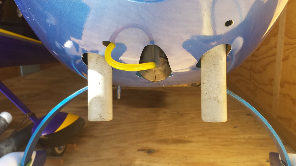

The carb has the 3W 90 degree horn on it with the pulse port hose from the carb connected to it. I will try to send you a picture of the front of the cowl.
thurmma
@Bunky.F.Knuckle here is the picture of the cowl. I noticed that there is a drip on the bottom of the cone. Any ideas?

I haven't yet, but once the weather clears I will. I don't have a snorkel on my 3w 150 and it runs great.
