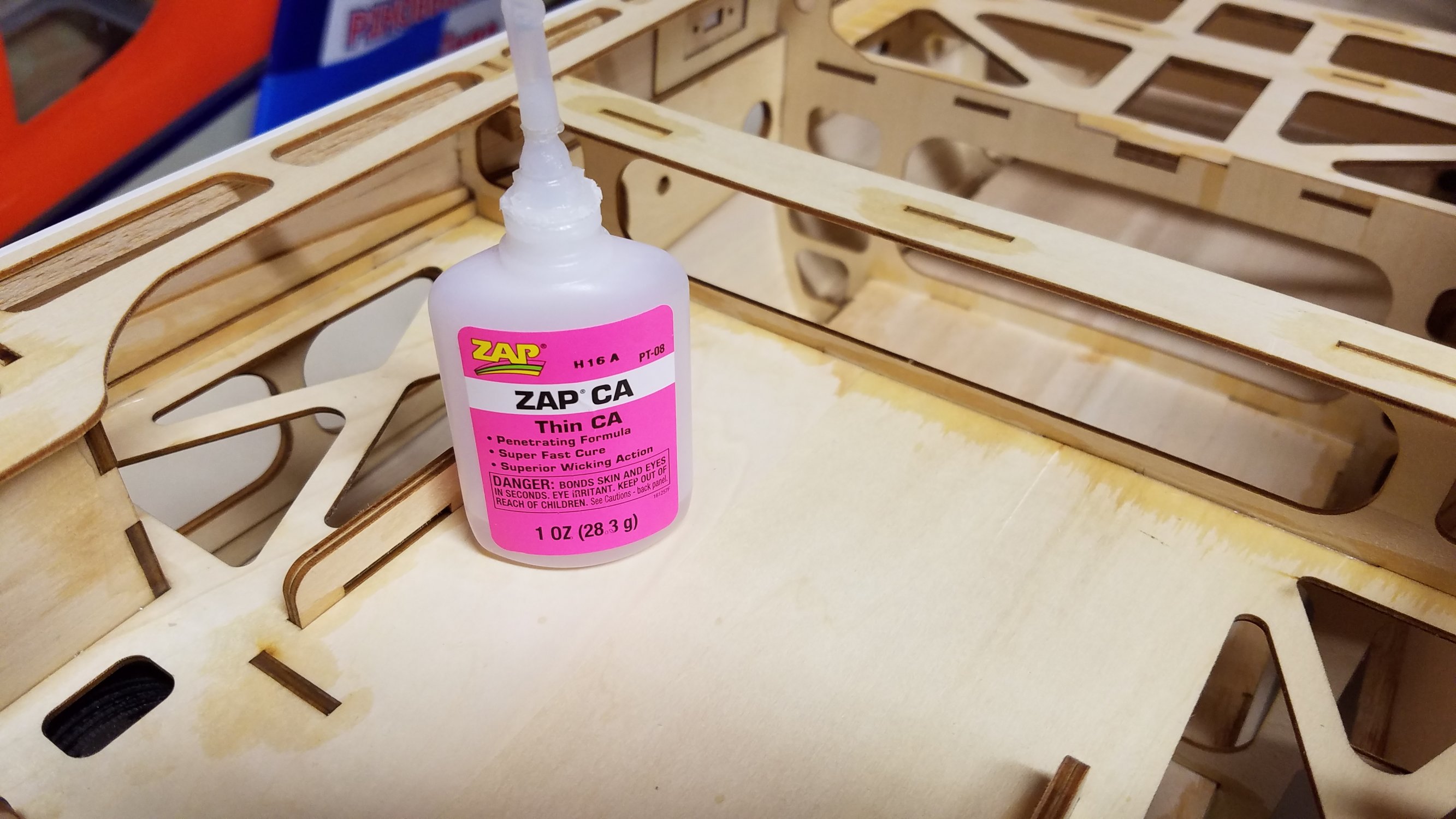

I did the standard thin CA soak all the joints... I went through a new 1oz bottle of ZAP thin CA on the fuse.

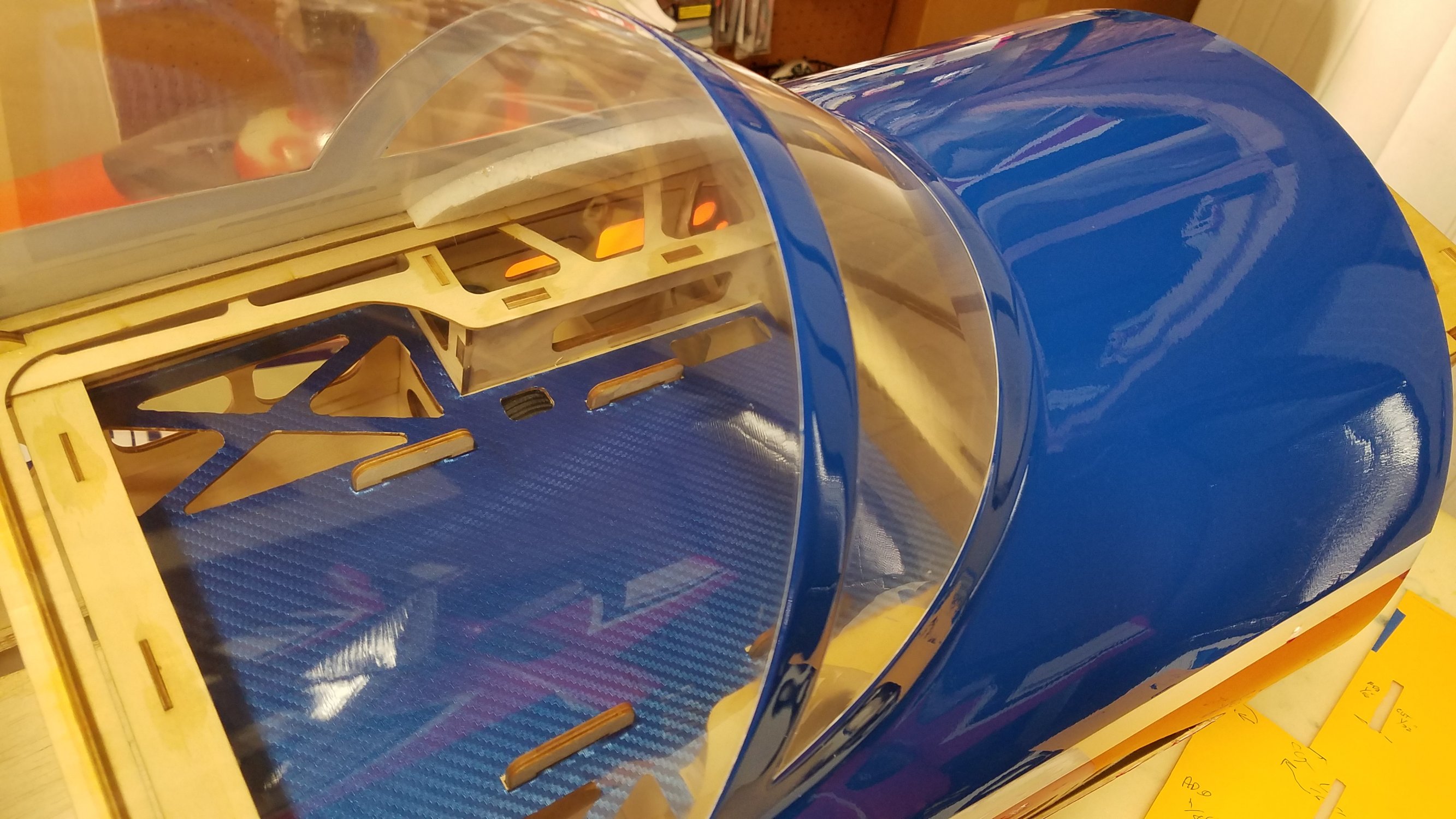

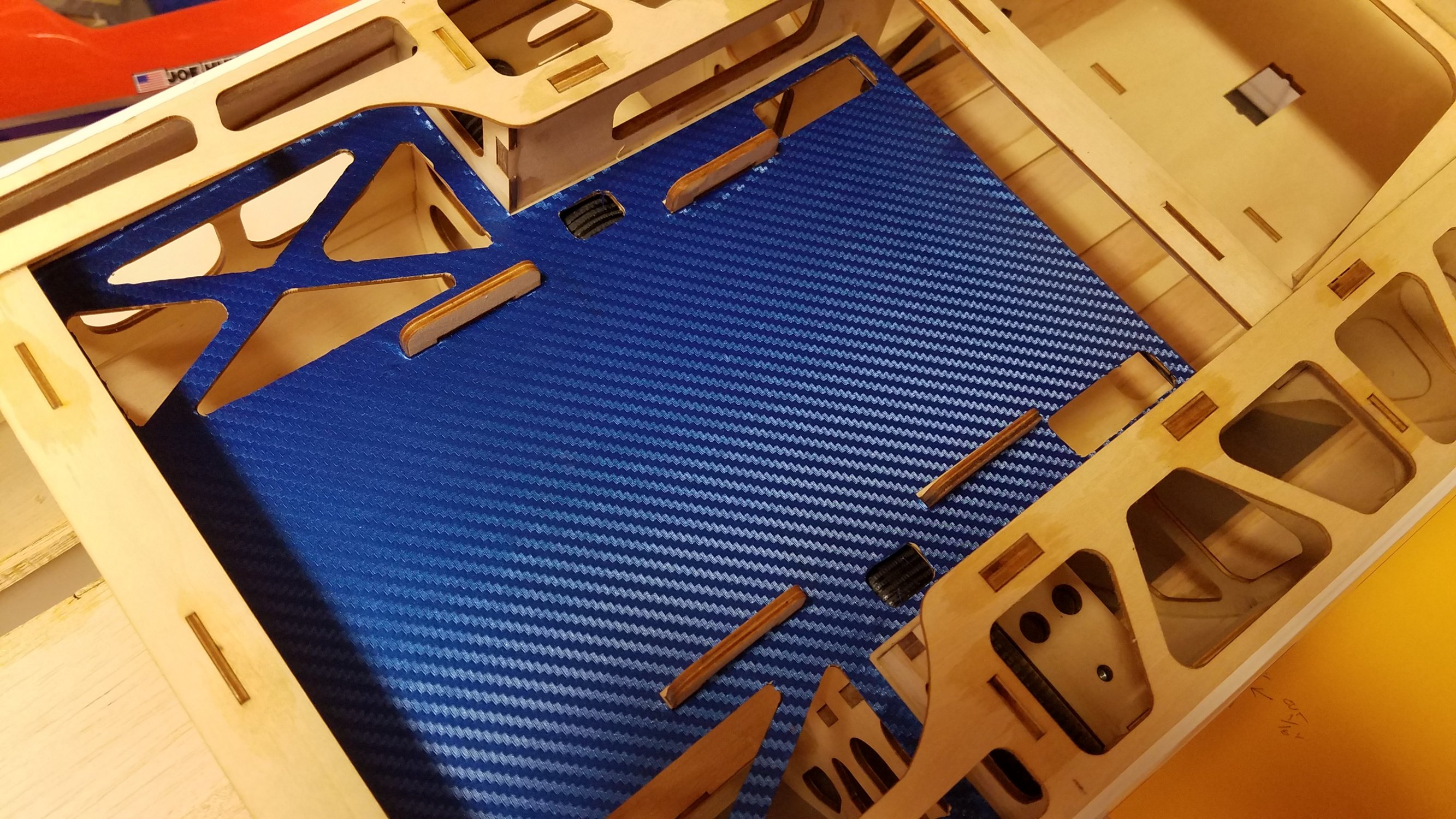

Joe Hunt
Since the fuel tank is over the wingtube (and therefore over the CG) the tank resides partly up inside the hatch. So, you can see quite a bit of the inside of the plane. I bought my plane at www.northwestrc.com and @SupaTim was nice enough to use this blue carbon fiber plywood so it would look nice. ;) He says he'll do it for anyone that asks. ;) Just kidding! I got some blue CF vinyl and put it on... just wanted to be a little fancy, you know. hehe

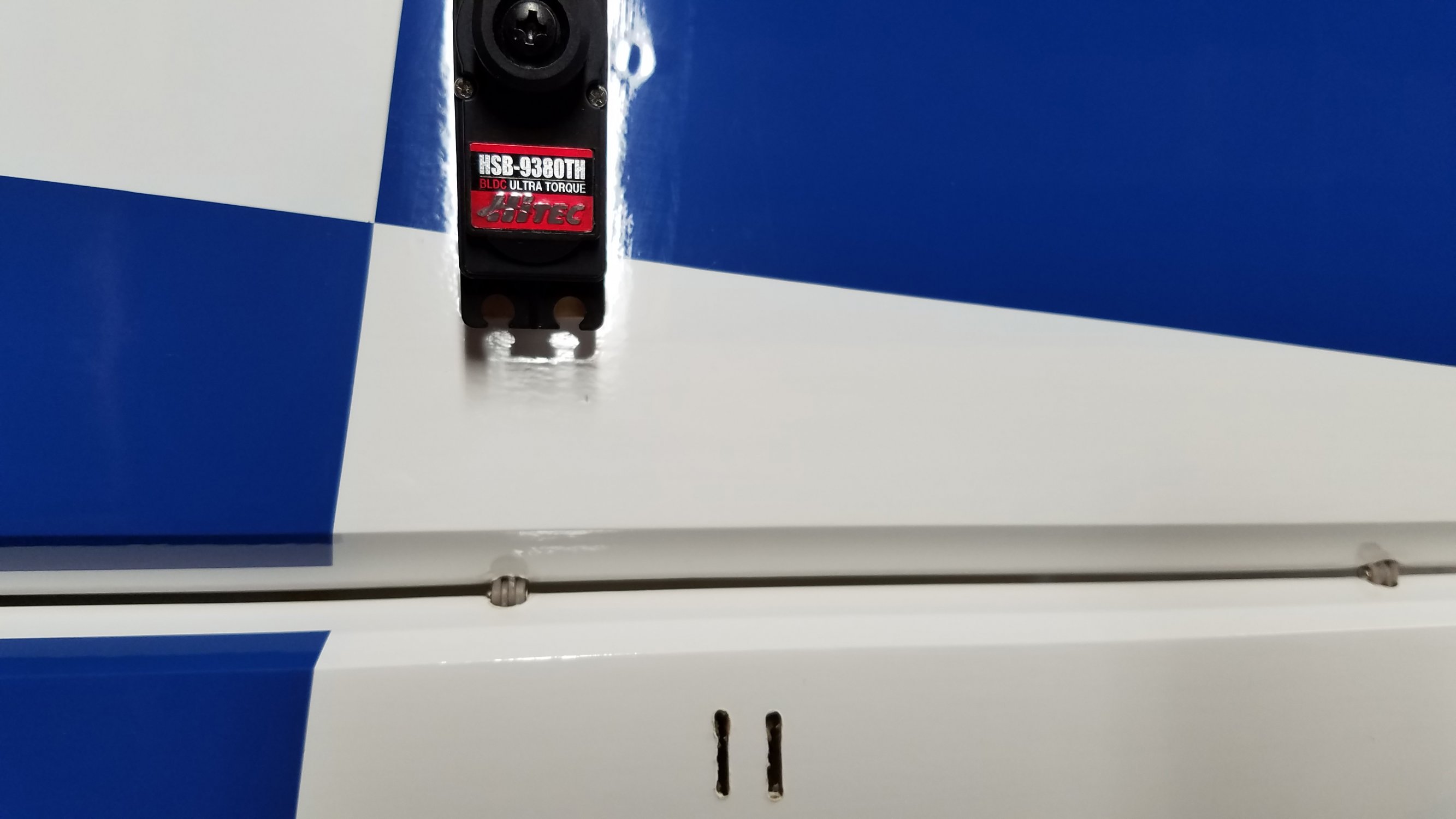

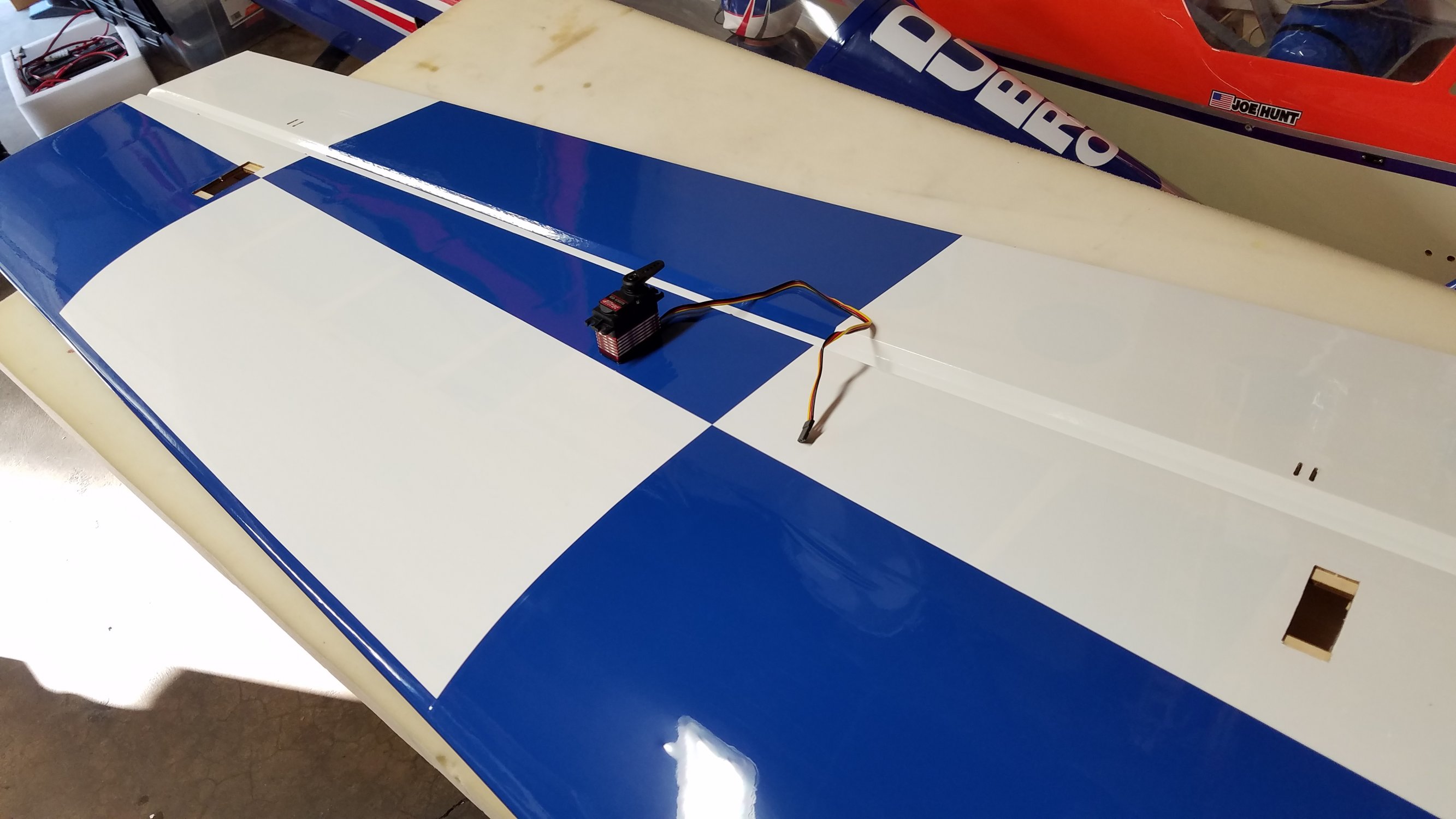

Joe Hunt
The manual was correct! There is a 3rd hole right under where I placed that servo... hmmm. haha

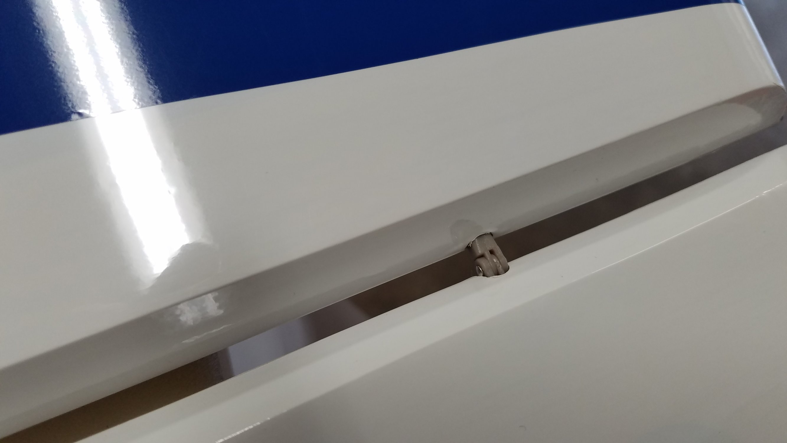

Joe Hunt
The hinges are not glued in which makes me very happy. I'd prefer all ARFs came this way. One it allows me to add hinges to each end of each aileron, etc. And, two it allows me to glue them in solidly with good glue.

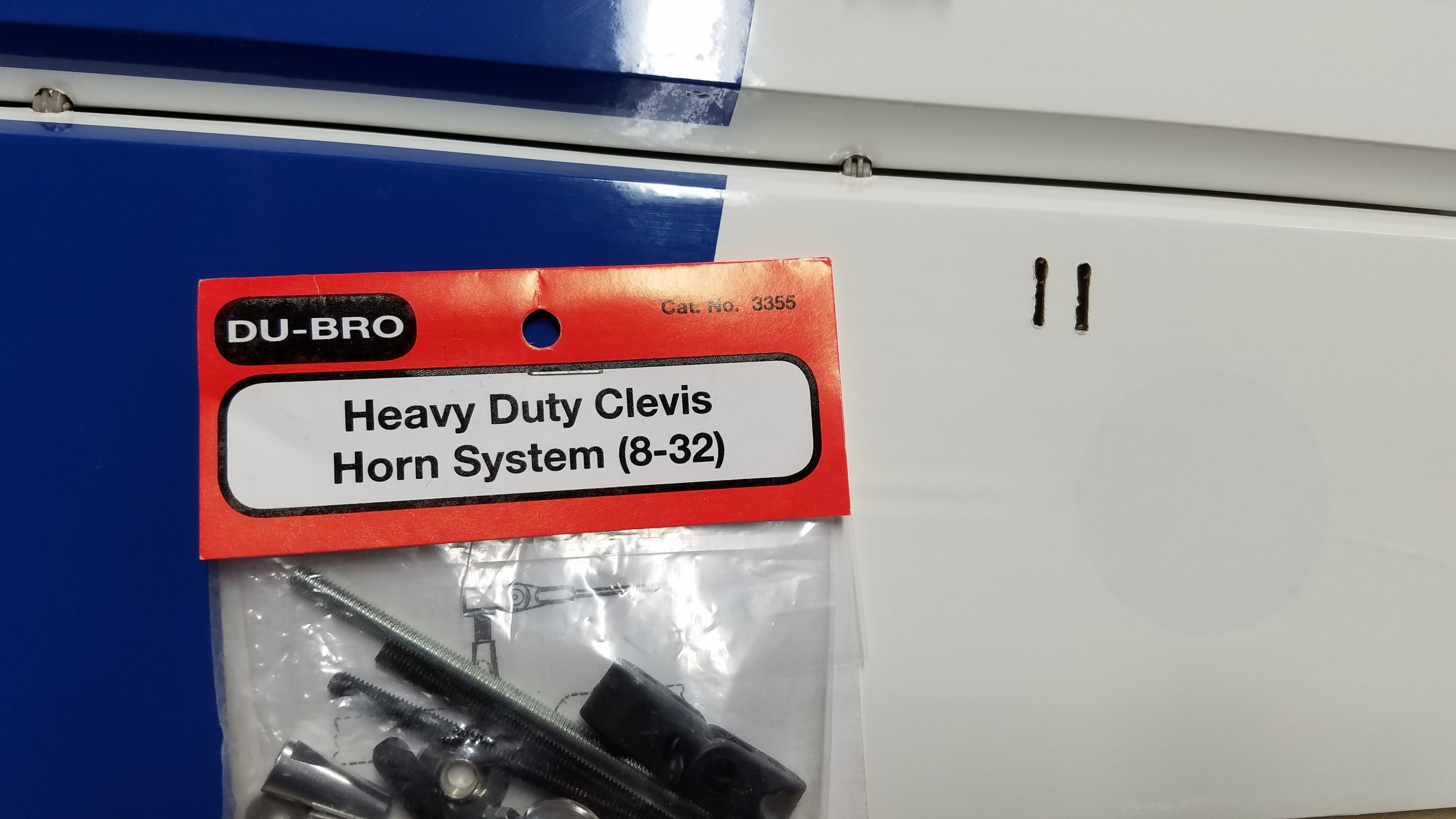

Joe Hunt
About the control horns, I could always use DUBRO bolts like I did on my Pilot RC 122". Then I can put them where I like them and fine tune the height for perfect synchronization throughout the range of travel. But, I'm going to give it a go stock and see how it works out on the protractors.

Xpress
Joe you shouldn't need 3 servos on each aileron, they're not big enough to mandate. 2 9380's should actually be overkill which is perfect, I'm using 2 7955's on each aileron on my oversized aileron 107" Yak and they don't have any problem pushing those ailerons out to full with HV power on the fastest of rifle rolls:epic:
I am firmly confident that 2 9380's will get the job done, plus those EF airframes are stupid strong anyways so there shouldn't be much flex in the ailerons. I'm slightly envious of you now because I want to get one of those in that color :sneaky:
