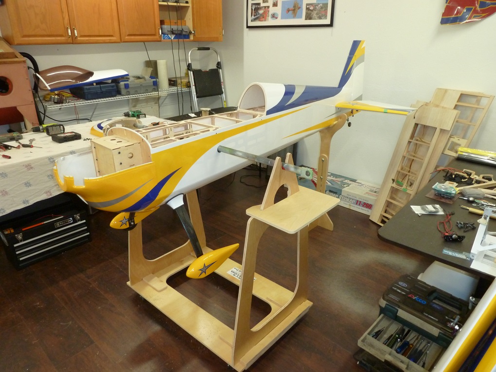

I thought the stabs were going to take a while with how deep the servo is recessed from the inboard edge, but it went rather easily.
acerc
Started with epoxying the main gear area, have to seal all the exposed wood don't we, when cured installed the mains, tail gear, and stabs and believe I will call it a day.

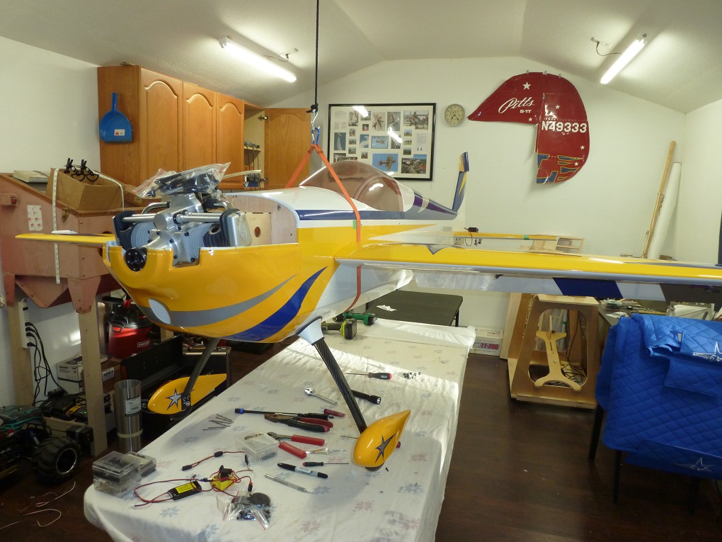

acerc
Could not stand the not knowing of what the extra 4lbs would do so I slid the wings on, set the two rudder servos on the stabs, and set the engine with ign on the nose. And to my surprise when I lifted it at the given 1-1/2" in front of the tube it set nearly level. Having the two four cell batteries and the Rx to move around getting a neutral c of g should be a piece of cake.
And according to my measurements it only needs 1/2" stand off's. I think the Valach will work out.
