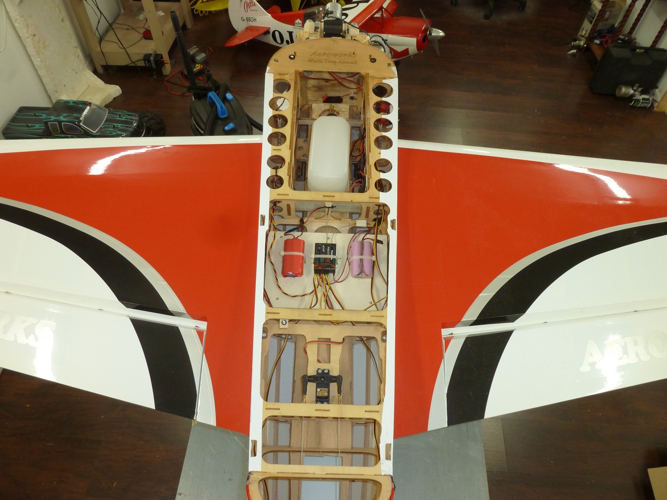

The tail is done, wing is done, motor mounted, batteries and Rx installed. I still have to install the throttle servo but in no hurry as I am waiting for a prop, a Ultra IBEC, and a Bridge rectifier. The stock muffler won't fit in this arrangement so I need to order a Pitts style. But in the mean time I am going to cut a corner out of the stock so as to fit and have it welded back up.

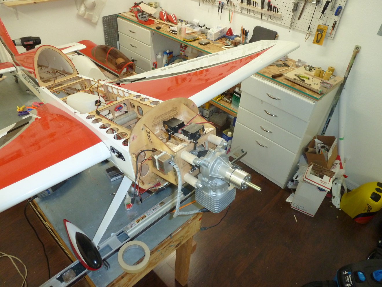

The throttle and choke servo ply plate has been epoxied in. I don't really care for this placement but with the orientation of the carb it is good as it is going to get without major modifications to the box. When cured I'll put the servo mount blocks in place and that will be it until stuff starts showing up.

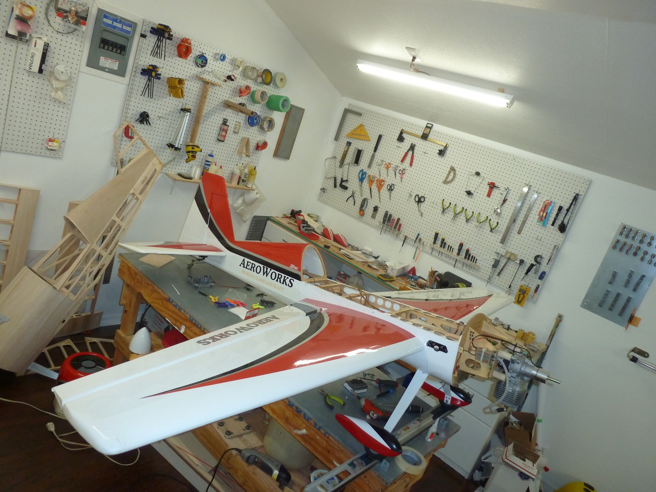

Got a little done today, the throttle and choke servos installed as well as finished up the wiring. The geometry worked out real well on the set-up, I am at max on end points with 45° throw on ail's, ele's, and rudder. Later on, when or if I get to more aggressive needs, I can re adjust the linkage for more throw but I doubt this airframe will be around then. All I am waiting on now is some fuel line and doing the exhaust.
