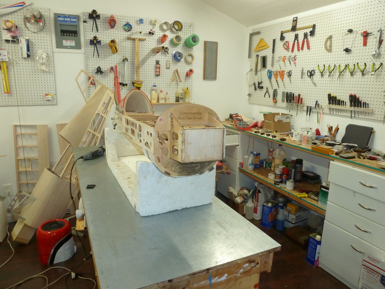

The wall has been epoxied in place. I went a bit thinner than what was there, I dug out at least a half inch of wood and replaced it with three eighths. Tomorrow I will put hardwood on the inside corners and glass the front perimeter.

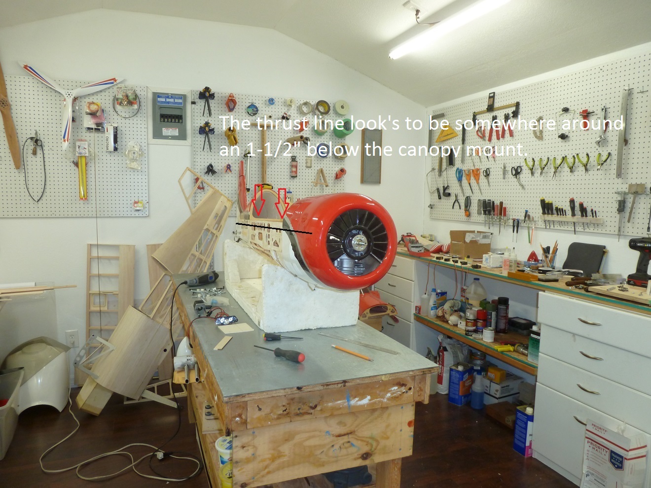

Does anyone know where the thrust line is? I am working on the engine mount, if I go by the engine box the prop hub is off center of the cowl, if I go by the cowl the engine just don't look right to the fuse. I can adjust the cowl to where it needs to be of which looks to need shims on the top, it points upwards just a tad.
