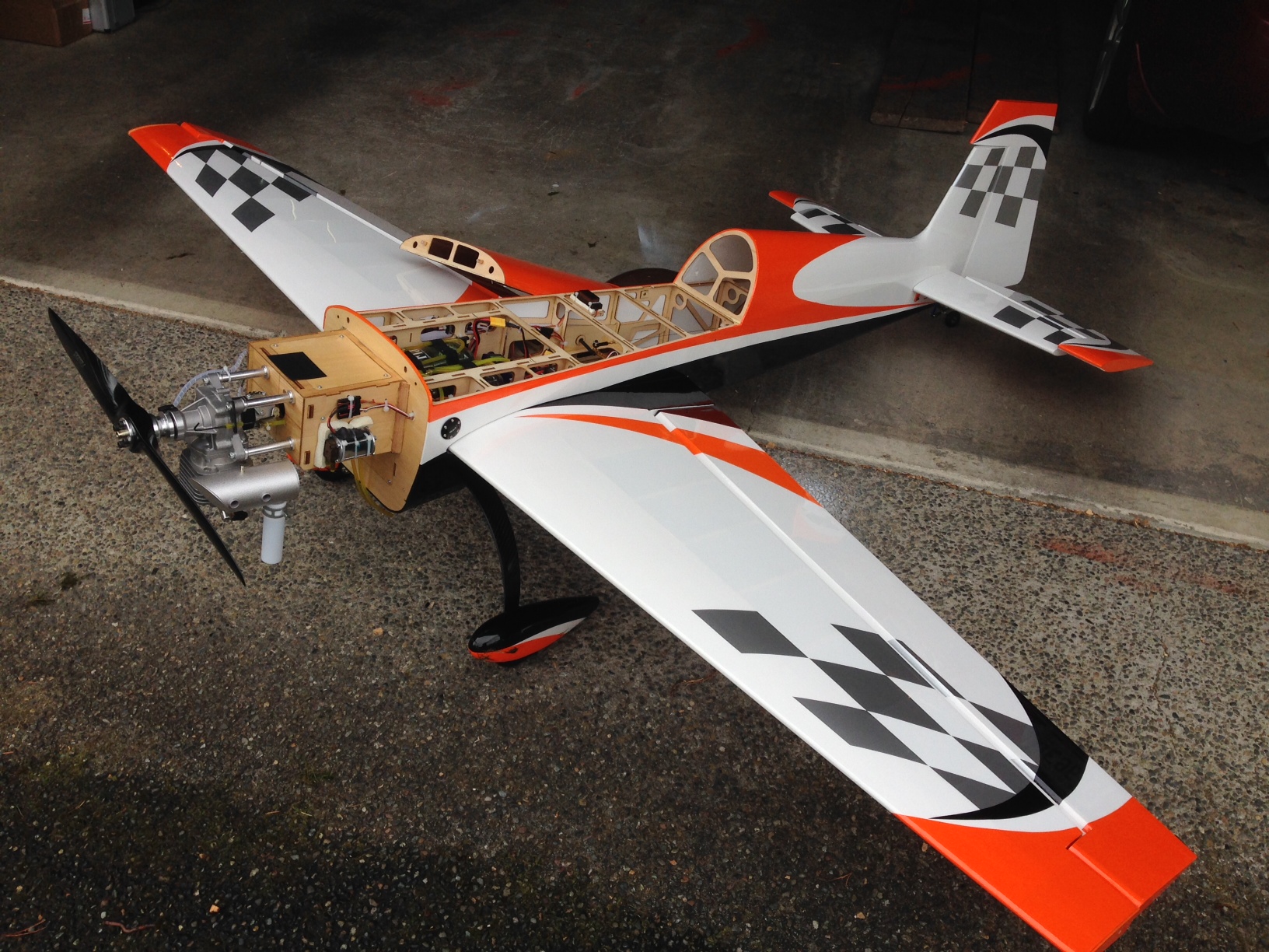

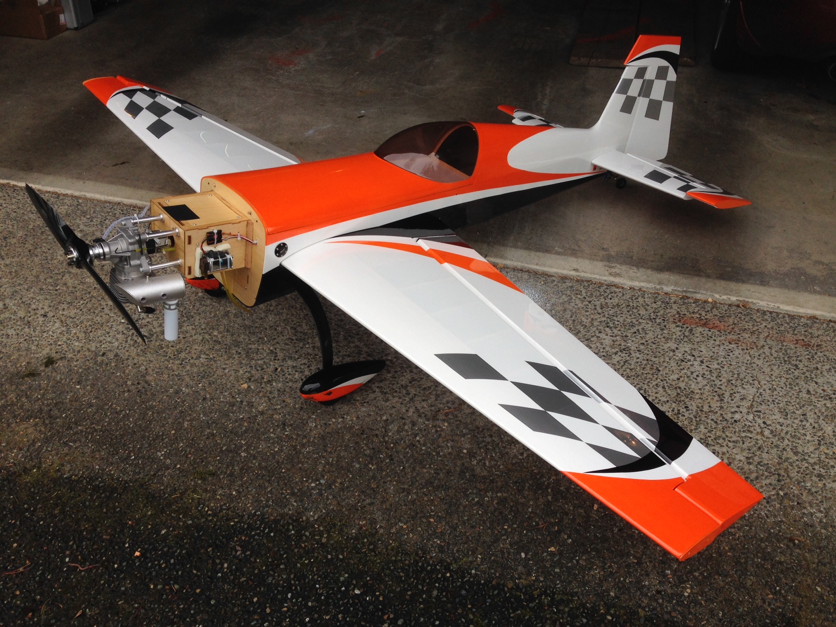

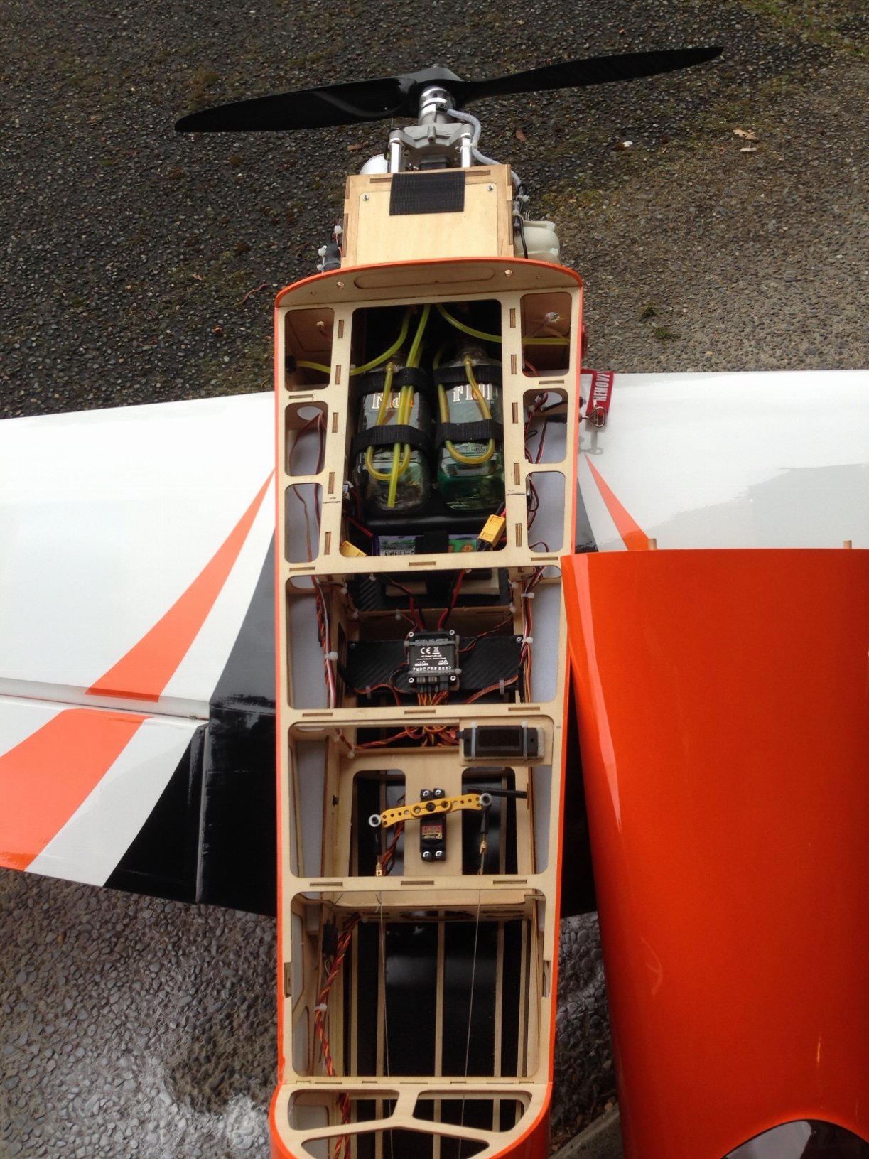

Today I'm maidening the PeakModel version of the same plane and because this airframe is so new yours is the best source of build info on the web right now. Mine is sporting a new DLE61 and will have smoke once my Jtec wrap around pits shows up. (pics attached)
I agree with the CG comments but I was just surprised the beginning GC is recommended 6.89 back. That puts it just behind the wing tube and I don't ever recall a starting CG on any plane I've built being so far back. Just a bit nervous but your comments are helping :thumbup:

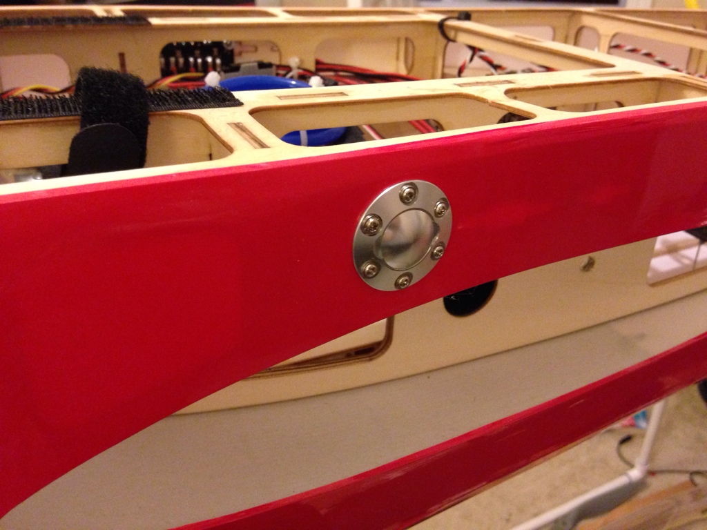

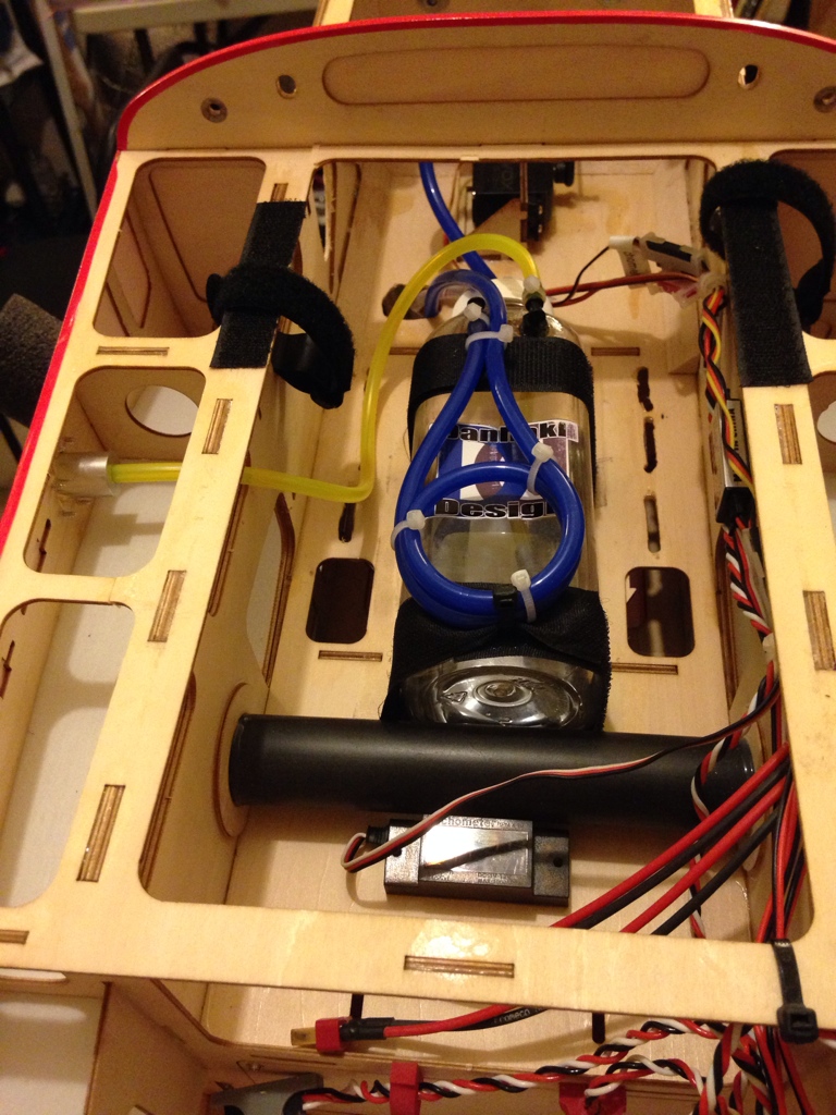

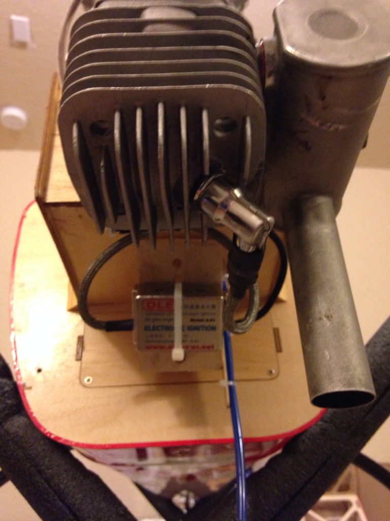

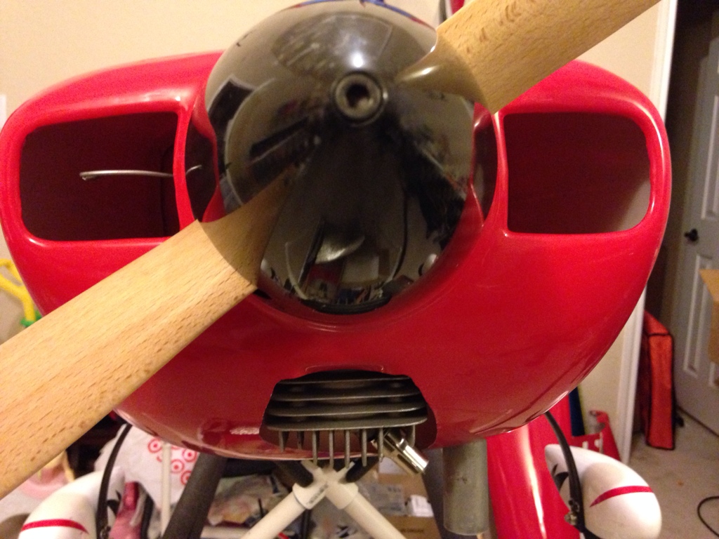

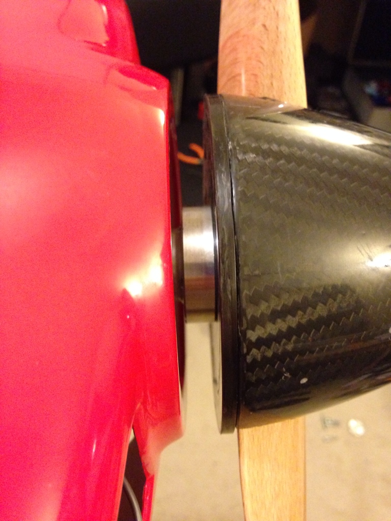

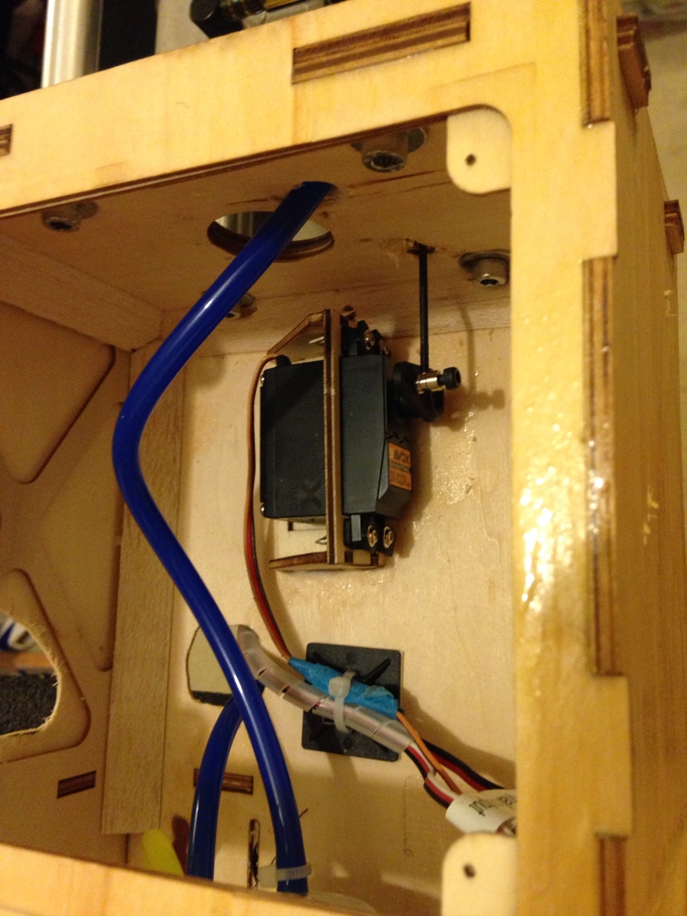

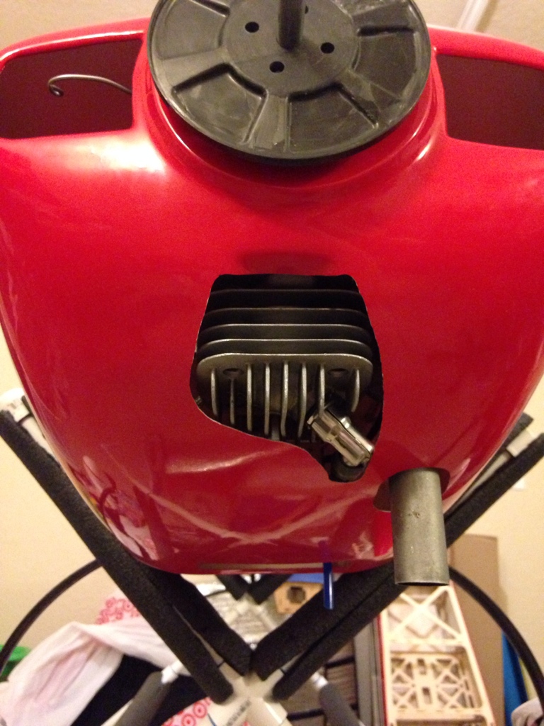

Got the DLE 55 all installed and ready for my next trip to the field:
ImageUploadedByTapatalk1396844859.114486.jpgImageUploadedByTapatalk1396844871.429663.jpgImageUploadedByTapatalk1396844882.622730.jpgImageUploadedByTapatalk1396844893.439807.jpgImageUploadedByTapatalk1396844904.191194.jpgImageUploadedByTapatalk1396844915.472296.jpgImageUploadedByTapatalk1396844927.060544.jpg
I'm happy with the big cowl, as I didn't have to cut a ton... So it really looks good to me. The forward edge of the muffler is about 1.5mm from the cowl, so it might singe through.
Spinner gap is a little big, but I'm using what I think are the stock DLE55 mounting standoffs.
