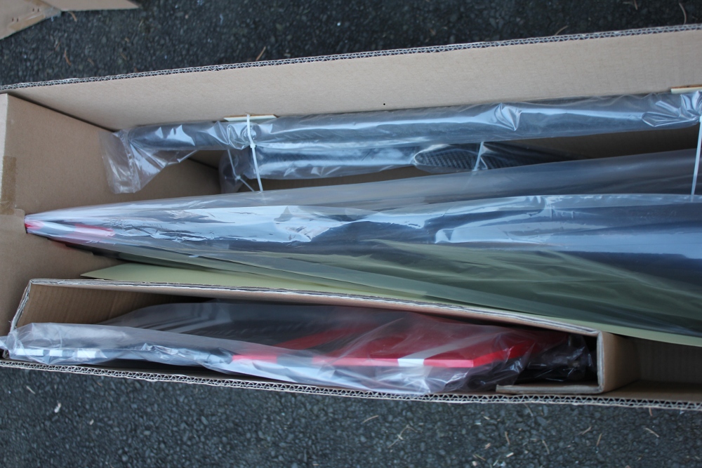

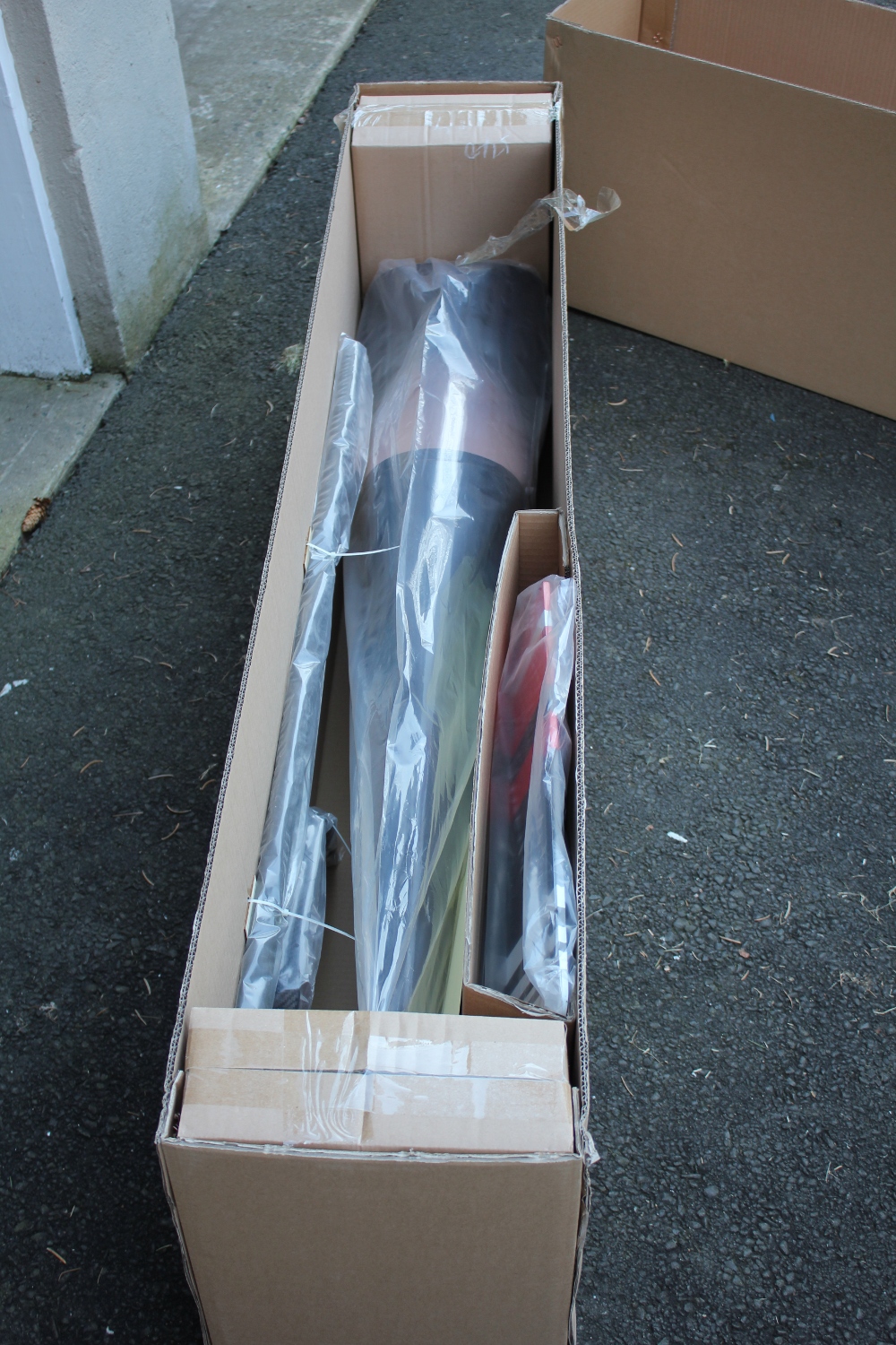

The plane is nicely boxed in double heavy duty boxes. Looks like you could run them over with a truck.

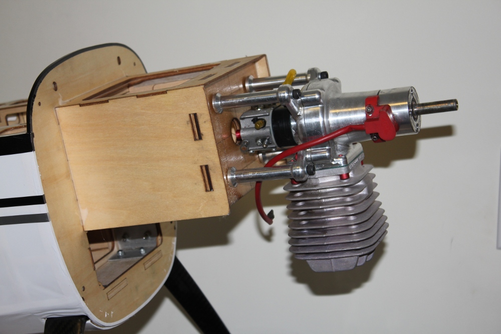

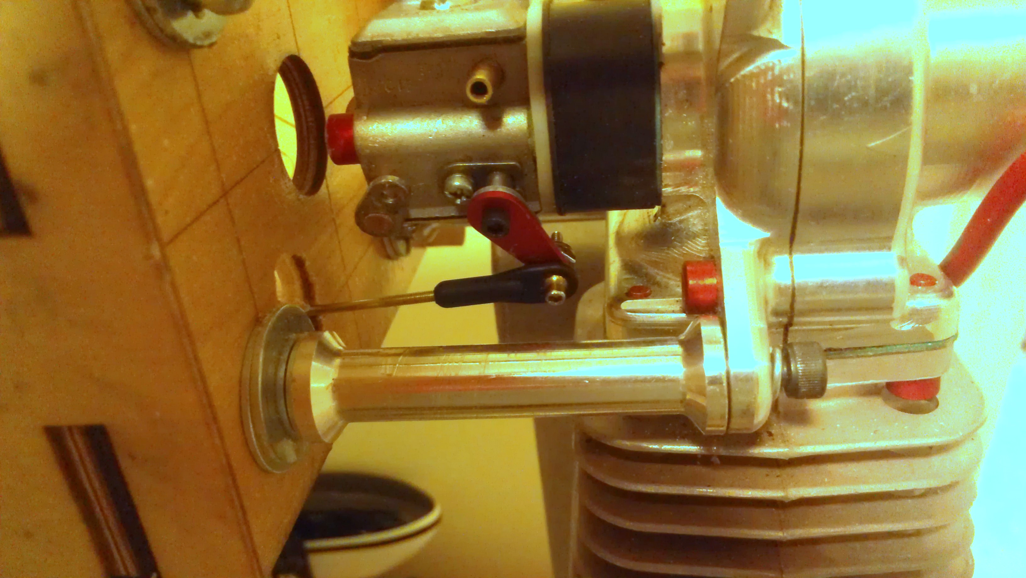

The firewall is nicely marked for a DLE55/DA50. Four holes and some bolts and I was able to dry fit the engine. It's really nice when everything is already measured and pre-marked for you! So far it looks like a perfect fit!
njswede

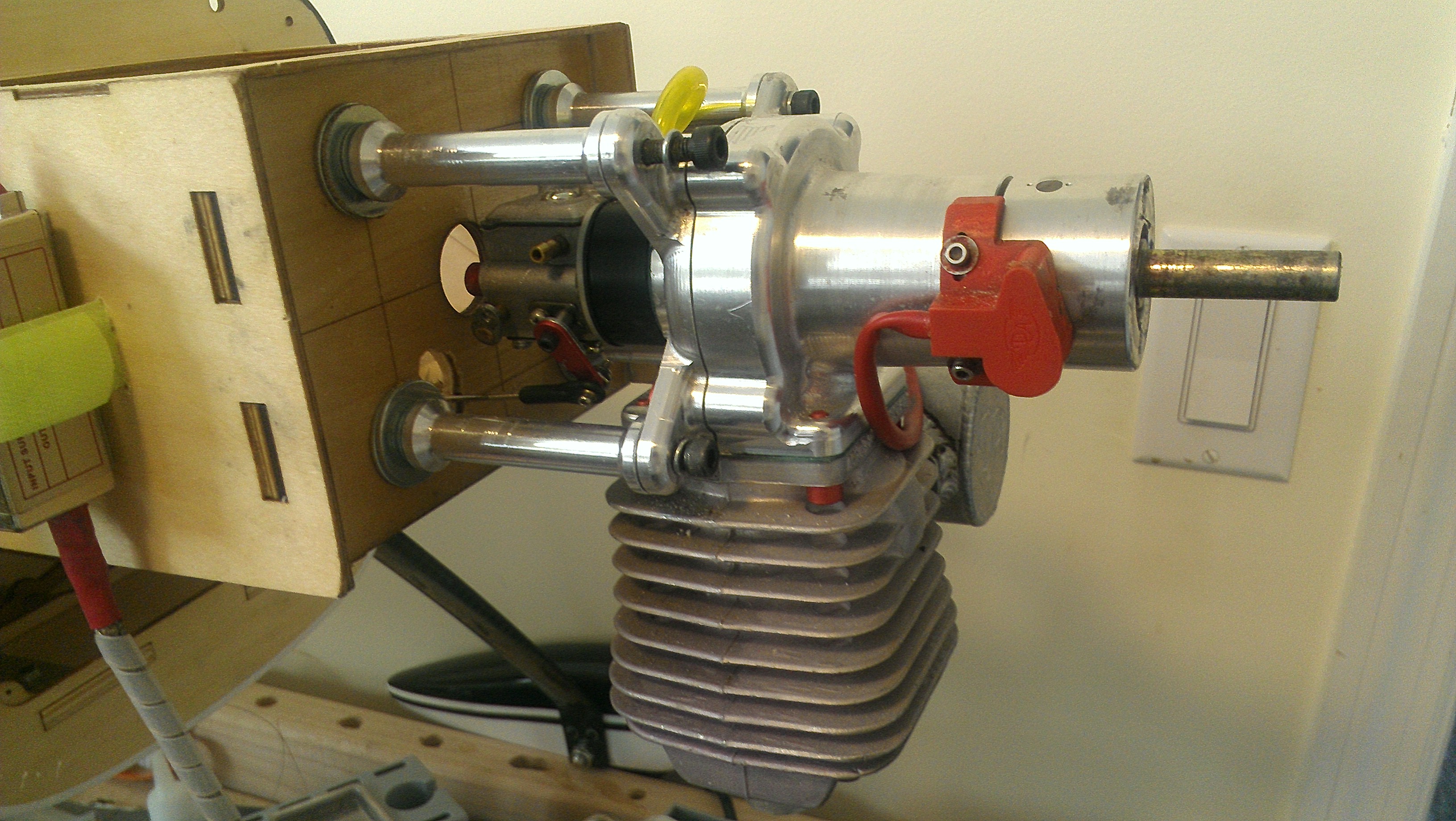

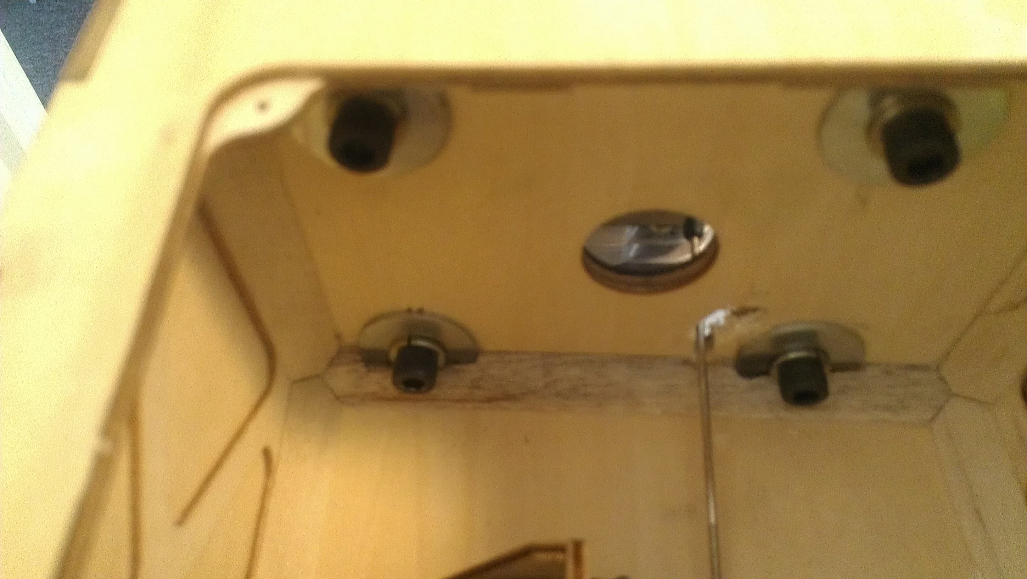

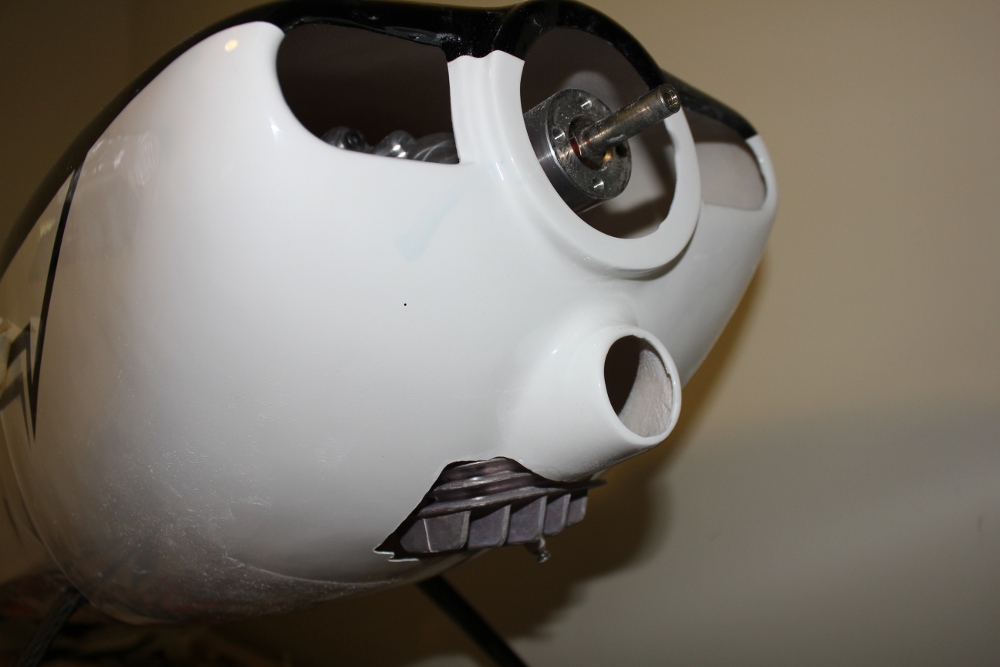

Permanently installing the engine, I used fender washers behind the firewall. As is common on these types of models, I had to trim some of the washers with my Dremel cut-off wheel.

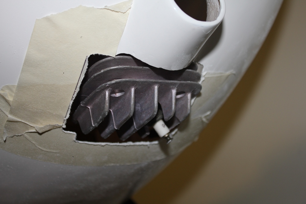

Next, I started cutting the cowl. I used some painter's tape to avoid chipping.
Starting to come together! The DA50 looks like a really good fit in this cowl!

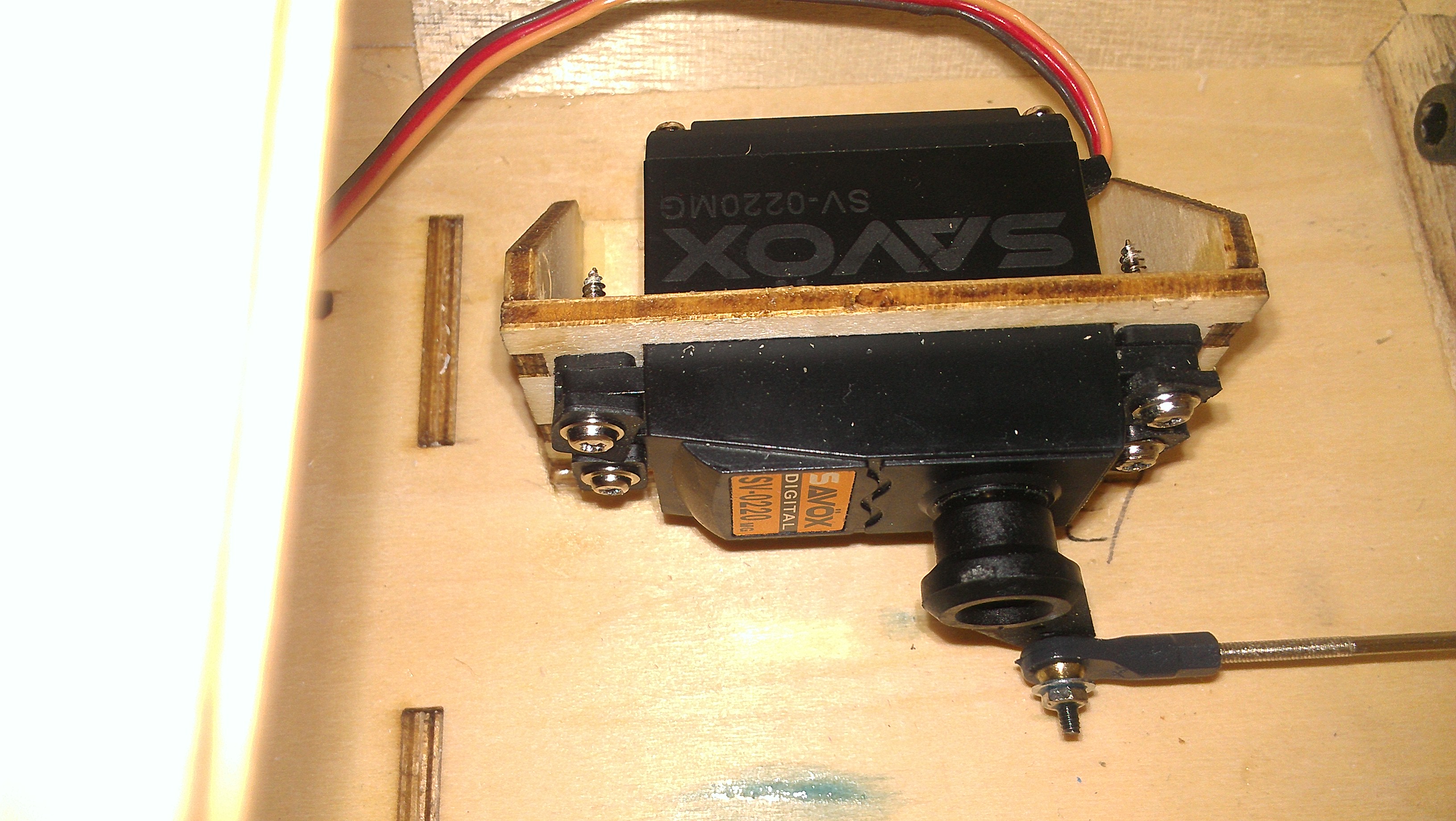

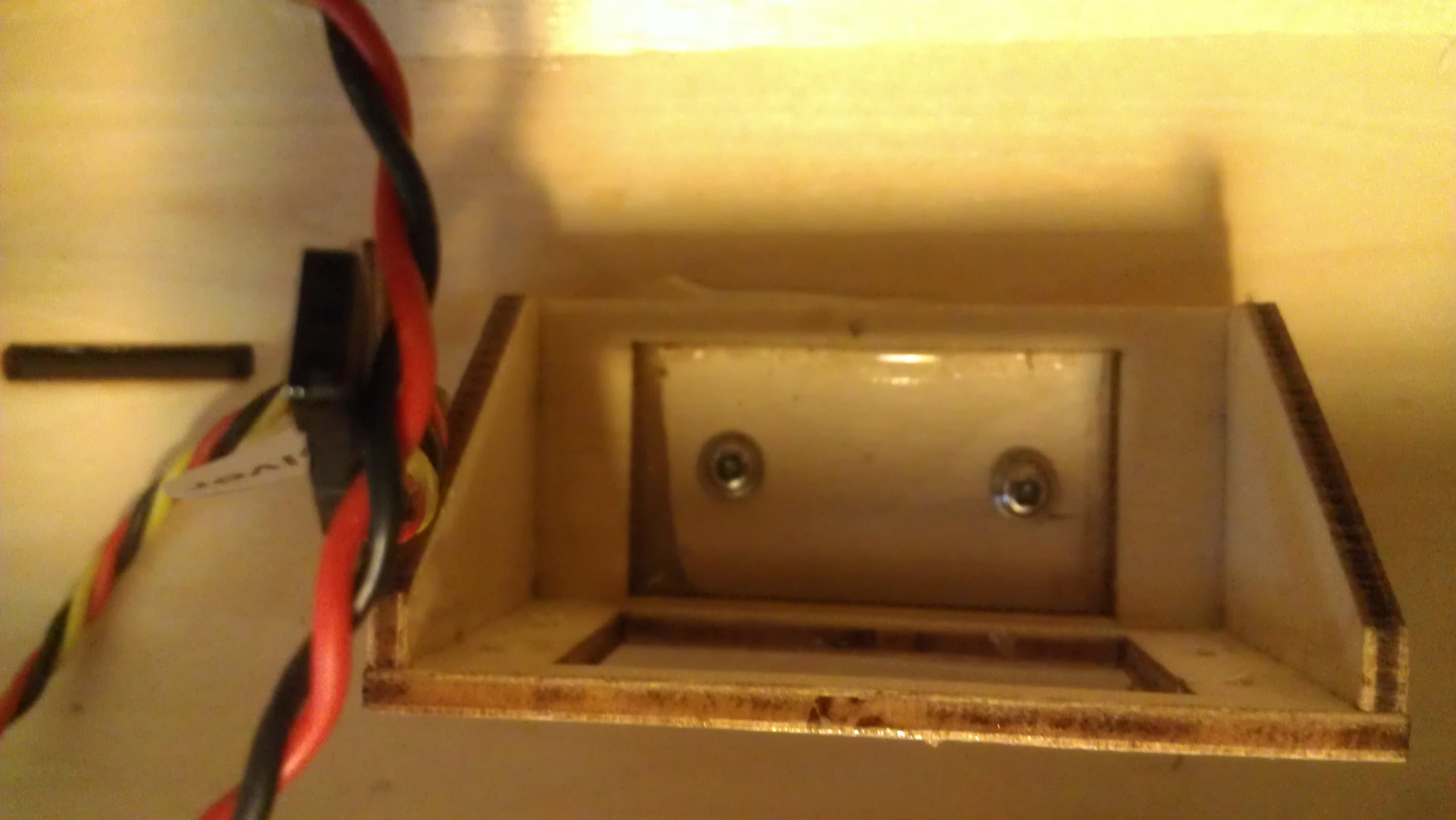

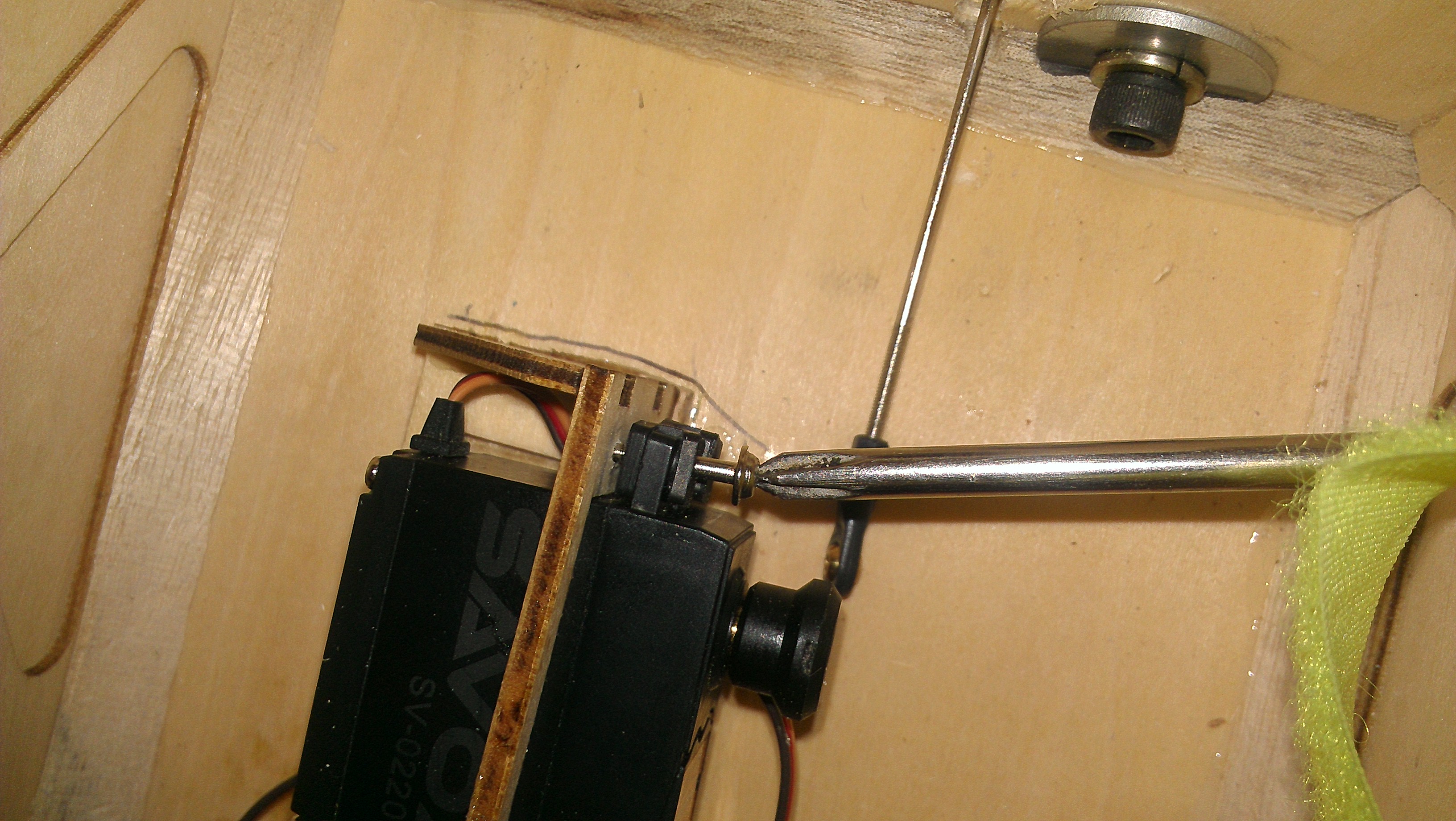

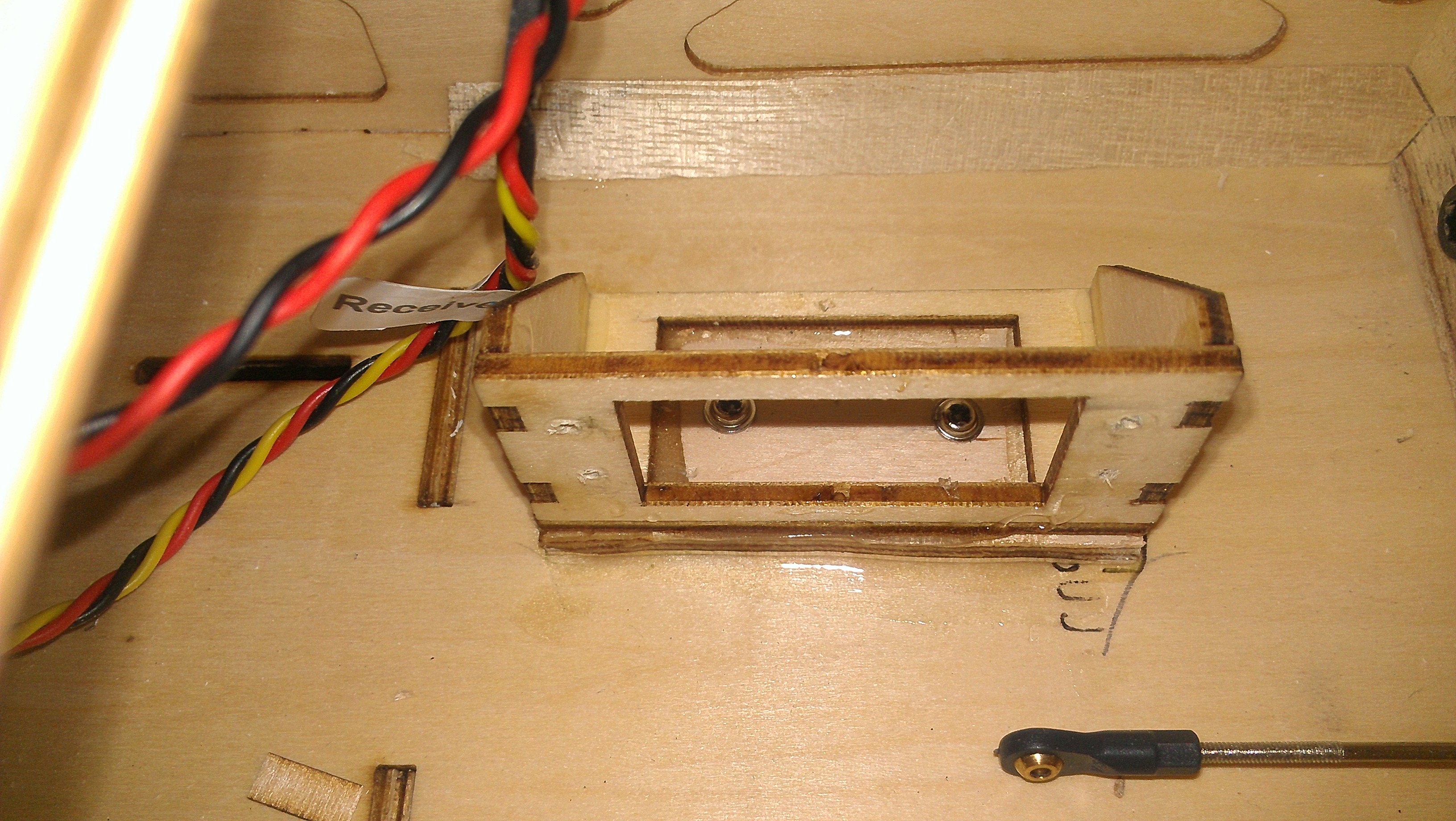

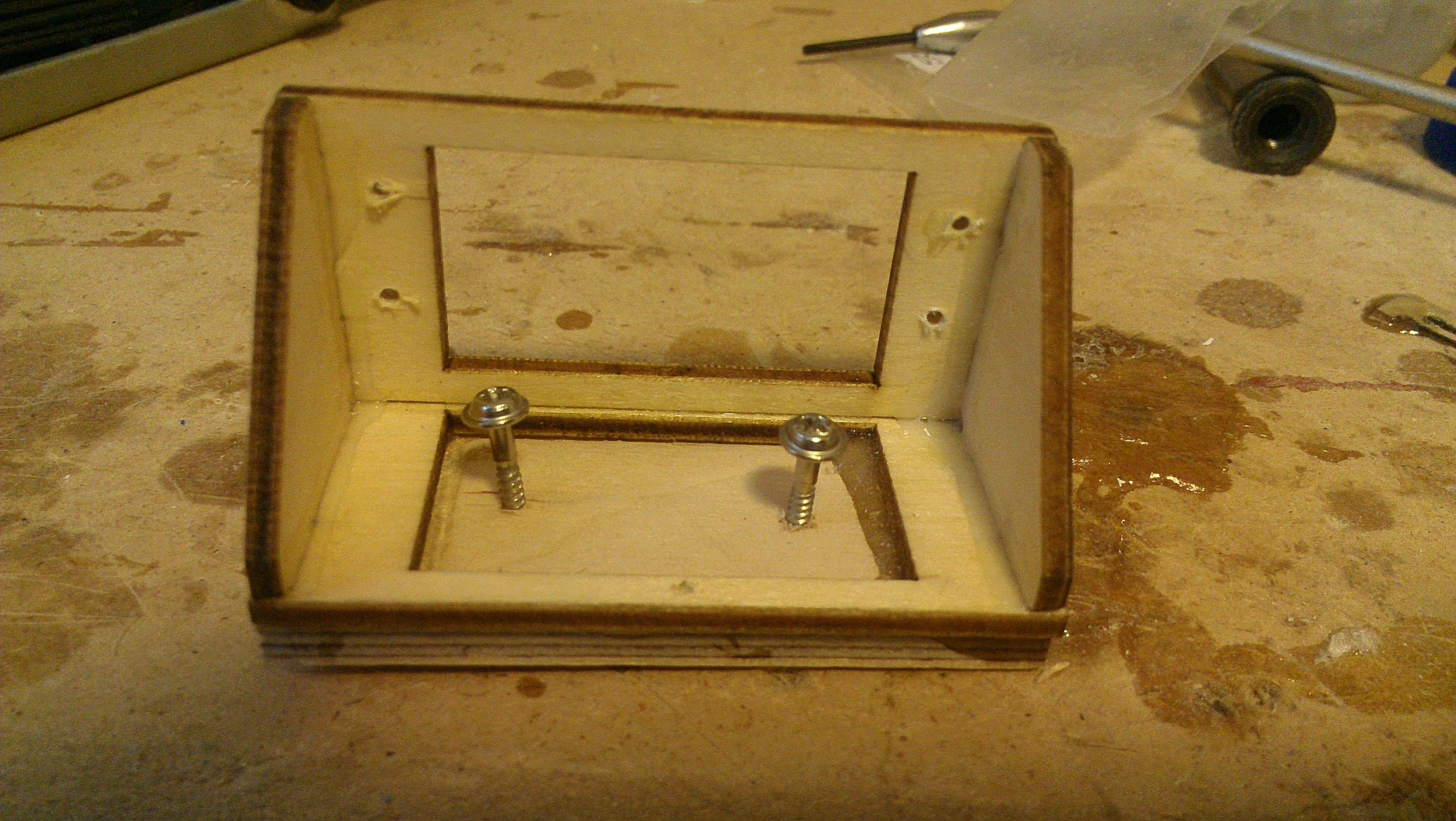

Time for some throttle servo! The kit comes with a nice seat for the throttle servo, but to make the geometry work, I had to mount it on a piece of 5/16" plywood. I just epoxied it to the plywood.

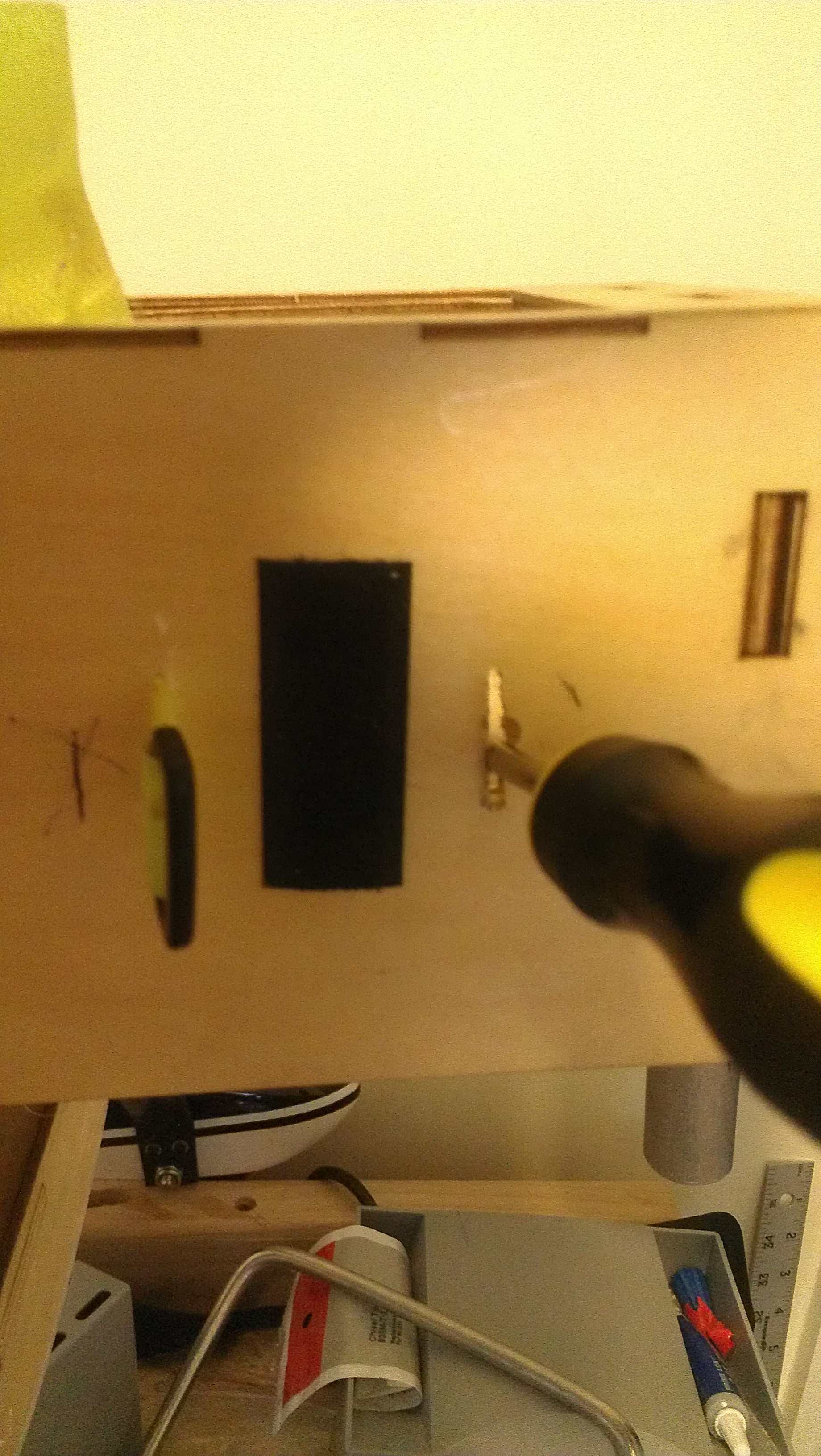

I screwed and epoxied down the seat, but since the screws attaching the seat to the plane are under the servo, I had to screw the servo into the seat while it's in the plane. Luckily I had already made some holes on the side of the motor box to strap in the ignition, so I could push a screw driver through those holes.
Everything in place! The geometry came out absolutely perfect!
