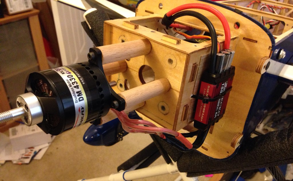

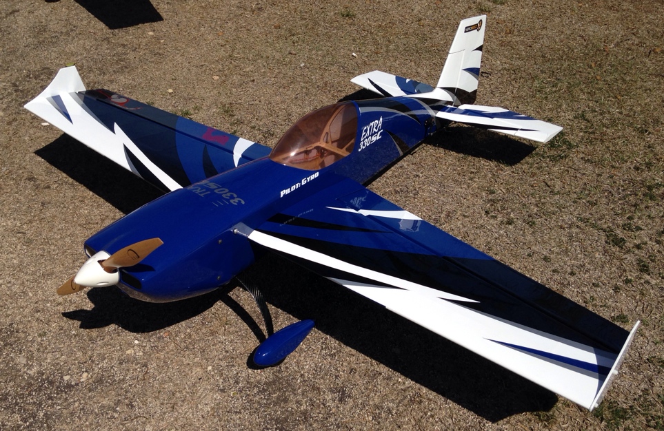

Got a quick 2 flight teaser on  [MENTION=3]GYRO[/MENTION]'s extra today. 1st I forgot  how EP feels. AND POWERS THERE..... the airframe itself I liked. Had some high winds but the SFGs helped a lot in the wind. My slick was sliding around in the 1 flight I had today. Not the extra, it was on rails. 1st flight I had with the extra the CG was a little more forward than I like. But it still tumbled well. knife edge, did not couple. 2nd flight Lipo moved back an inch from first flight. So much better to my liking. Tumbled better, knife edge still on point. Flies very well. Little heavier then 3dhs extra, but the extra wing area helps. It flies light. You won't notice. After the flights I took a closer look at the airframe itself. Built sturdy and smartly. I liked that the wings slide into the fuse instead of just butting up. LG plate is reinforced by L brackets which I loved, Problem area of my slick right now. Over all I give it a thumbs up. I have to replace my slick this season and Aerobeez just may have one more customer.
