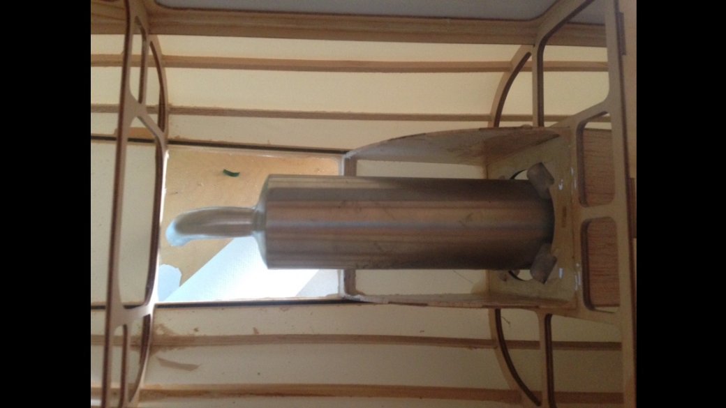

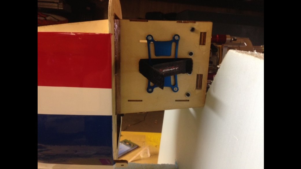

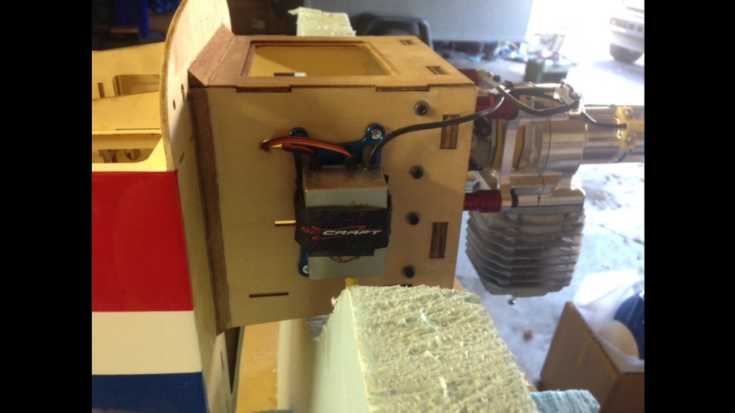

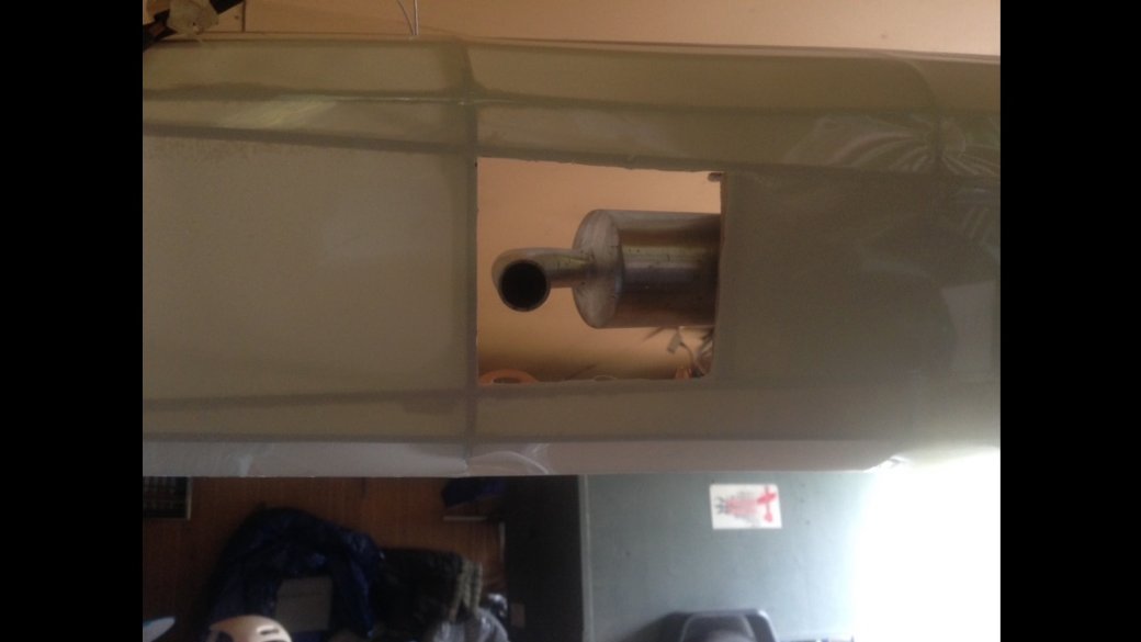

Well pinned the exhaust and glued a mount in. All I could manage after a 14 hour day and parenting now lol. An es 55 comp mount worked for the hype pipe perfect. A little but of trimming and it slide inside the bracing of the tunnel like a glove first shot.

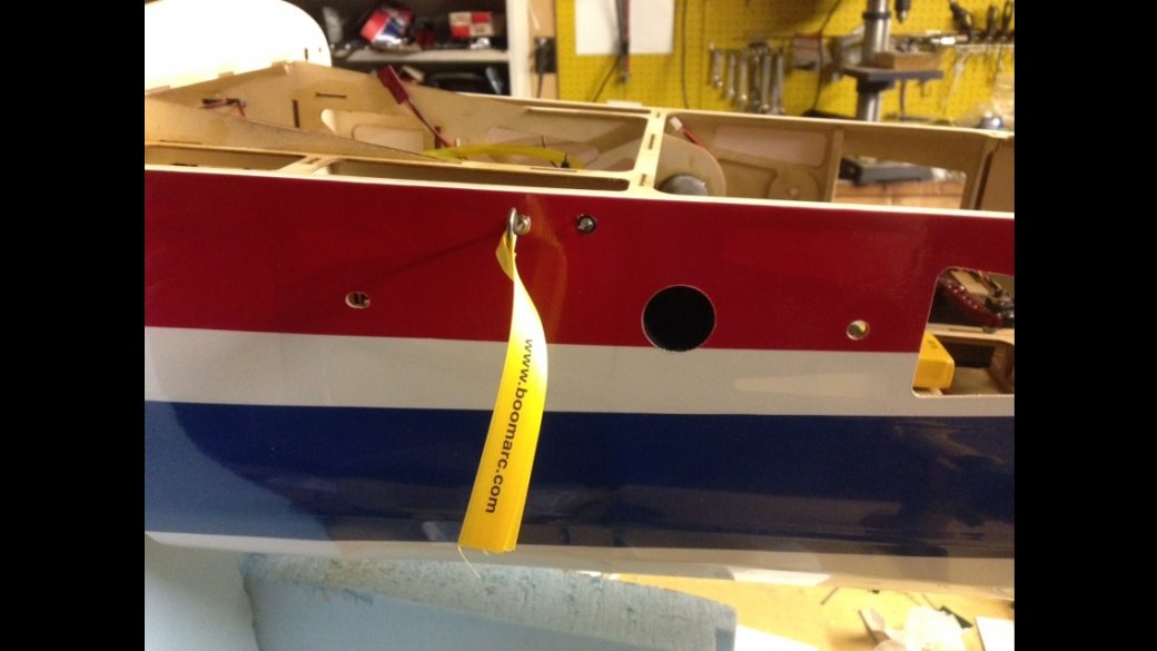

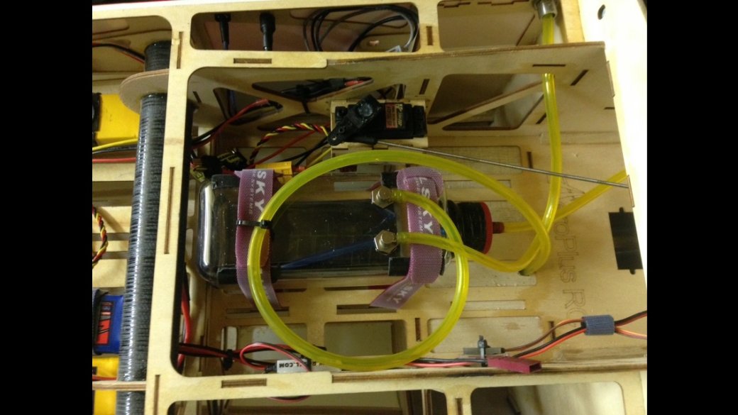

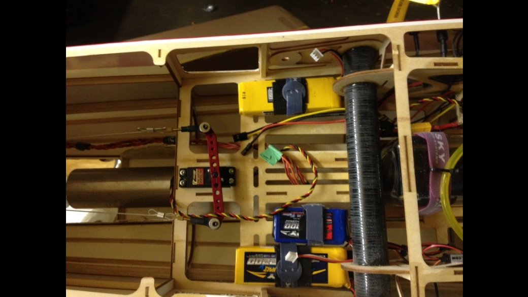

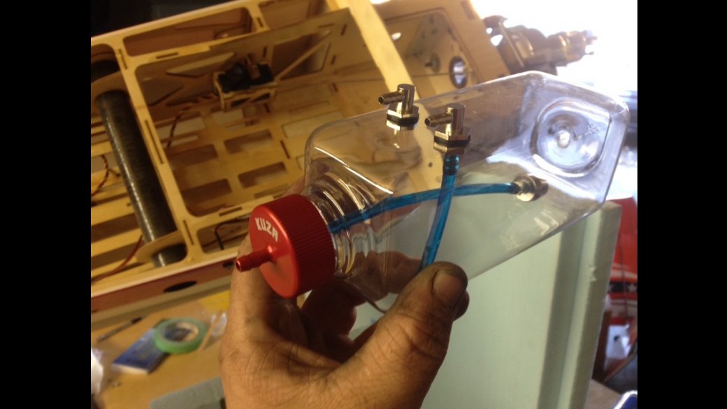

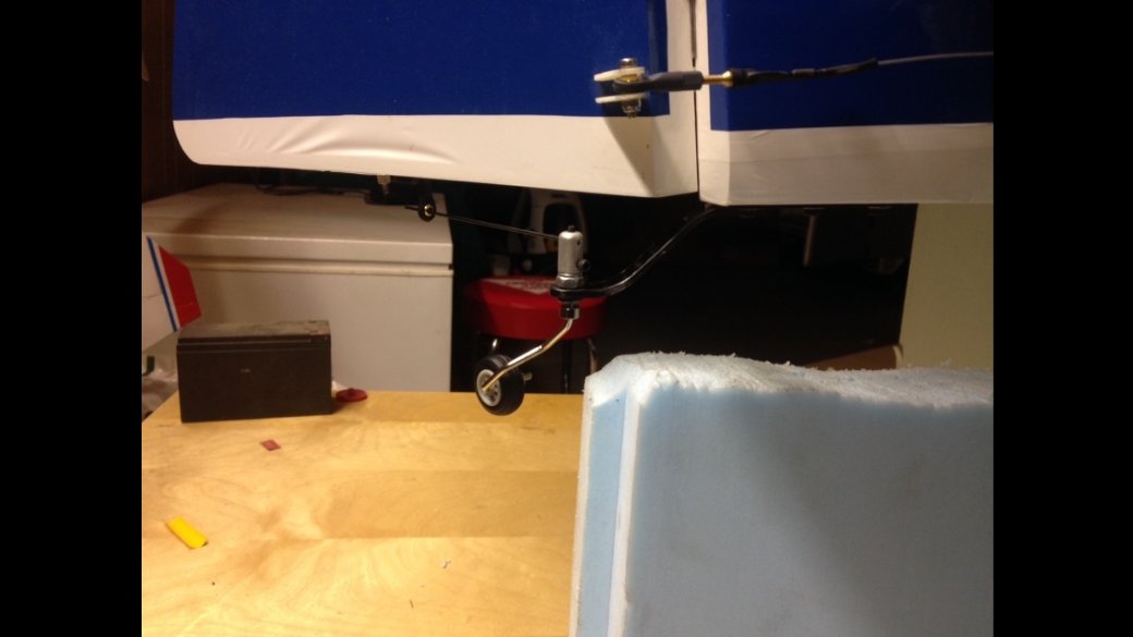

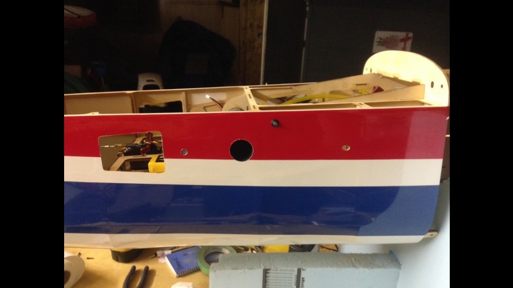

Well got the fuel tank done it's a kuza tank take note these tanks were out before extreme flights "new" tanks see a resemblance lol. Elevators on. Batts installed. Fuel dot. Ign mounted with a nice ign holder I won at the great Canadian Huckfest . Throttle done. Finally get to use the batt share booma rc pin flag switch, it's nice cause it's batts share and only two lights and the pin flag in the fuse. Makes it clean. Rcxl optikill in. Using two zippy 2200 2 cell lipos for the Rx and an 1100 life pack for ign. Still have To do the tail wheel landing gear cowel and choke rod. Might be ready for a maiden tomorrow weather permitting

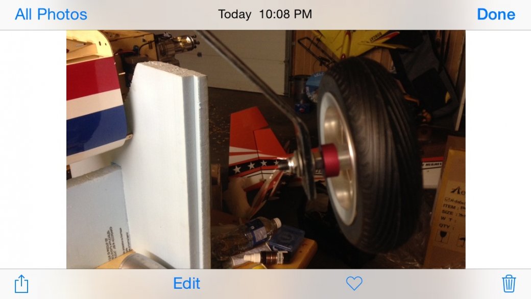

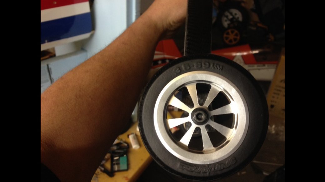

. Lorne got sick of losing wheels coulers and axels so this is his new method I like it. M5 bolt spacer regular nut two washers and a Teflon locking nut. Saves buying white rose axels. For larger planes use an m6. Now my favorited way to do an axle

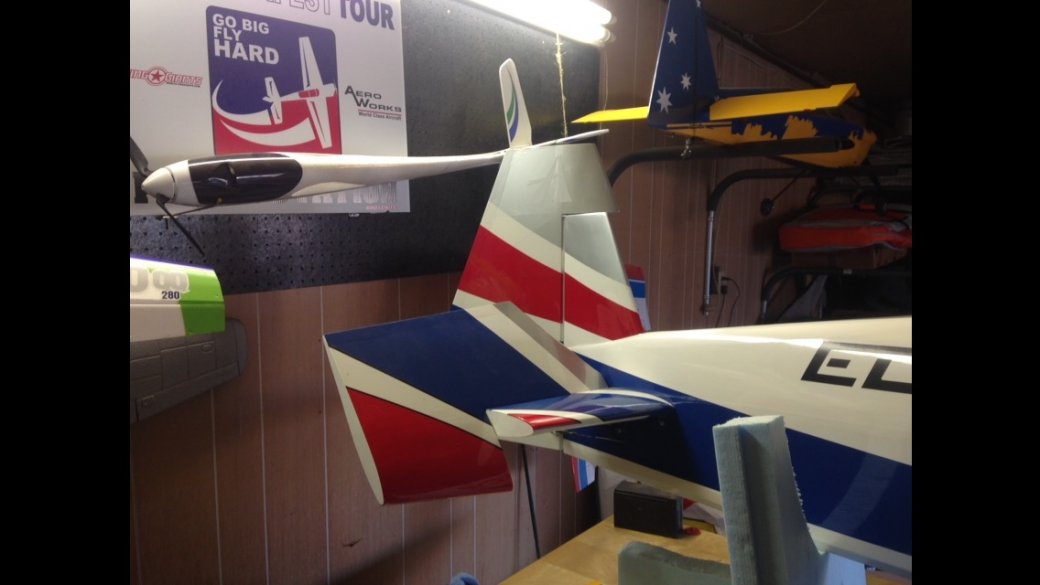

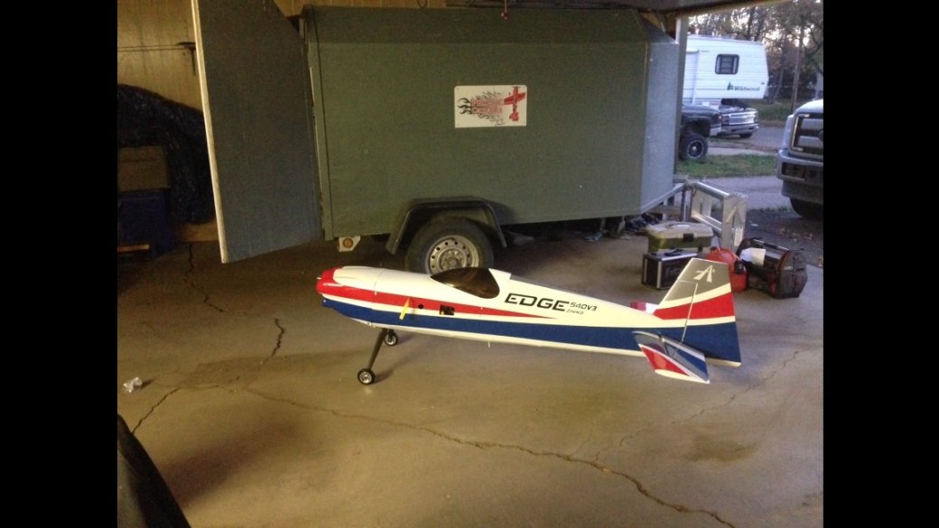

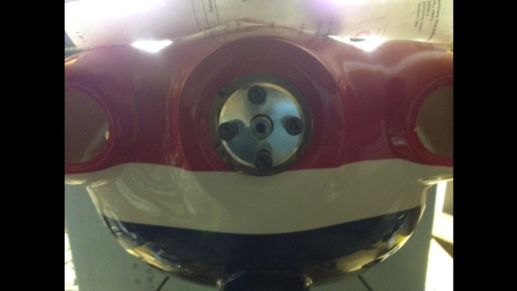

Well she done except to throw Lorne's Rx in. We're doing jr for the brain because Lorne always leaves it at the farm so we can both fly it. Not bad on the motor mounting only a mill or two off lol. She's big my 3dhs 92" edge mounts in the trailer won't work the rudder hits the roof. Maiden today weather permitting. My neighbour says 40k plus winds. We will see..

Well it flew wow does it rip. Short 2 min video later cut it short wind picked up to 40k as a storm rolled in lol. Still in one piece. 6900 24/9 only plus 4c out here today.
