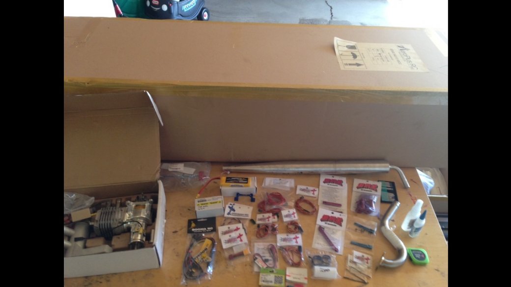

Most of what I need

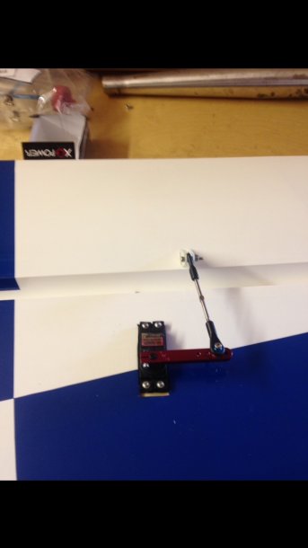

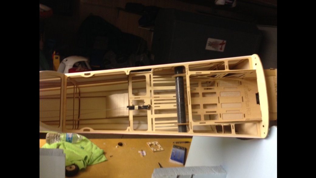

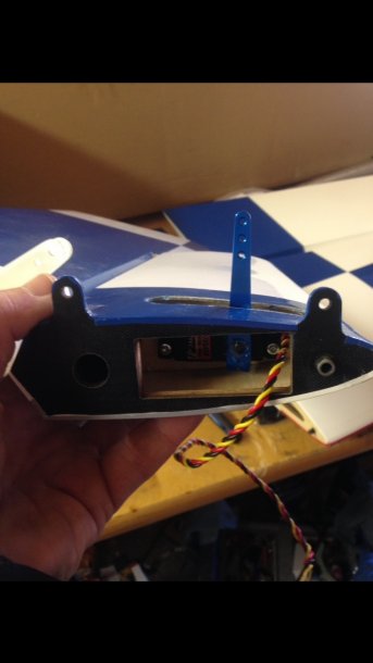

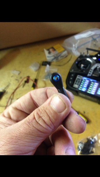

Got the servos in the ailerons and elevators tonight. Using some bling secraft ball links.
Take note that their fuses come with the covering cut out for your servo wires anti rotation pins and wing bolts.
The fire wall already has a couple cut outs for throttle linkage and fuel tubing, don't know if they line up yet.
Not a full pipe tunnel. So mods will be needed as I'm going full bore on the motor. A lot of pilot arfs are like this. If they would make a full tunnel it would be a 10/10 arf this makes it a 9.5/10
Carbon rods run down the bottom of the fuse.

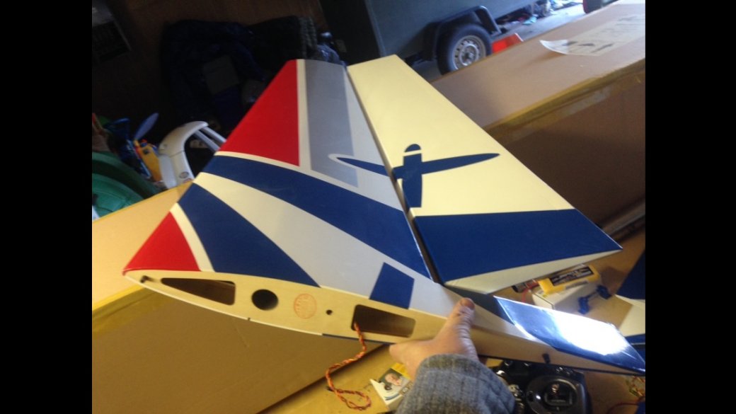

Pin style rudder attachment. Since this is a replacement fuse I have to glue the fuse side of the hinges in. Pretty minor.

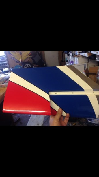

Biggest elevators and ailerons on any arf probably out there. There's almost no stab. On the 100cc arfs the aileron is almost half the wing lol.

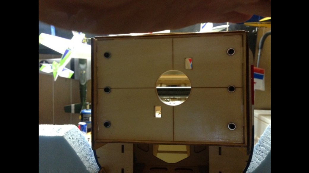

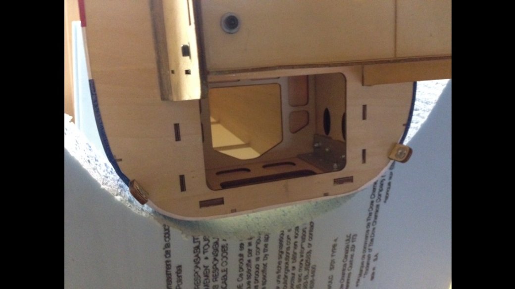

Got home before the wife today and glued the rudder hinges in the new fuse(I had wings and elev from another plane not mine. And got a new fuse. Normally the rudder is glued already and you just have to drop the pin in) drilled the motor mounts out. And was checking to see if I have to flip the carb and that's when I found out there is only one pulse port so I can't flip the carb. I hate mounting a servo way up in the fuse lol. And I grabbed some new wheels on the way home. Well wife's home parenting time

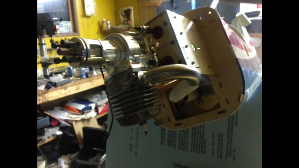

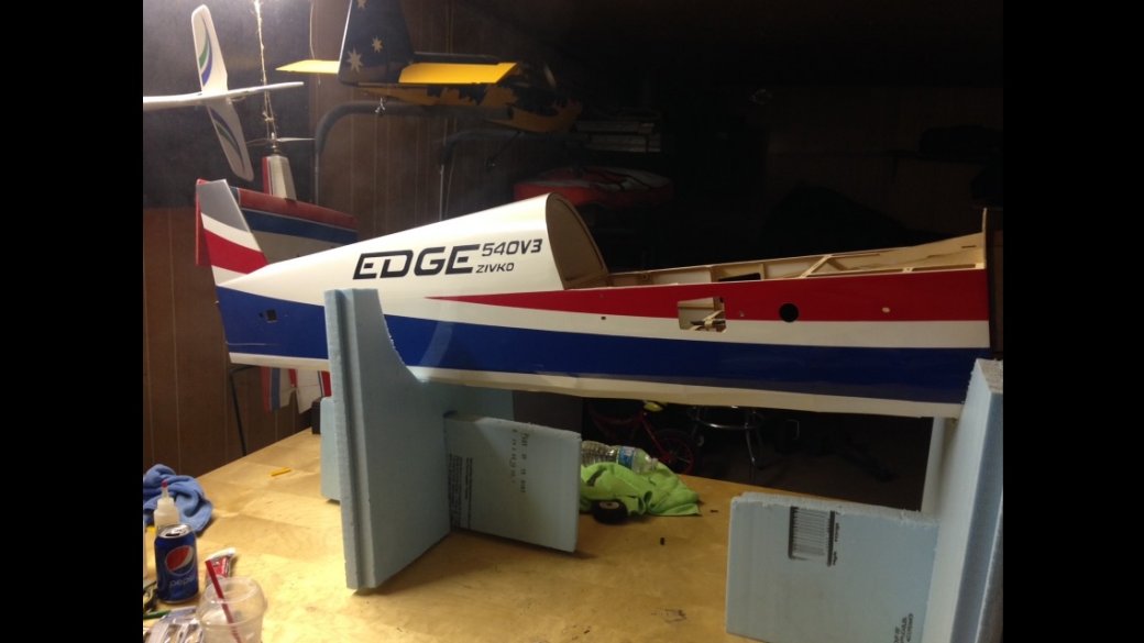

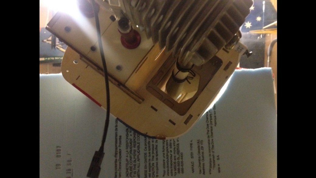

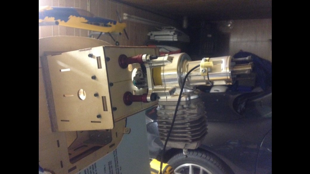

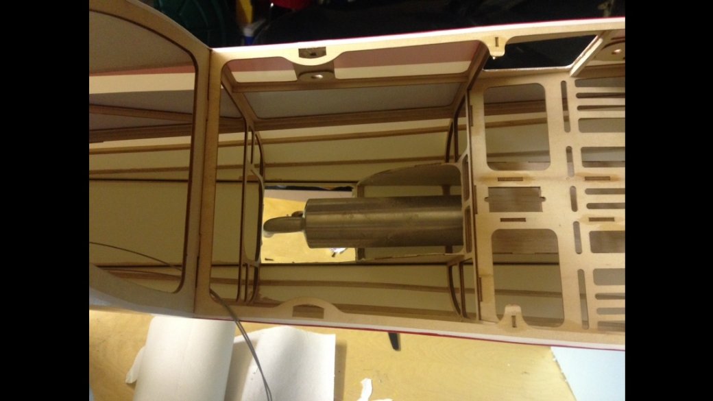

after the little one went to bed I got the motor mounted and header cut. Dry fit the pipe. Still have to pin it and glue in a mount. Bit of work to shoe horn the pipe in, but do it carefully and it works. You can see what I had to cut out to make the pipe fit
