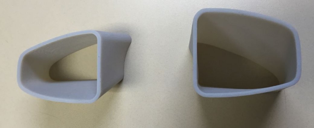

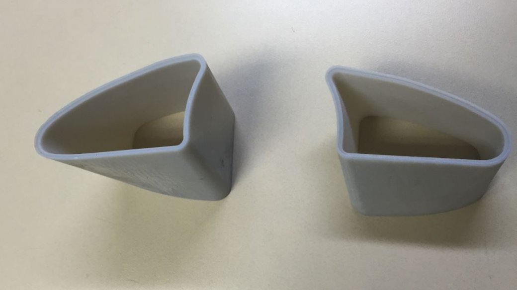

Pulled off this morning the first go at my baffles for my 91" Extra w/DA-70. The front inlet contour I already matched with a simple straight extrusion and that fit pretty good. As you may have seen the cylinder sits lower that the inlet and due to the offset motor mount tilts off to the right. I made these blend into both shapes. One view is the front and the other is the back. In the back view you can see that the shape is bigger to match the full area of the fins. A little optical illusion makes one look larger but that is because it is longer and closer to the camera. Can't wait to try it tonight, but leaving for a business trip for several days so won't get much more done.
