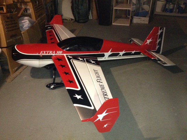

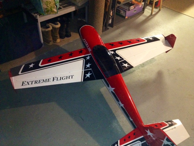

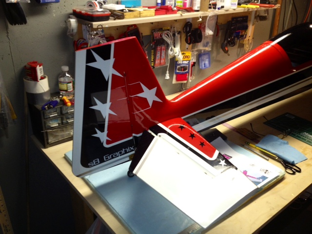

dth7
3DRCF Regional Ambassador
Thanks, yes it is "star struck". Santi gets credit too. I am proud of my first "real" vinyl application. Thanks to Rapid RC for the samples.

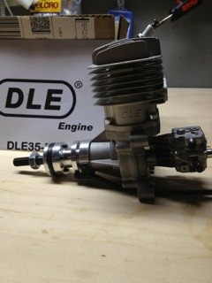

Engine mods done! Thanks for the help Cody.
Single shaft prop adapter
Reed housing sanded smooth
Bowman ring installed
All gaskets sealed.
Ready to mount.
