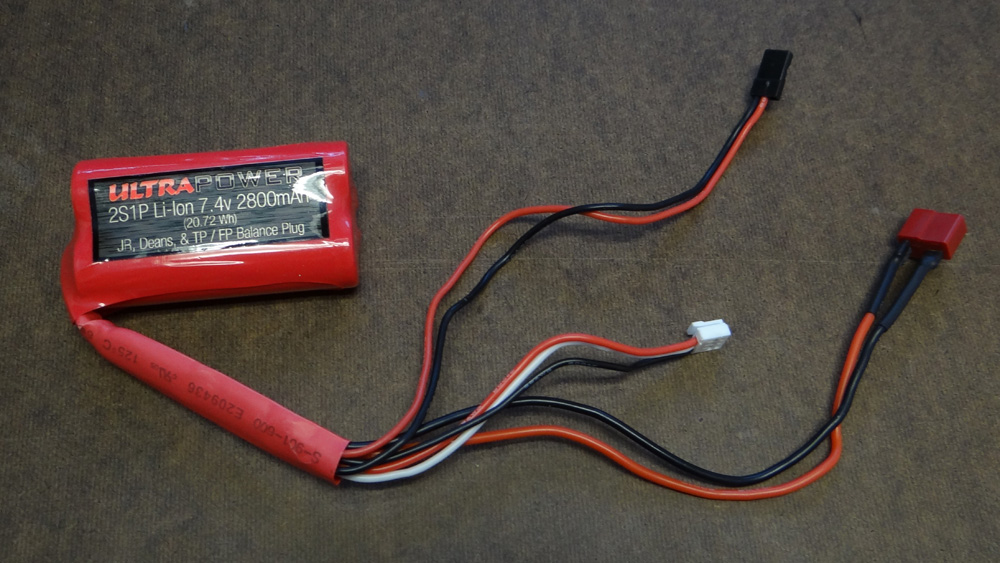

1) Run unregulated 2S Li-Ion battery to receiver.
2) I'm using 4 HS-5565MH servos (control surfaces) and 1 HS-5665MH (throttle) servo which are all rated "High Voltage"
3) I'll use an Ignition Battery Eliminator Filter (IBEF) with opto kill switch to power the ignition system.
