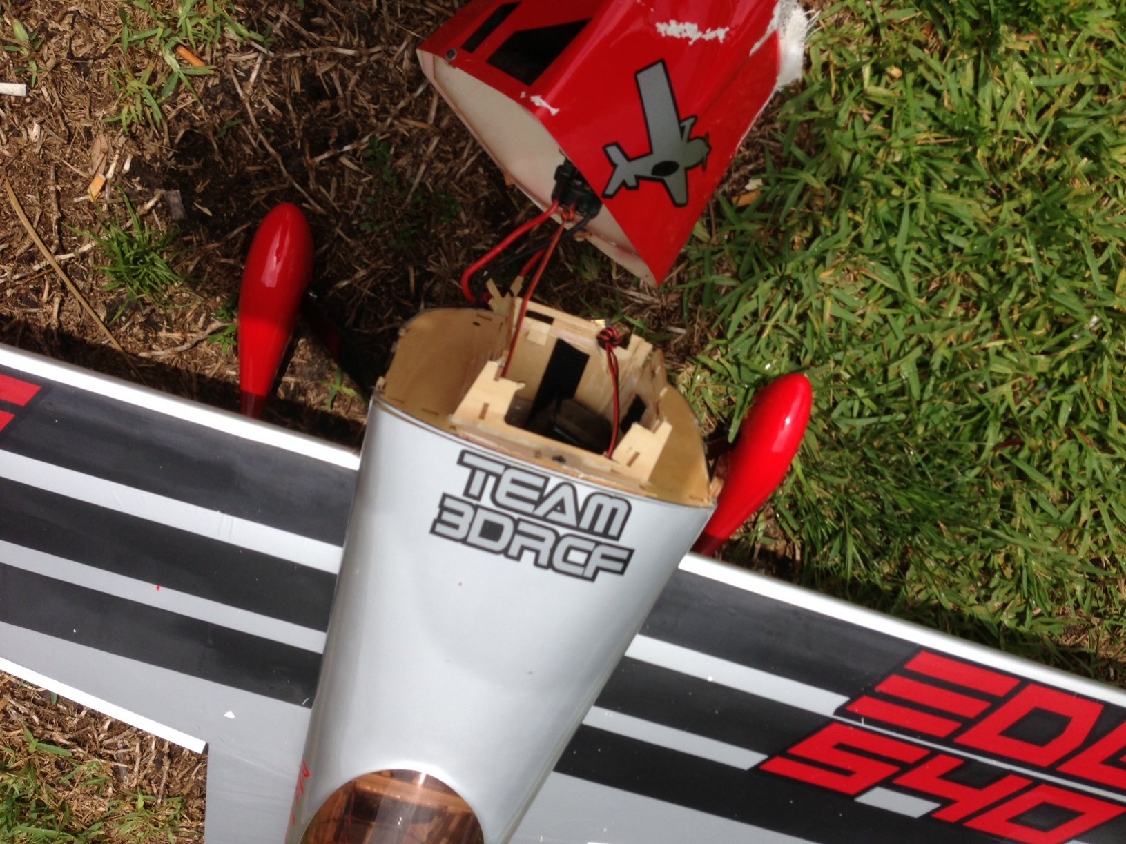

74" edge RIP...
Immediately after take off i did a half roll followed by a negative wall and then...
My motor box broke in half. This caused the esc and bec to separate from the battery.
The plane hit nose first on the concrete runway...
:crying:
3dbandit
Pics...
One of the wings has some pretty bad dents and cracks, the fuse is buckled behind the canopy, and the cowl is destroyed.
