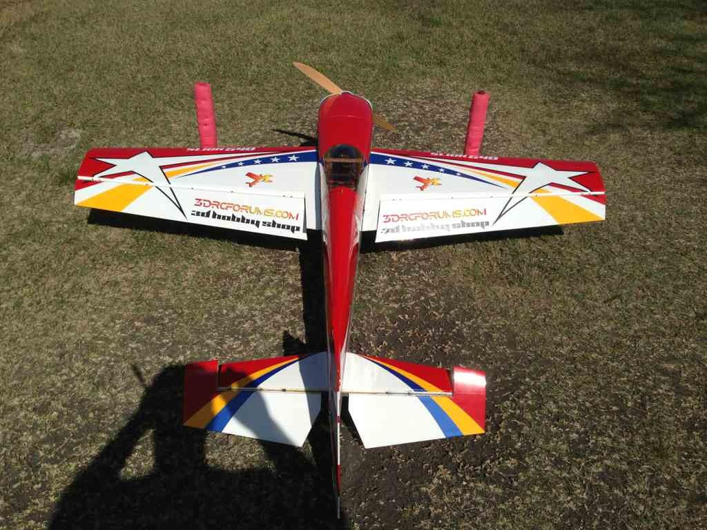

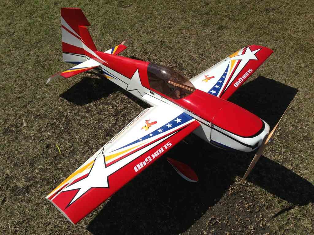

71" AJ Slick Building, Flying, and Questions
Flew my "new to me" 71" Slick today... very pleased overall. It was the first flight on a brand new DLE30 with a Bisson Pitts muffler, and I used the VallewView RC pre-drilled 20x6 prop. Everything went very well. Started with the needles at 1.5 turns out, and started up very quickly! stopped the motor, made a few adjustments, (x3), then when I was relatively certain the engine at least wouldn't quit on me (no, she's not tuned well yet, but hey, this is my first time with a new motor) I took her to the air. All in all, I got two nice 12 minute flights. The first flight was very gentle, and didn't do any 3d, just some rolls and some KE flying. On the second flight, had a tiny bit more fun, and did some cuban 8's, rollls, loops, inverted circuits, and one short crankshaft/lomcevak. In-flight temps were 175-190 with the thermocouple around the cylinder head, and spiked to 225 briefly after shutdown.
I outfitted her exactly as described above (http://www.3drcforums.com/showthrea...ng-and-Questions&p=23173&viewfull=1#post23173) and I'm really happy.
The only thing I noticed was a little bit of tail wag, and I'm not sure if that was due to a setup error, or the 5-8kt winds. I'll have to investigate.
-G
edit: forgot to mention, CG was spot on, just a touch of nose down for inverted flight. Also, controls were nice, with only a few clicks of trim on each control to get her trimmed up.
