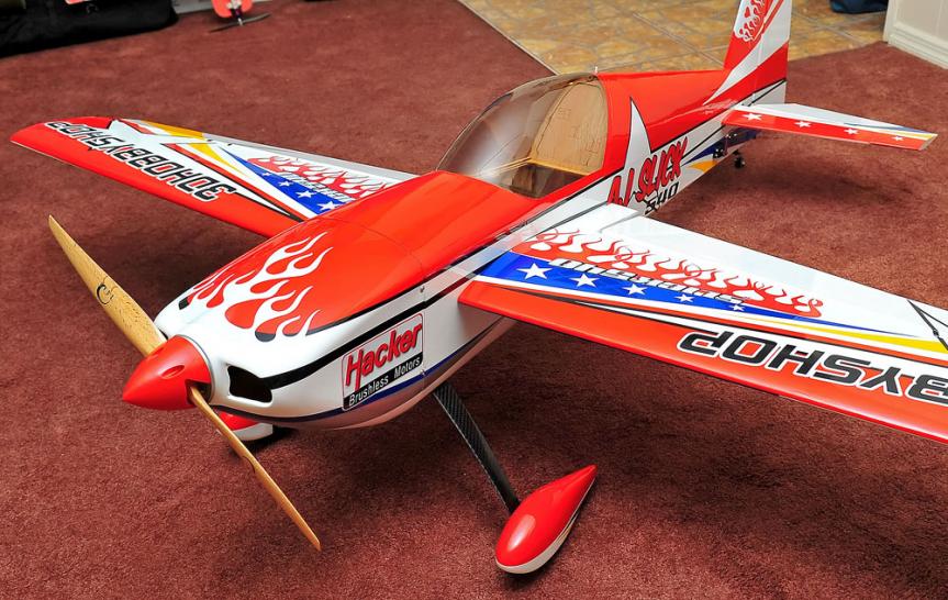

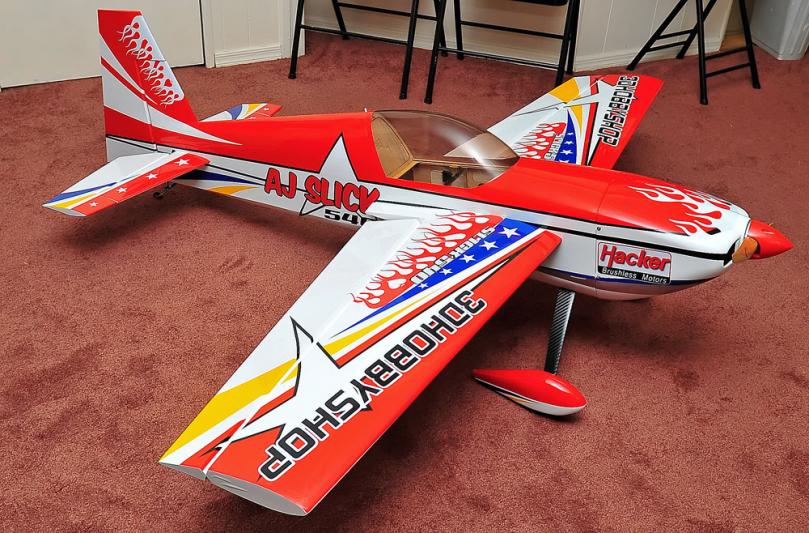

  1. Right now this is my favorite airframe in my hanger. Here are a couple of photos of my 71" AJ Slick in red. It is a gas version converted to electric.
    Here is my maiden flight. It is nothing fancy since I was quaking in my boots. I have gotten much more ballzy with it now. I still need to fly her more but I am getting more and more confident with each flight.
