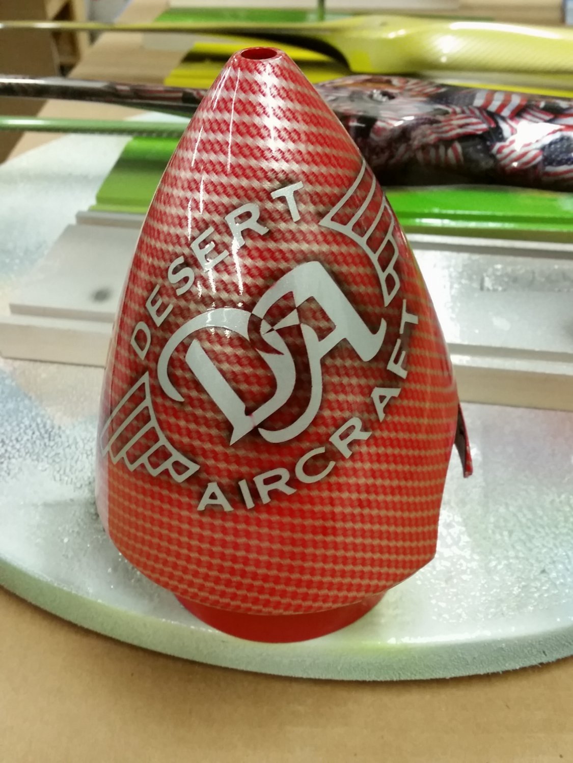

That looks absolutely great nice work. And I looked as hard as can at the pictures to see if there was any bleed on the taping could not find one that's good. Like to know how you did that please give a small how to on that. Thanks.
If you're getting bleed with base clear, you are hosing it on too thick or you have over reduced......or your using the wrong reducer.
That and you really need to watch the shrinkage on blue Fine Line tape. It will shrink and pull up on a sharp curve if your not paying attention. That and it likes to bridge up where it overlaps another piece.
Good point, I got bit by that this week. Little bit on this compound curve bunched up so small I could not see it. No touching up though, would likely make it more noticable.

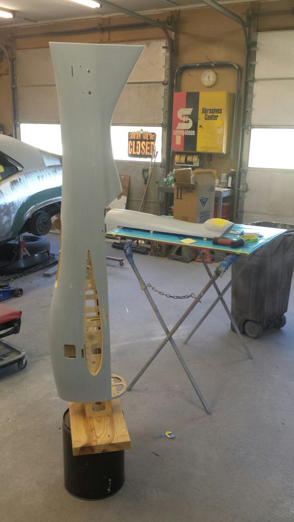

I guess the day has come to start doing some painting. I brought everything but the wings to work with me today so I'll see if I can get something accomplished.
I'll start by getting all the edges masked up and then spray some white on everything that gets either white or red. Spraying white under the red will make it cover much better. When the white is dry I'll mask off the white stripe and spray all the red. When the red is dry it will be time to mask again and spray the black.
Being a holiday weekend it's the perfect time to do it. The problem is it's also supposed to be REALLY nice this weekend, so I'm going to need to get at it if I'm going to get this painted and go flying!
