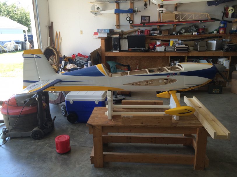

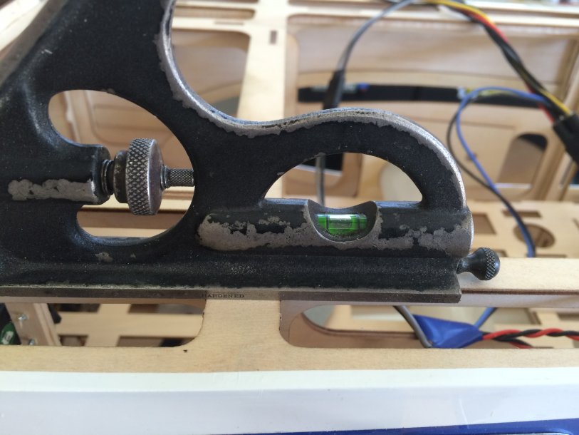

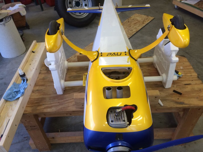

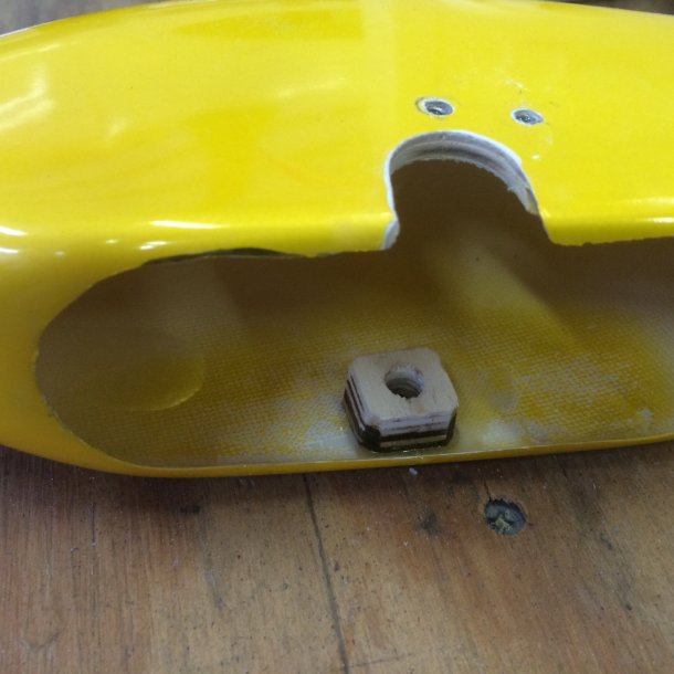

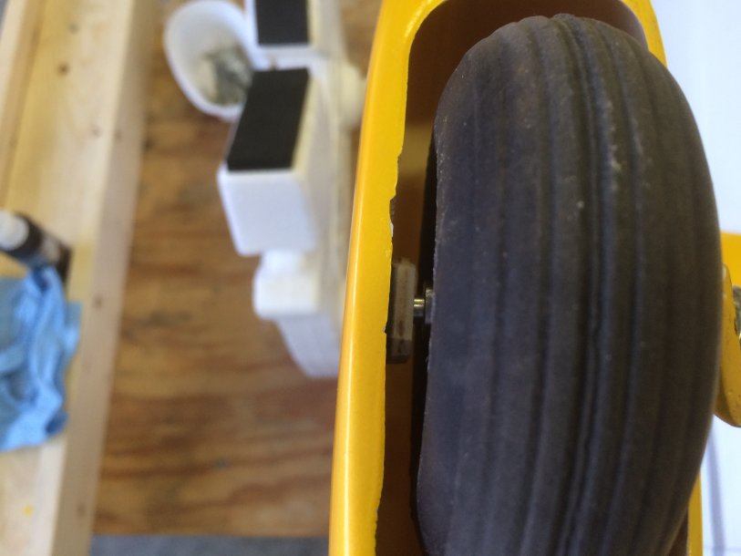

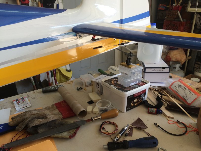

..............This is one way that I found to make the wheel pants come out even and in the right orientation.
Great point, this is how I do mine as well. Always hate when I see a plane at the field and it's sitting on the ground with the pants level to the ground. Then when it's in the air the pants are aimed towards the ground!!! That and a jacked up cowl cutting job are my pet peeves

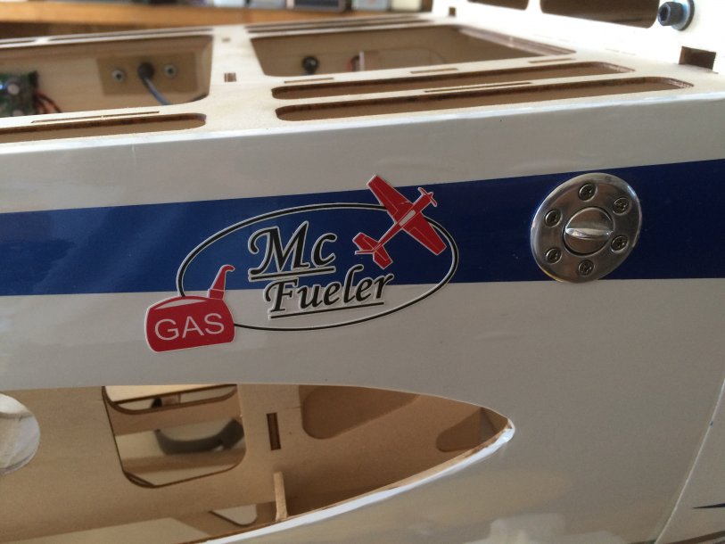

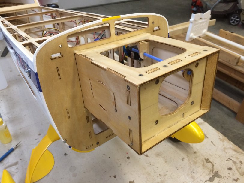

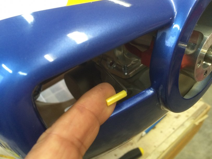

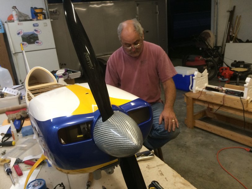

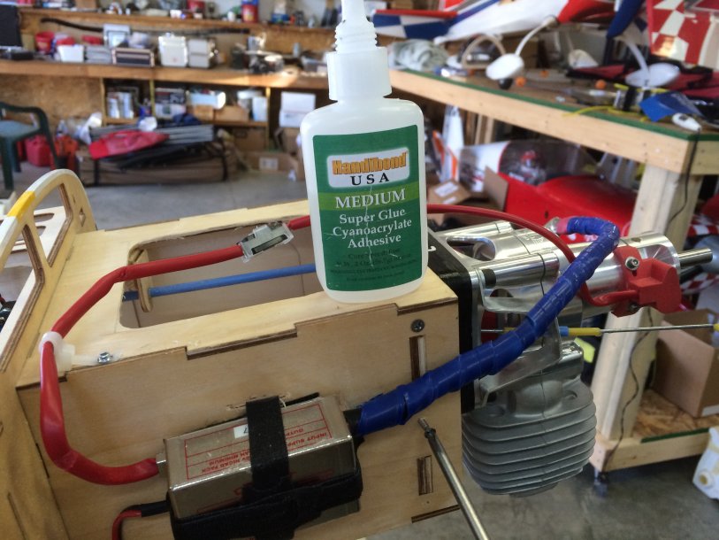

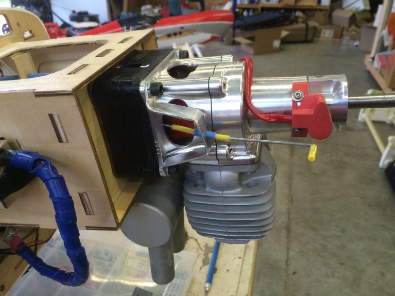

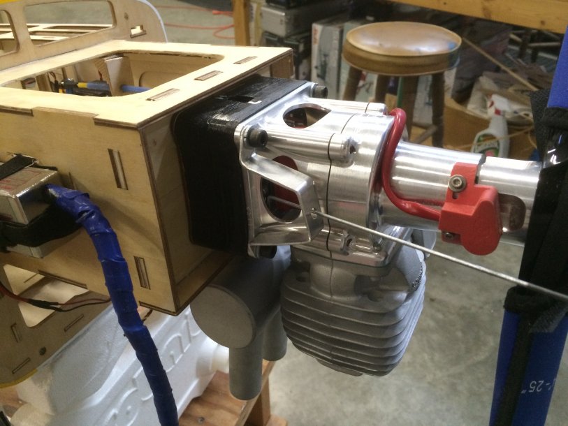

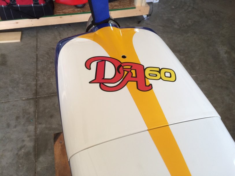

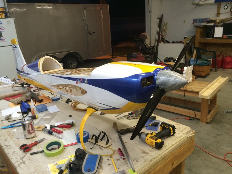

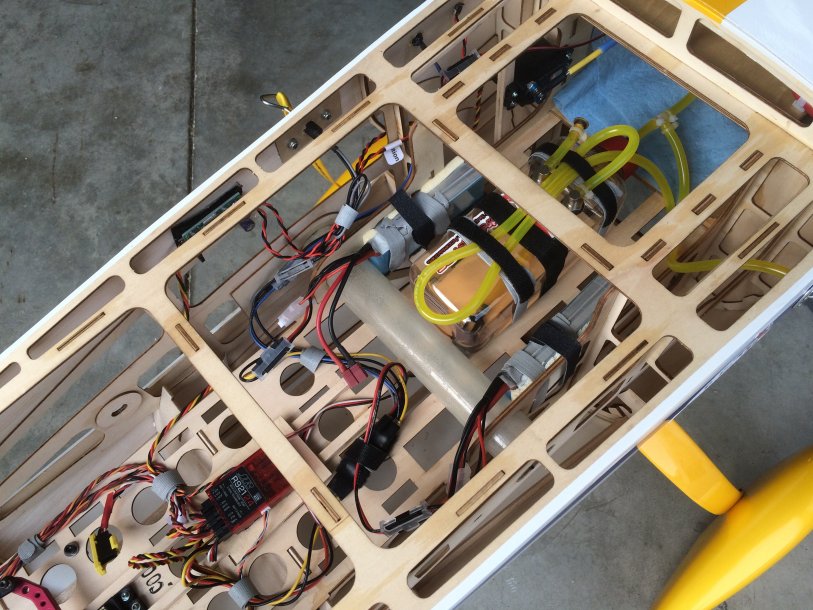

Found some time to work on Art's plane again. This time we pinned the firewall with some flat head screws. I like these better then wood dowels. Then we fuel proofed the firewall and the Engine compartment. Of course before we got started on that we had to put some Bling on from B&E Graphics. We are running out of the tedious stuff. Before you know it we'll be ready for final assembly. For those of you who don't know. Handibond Glue is owned by Herve. It is 100% US Made. You can get your glue fix straight from PAU.

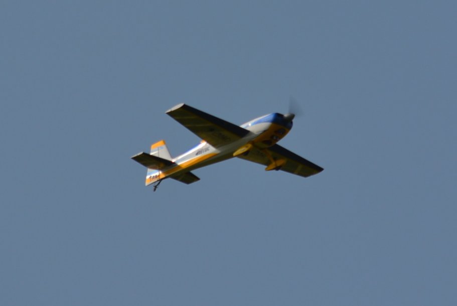

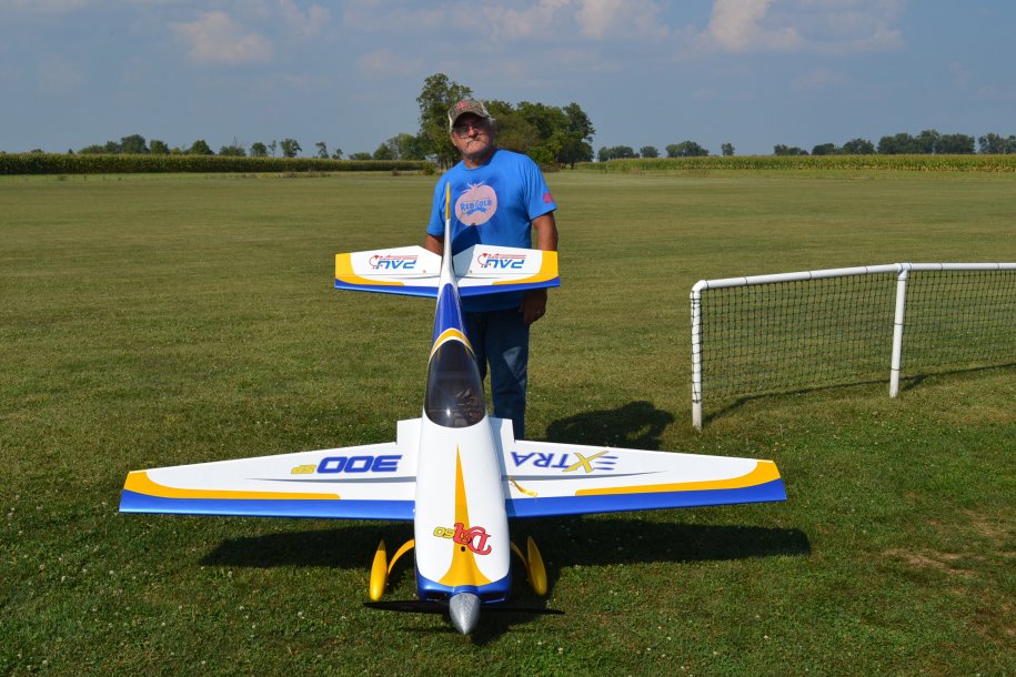

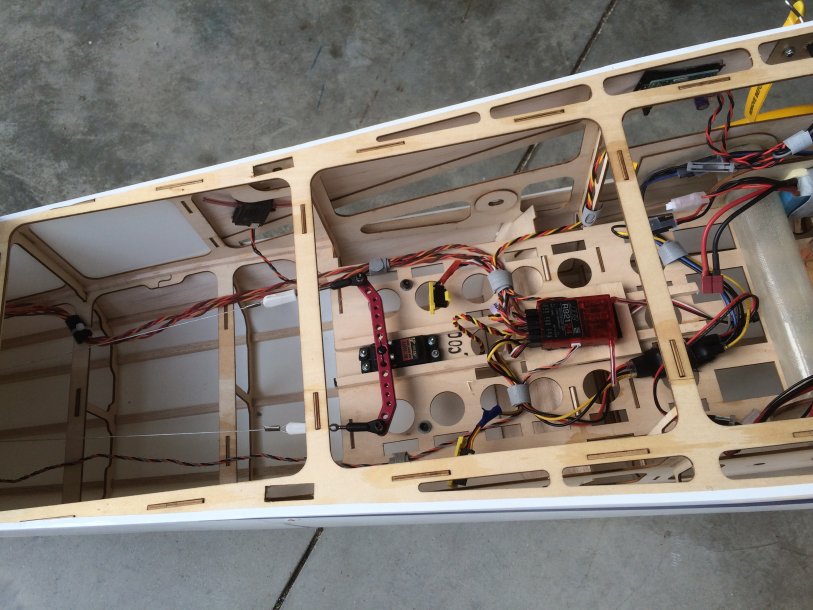

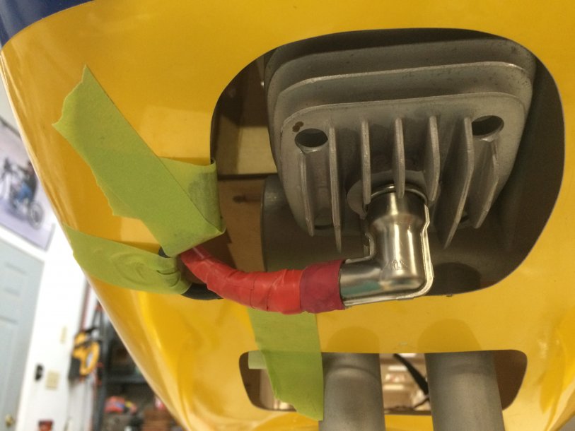

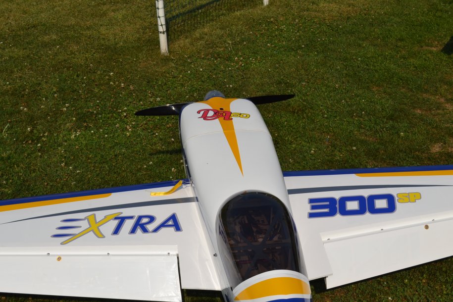

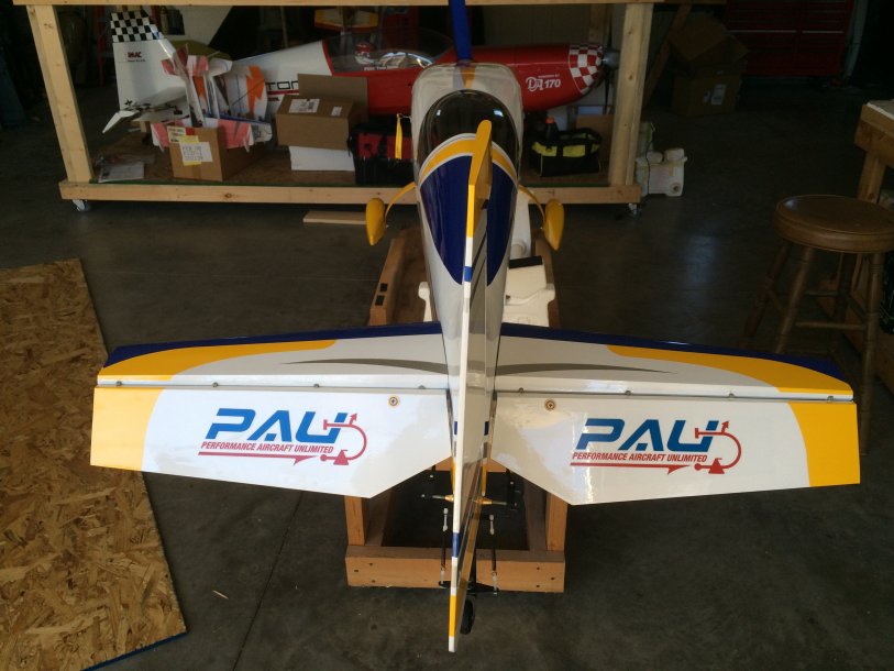

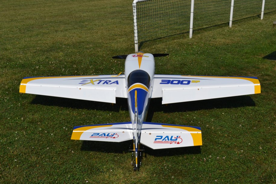

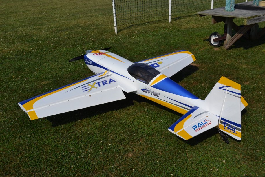

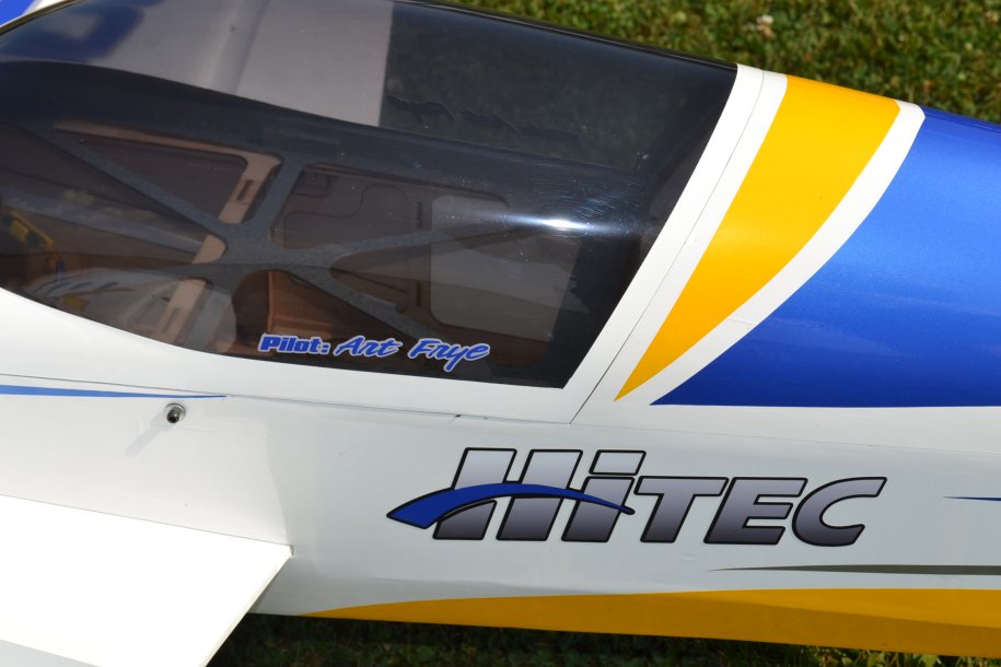

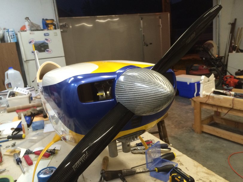

Here is an update on Arts Extra. It's Flying and flying Great. Sorry about not updating sooner but I hop you like the pictures. Sorry about the double pictures. I don't feel like sorting through them so your getting the whole build right here.
The graphics ar from B&E Graphics.
