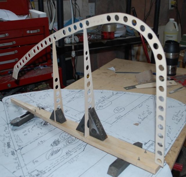

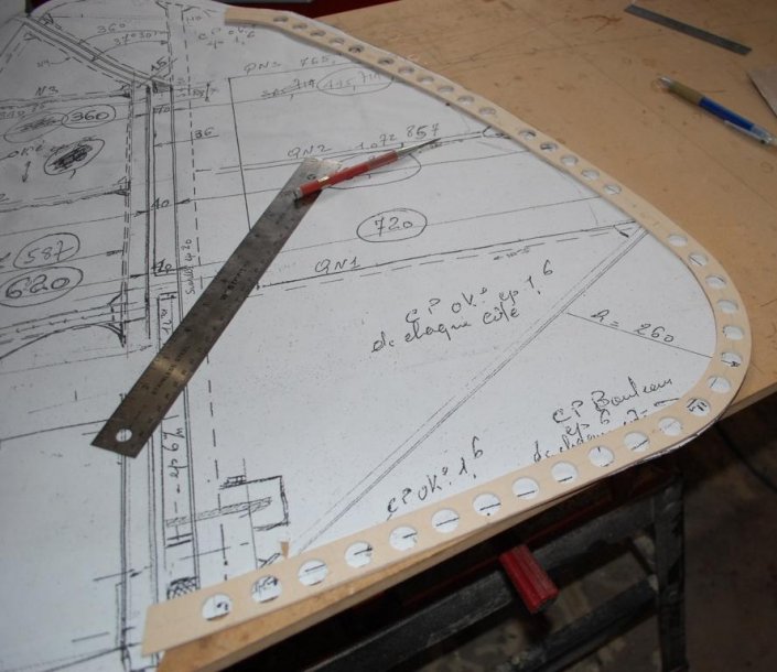

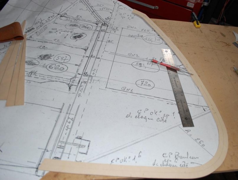

working on the fin and preparing the engine for welding

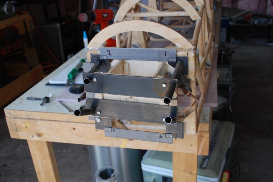

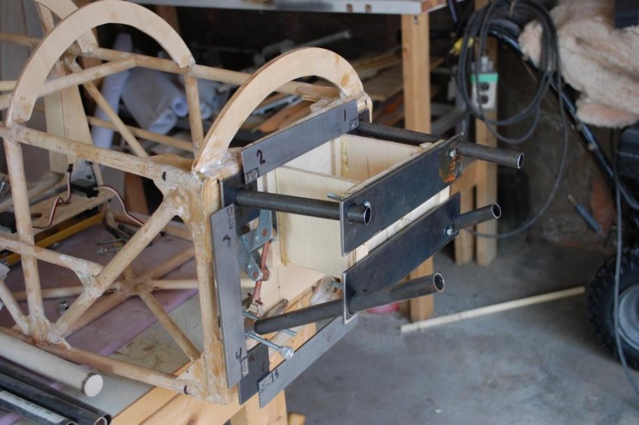

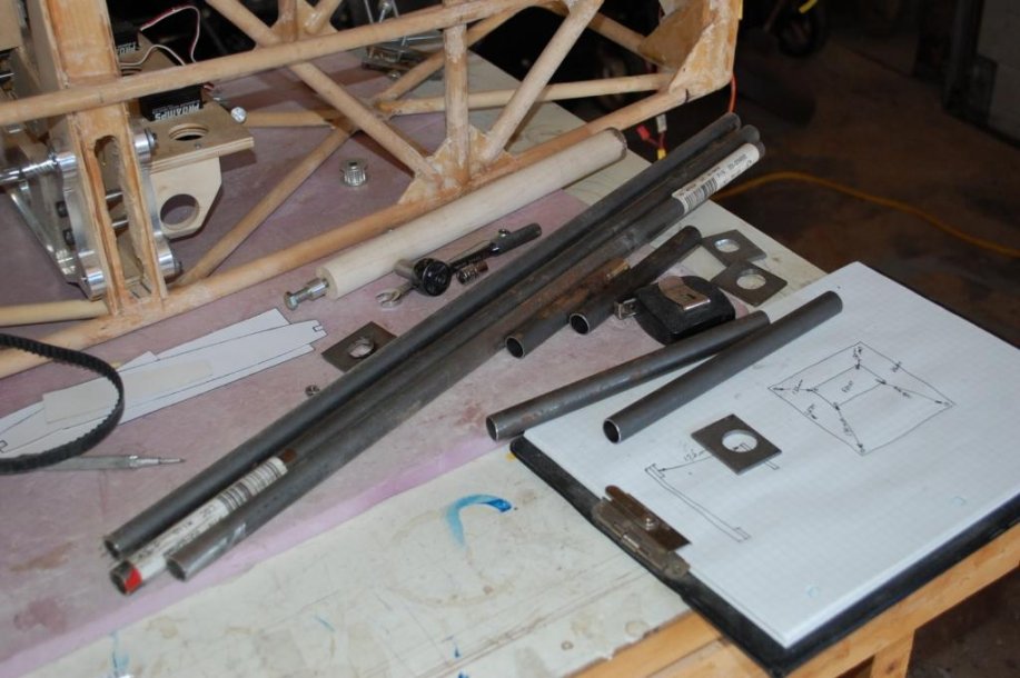

working on the engine mount jig , once tubes are welded in the proper place, then I start removing steel parts not needed

Interesting! Care to share your thinking regarding this construction method, vs the wood motorbox? Thanks Roger!
it has t do with scale, but the wood box you see here was just a setup to line up the engine properly, now that it is, I just need to fill in the blanks so to speak. It will be mig welded by my neighbor, he is an expert mig welder.
Pistolera
HEY!..GET OUTTA MY TREE!
Thanks Roger. I kinda figured the wood one was temporary. Do you have any idea on the weight of a wood, vs welded tubing motor mount? Of course once it's done I suppose we'll all find out, eh!
