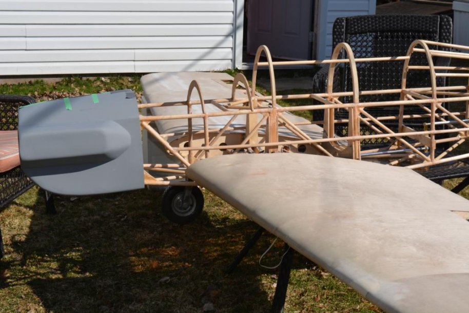

I have been working on this project for a year so far. I took a look at the blue bird servos. I think you are right about using one, this way I can use the scale cable set up for the control services.

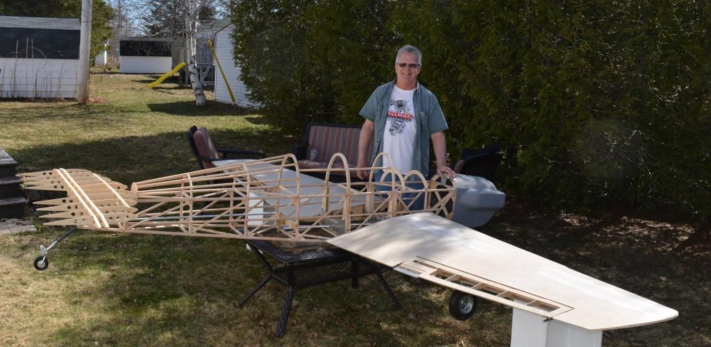

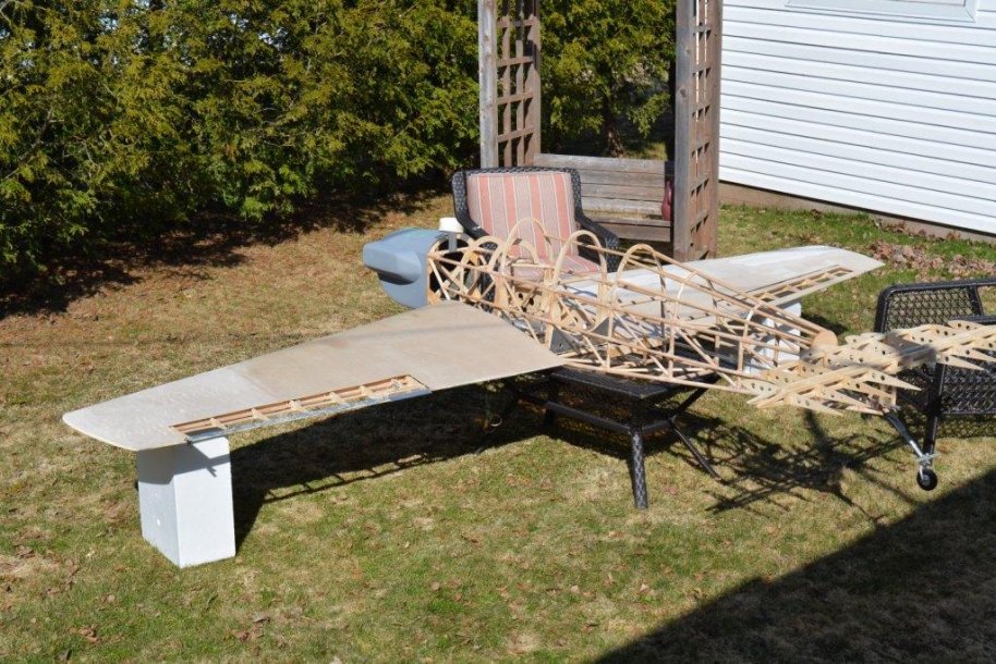

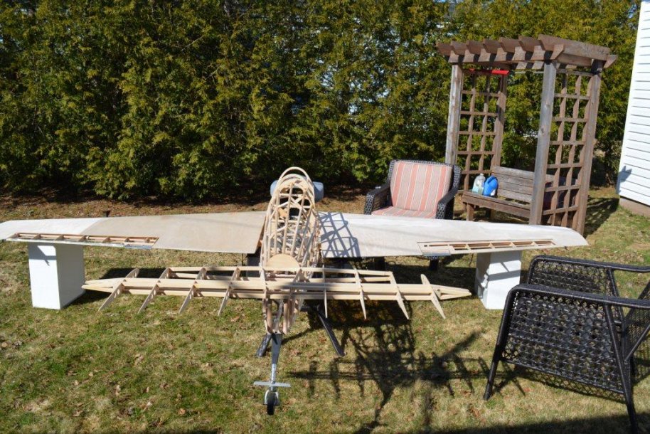

loosely trial fitting of the wings, cowling, and horizontal stab.
