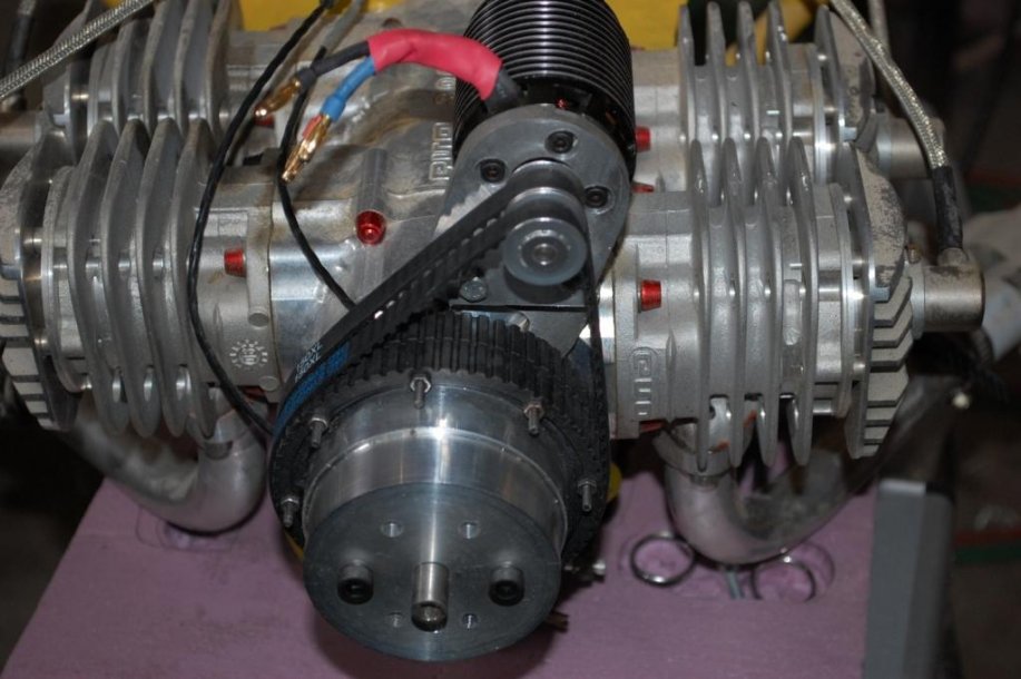

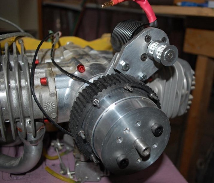

finished properly mounting the starter/alternator, need to reorder belts,

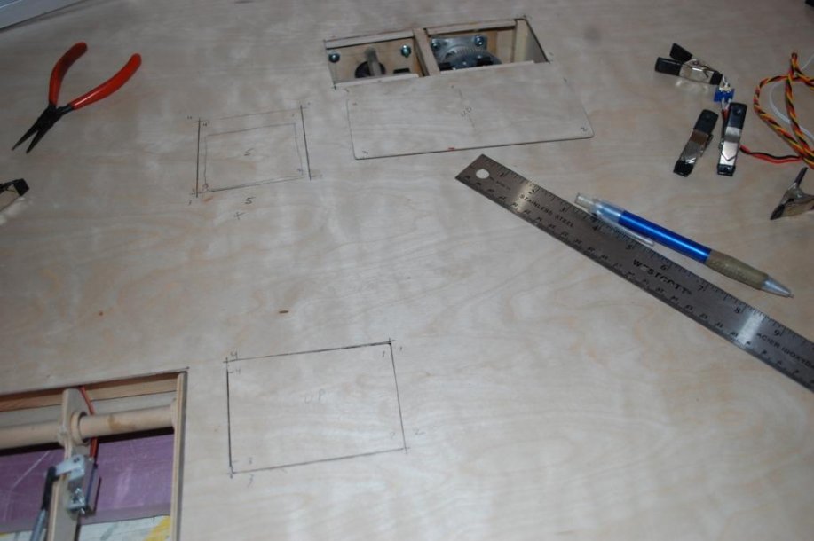

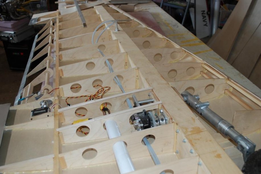

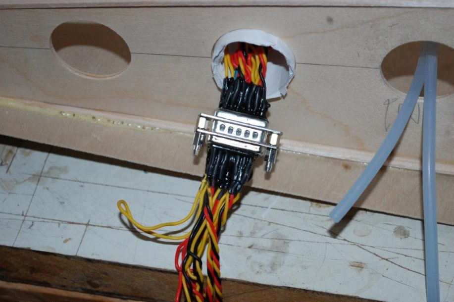

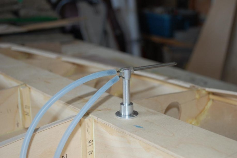

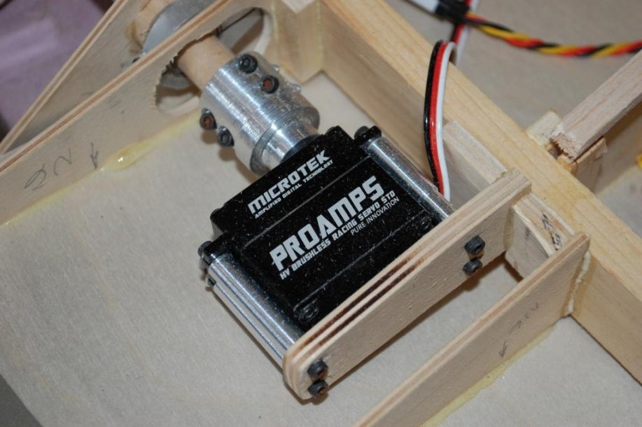

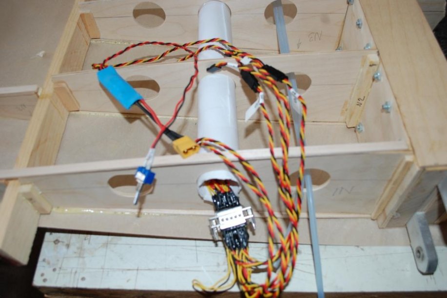

the last two days been preping the wing for the bottom sheet, fine sanding of the ribs to make them equal height, installing the wiring, and in these photos, there still one set missing the "gear down sensor wires", the airlines for the pitot tubed, , sorry about at least one photo not properly focused ,

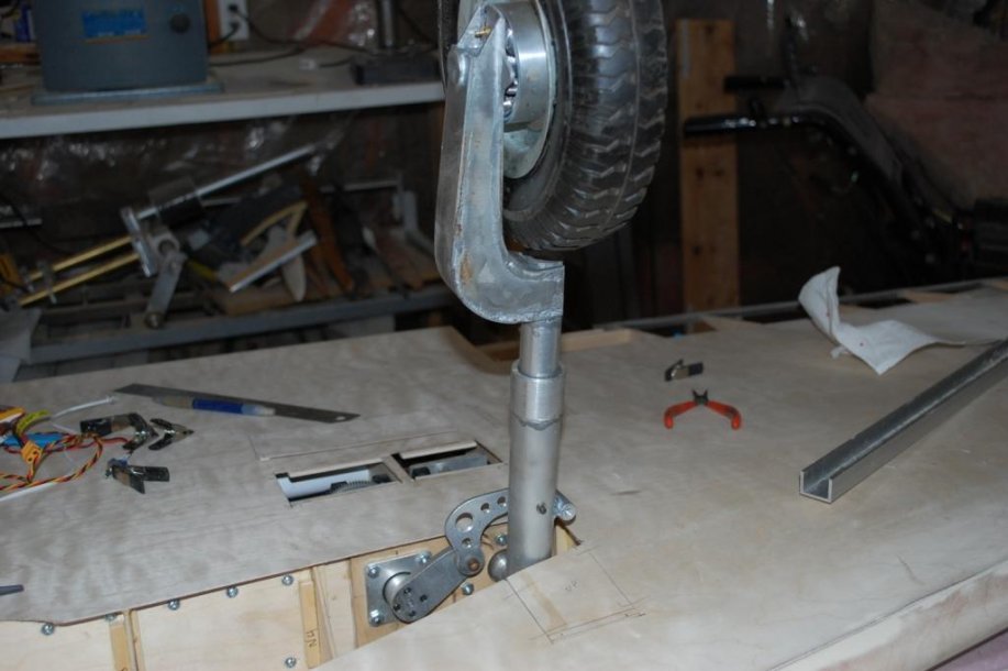

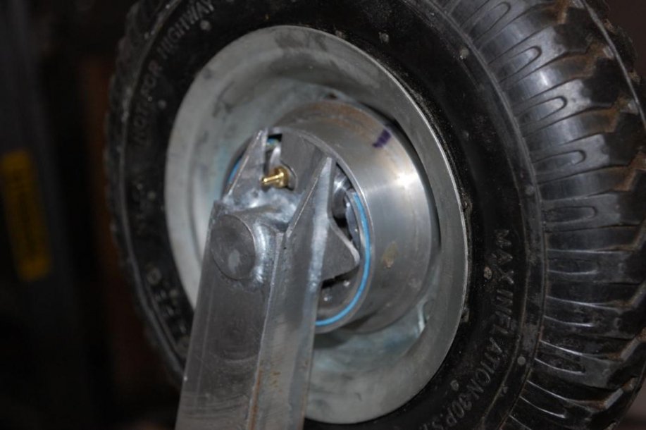

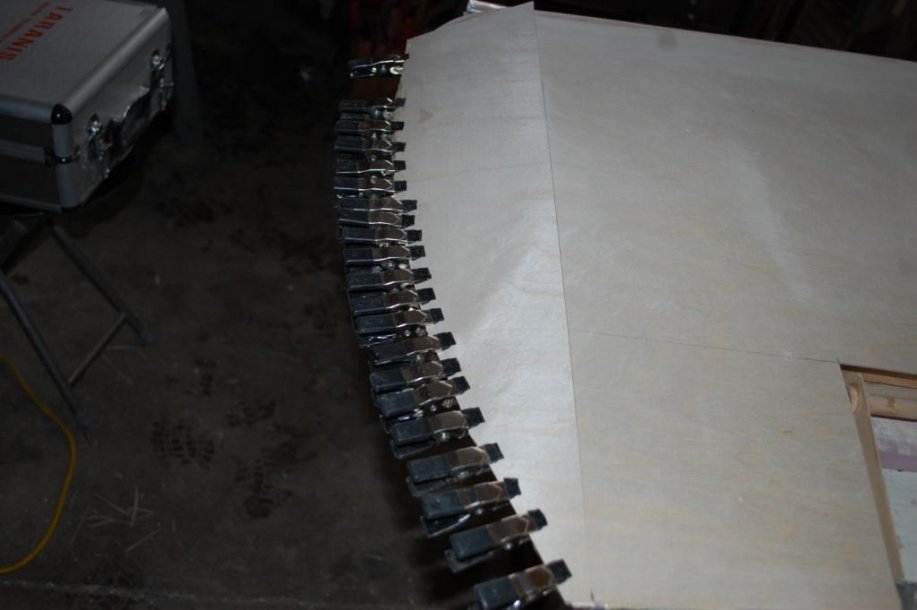

got the proper belts for the starter/alternator, still waiting for the proper ESC but its in the mail, changed the brake pads, worked on the hatch covers, wing tip also, getting there

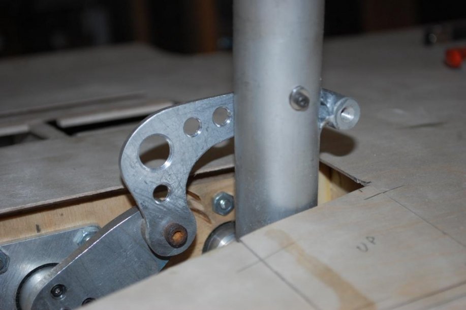

Roger....what the hell is that rust doing inside the bolt head?!?!?! You been plowing snow with it? ;)
Just yankin your chain of course....awesome work as usual! :cheers:
hahahaha it was the only one I had at this time, need to stock up, as for snow, we had absolutely nothing left for the past 1 1/2 months, last night had a snow storm, ouch, , but its coming
