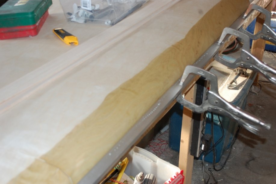

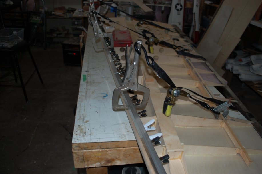

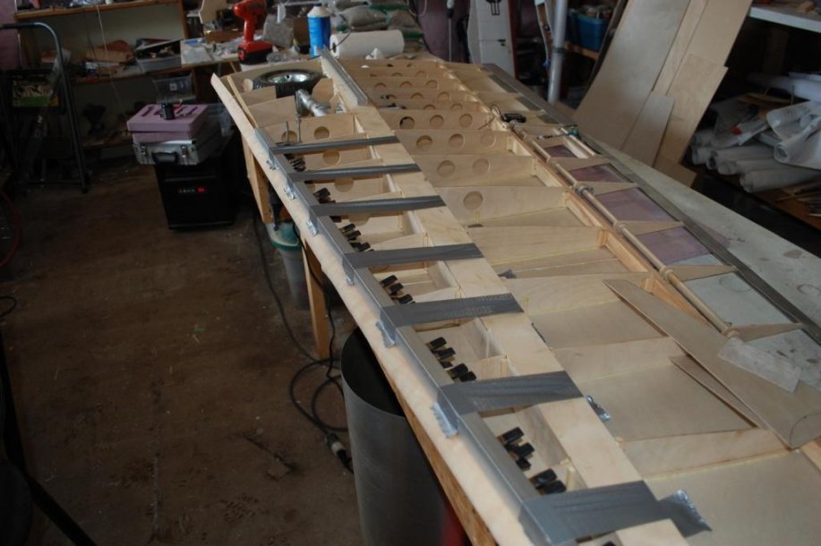

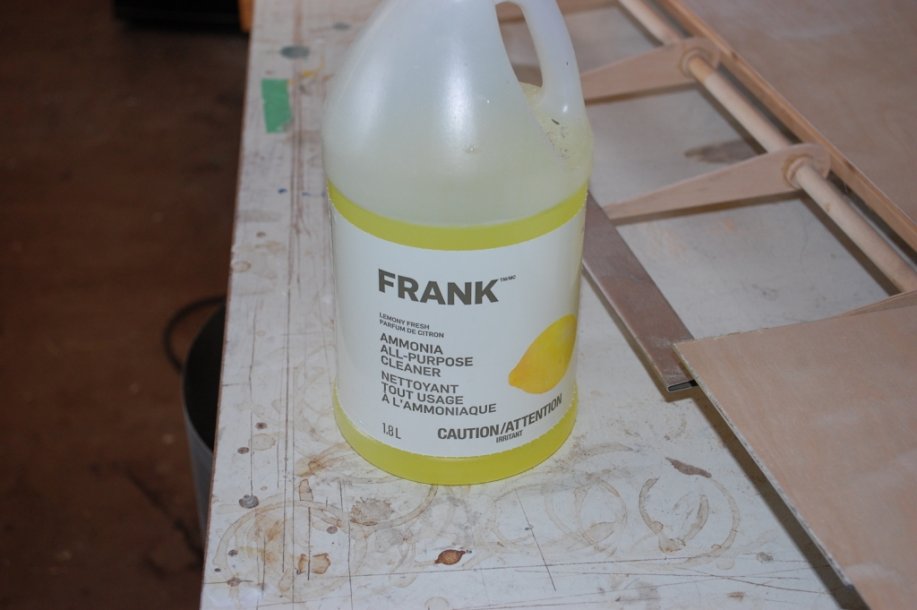

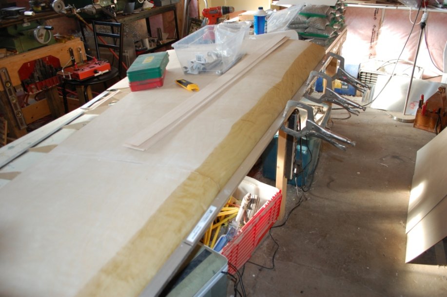

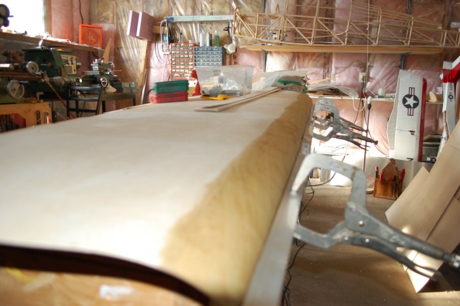

still working on the top sheeting bending with amonia

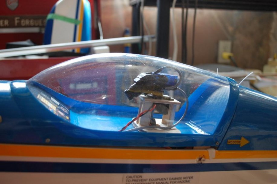

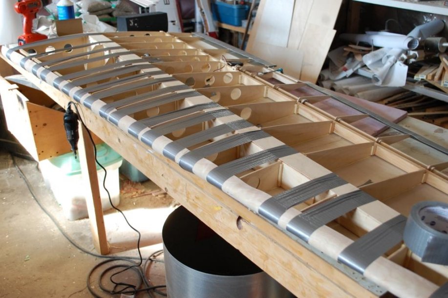

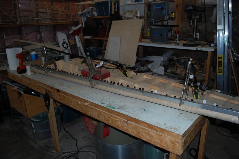

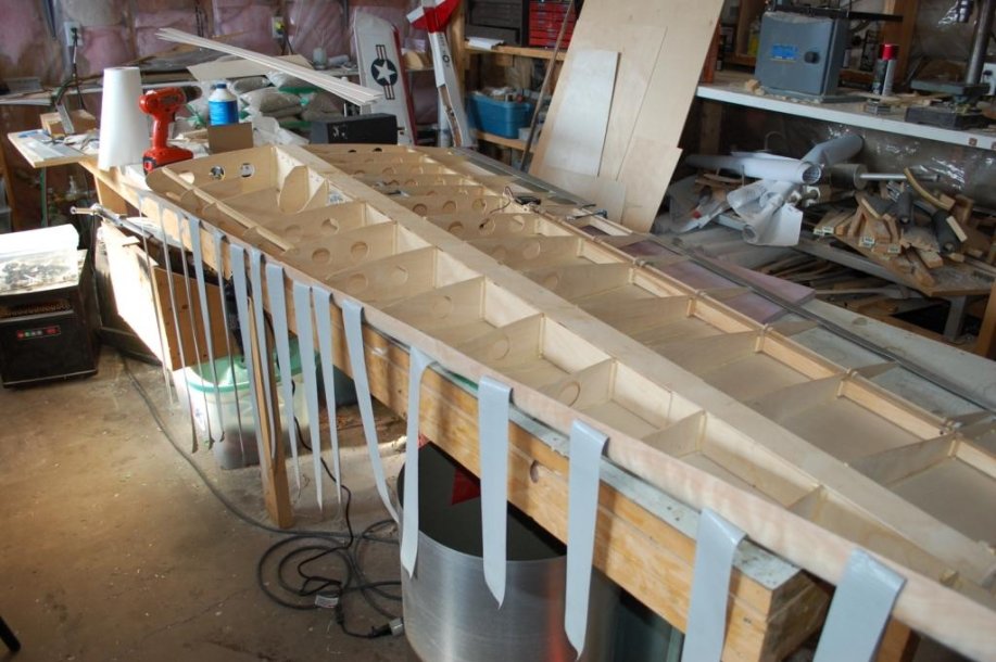

the last part of the leading being glued, that wasn't easy to say the least, also, the picture of the little extra of the canopy is the head tracking camera I have installed for testing should be fun.

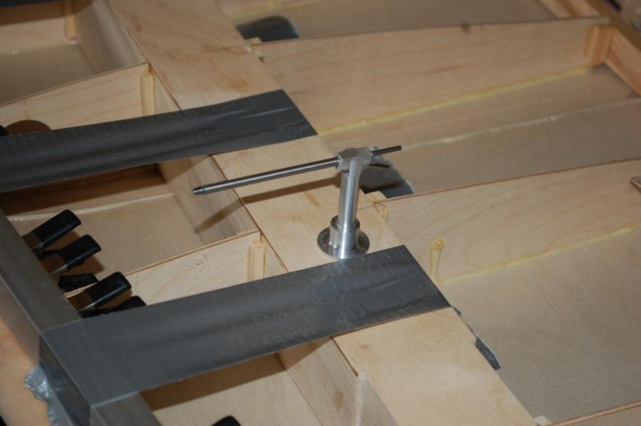

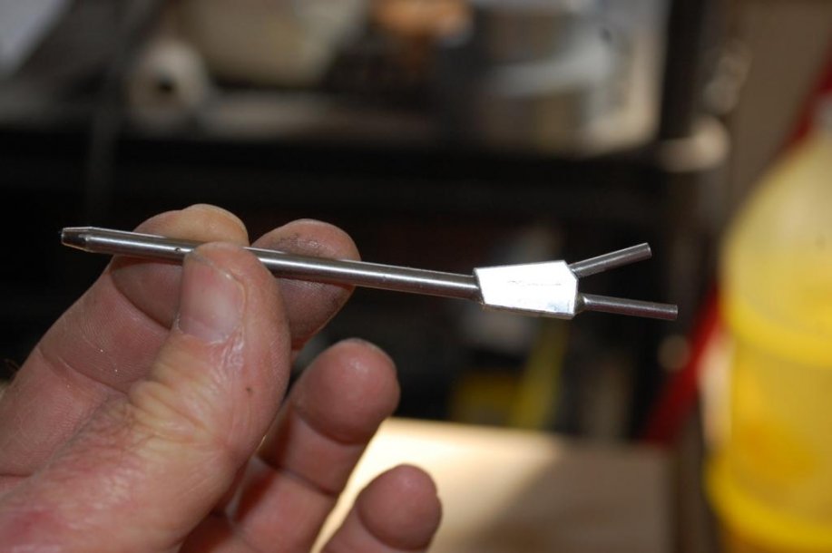

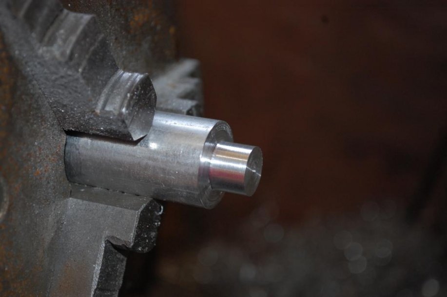

Then last but not least, making an installation for the Pitot tube on the bottom of the right wing.
