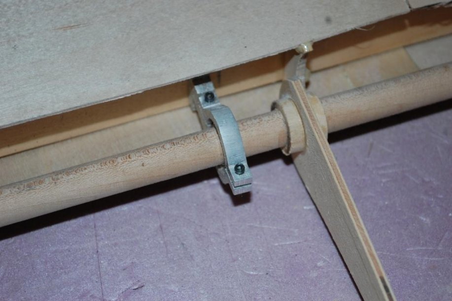

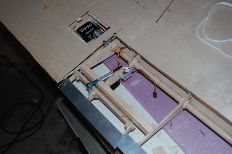

Between working on the brakes, the voice control, etc. I still need to do some work on the actual airplane LOL so today I started on the wing tip and sized up the spar joiner which will be in the fuselage of course

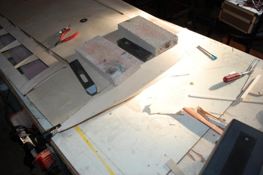

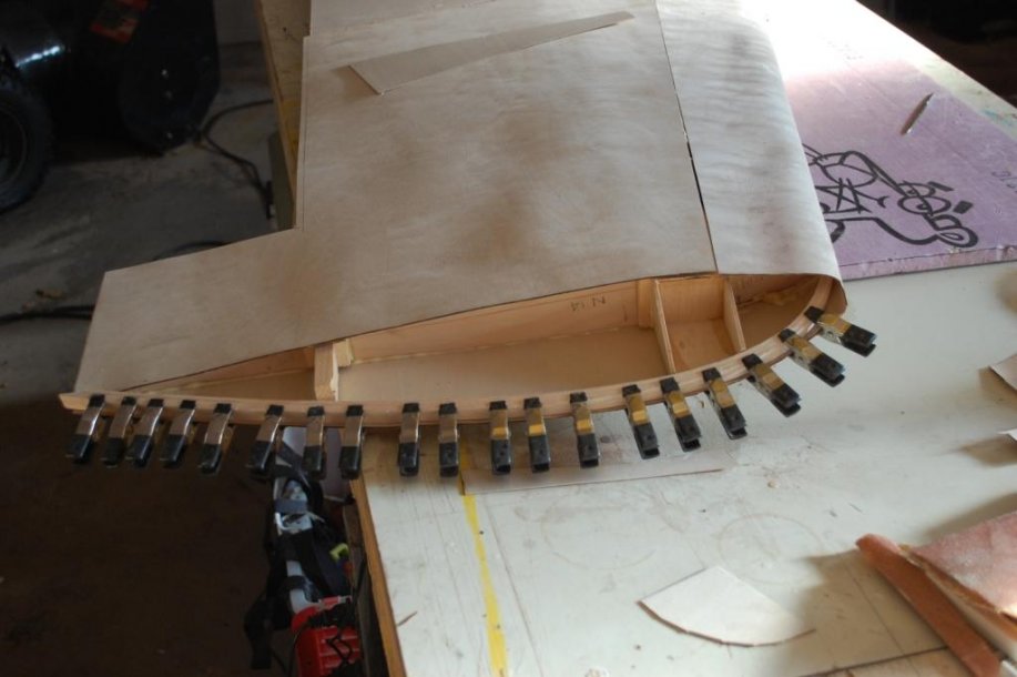

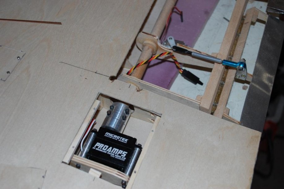

installed a small lip at the wing tip, , will need this for the flush mount of the 1/32 plywood, also trial fitting the the aileron before covering the aileron, to make sure I can reach every thing once covered,

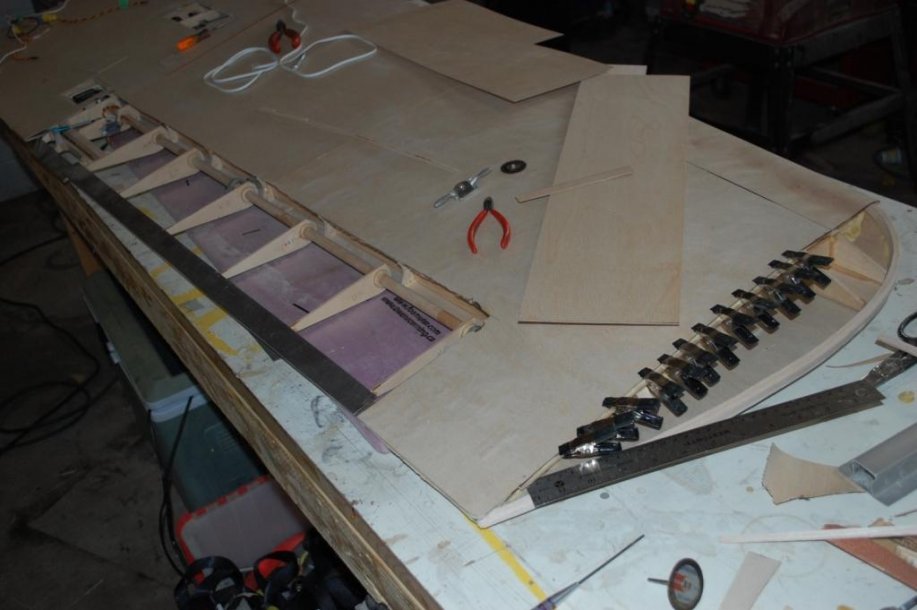

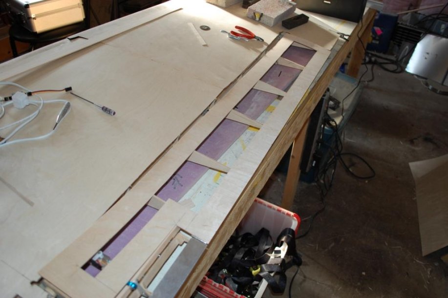

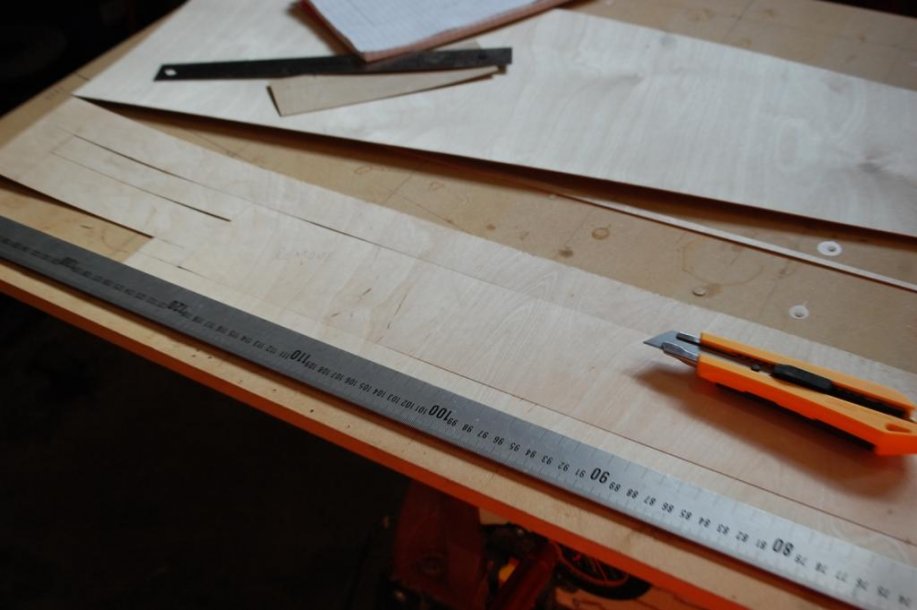

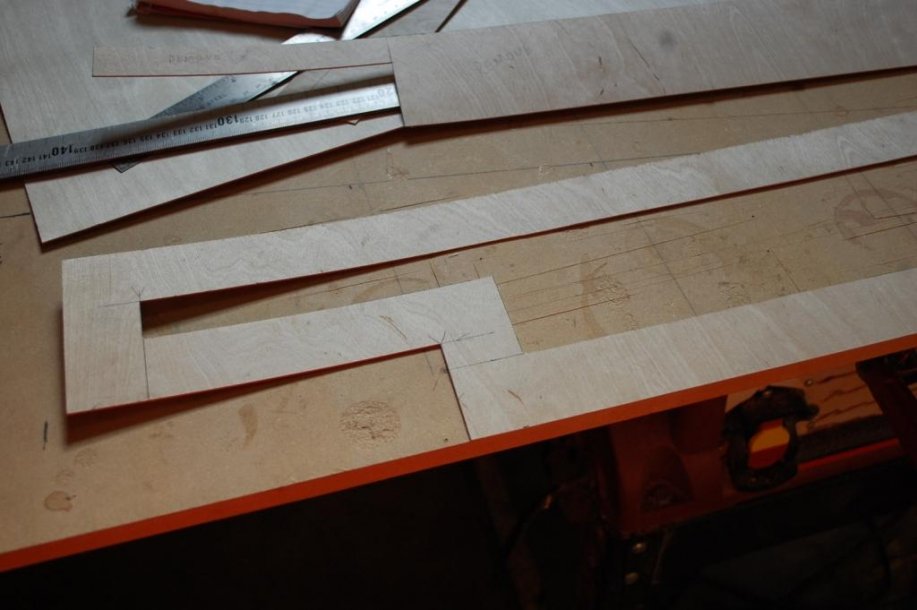

cutting out the aileron contour sheeting, and add the wing tip only at the butt joint , will glue it properly tomorow
