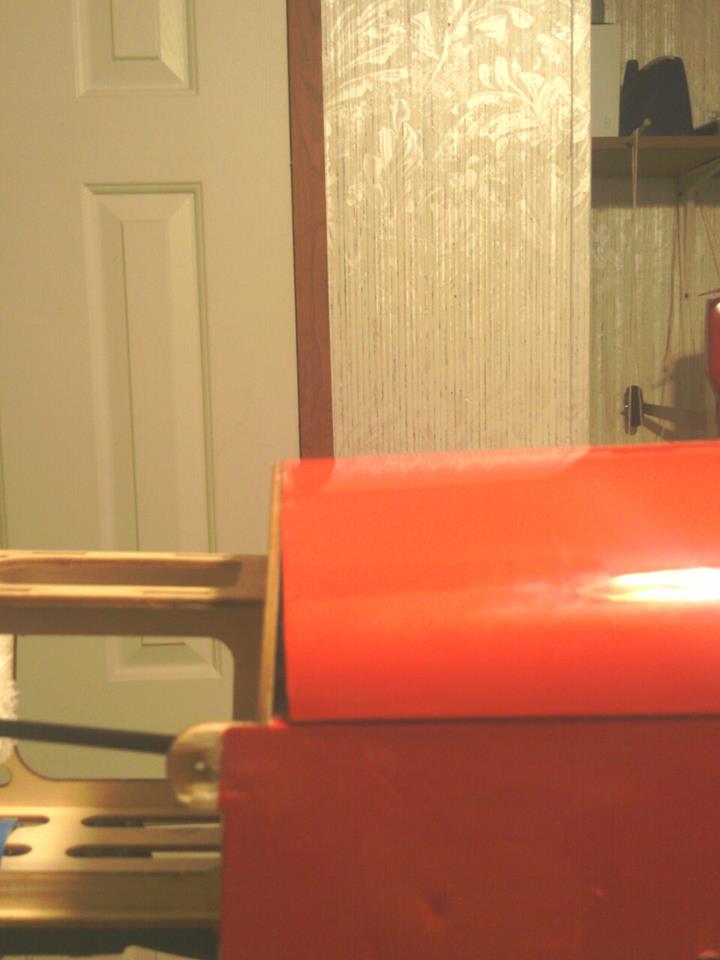

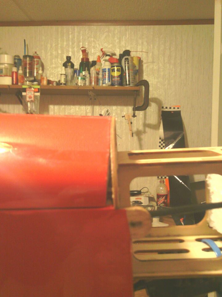

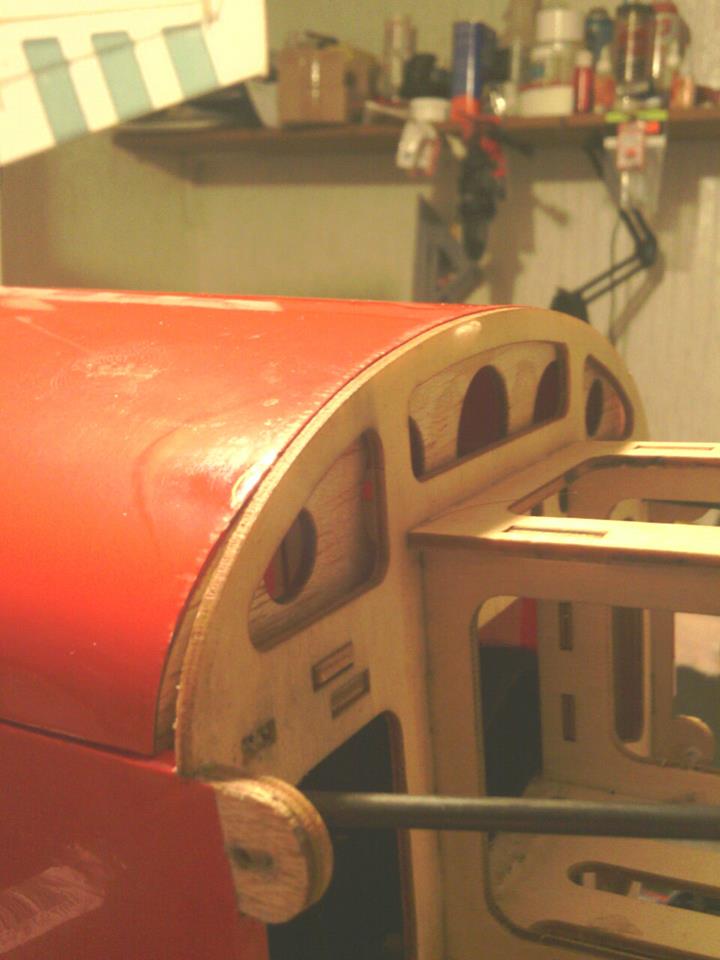

However, that firewall looks kinda fishy. Was there a rebuild done? If the front end isn't aligned properly, it could cause the thrust angle to be off, but you could mix that out on your radio.
how do i do that? a throttle to rudder mix?
i didnt notice it till today, the firewall. but no rebuild. i know exactly when the guy bought it and im pretty sure the flights flown on the airframe so far are around 15. pretty sure that firewall is a manufacturing defect. LOL, im sure ill get some flak for saying that, being these are laser cut and all. but i have another plane i bought new that i had to modify the antirotation pin and holes to get the wing to seat right.

had a guy on rcgroups tell me he messed up his firewall kinda the same as mine is and his MXS wasnt flying good at all until he fixed it. wonder what would be the best way to fix? if youll notice the gap in the pic on the first page of this thread. The piece of balsa thats going vertical, paralell with the fuse in the pic on the same side as the gap. Looks like i would have to cut that just a hair to get the firewall to go back the way it should, to fix the gap.
If the fuse and motorbox look secure, the easiest fix is to skip the cutting, and just use a few washers in there to regain the stock angle for the right thrust.

well i found another problem. in the pics the canopy is as far forward as i can get it. and on top of that i had the canopy latch fall out LOL.
but i am kinda disappointed.

imo he should have contacted EF when he received this. the plane is barely a month old. pretty sure it came to him like this as there looks to be no repair work done, if there was dude is beyond a professional LOL.
but anyways back to the debonding. whats gonna suck is that i think ill have to get the CF rods loose also, as they will need to move back just a tad also. idk, scratching my head alil on this one.
Yeah, if that's the way it arrived to him, yes, he should've call them at least. I hope you can get it fixed.

Thrust line is most likely not the issue. You will need a really bad thrust angle to make the plane misbehave like that, and it would be apparent to the eye.
I would imagine the canopy gap is purely cosmetic. There is no reason that should cause any flight issues. Besides, doesn't the canopy cover it?

only problem with the canopy the notches on the canopy doesn't want to go into the holes in the firewall very well at all. they are just barely on there, which puts stress on the canopy and the canopy latch, plus in the back of my mind ill be worried about the canopy ejected at some point.
im running atm a sunnysky 2820-800 (140 gram) ZTW b series 65amp esc 13x6.5 xoar, and glaciers/nanotech 4s 2600. lipos all read under 3 on IR reading on my PL6. I was a tad nose heavy .
the firewall looks kinda warped, especially towards the top.
