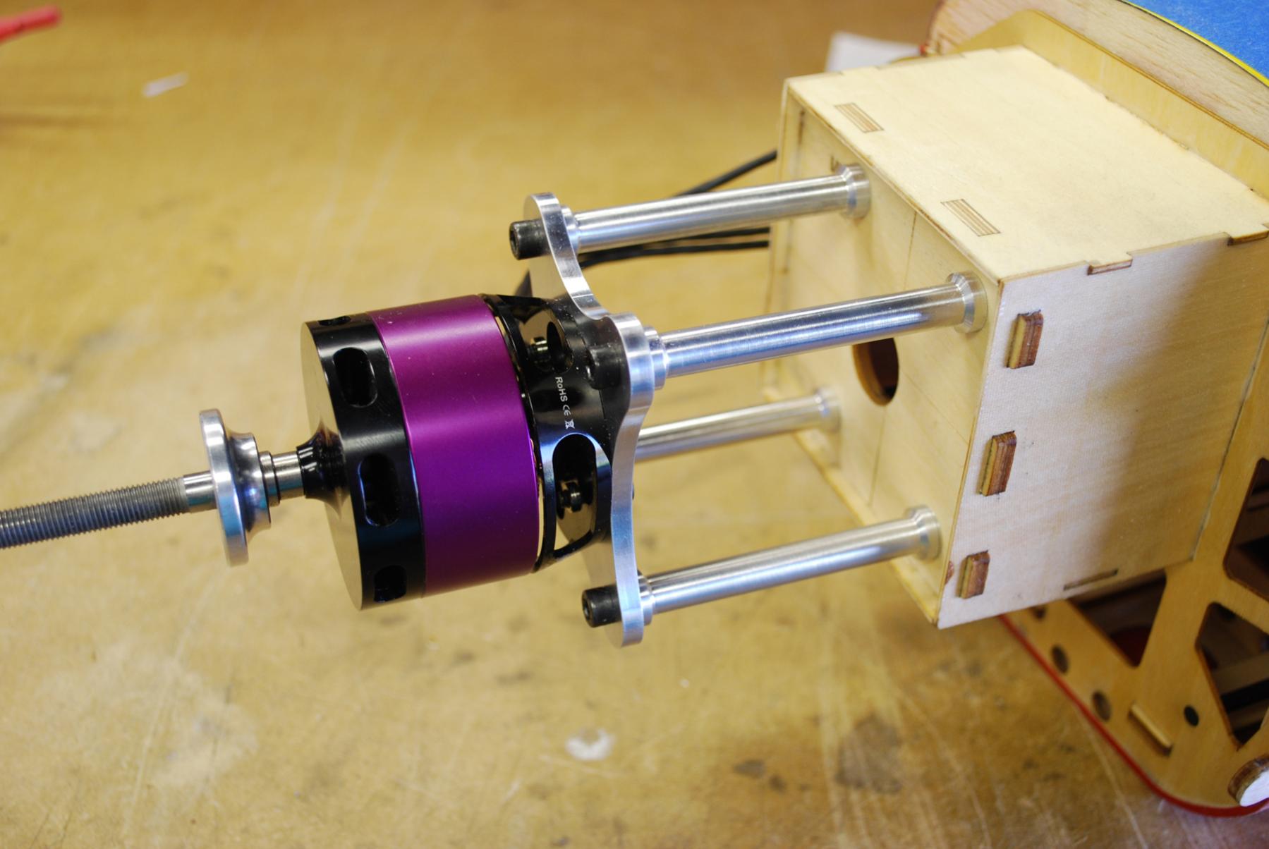

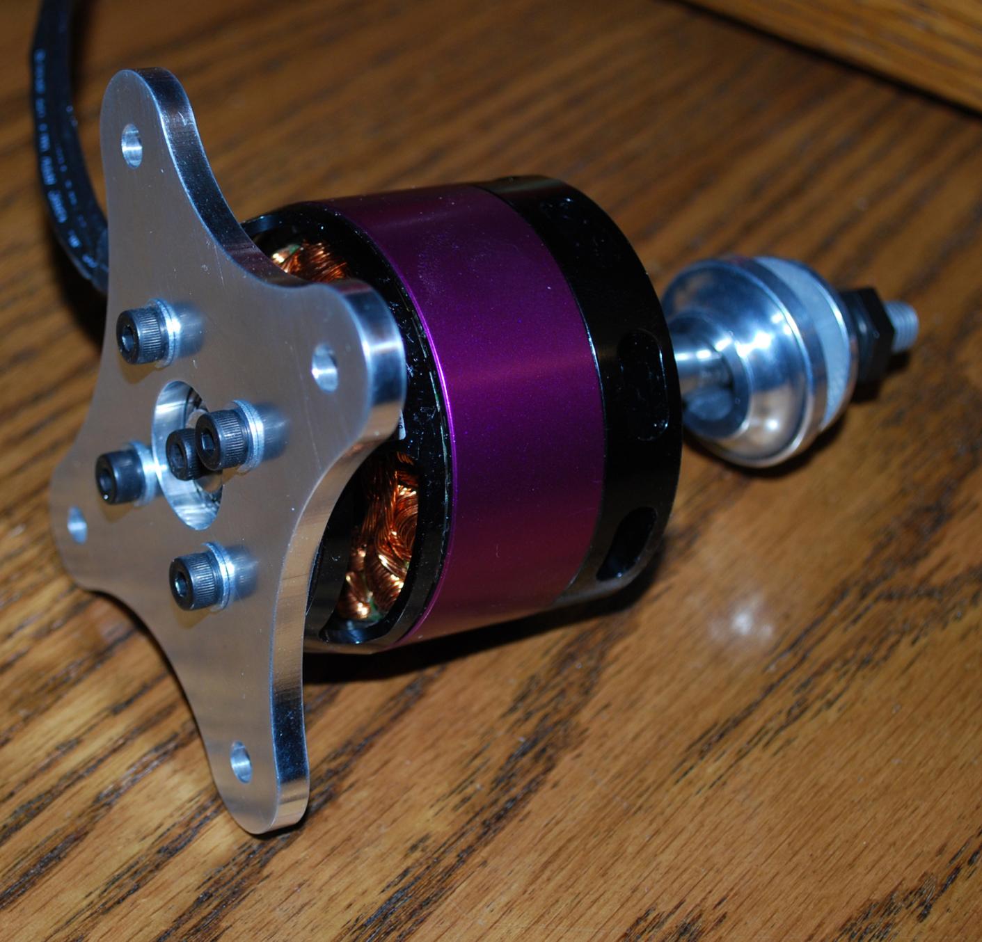

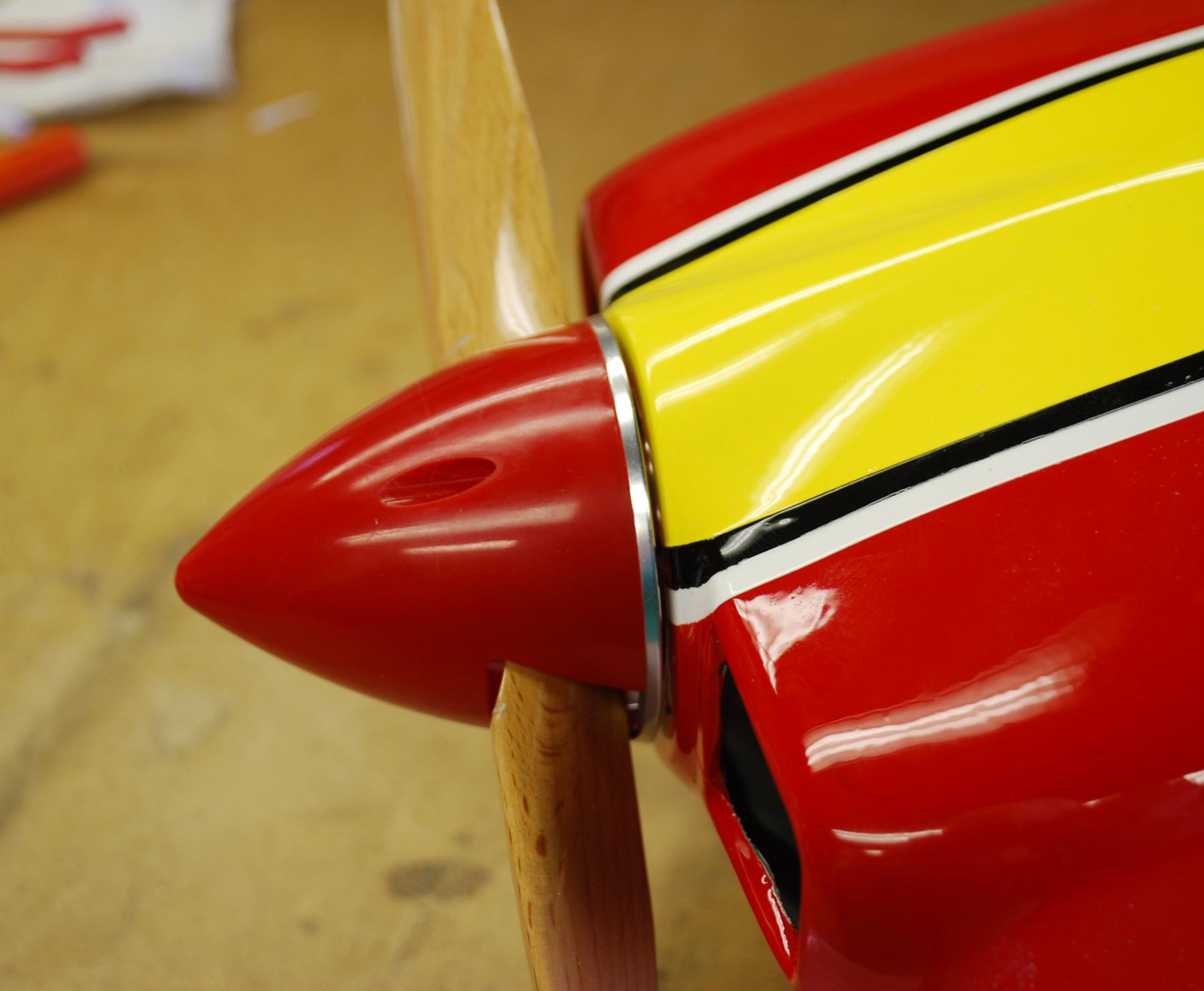

I am putting a motor similar to this (this is an A60-6XS)in mine......I was going to put this one in, but I found out that Hacker came out with a higher KV version of it,(A60-5S) so now I won't have to run a 20" prop on it. This is also the motor mount I designed. A friend made the backplate for me on his CNC mill, and I made the stand-offs
SteveT
