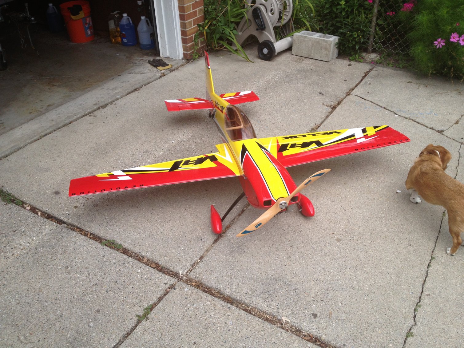

Velox with DLE30 ready for Maiden tomorrow...
