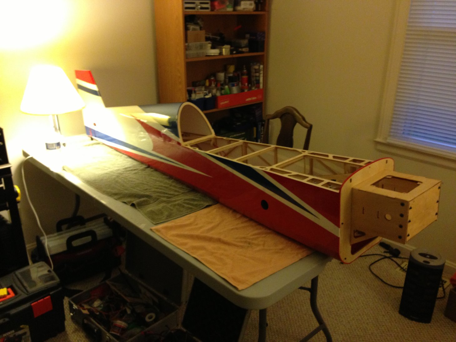

After bringing the fuse in the house I'm impressed that 2 extensions are included and ran down the fuse for the elevators.
Also nice to find a fuel DOT included but it was a pain to get it apart and it looks like it uses medium size fuel tubing which doesn't make sense since 50cc and up uses large size tubing to fit the carb and tank nipples.
But so far I'm liking it :)
I sprayed the firewall and where the fuel tank sits with TOPR7501 Top Flite LustreKote Spray Clear 10 oz to fuel proof the wood just in case of a spill, gas droplets, or exhaust gets sprayed on the wood.

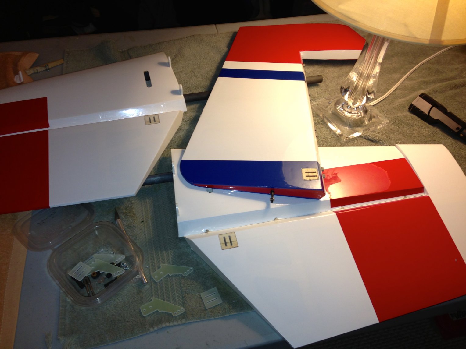

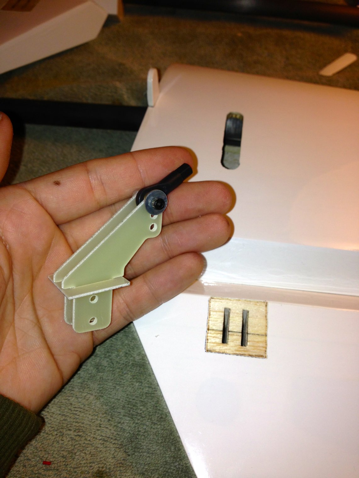

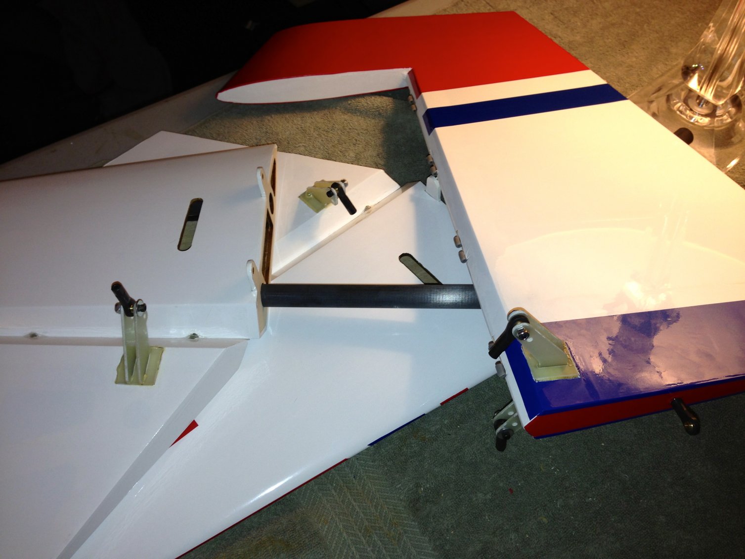

But last night cut out the holes for the elevator servos and installed the control horns on the tail feathers. Yes I know I'm not going in order as the manual. But anyways I used a soldering iron to remove the covering which came out nice and was easy.
Then started first glueing in an elevator arm first. These arms are huge!

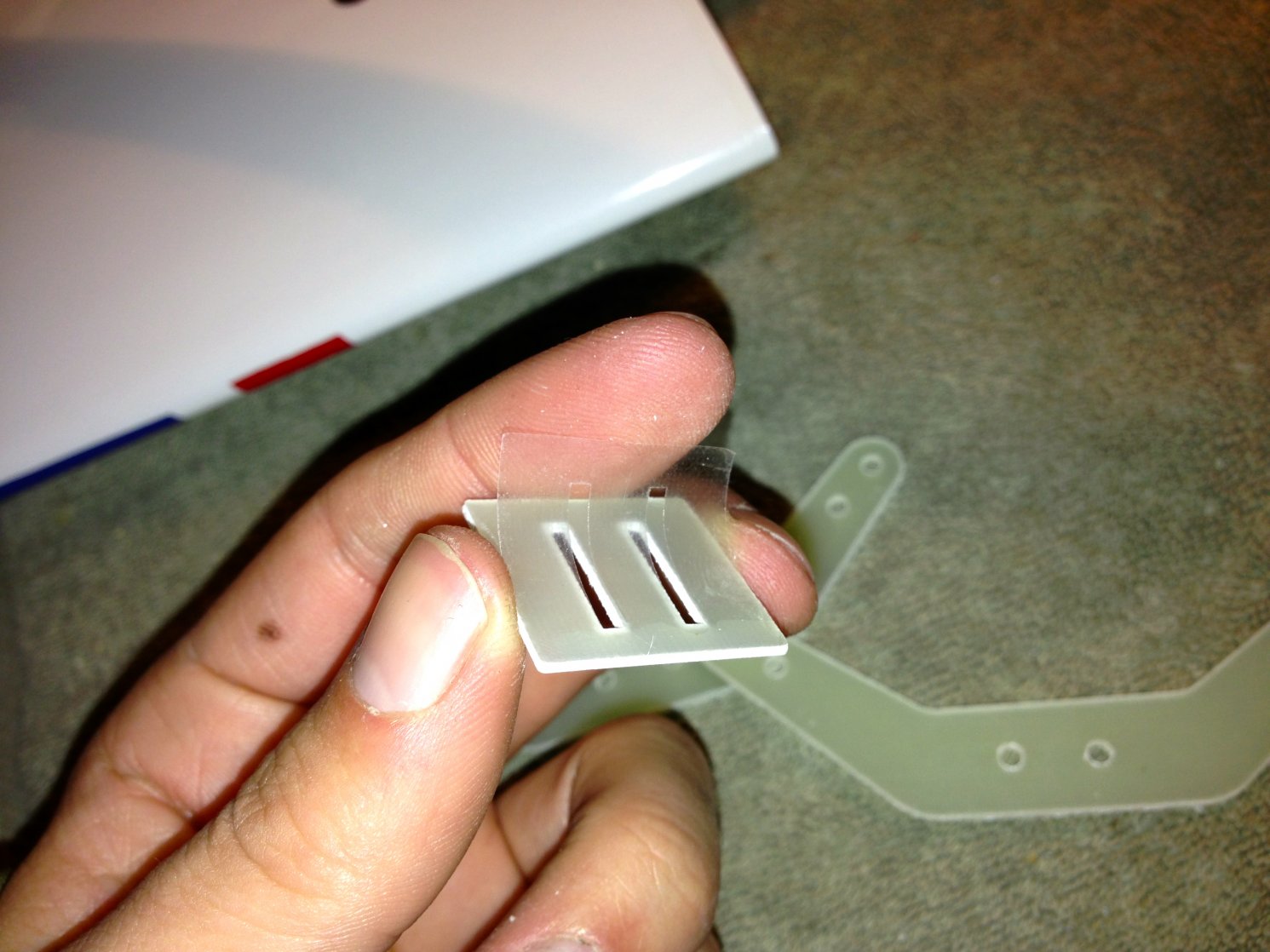

When I started on the other elevator I noticed the fiberglass squares had some film on them and I think the first elevator has the film still on but its already glued! I think it will be okay but frustrating no sign of the film in the manual. :cursing:
But after a while I got it all done including the rudder. Rudder is fun to push through, add glue, push the rest of the way, add glue under the squares, press them up against the rudder, then get the arms squared up meaning getting the holes in line with the hinge line and equal length of arm on both sides.

John, when building my 104 I would not have even thought or notice the clear film unless one of mine fell off. I thought to myself, what? then pealed the rest off.

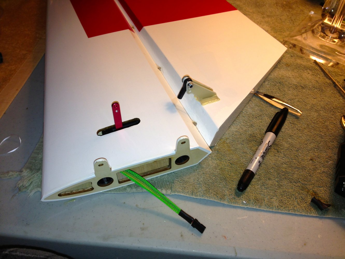

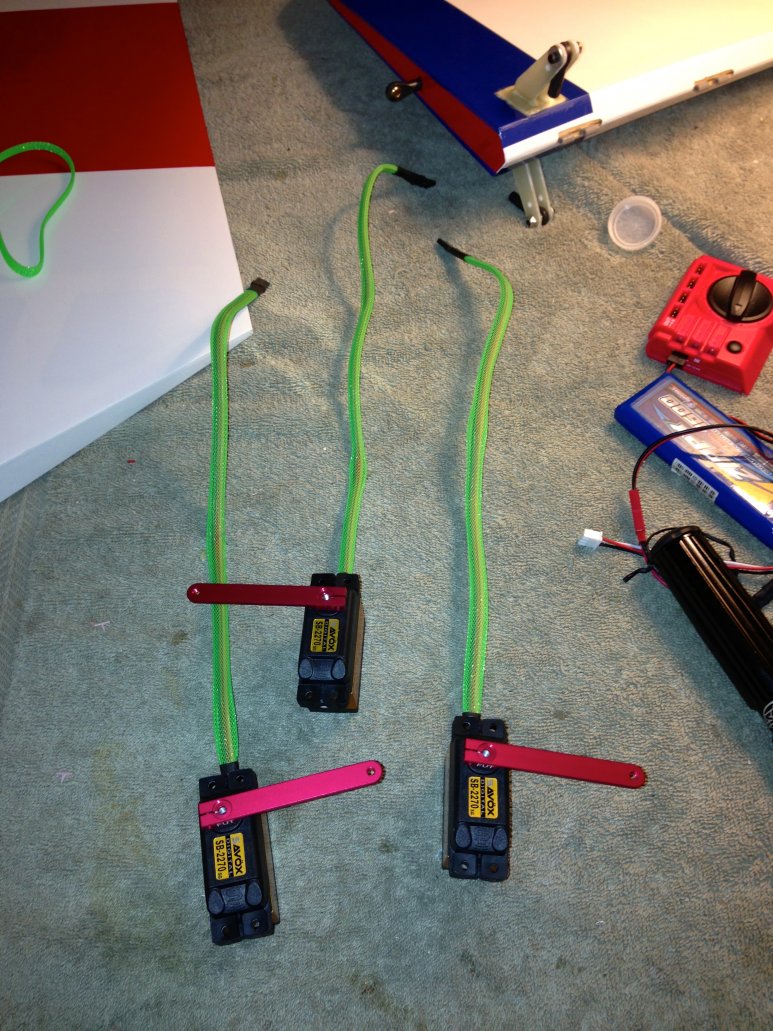

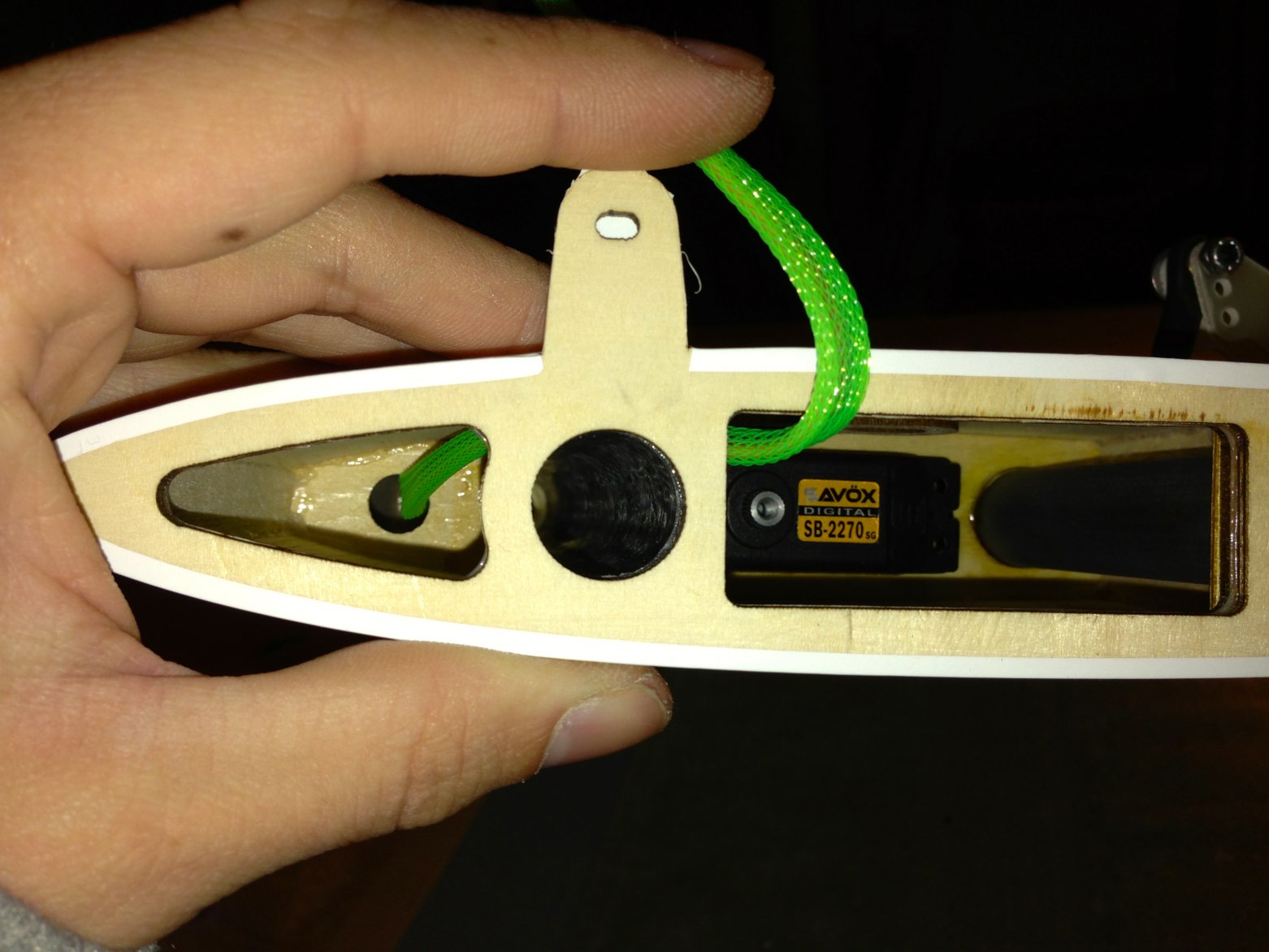

Last night got the tail servos out and added some wire braiding I already had to help protect the wiring from cuts and to be cool like diggity :D

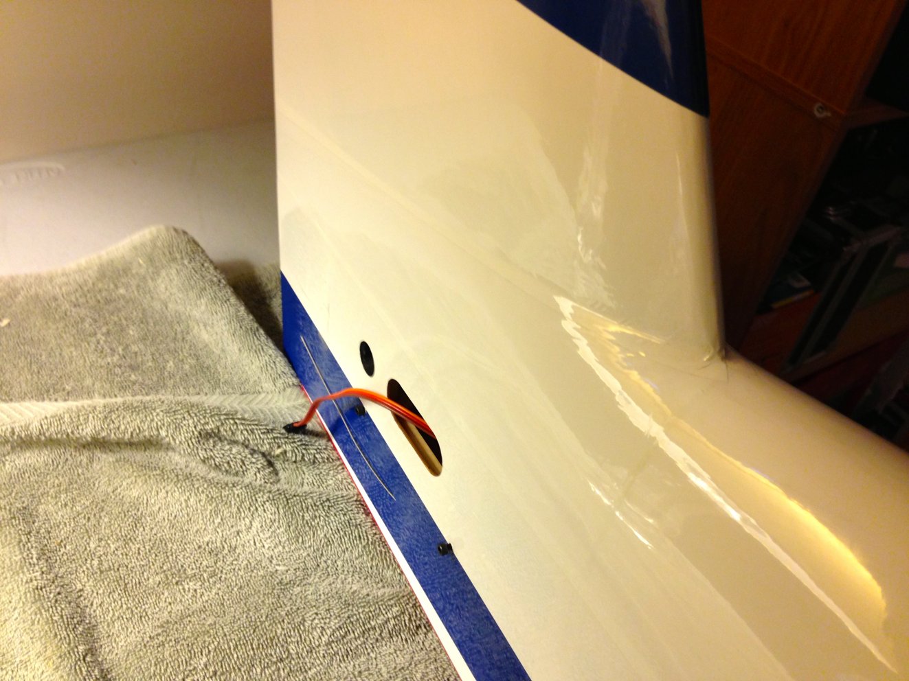

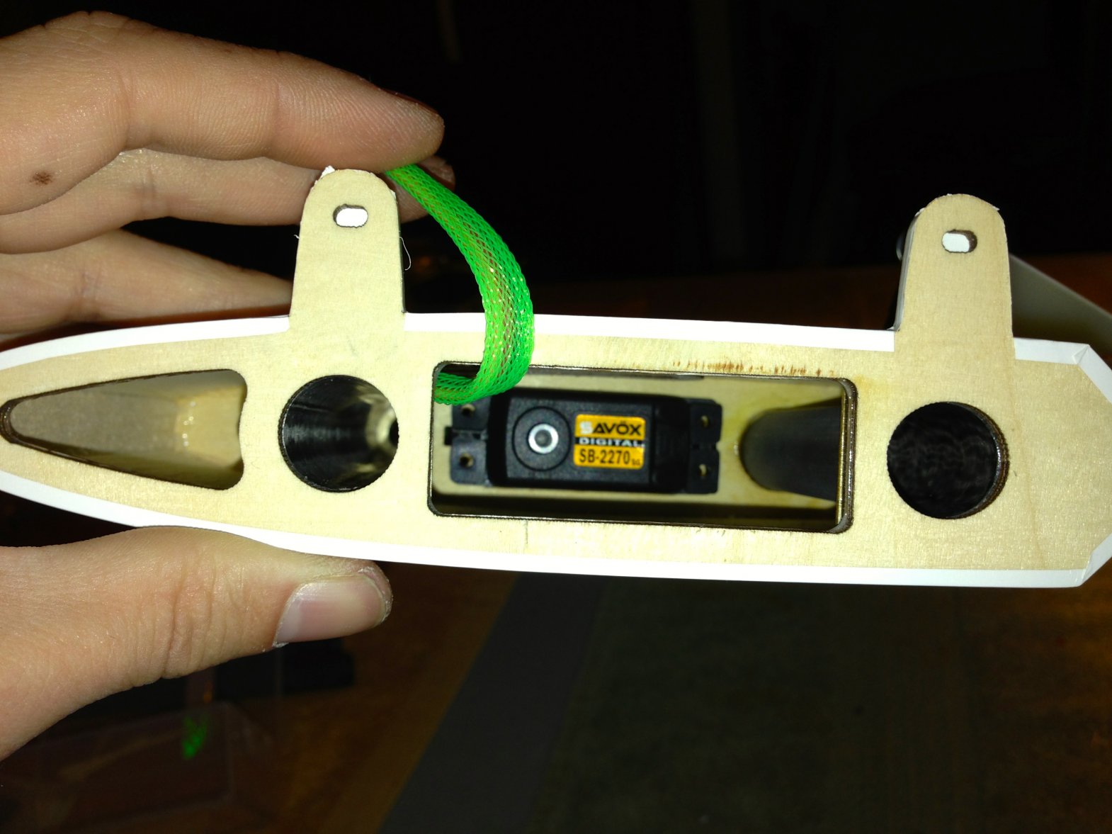

I like how the servo mounting holes are already drilled so just have to run a screw in the wood to thread it and drop CA in holes to harden the threads. I didn't like the idea of squeezing the wire through the little hole/slit they give you so ended up running the wire under the carbon fiber tube, through a hole, back under the tube, then out where the wire is supposed to exit.
You can see the little hole/slit for the large servo wire that I didn't want to squeeze the wire through
I still have plenty of wire sticking out so just need to do the other elevator and get the linkage set.
Also got the arms drilled at 1.75" and tapped for 4-40. The elevator already got the sub-trim set so arm is 90 from the case. This weekend I would like to get all the tail done and start setting up the wing servos.
