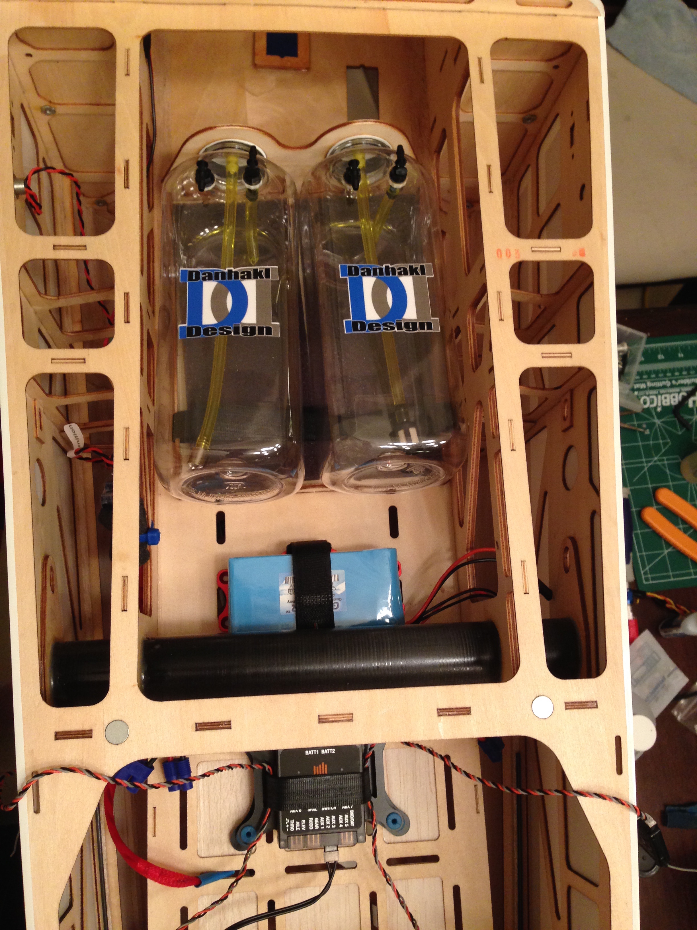

With all the talk about CG I think I am going to lay things out like this...
Done so far.

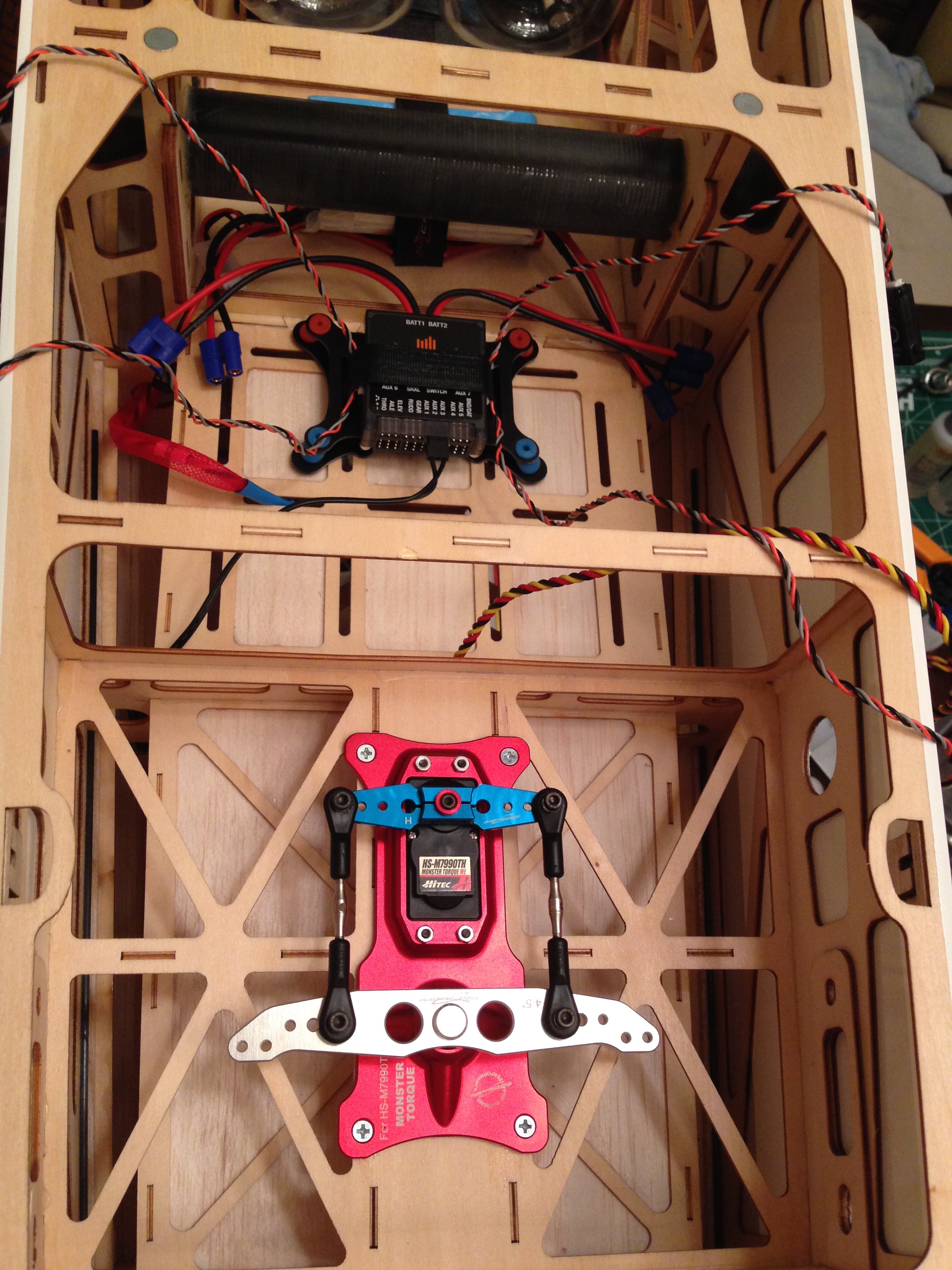

Rudder servo tray cut in deck.

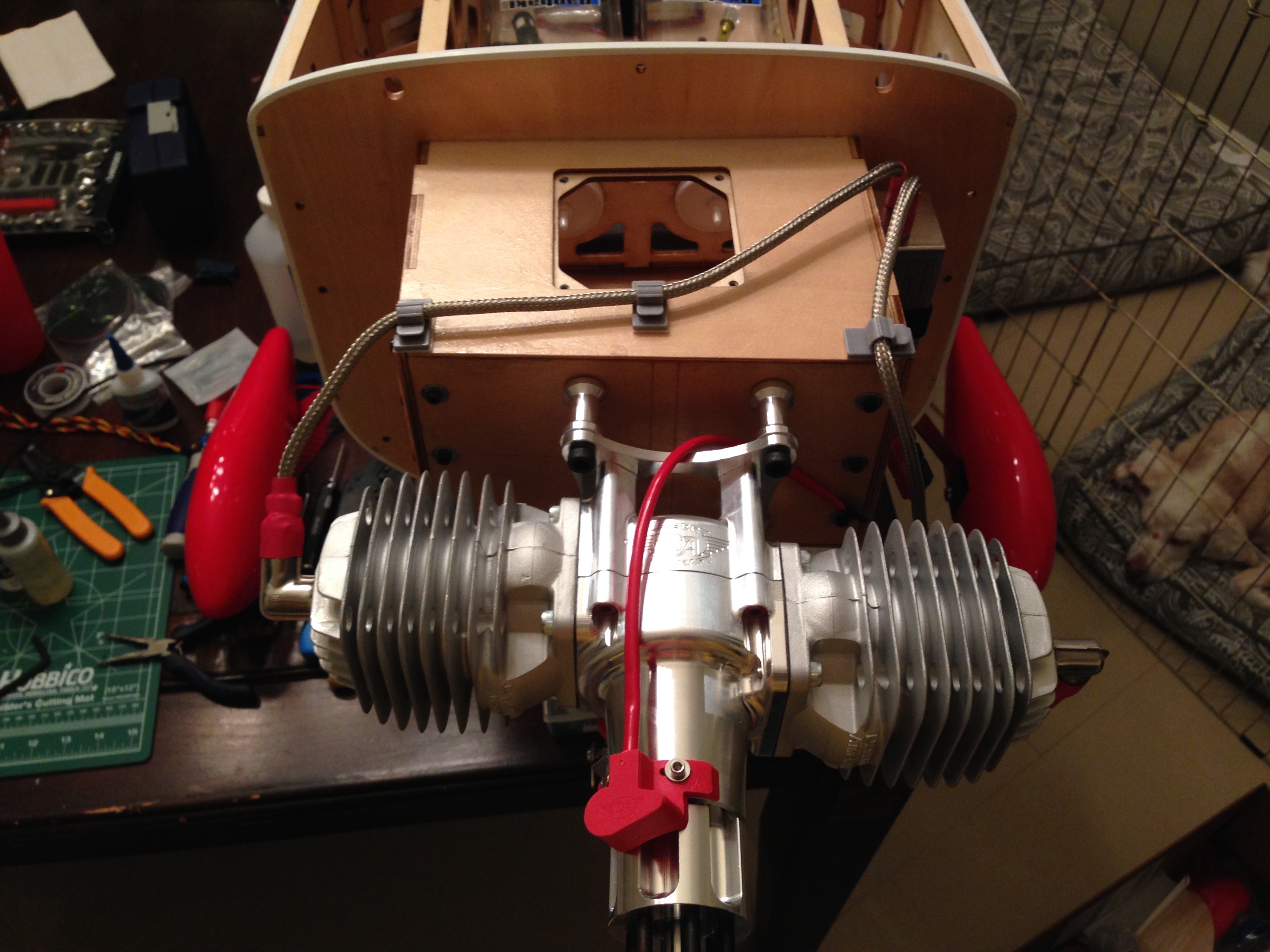

Motor box and leading deck sealed with clear fuel proof paint.

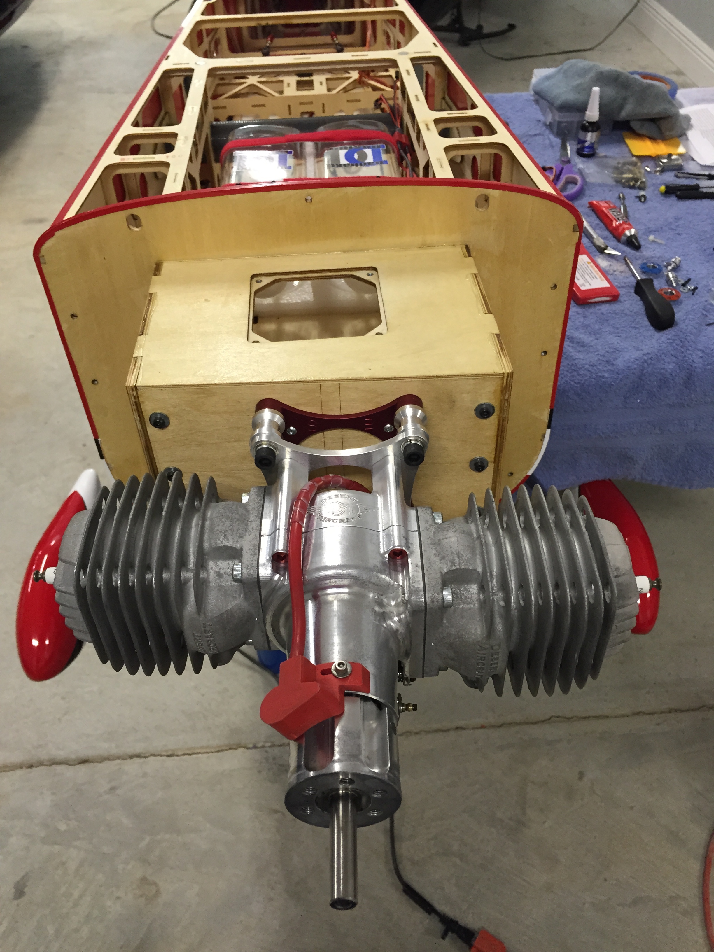

DA-120 mounted and throttle linkage done.
Landing gear.

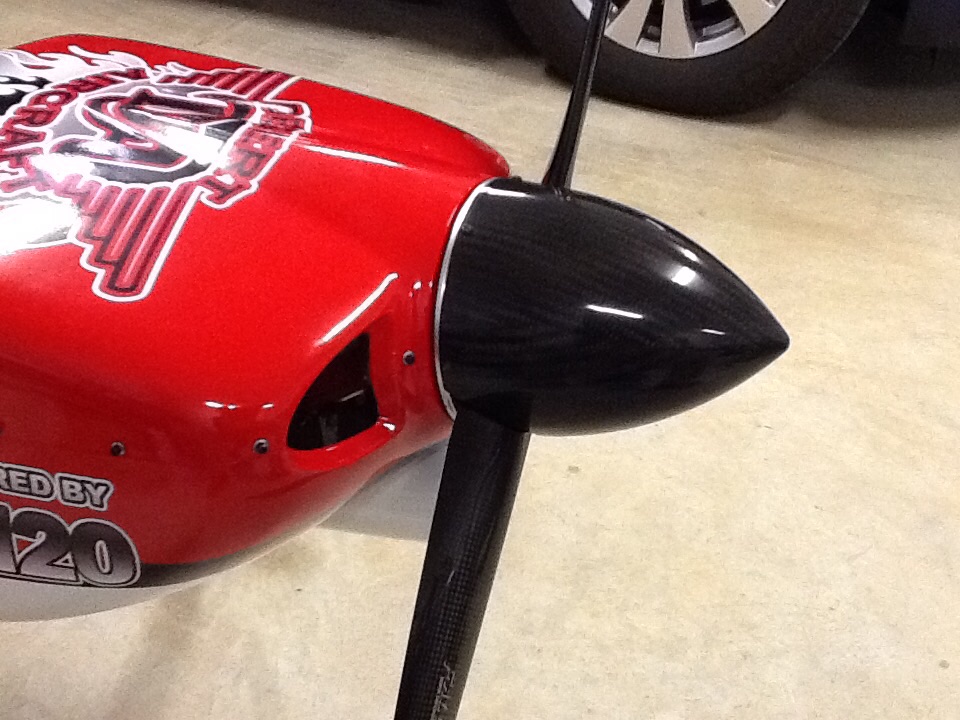

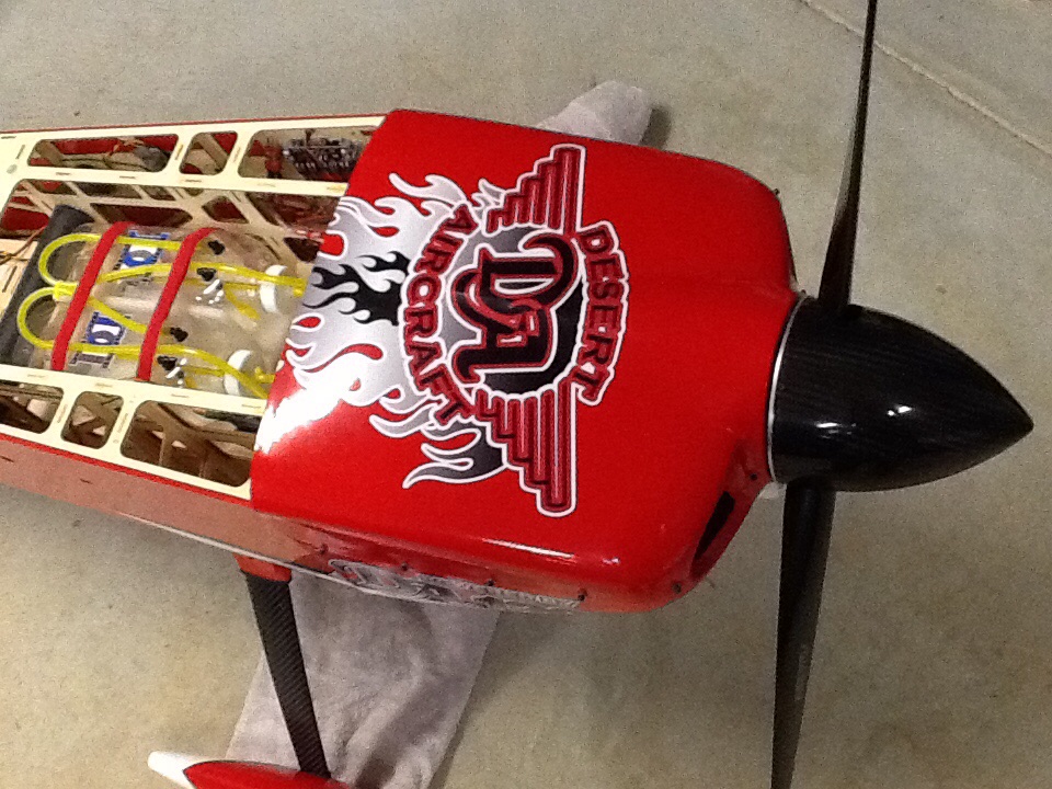

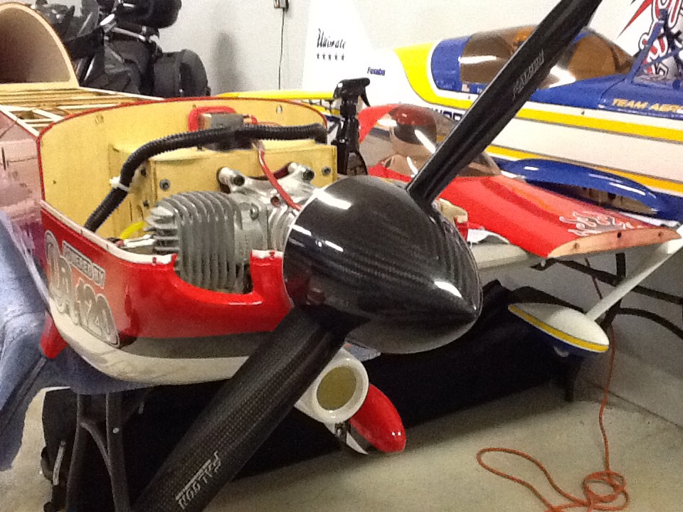

Went with TaildraggerRC's new line of carbon fiber spinners with aluminum back plate. This is the 5" model. Love it! More upscale than the included one with the kit and aluminum backed. :cool: Still have to baffle the cowl but had to button it up to see how it looked.

Looks sweet. Did you use a single washer and long standoffs?? Gap looks good.

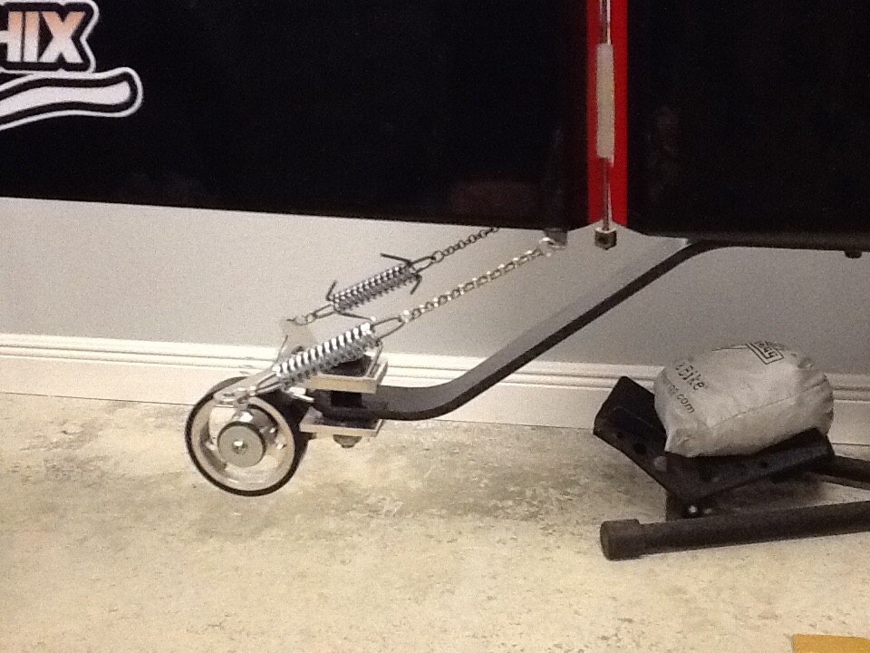

Used an SWB engine mount combined with the included short standoffs. Perfect. Swapped out the included washers on the cowl for neoprene backed/bonded washers too. Vibration/rub elimination I hope. Not sure if I like the tail wheel bling. Looks great...just not sure of the style.:flyer:

FYI- The tanks in my pics were not screwed down ...I will move as close to the wing tube as possible....
You are definitely winning the build race...
