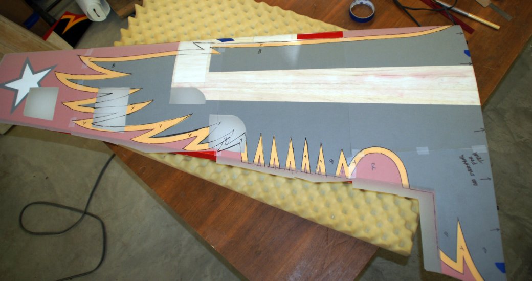

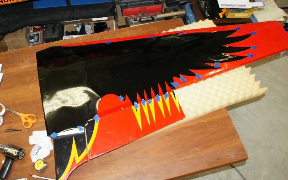

Covering should arrive tomorrow. Traced the Raven's feather pattern from the less-damaged left wing. Glad I had that much of a template to go on. I'll just flip it over for the right wing.
BTW - I removed the center strip of black primarily to inspect the sheeting along the top of the spar. All looks good...still counting my blessings that the plane wasn't damaged any more than it was. All main internal components of the wings and fuse were not damaged at all. :fist_pump:

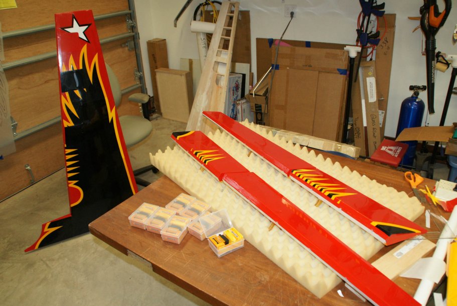

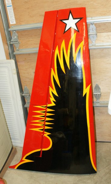

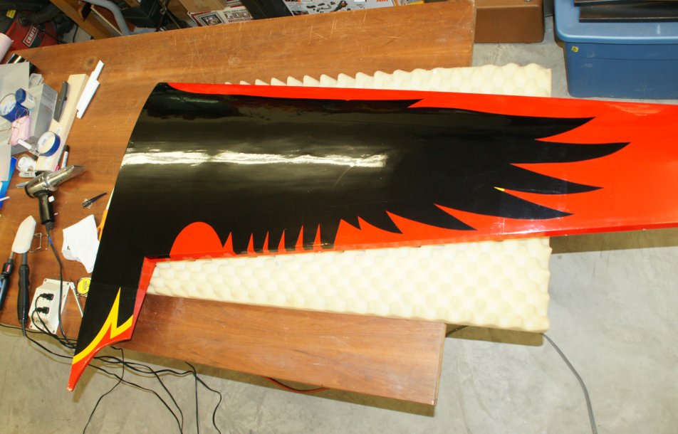

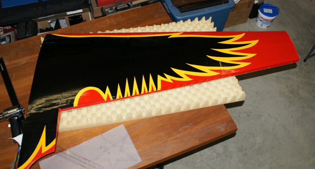

Getting closer to finished on the Raven repair and clearing the way for getting back on the Krill....:confused:. Ailerons covered. Left wing covered, ail glued and servos installed (Savox 1230SG, 500 oz/in). Right wing almost done, just need to get the yellow outlines on the feathers....what a PITA these are!!!!!!
Should have this thing ready to fly by next week....I hope!

Awesome job Earle. Looks great!
That yellow outline looks tedious. I think I would have laid down the yellow first in one solid piece. Then overlaid the black. Or would that be the totally wrong way to do it?
Pistolera
HEY!..GET OUTTA MY TREE!
I though about that but didn't want to lay that much covering over another layer of covering. I only put enough red on the wing so the black overlaps it.
The yellow turned out OK....just did it in smaller sections, like a few feathers at a time. The original covering was done in a similar fashion at the factory, although they did lay red for the whole wing before laying the black on.
