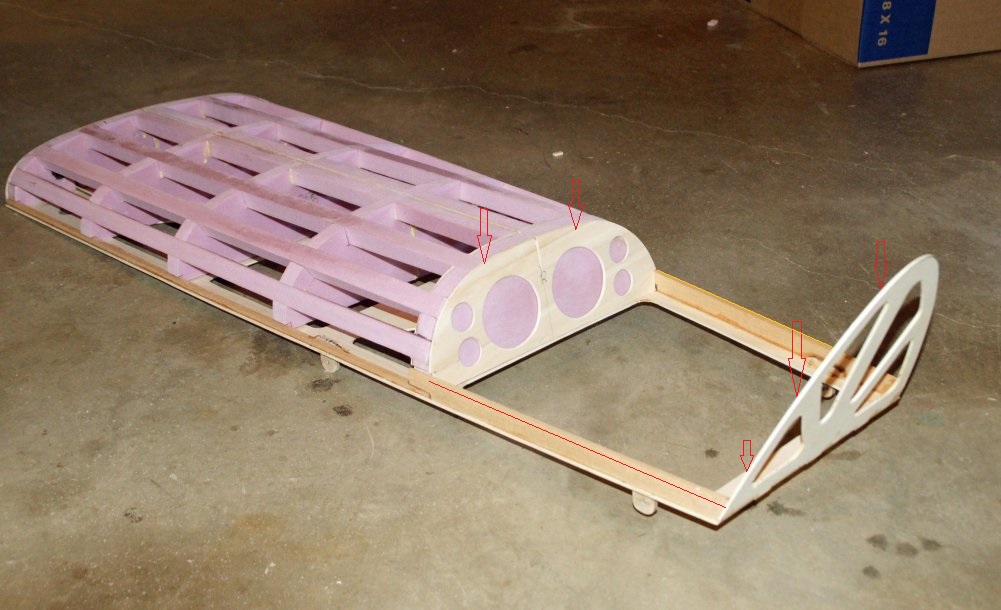

@Terryscustom ....do you run a bit of balsa on the inside perimeter around the back canopy bulkhead to give some more surface to glue to, or just glue to the 1/8" ply and leave it at that?
Just 1/8", tack in with goop or whatever you install your canopy shell with but don't go too crazy. After it's all dry and removed from the fuse put some Goop in a syringe and go around the inside perimeter with a 1/8" or slightly larger bead and good to go. I dont smooth out that bead, I just poke it a little so it is sort of like a tig weld line of goop. Never had one fail yet.
