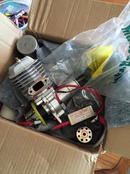

Received my DA-50 in the mail today. I promptly took it directly to DA and had them run it. It worked perfectly. Glad to know that having bought it used. While they were setting it up and running it, one of the gentlemen gave me a tour of their shop. Very nice operation and a bunch of good people there!! I don't think I could buy any other type of engine now!

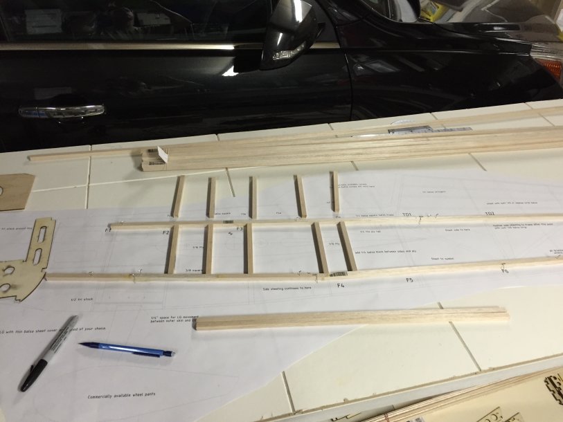

More progress. Pinned the two main stringers to the plans. Then cut the perpendicular pieces in sets of two to save time on the 2nd half. Nothing is glued yet. I should get there tomorrow.
