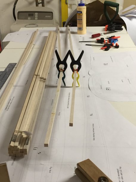

I can finally say the build is under way!!!

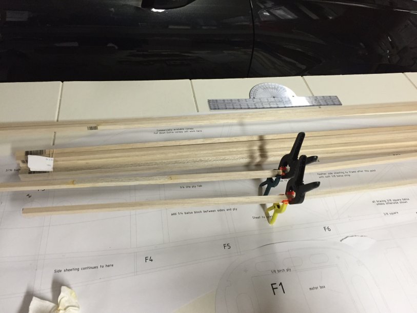

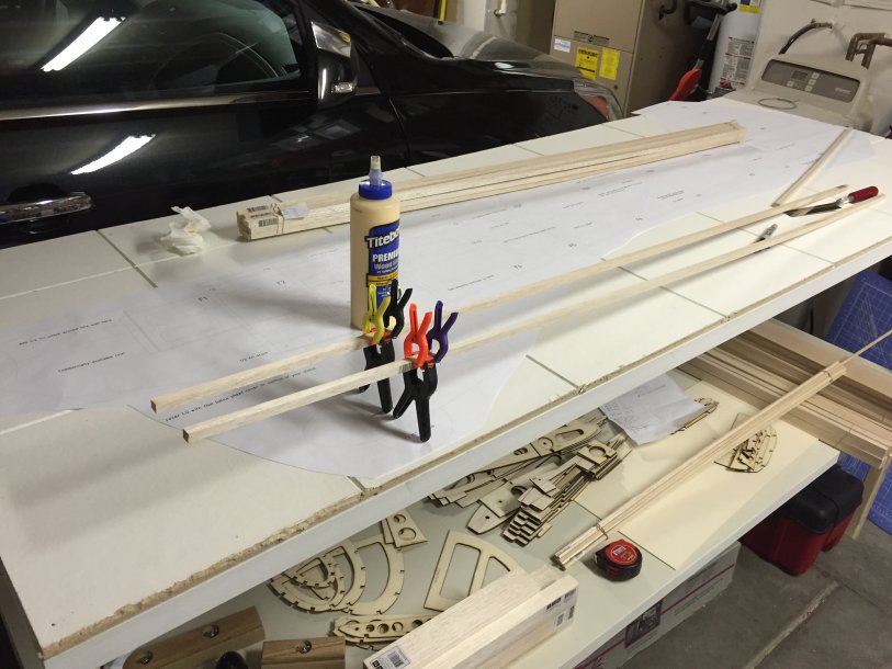

The bottom main stringers have a 5 degree bend somewhat close to the front. I am using about a 20 degree overlap for extensions, so for the 5 degree bend in the stringer, I just cut the front piece 5 degrees closer to 90 to get the angle needed.

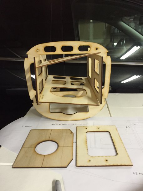

I found out that I need to do a bit of sanding on the tank floor and motor box top to make them fit properly.

BalsaDust
Better to sand a little to get it to fit than it being to small. Looks good brotha and glad you finally got it under way.
Bluepilot2003
@cbarnes0061 True story. Much easier to sand to shape. Sure glad I have those handy, dandy sanding blocks!
