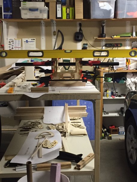

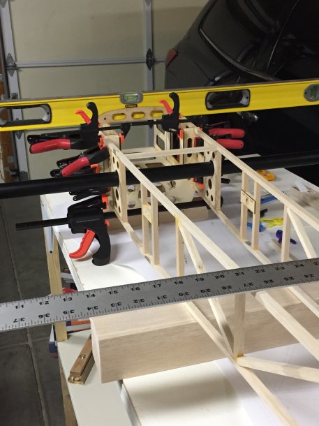

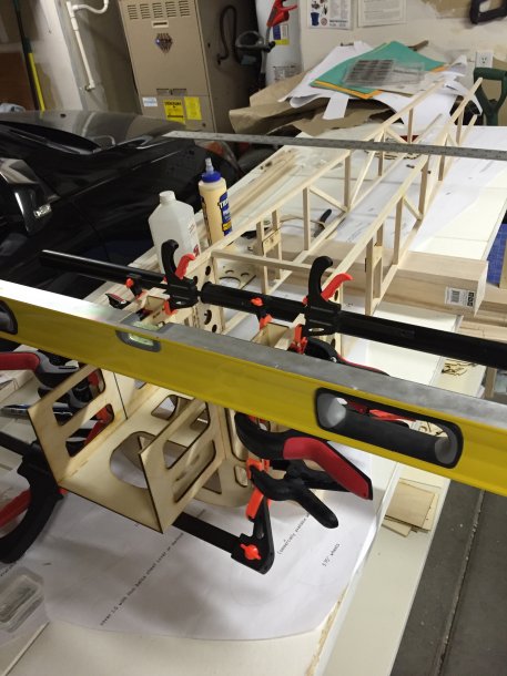

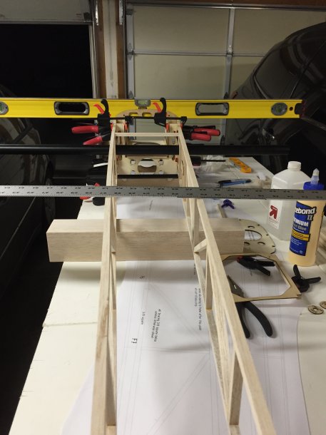

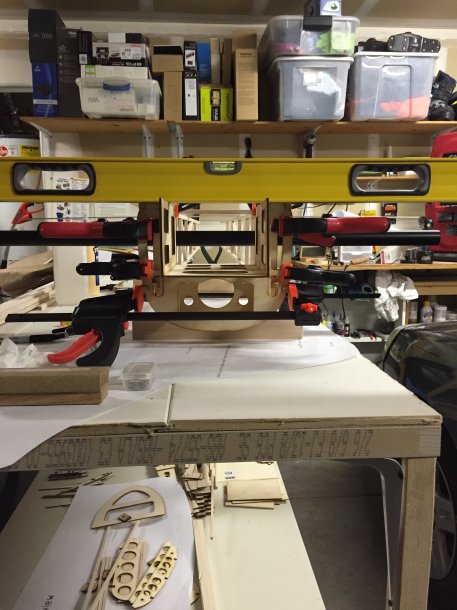

I put in the wing tube doublers into the frame. Then added the back side wing dowl holders.
I am contemplating the best way to glue the fuse sides to the f-1 and f-2 formers. I've had it together about 4 times now trying to think of the best way.
Looks good. I would say though where the two sticks come together at an angle I would put some sort of gusset in there to add a little strength.
Bluepilot2003
Well, I glued the sides to the motor box after I was satisfied with the fit. My biggest qualm has been the fit of F-3. So I did it without F-3 in at the time. I don't think I could have it any more square than it is. Though I don't have the phenolic tube, the wing tube itself did a very good job of verifying how well the pieces fit together. I used epoxy for this step.
