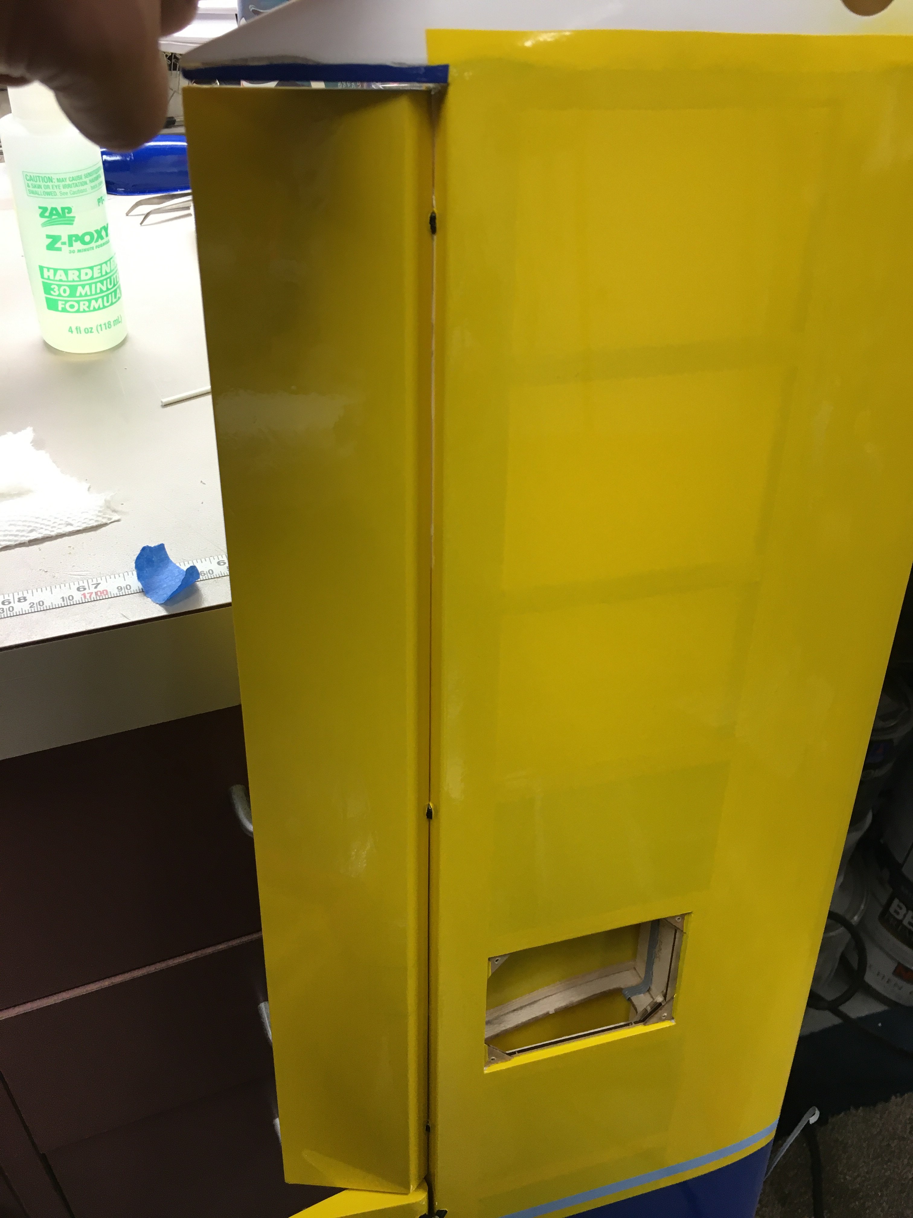

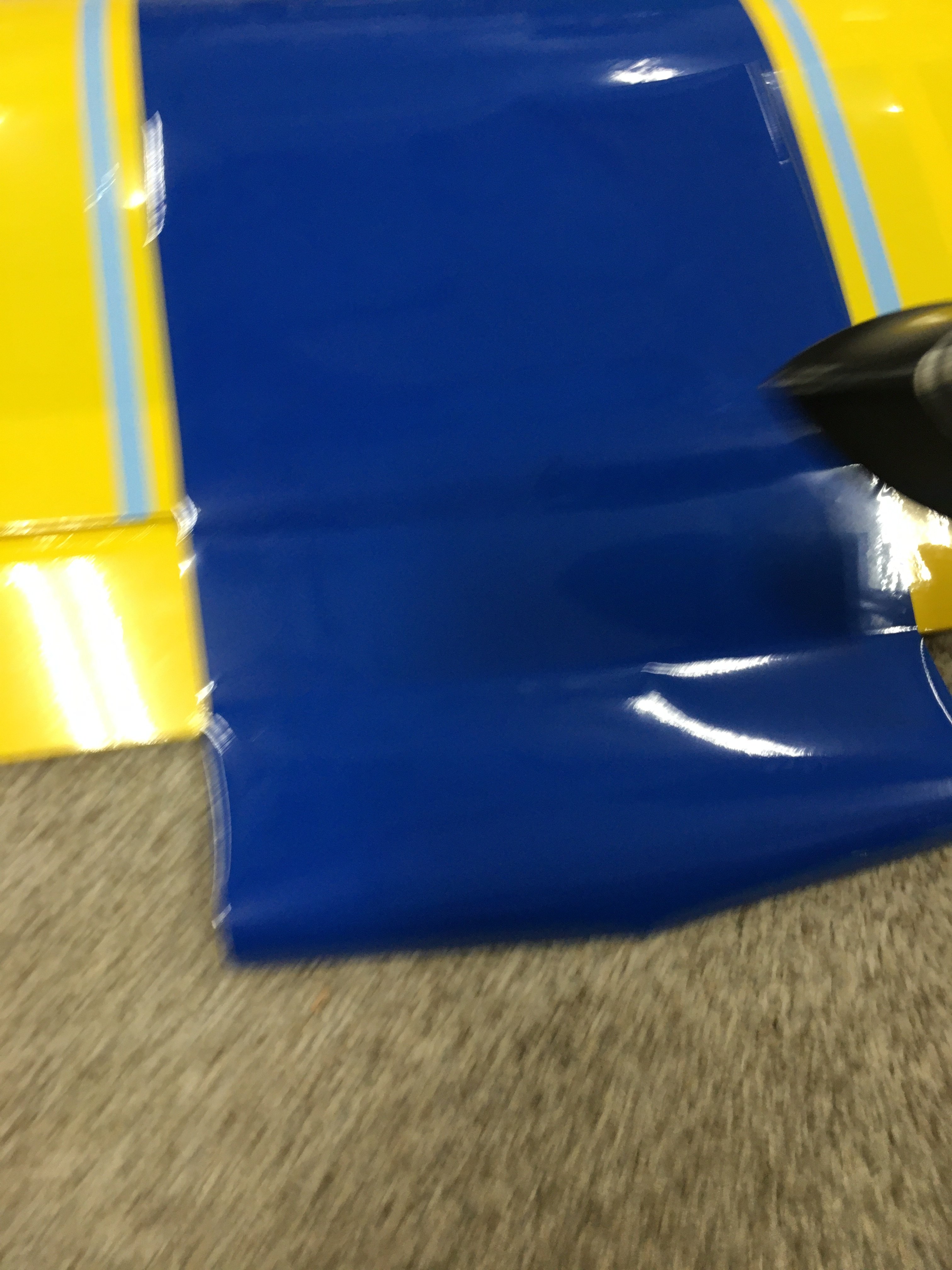

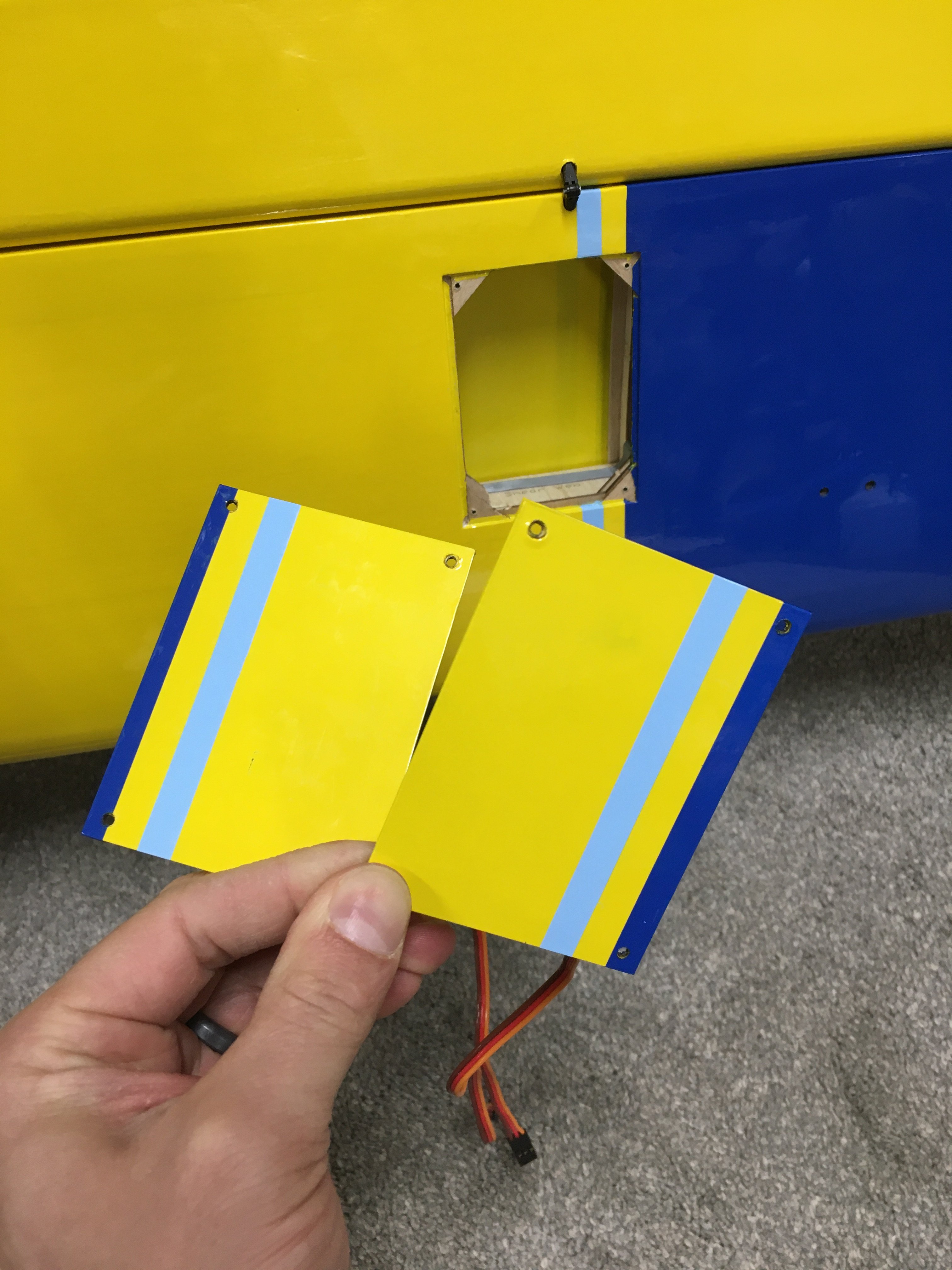

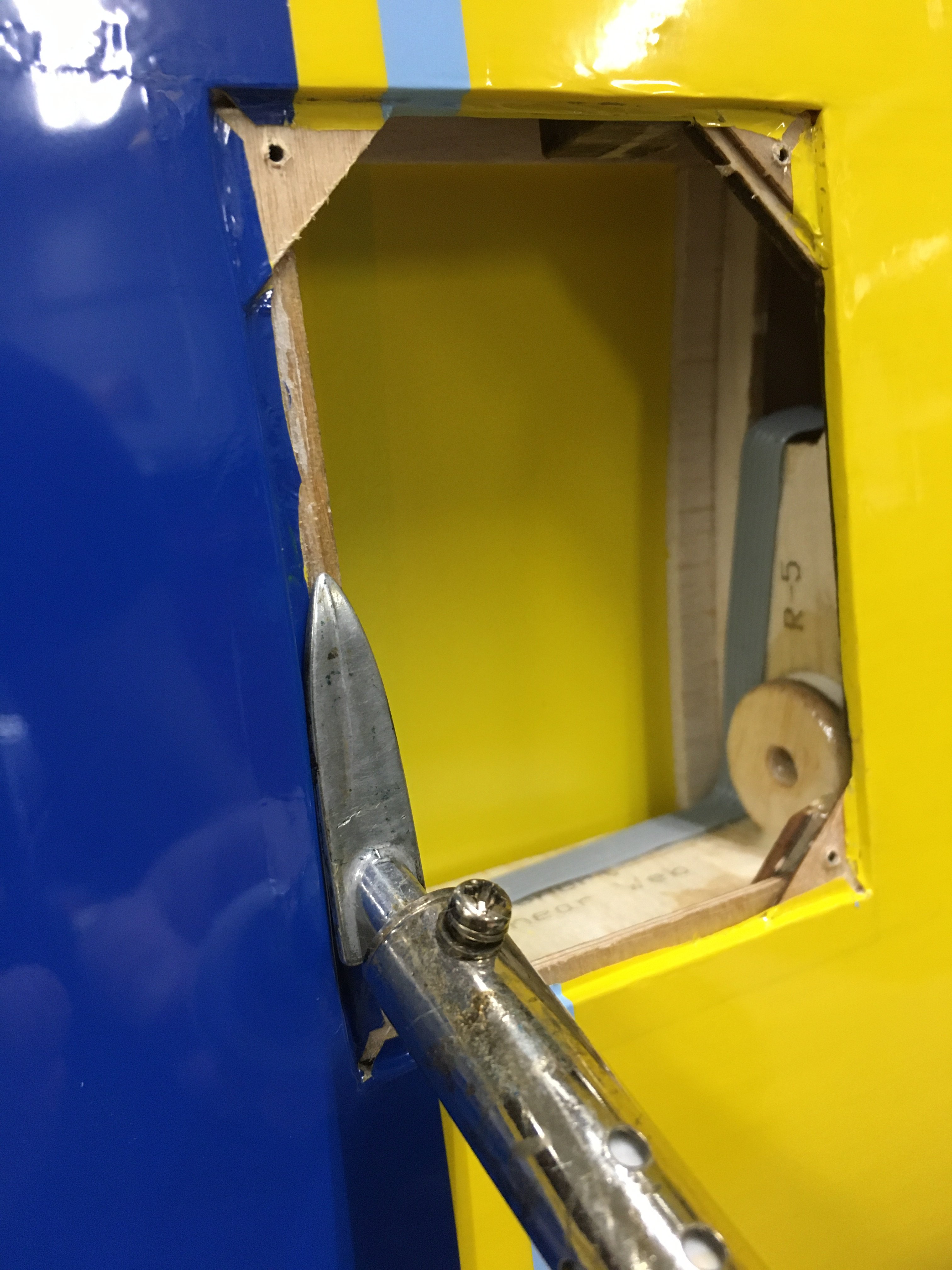

    Cut out the wing servo bays and put the trim on today.

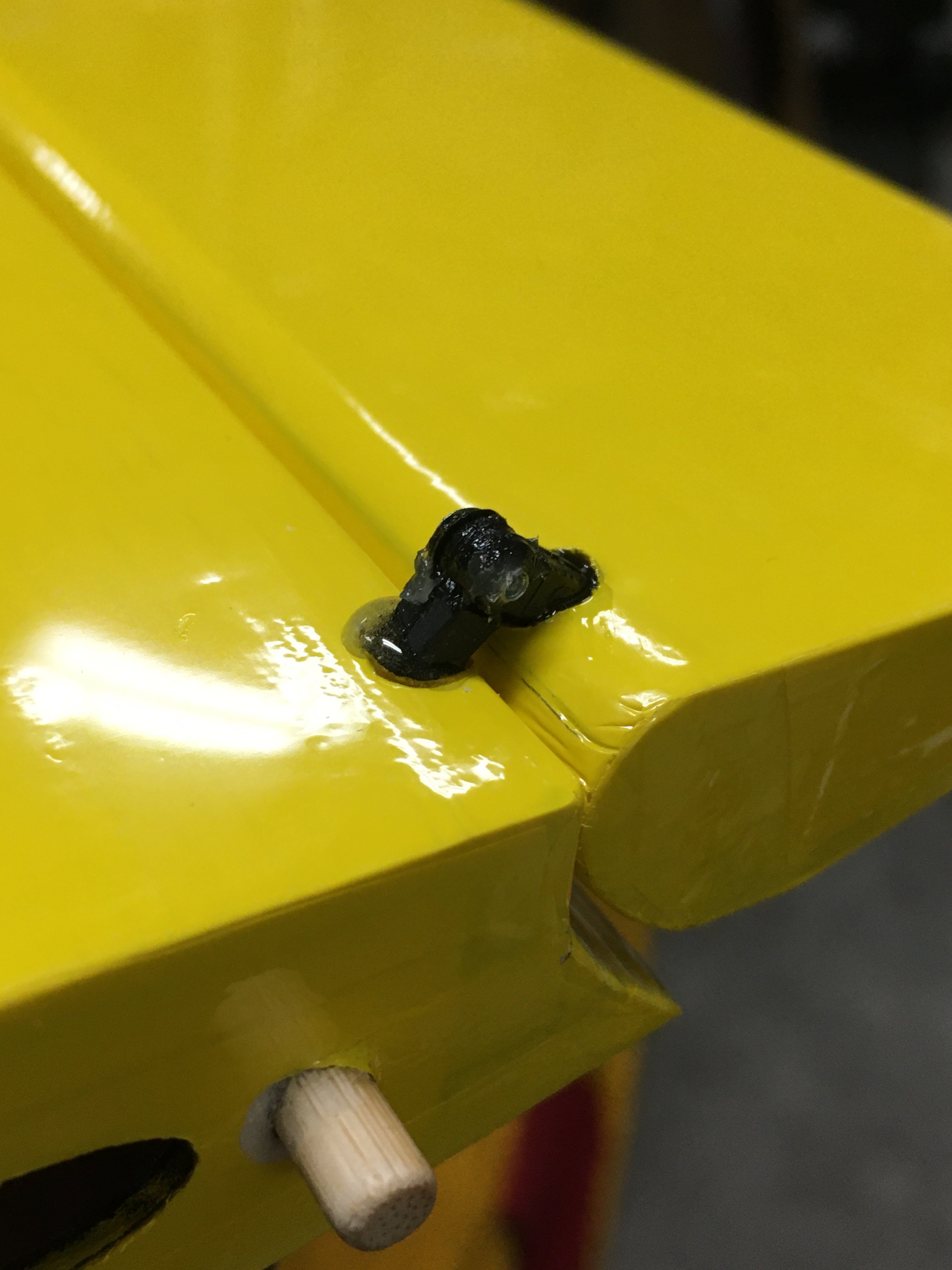

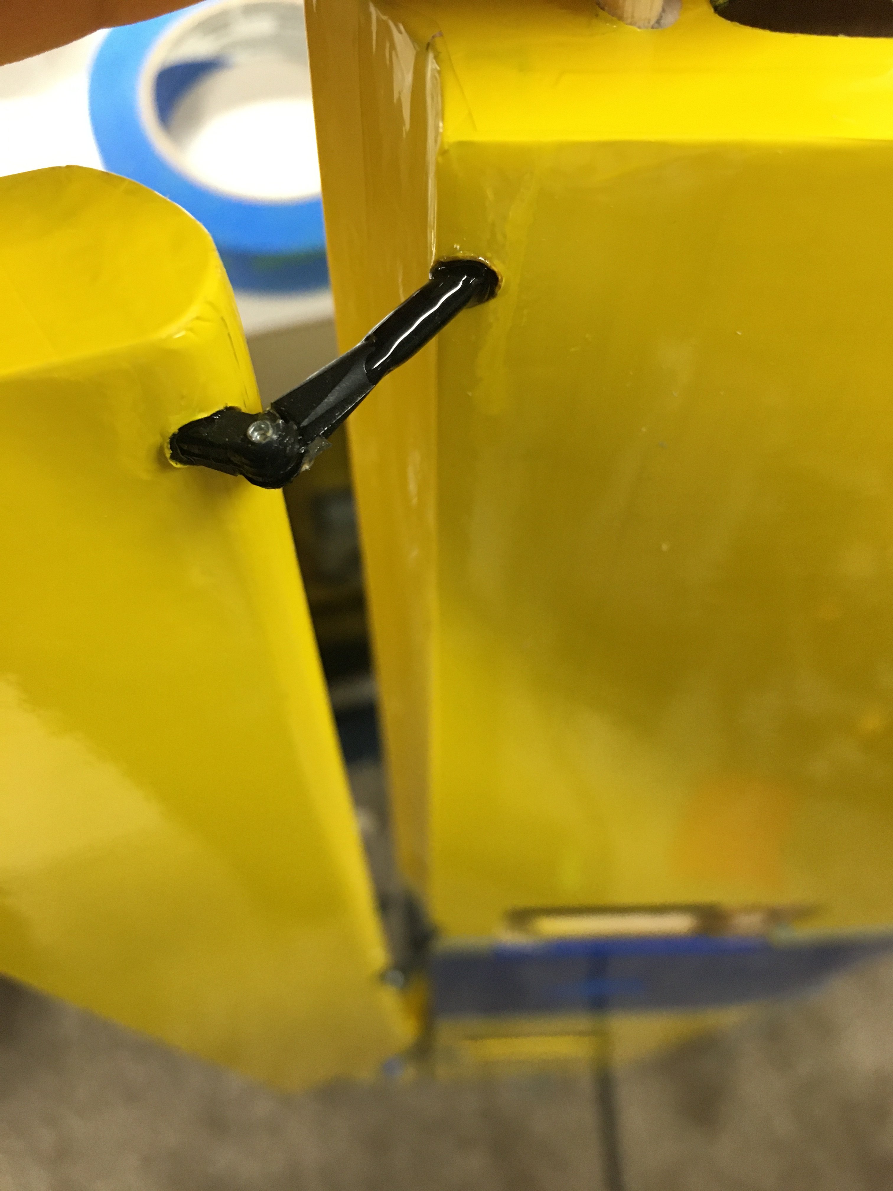

    Aileron point hinges glued in place.

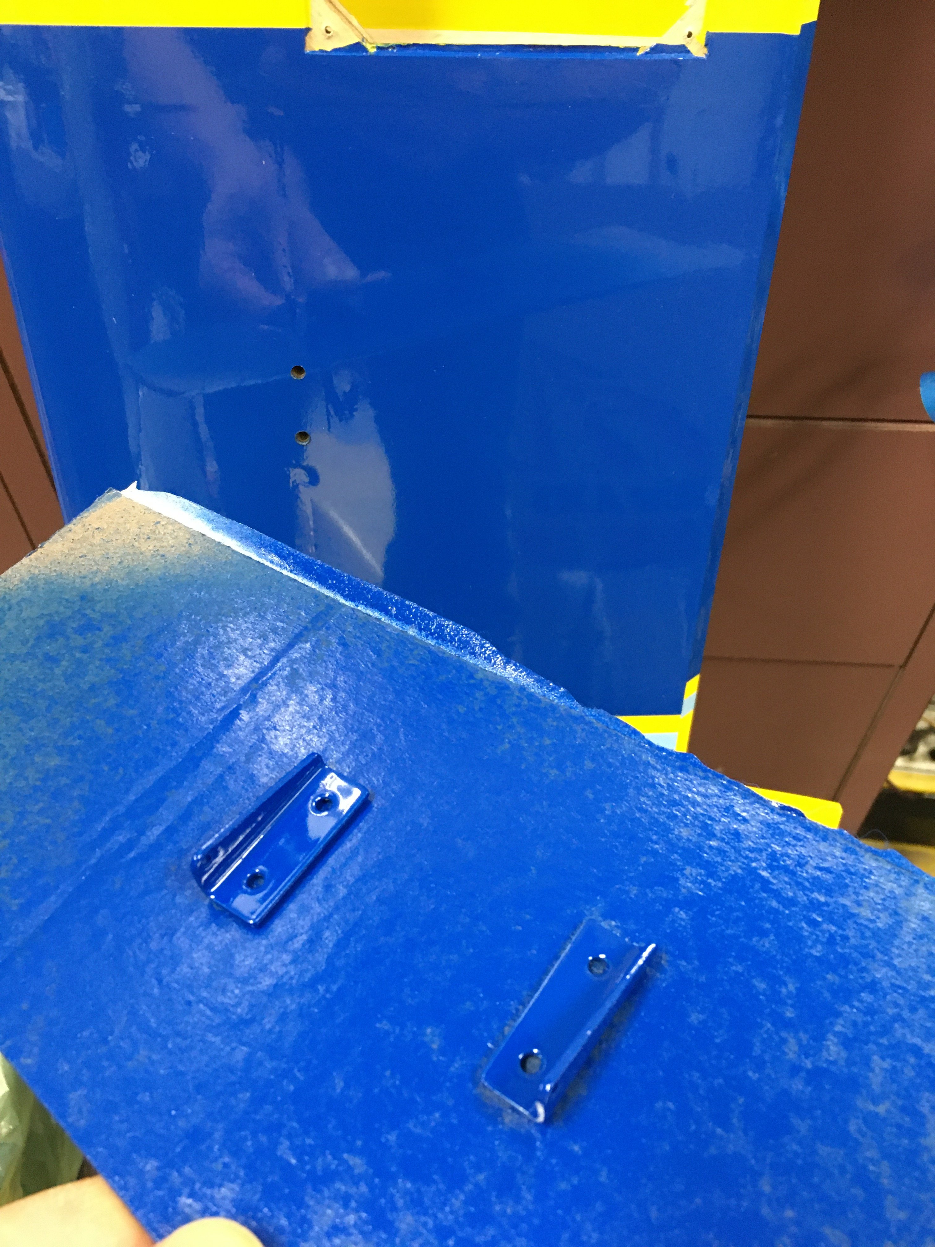

    painted my wing strut mounts Rustoleum deep blue 2x (x2)

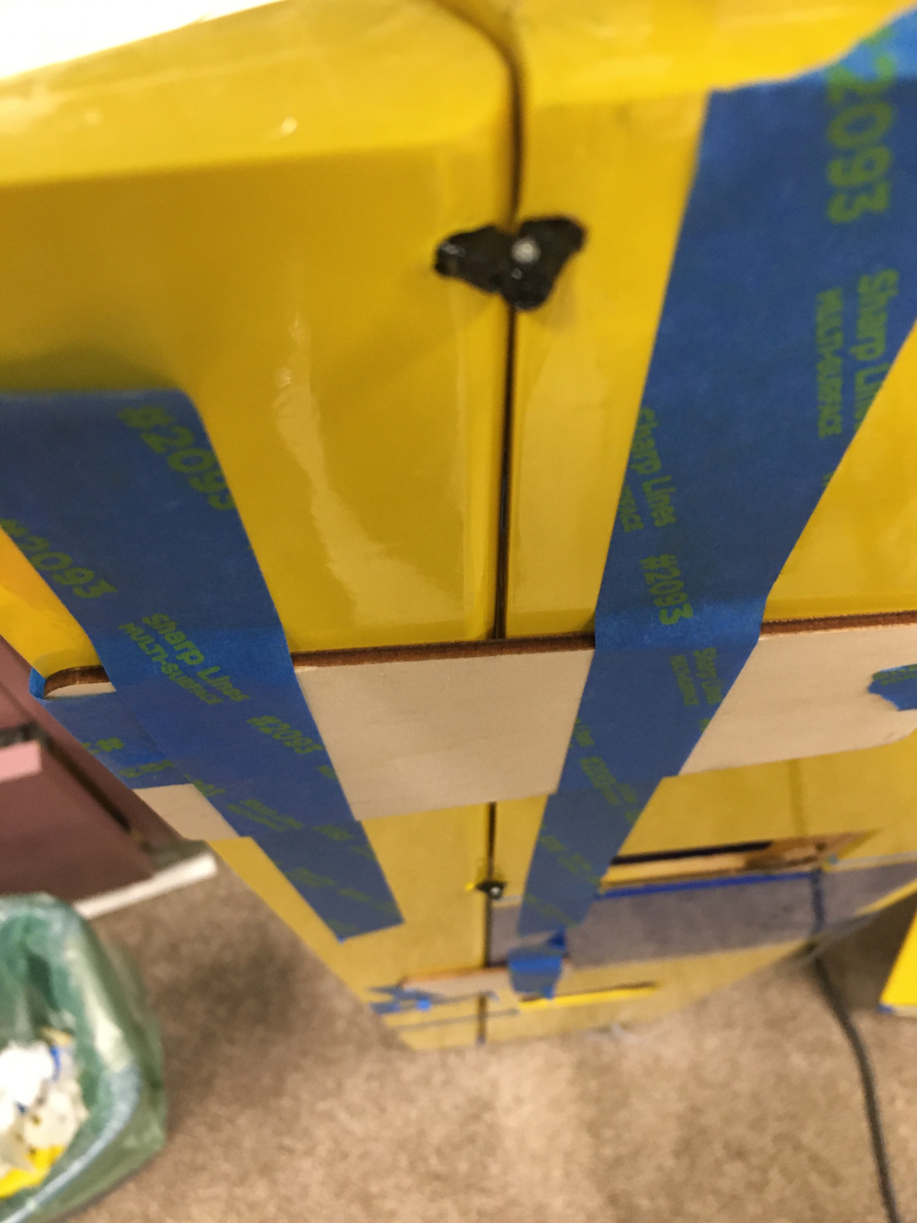

    Glued my flap hinge points. They were a bit tricky to get aligned but utilizing some scrap ply to keep the flap flush with the lower wing it all worked out. Did each flap separately to maximize my 30min pot life.

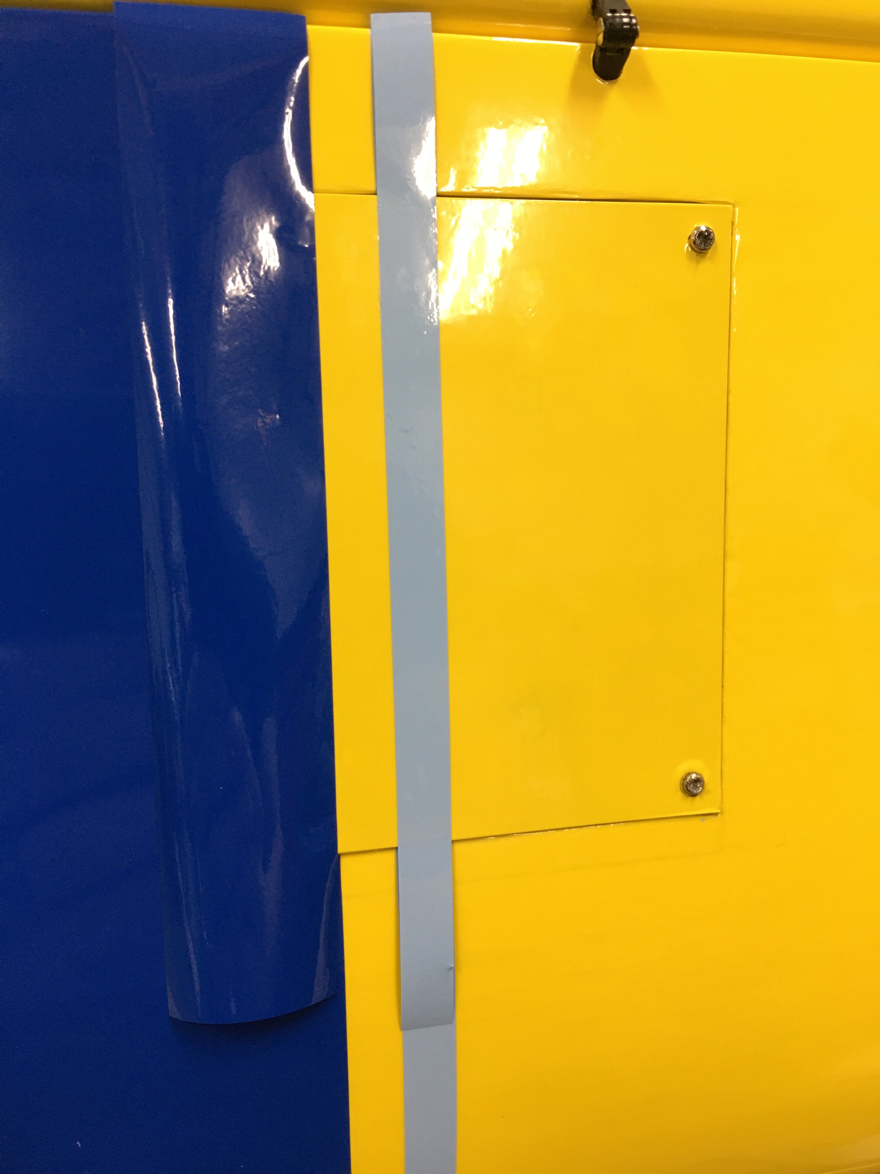

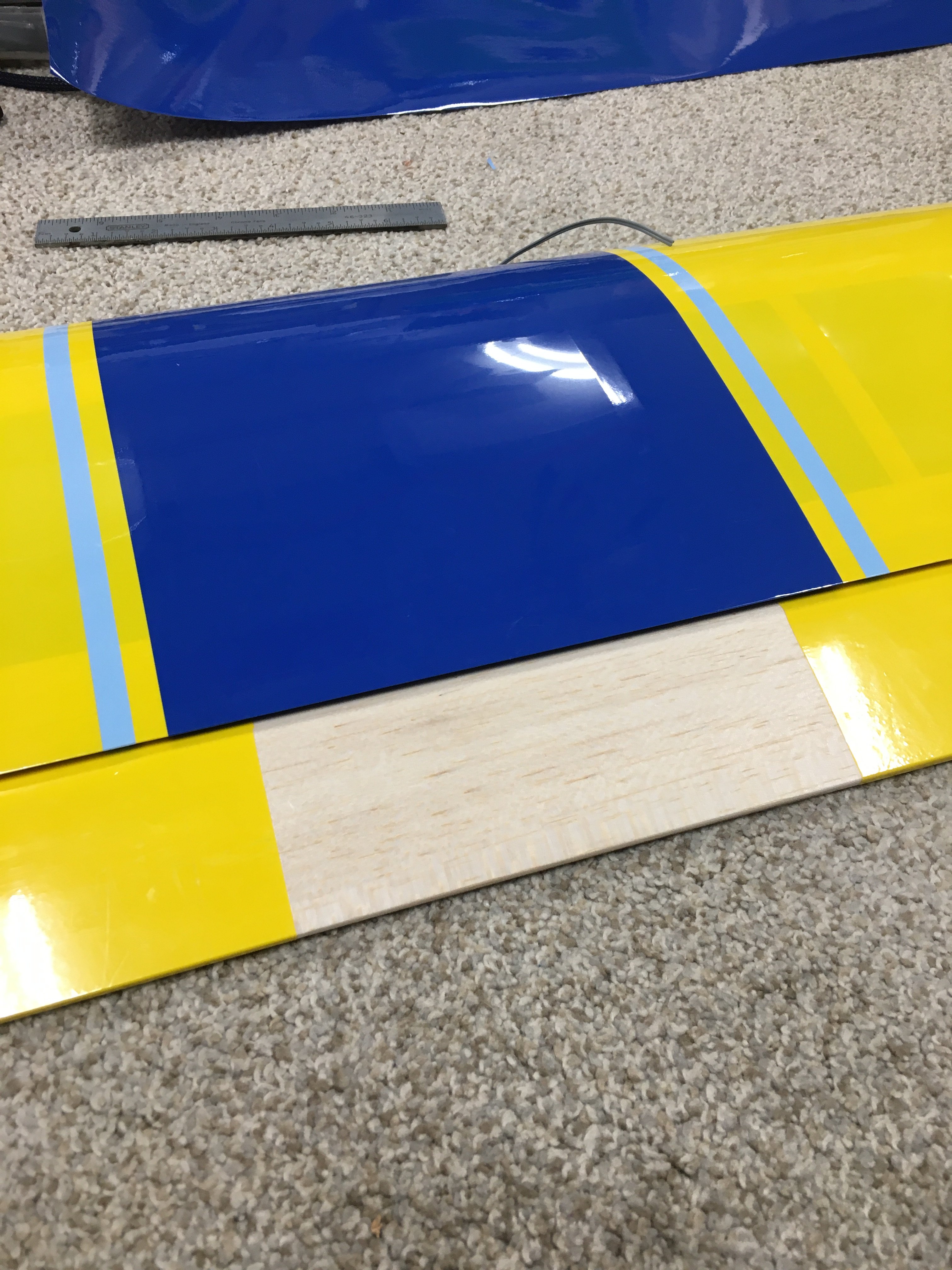

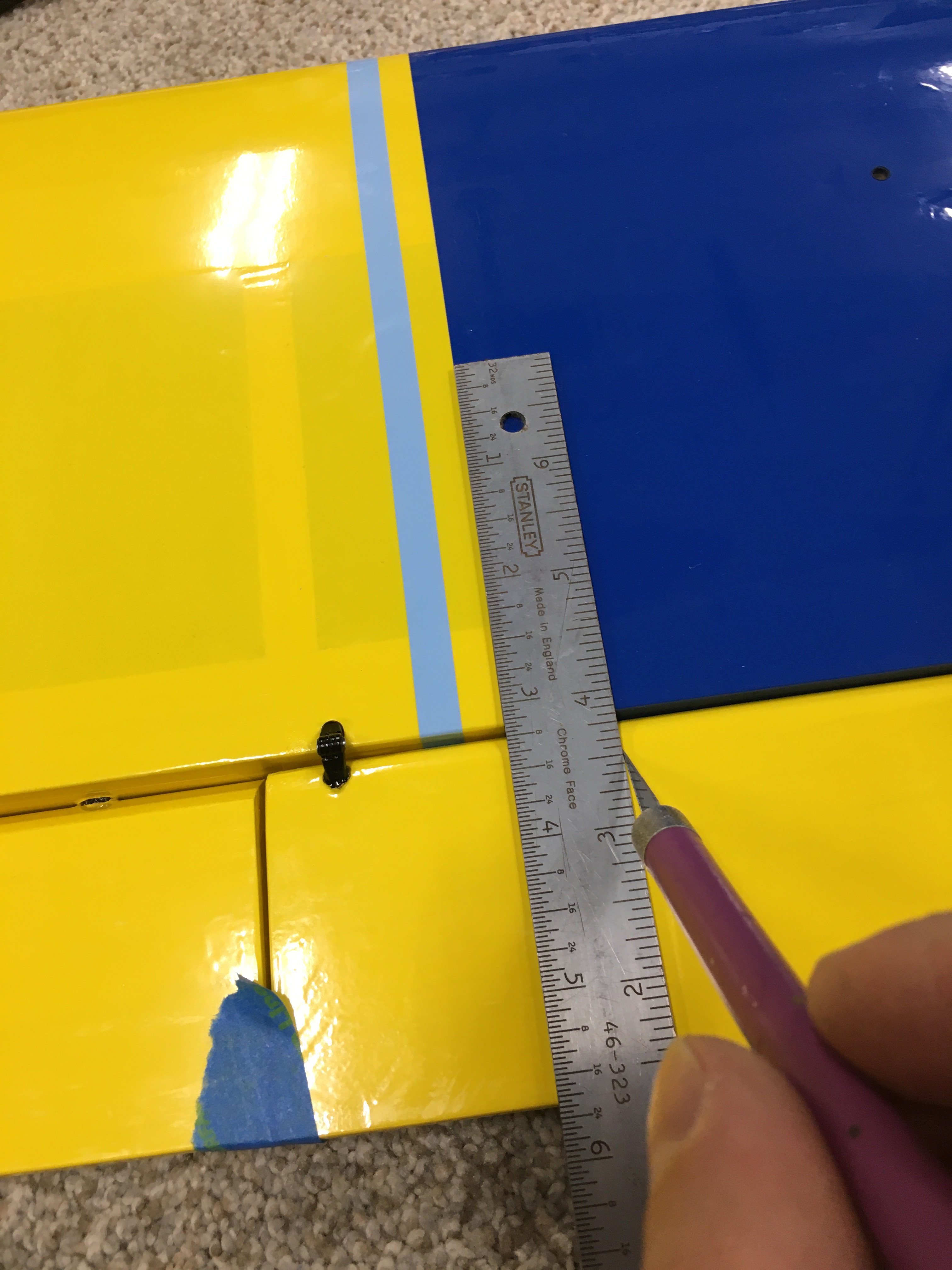

    Put my flap trim on.
