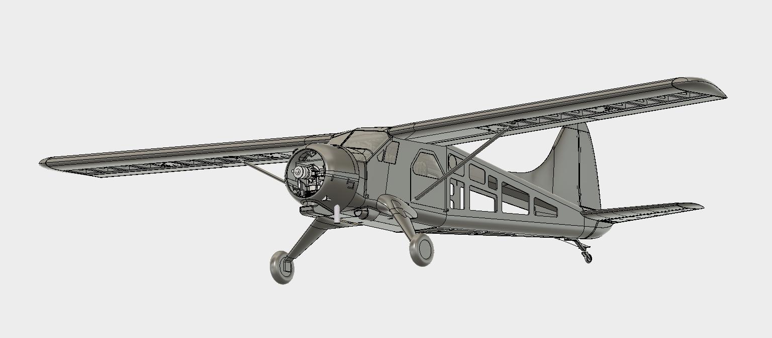

Modern 3D CAD Designed with 100% scale outline from the real deal. Laser Cut interlocking tab and slot parts in which minimize the need to build over the plans! Two piece wing plugs in over a carbon tube. Fiberglass cowl, wingtips and landing gear fairings. Vacuum molded windows, seats, oil cooler, intake (two options lower/upper induction), and tail fairings.
Features removable windscreen for access, fowler flaps, full hardware kit, plus MANY customizable features! Floats are still being designed from the mfgr at this time.

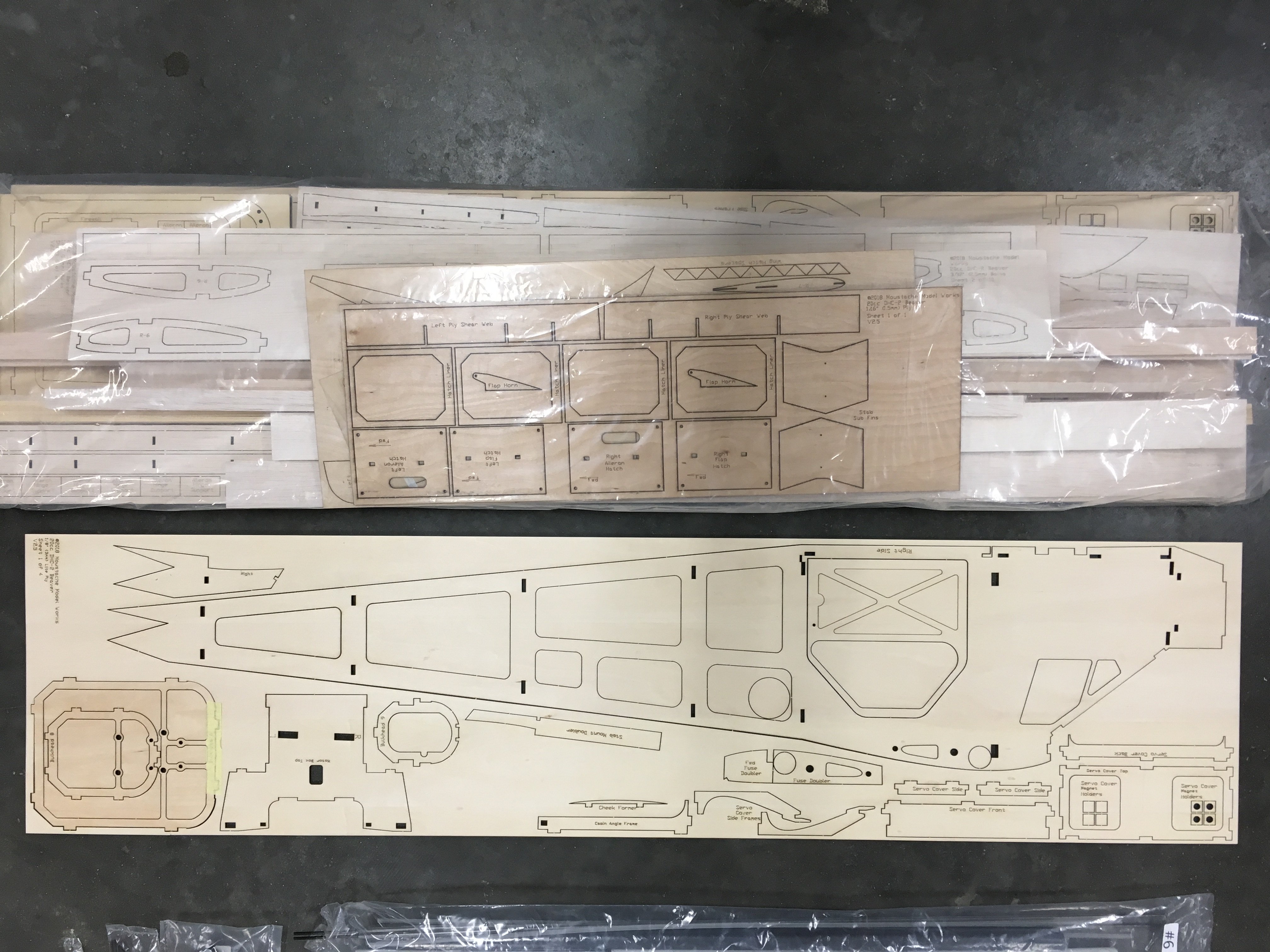

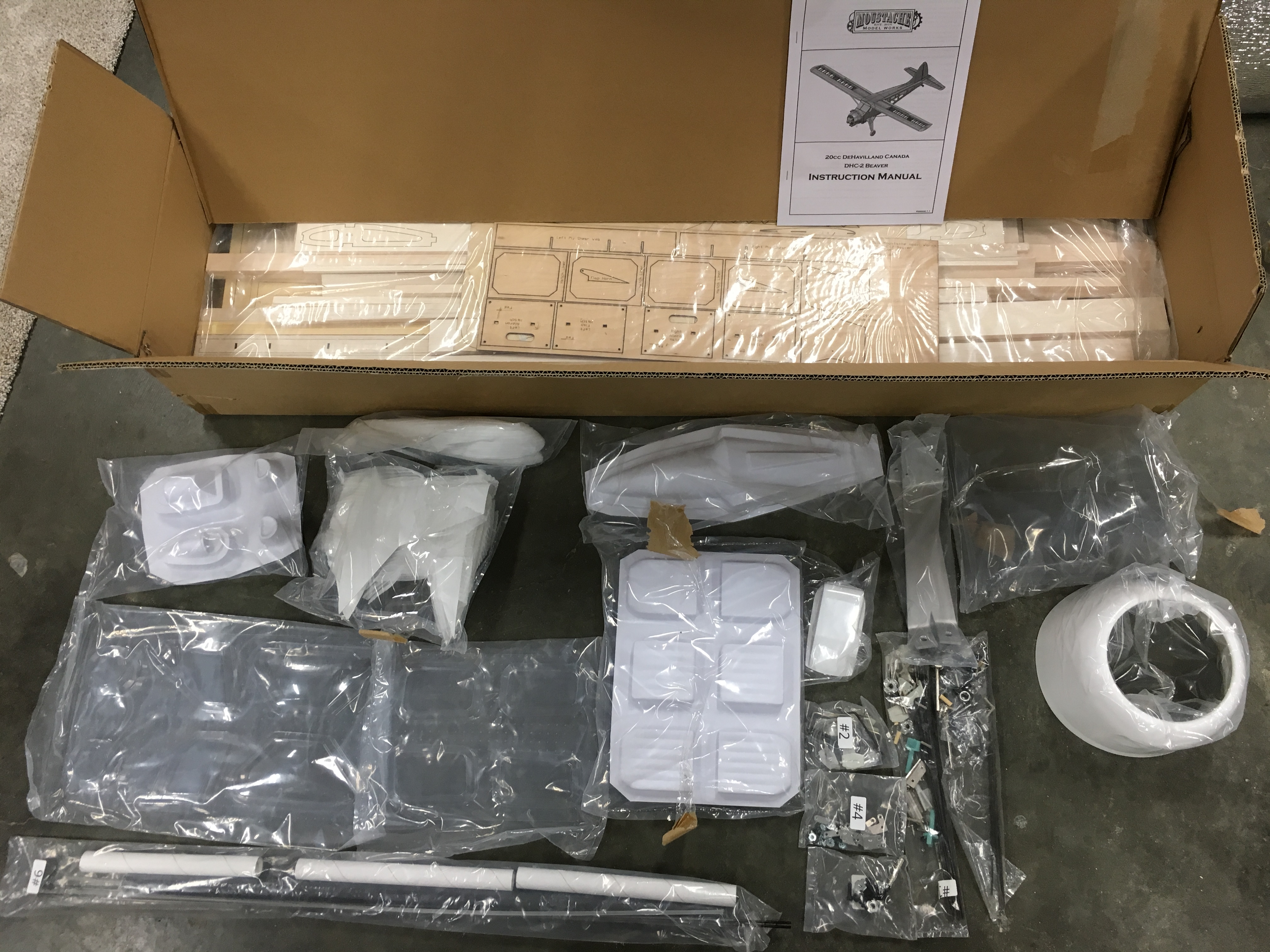

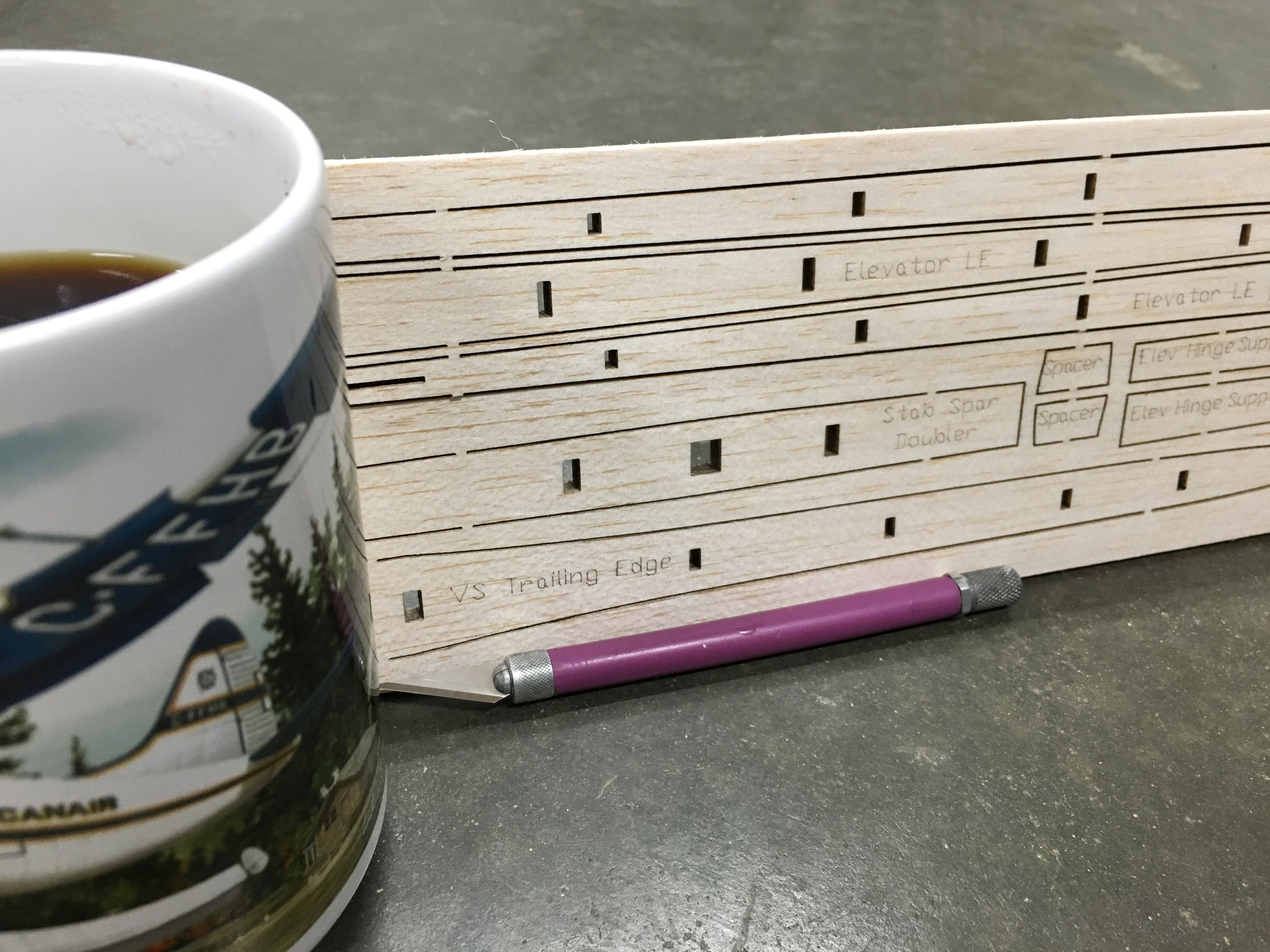

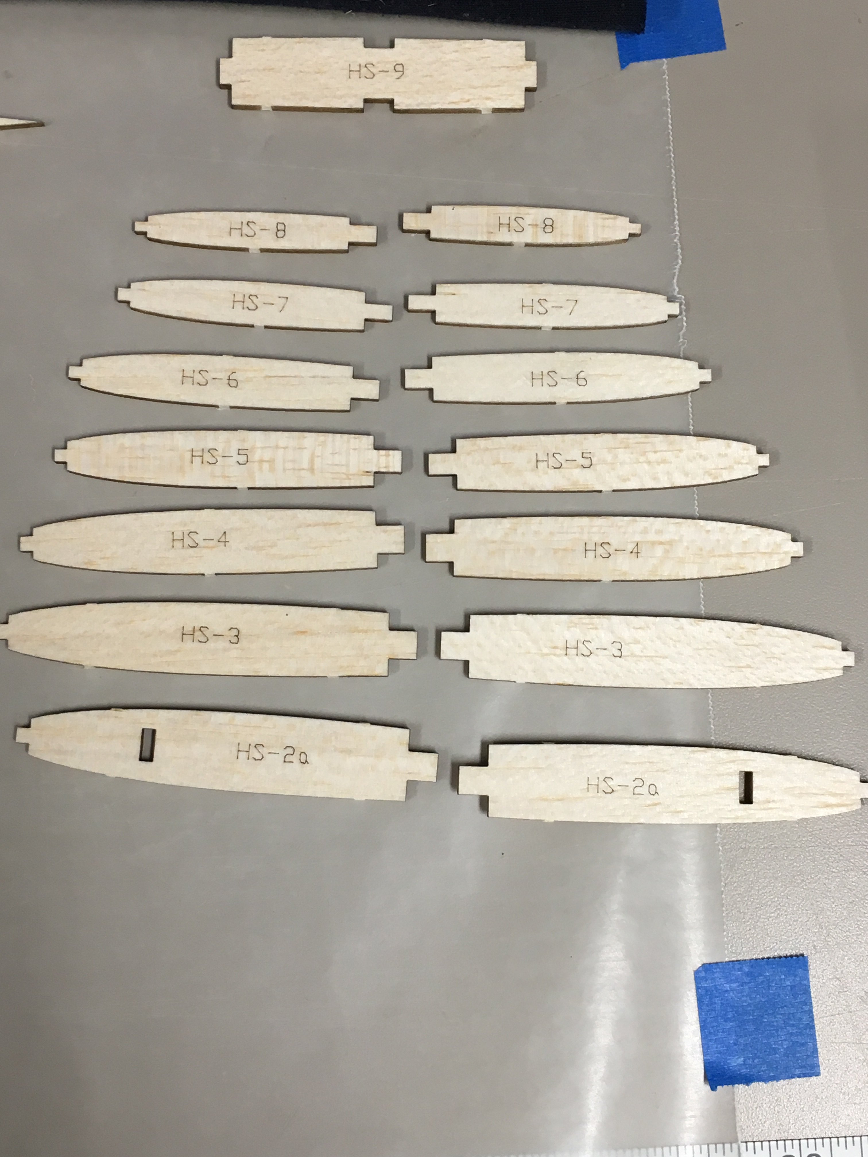

I’m trying. Gotta wait for baby nap time. David included a mug for those who were in the startup program. Punched a lot of parts out with a baby in my lap until I got puked on about three times... that slows production ha ha ha!!!!
Everything is cut very well and labeled great!

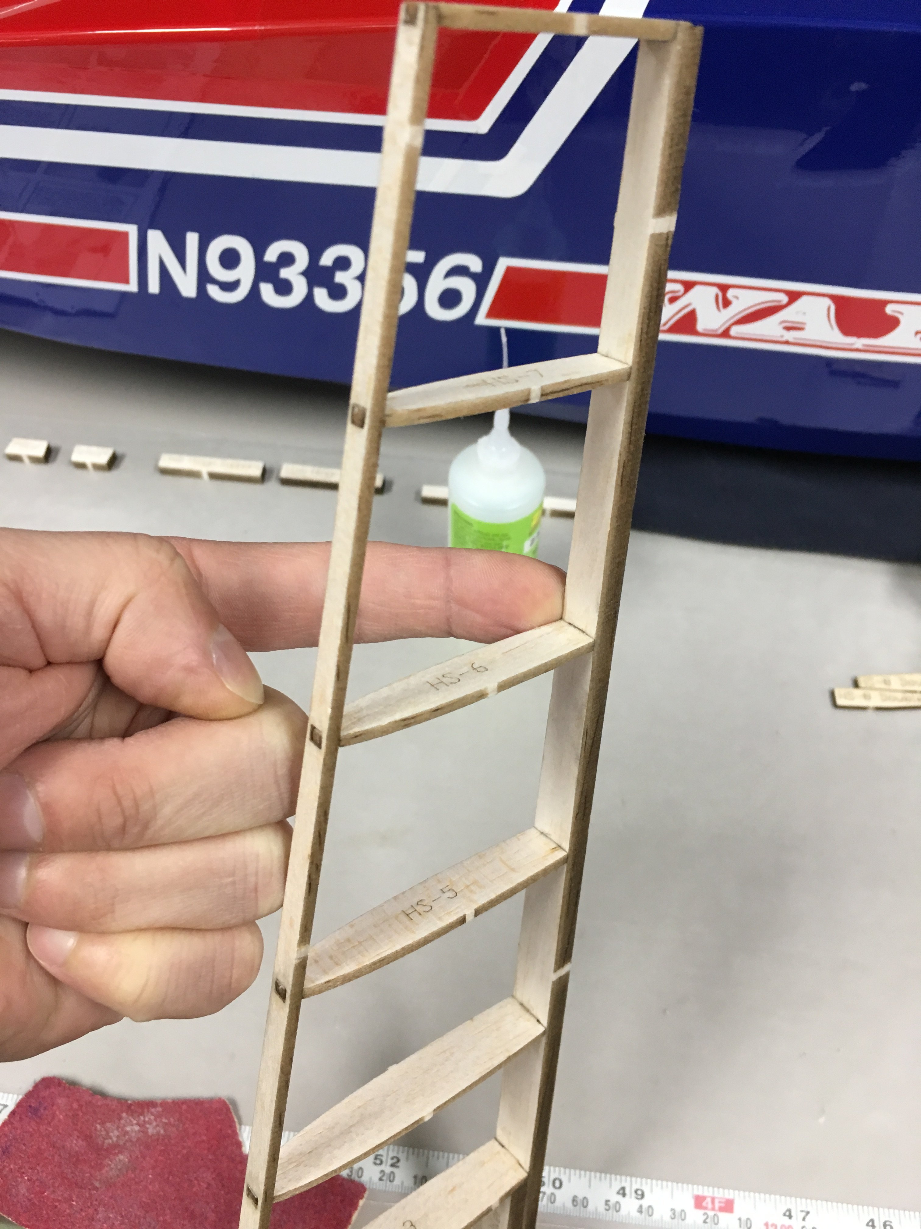

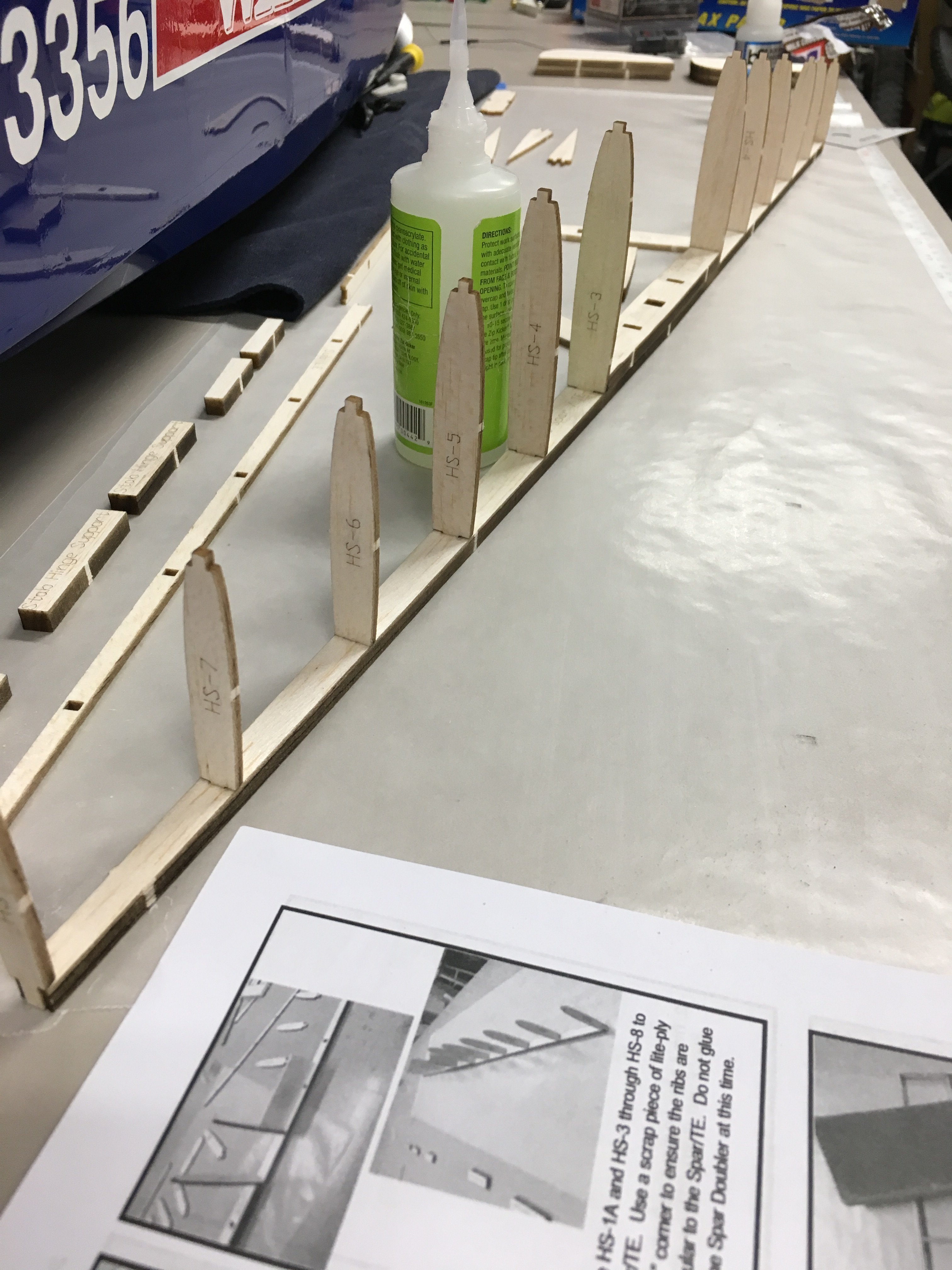

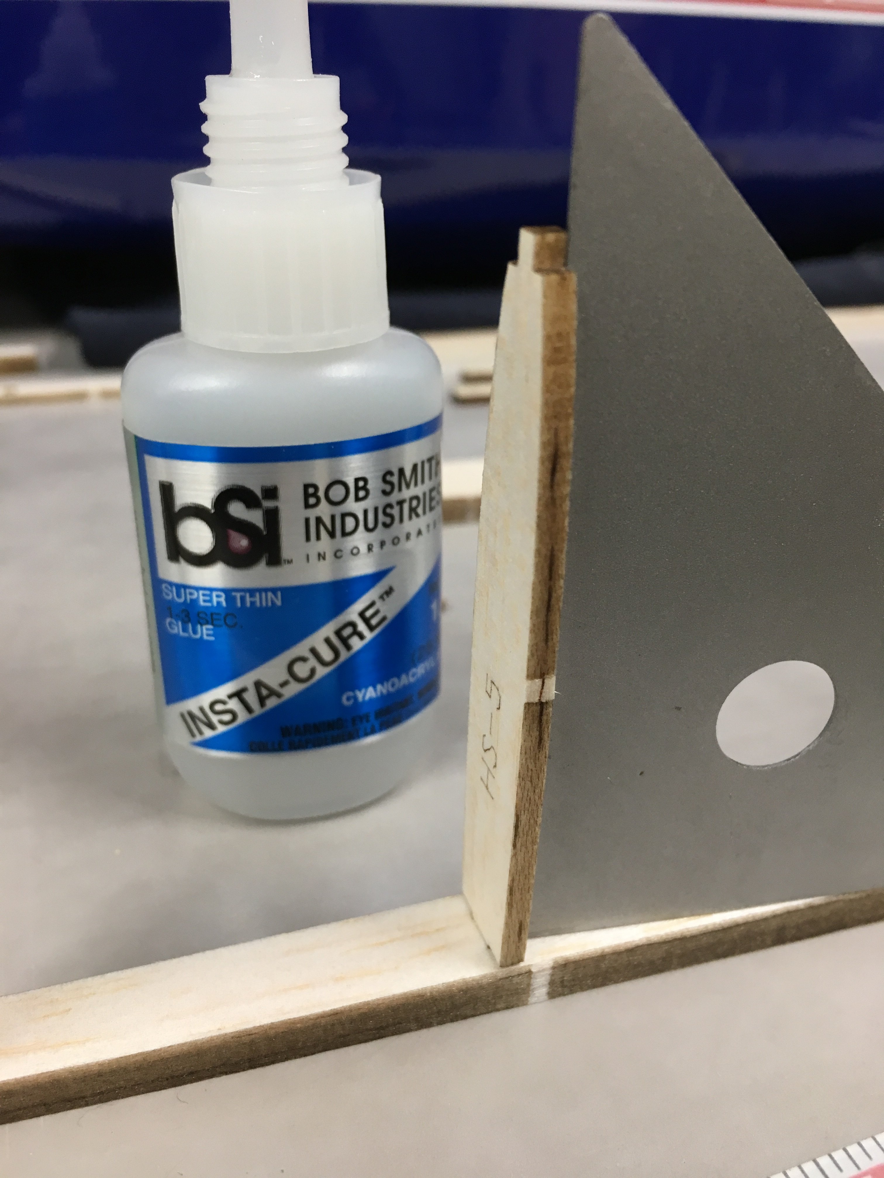

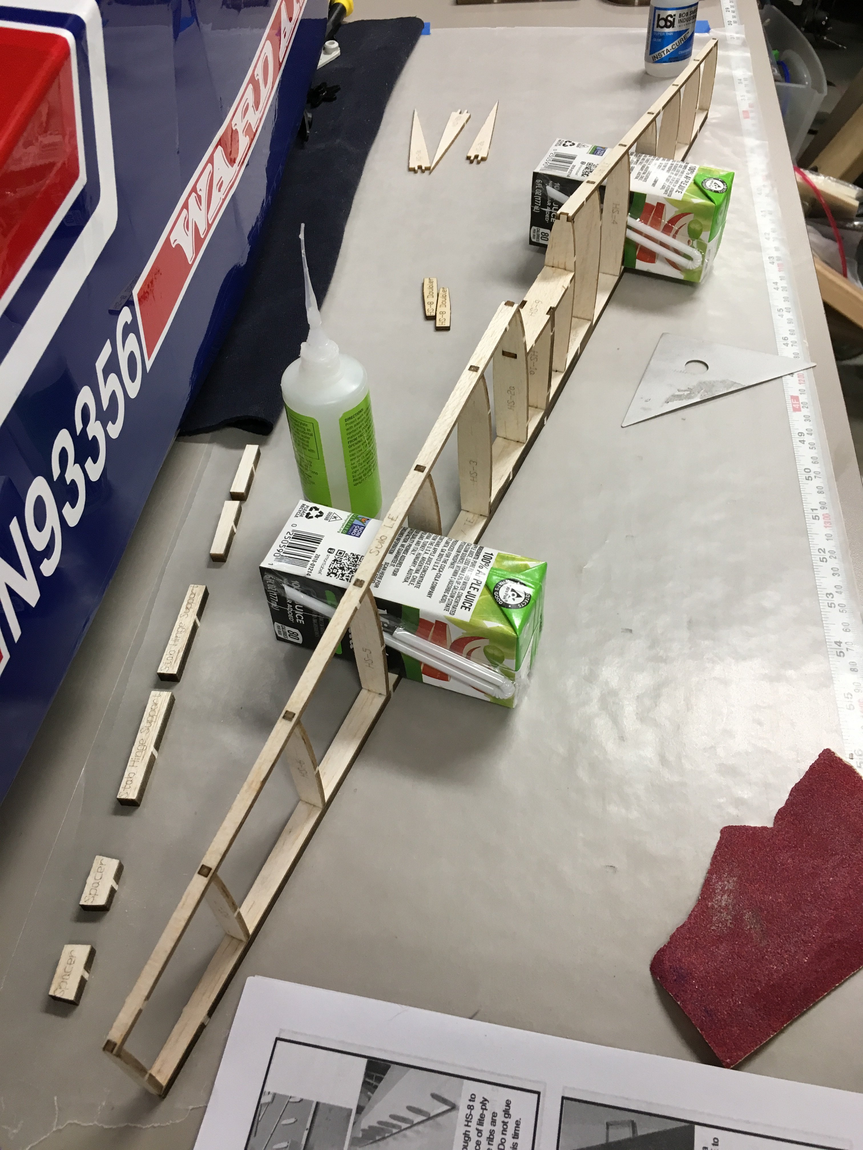

Decided to work on the horizontal stab. Pretty strait forward. Glued the frame without plans or pins. A tiny drop of thin CA to tack them in place once aligned then hit it with medium CA once satisfied with the trueness of everything.
Well That escalated quickly!!!
Looking good, the balsa looks good to. The leading edge with squares makes for a nice alignment.
Are you working or are you also quarantined at home.
