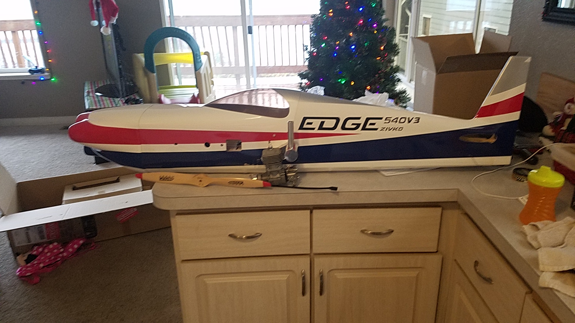

Assembled the stabilizer and glued on the elevators. Installed the servos and linkage. Installed the rudder and the rudder servo.
Had no problems at all every thing was square and level just had glue it all in that does not happen to often.
I know this is an old thread but hoping to get some insight. I purchased this same plane and the build instructions are lacking. Did you use a single servo on the elevator or duel? The kit came with 4 horns in the elevator pack and feels like there are servo mounting points on both sides of the fuselage, how ever all the pictures I can find and the instructions only show a single servo?

Have only one Servo on the elevator.

Good looking plane. It looks like the tail builds like many smaller electrics (ie EF64" MXS) and requires only 1 servo but the other side of fuse will accommodate the rudder and an additional elevator servo if you decide to split the elevator joiner. I would do this only if the planes balance needed additional weight in the back but rarely have I seen an ARF of any brand coming out nose heavy with the recommended set up. I considered that plane myself for the RCGF 26 I have. Good luck and post up your build :)
I keep looking at the plane and I feel I should strip it down and make as many changes as I can to remove weight. I think it may be possible to take a good 5 oz still debating with my self if it is worth the trouble or will I even notice the difference.

What does it weigh now and with what engine/muffler?
The plane weight is 8lbs 8oz ready to fly on fuel. What I get from most of the threads that a 20cc plane should weigh less than 8 lbs. ideally a 20cc should be 7-1/2 lbs I will never get it that low. I do not think I could get down to 8 lbs.
The engine is a OS GT22 with a pitts typ muffler.
