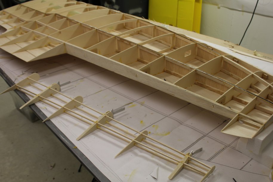

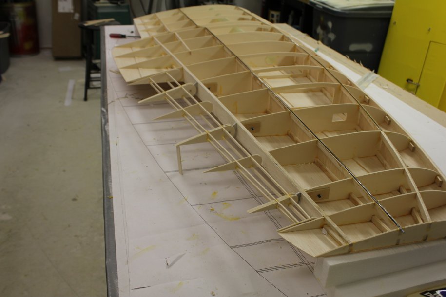

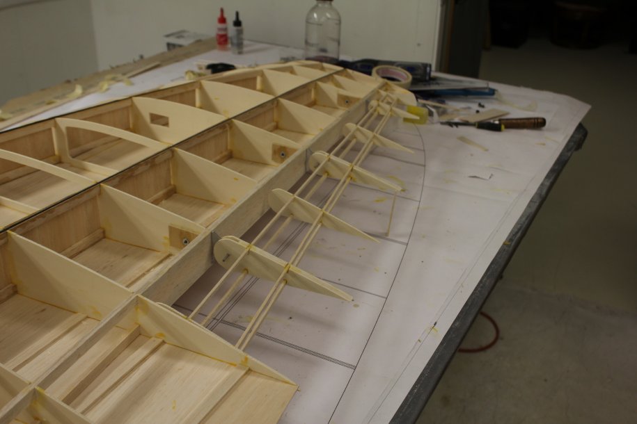

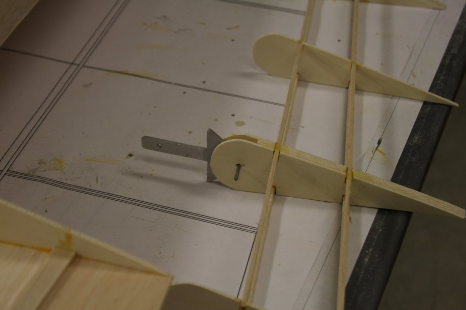

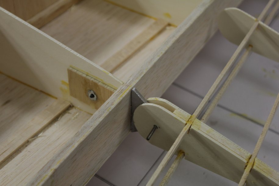

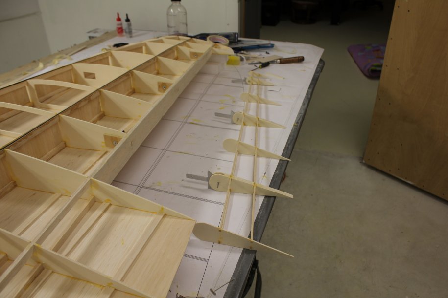

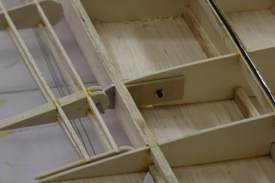

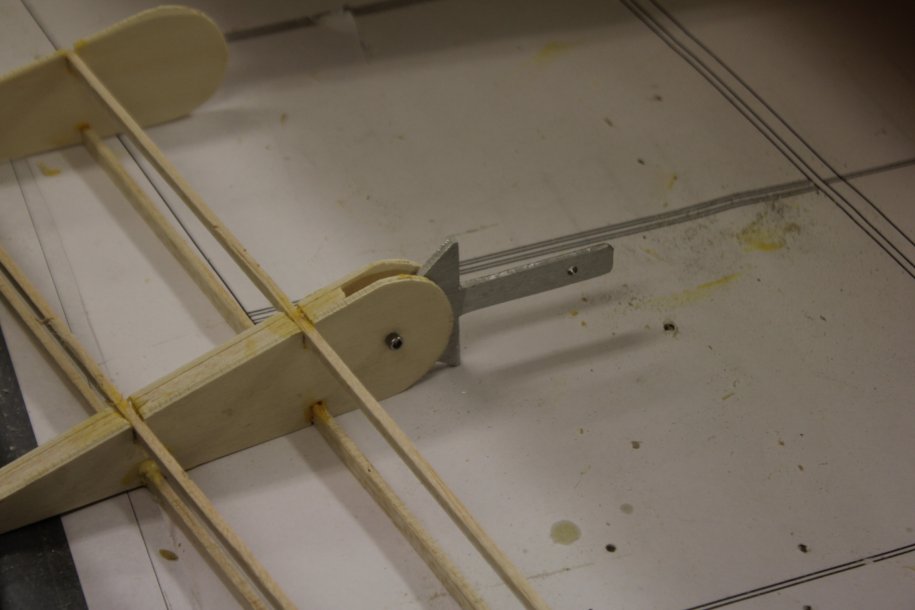

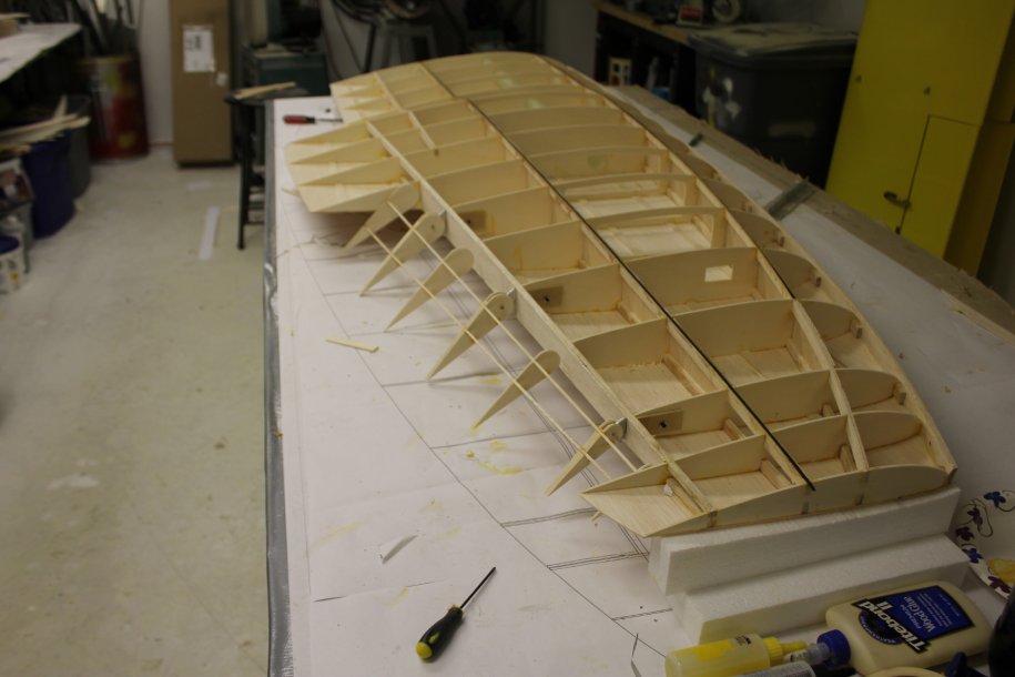

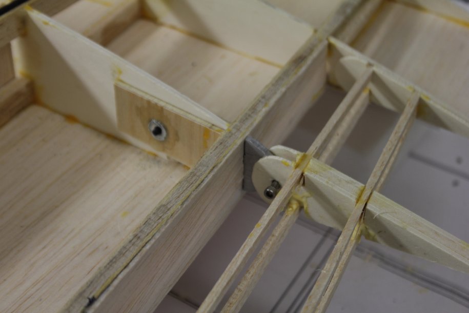

Here is the start of the aileron. The hinge pin will be a 4-40 bolt shaft with a little thread left for the bolt. The hinge will slide in and out of the wing while I build it. Once the wing and aileron is done I will add the bolt into the blind-nut which holds the hinge in through a small hatch in the bottom of the wing.
