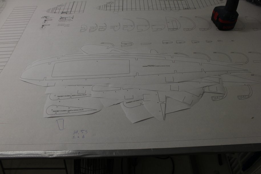

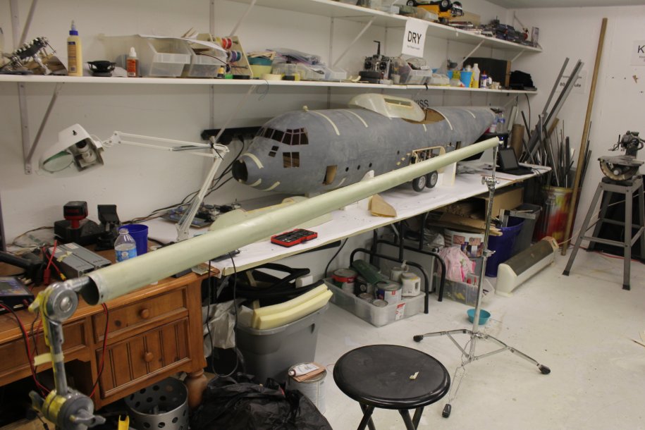

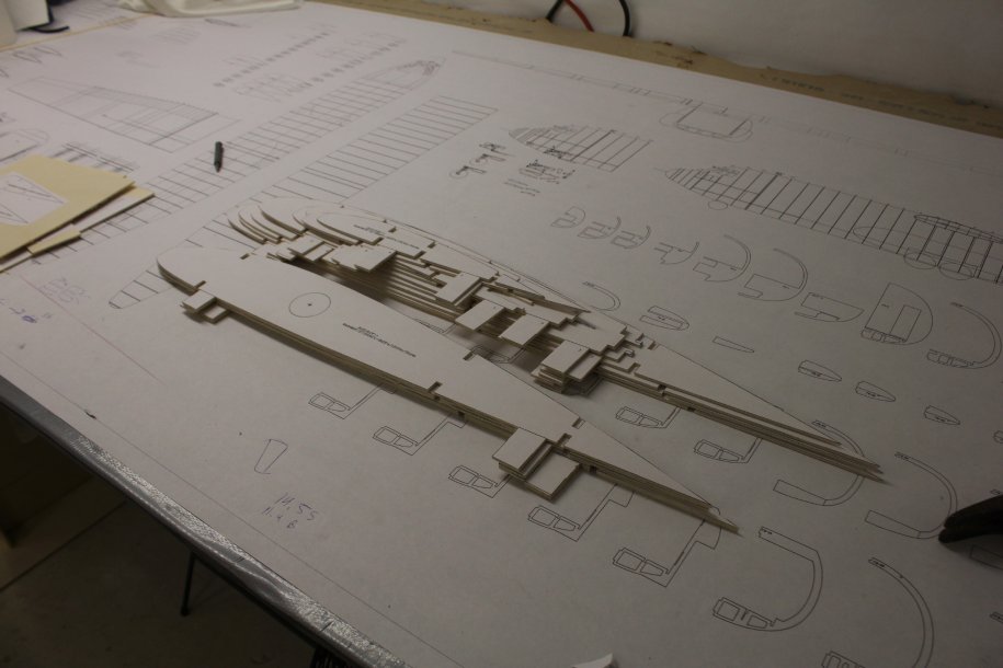

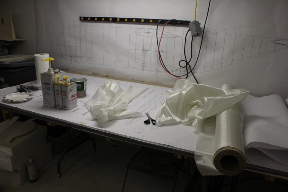

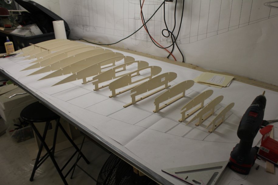

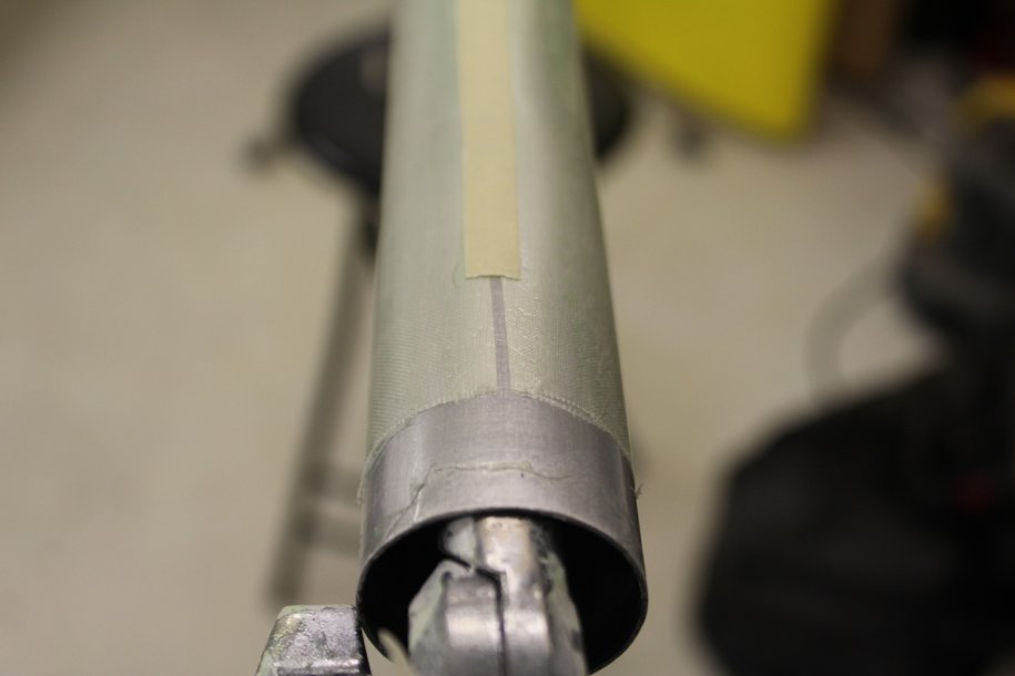

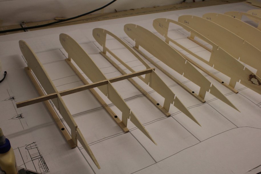

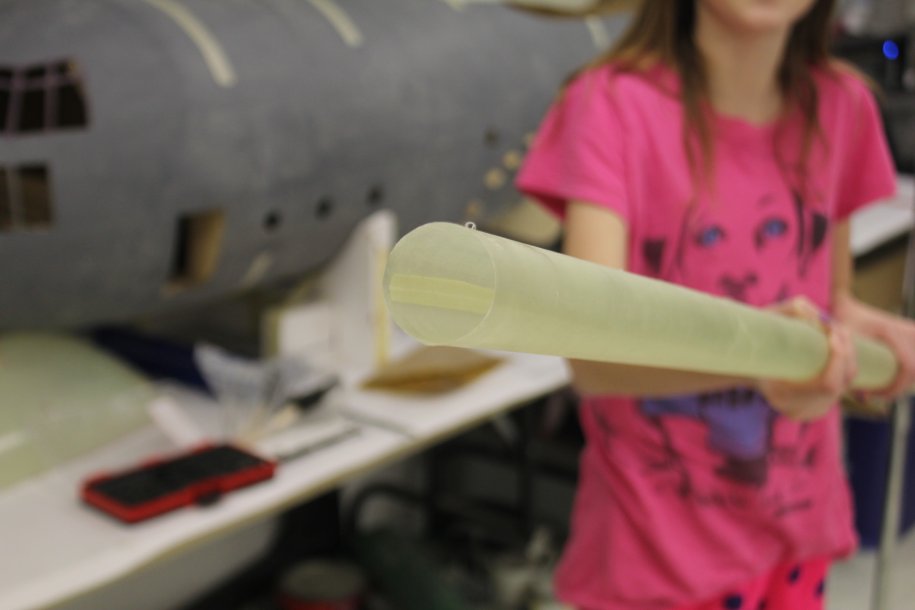

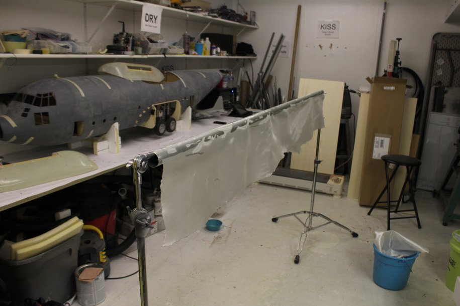

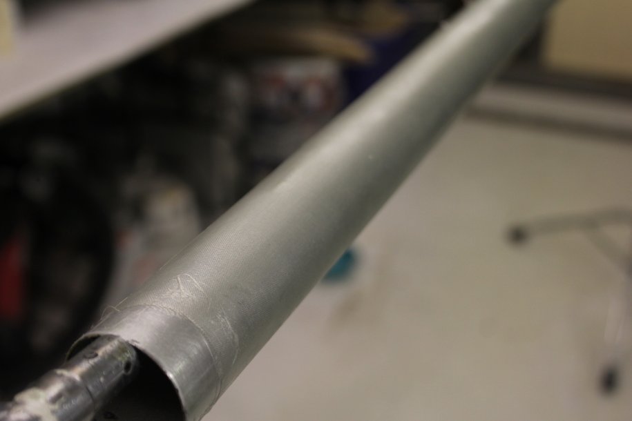

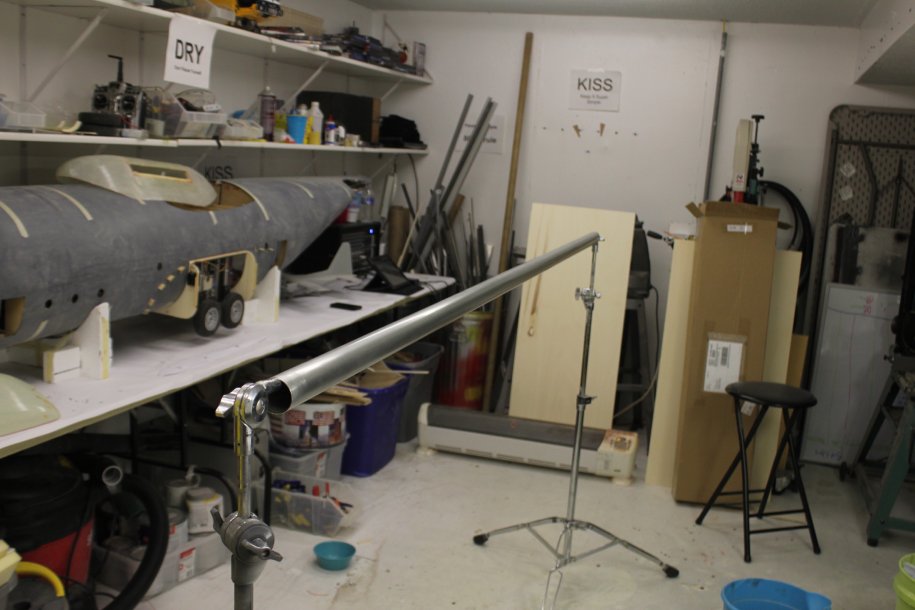

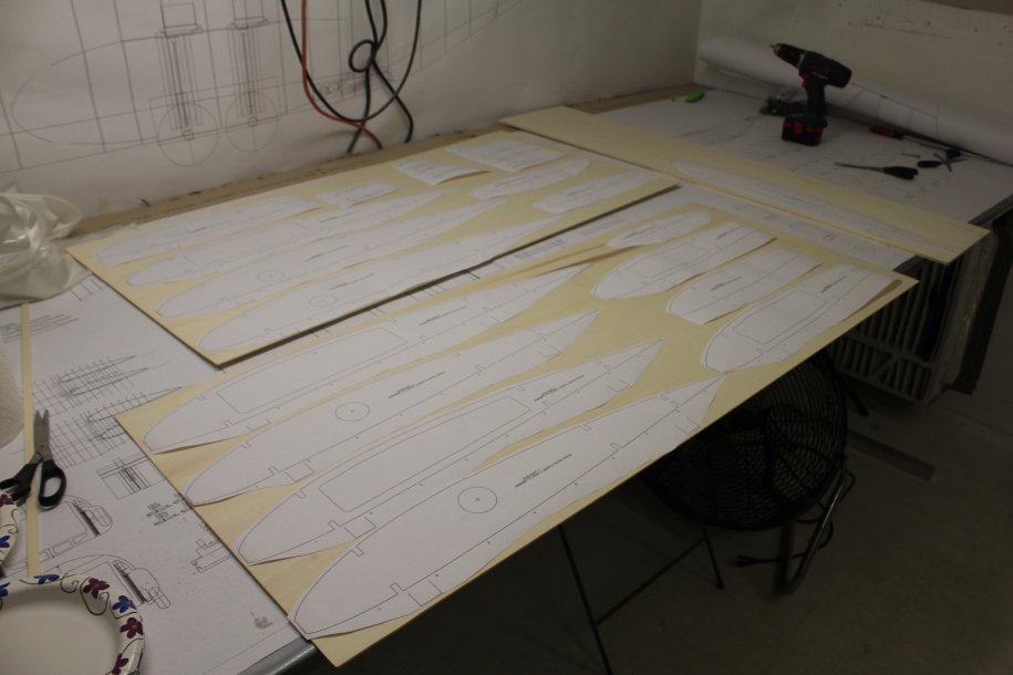

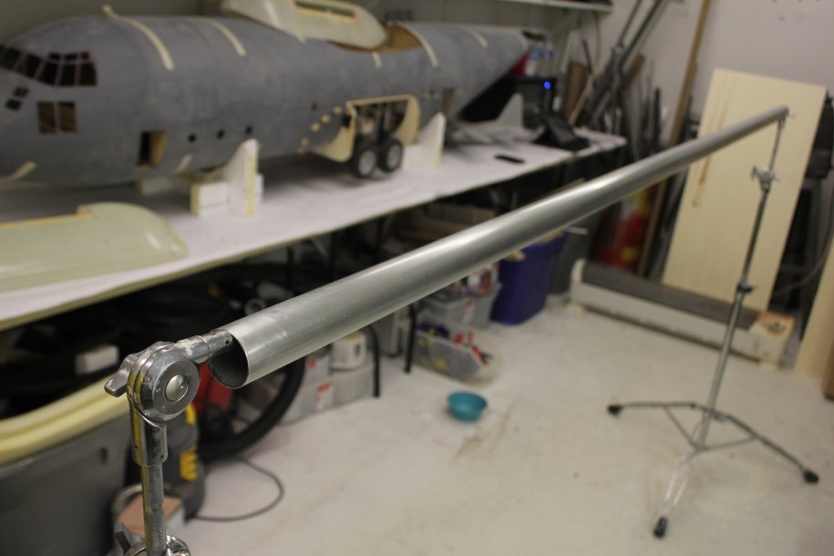

This covers the cutting and set up of the ribs (right wing), plus making my wing tube. The darker tube is what I made a long time ago and I hated it as it was very heavy. The new one is spot on. Making my own wing tubes is cool as everything I do is big, and finding big wing tubes is hard, plus mine are just cool
. But they are a huge pain to make as you have to split it off the 1.5" tube and then wrap it one more time. This is due to the fact it would be way to tight.
Rock ON! DAG

Was a late night last night, but boy do I love it when a plan comes together:):):):):).
The wing tube slid right in and fits perfect.
DAG
