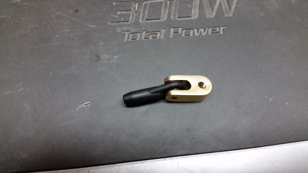

Came up with a cheaper solution to spending $70 on new hardware.
Won't work. I tried that when I first tarted flying. Wasn't with PAU hardware but the end result is the same. The link will swivel around the ball and it won't stay in trim. The clevis has to stay inline with the pushrod.
Terryscustom
I didn't notice any trim issues when I tried it. Interesting..... Mine was on a brand new setup so the clevis was pretty snug on the threaded rod and didn't move freely though. On my Viper prototype I installed these just because it's going to get a LOT of stick time and the servos I used had a little slop so I wanted the tightest setup possible. http://shop.dubro.com/p/heavy-duty-clevis-w-4-40-ball-link-8-32/aircraft_control-horns?pp=12
I'll probably be switching it over to MKS this Winter to tighten it up more.
I was planning on using red loctite on the clevis. Should be stiff like the full dubro set up.
Also my thought on that was the clevis would not move at all and the ball would in relation to the servo turn buckle travel. Or maybe I need to put on my man pants and spend the $70.00 on dubro hardware.
Tseres
This would work if you can insure the clevis not moving on the screw. If I were you I would go through all the clevis' and use the good ones and call Herve. I bet he would replace the bad ones.
Terryscustom
I'm kinda brain storming with you..... Instead of red loctite I wonder if a small nut or nylock would be better in case future adjustment or maintenance is required?
