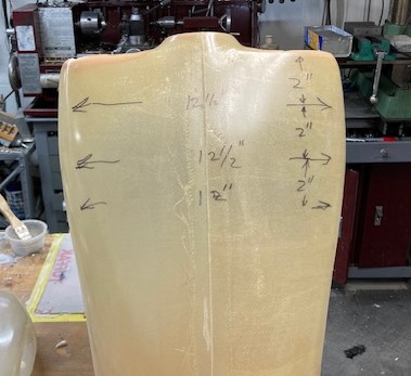

What was your layup on the Fiberglass version. 32 oz sounds very heavy.
If my memory serves me right
1. first layer 2oz
2. second and third layer 4oz
3. fourth layer 6oz cloth and then and extra ring around base for the screws and an extra layer in the nose for spinner and air ducting cutouts.
I do believe my problem was to much epoxy trying to wet it out and it was difficult. I also should of used a lot of paper towels to soak up the epoxy and make it as dry as possible which I did not do. You can also see how the epoxy puddles form in the nose from sitting overnight curing. Not a good job, better next time.
I just weighted the cowl for the 30% Chipmunk, it is a large cowl 12 1/2" wide and 18" long, it is just over 16 ounces. Based on thickness I would say it is about 12 ounces per yard of cloth.
That's one nice job there Snoop.
When you say 12oz you mean any combination that gets you up to 12oz. So mine is 16oz and then some that is to much plus excess epoxy. It’s amazingly how quickly you can add weight to a part. Thanks for the input.

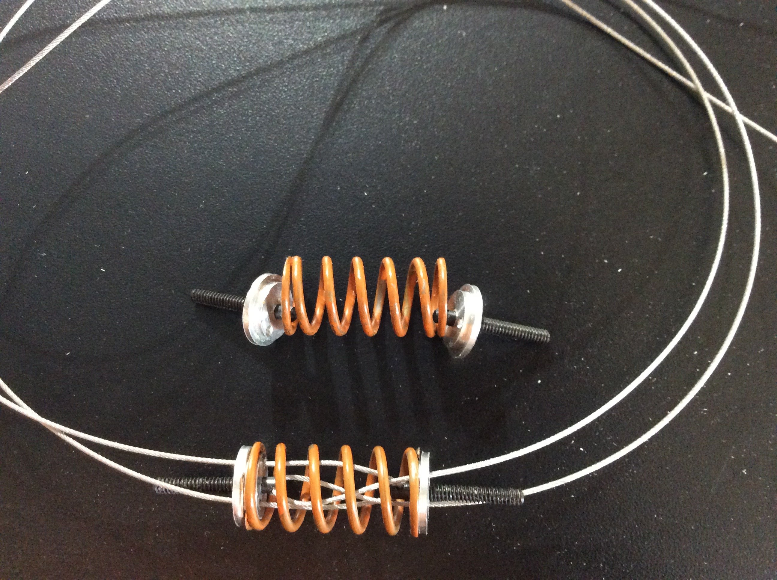

Ok when I was just doing a quick check on the landing gear a while back it seamed it could be on the light side not sure. So I decided to add some pull pull springs to the gear. The springs are good for 30 lbs per inch. This will be built into the gear.
