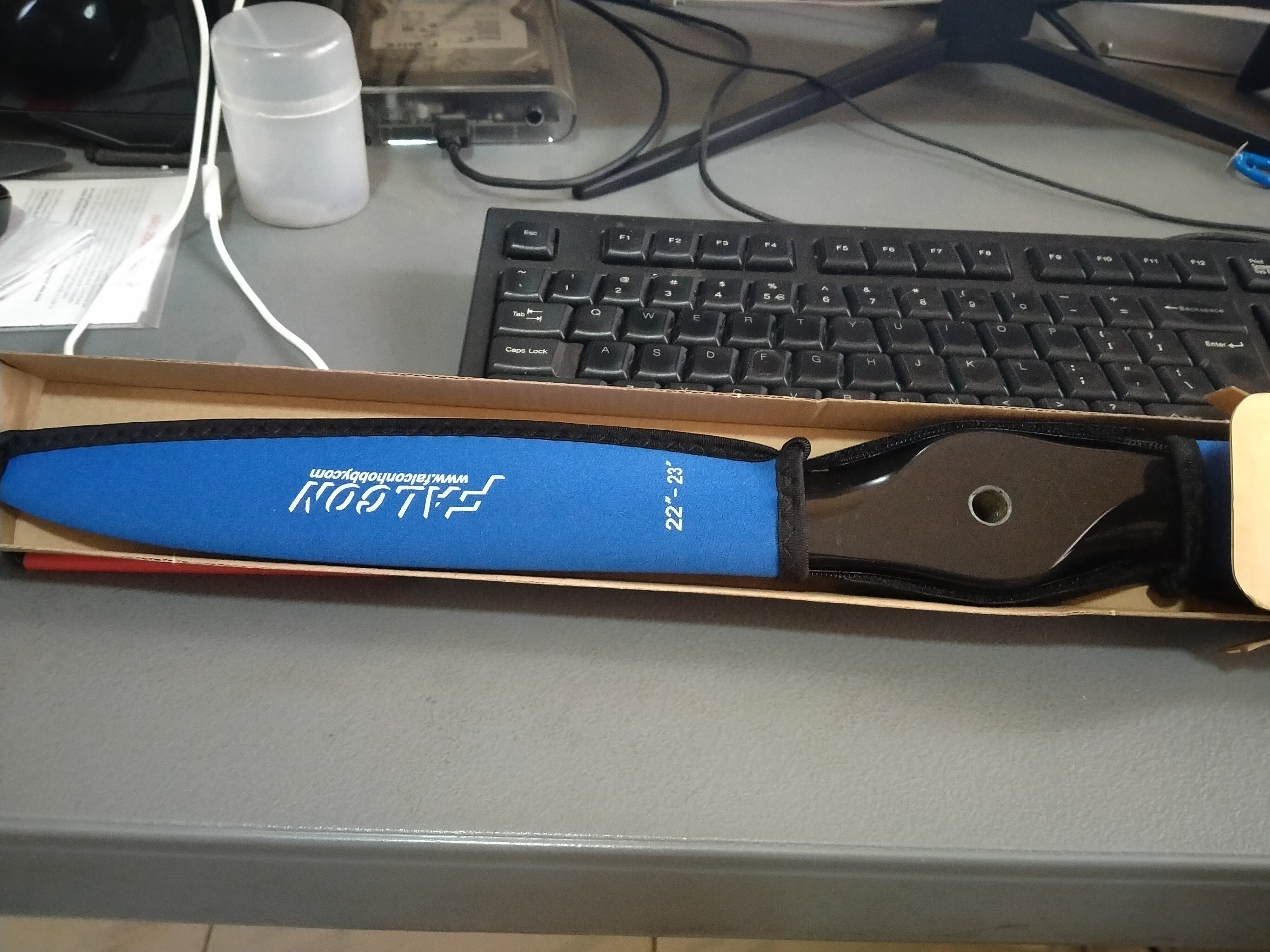

searched the thread in vein, anybody know if the stock prop clearance on the 60cc Cub gear is less or more than the Timber gear? I saw the shortening mods, but I don't have a shop and drill press any more to do it right. still may attempt it however. I want to protect my precious Falcon prop, it's the only one in the Philippines![]()

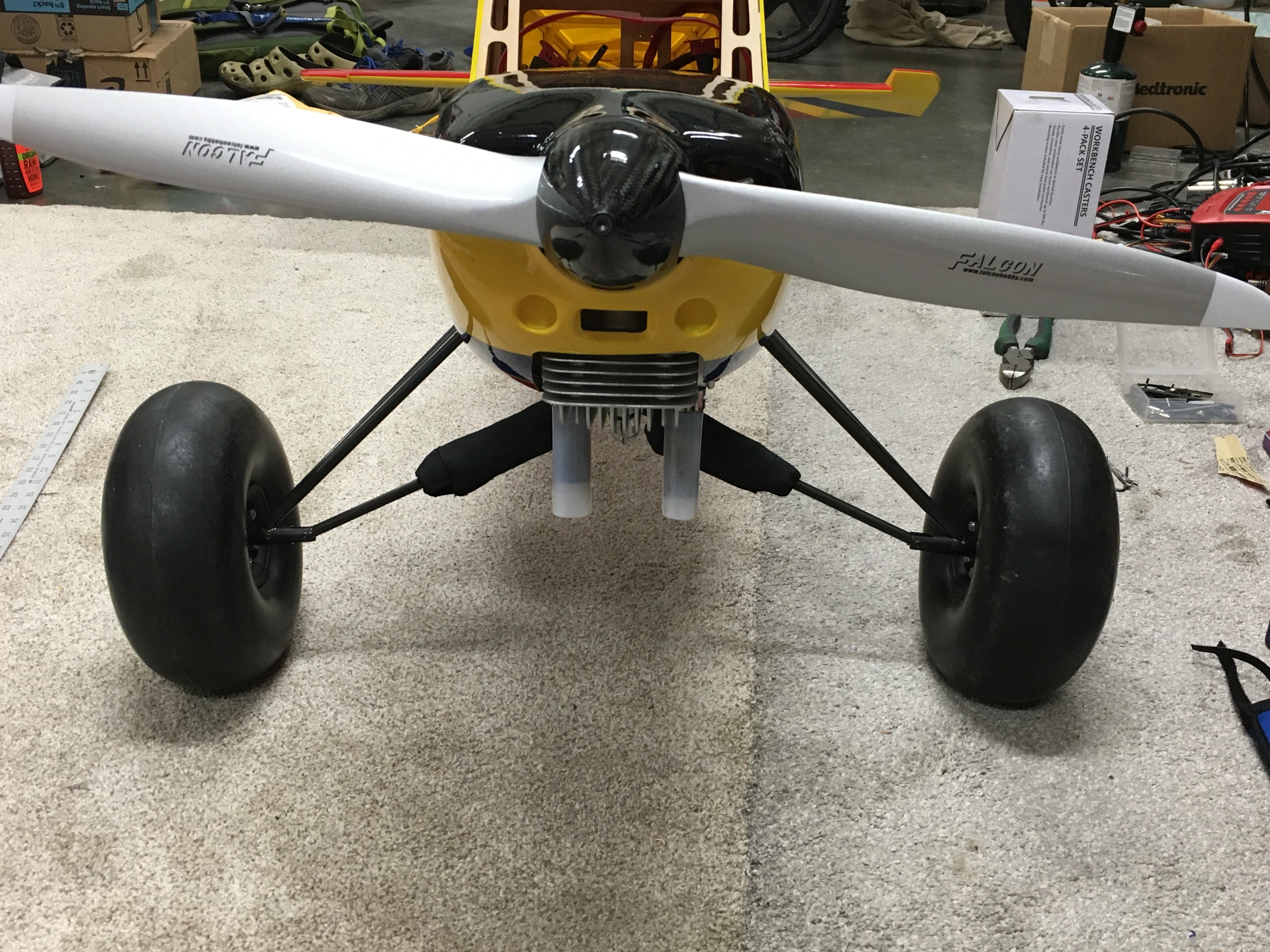

I finally did this mod with the tube length shortened only. I feel like my springs are broken in and flex quite well.

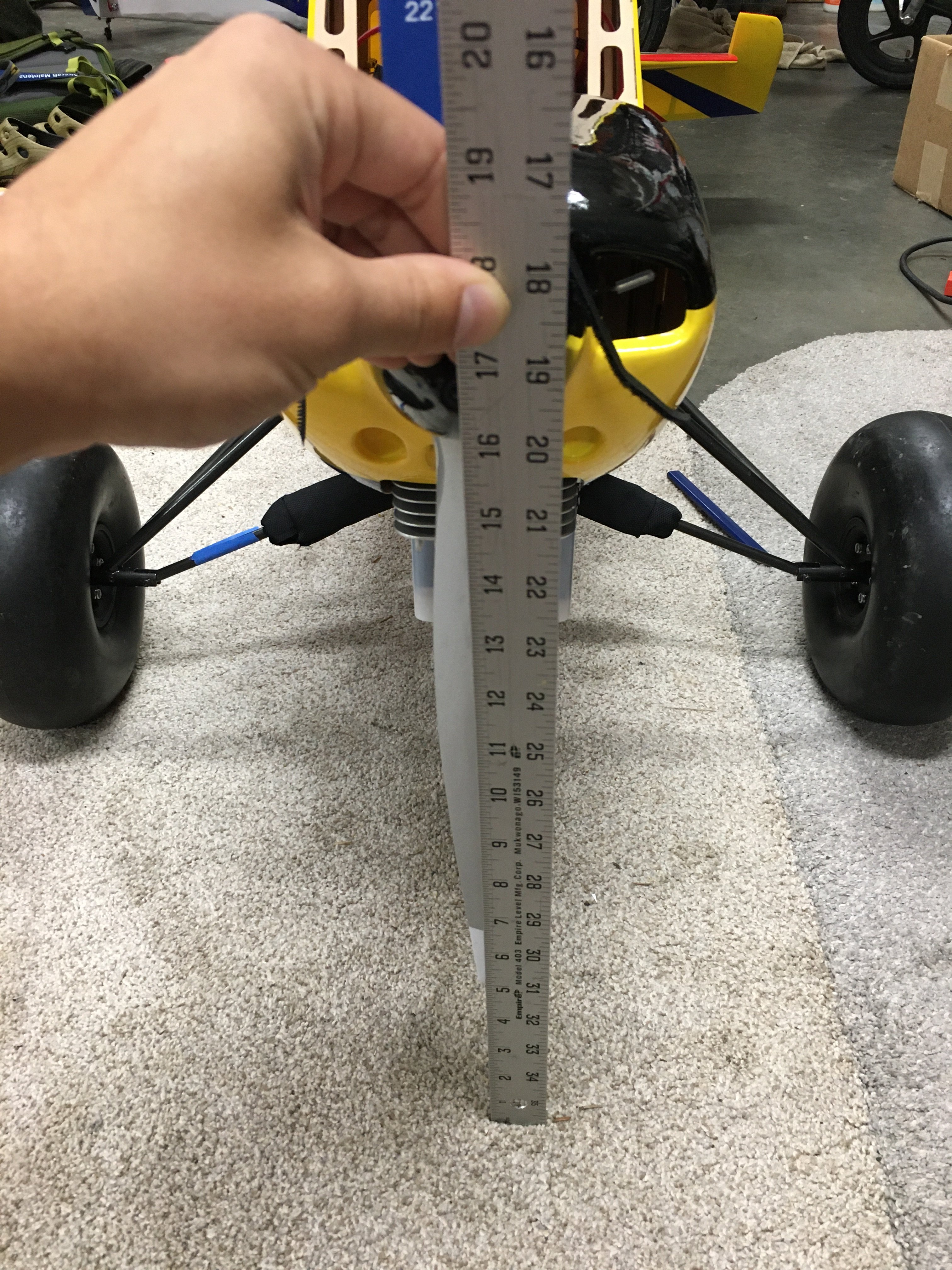

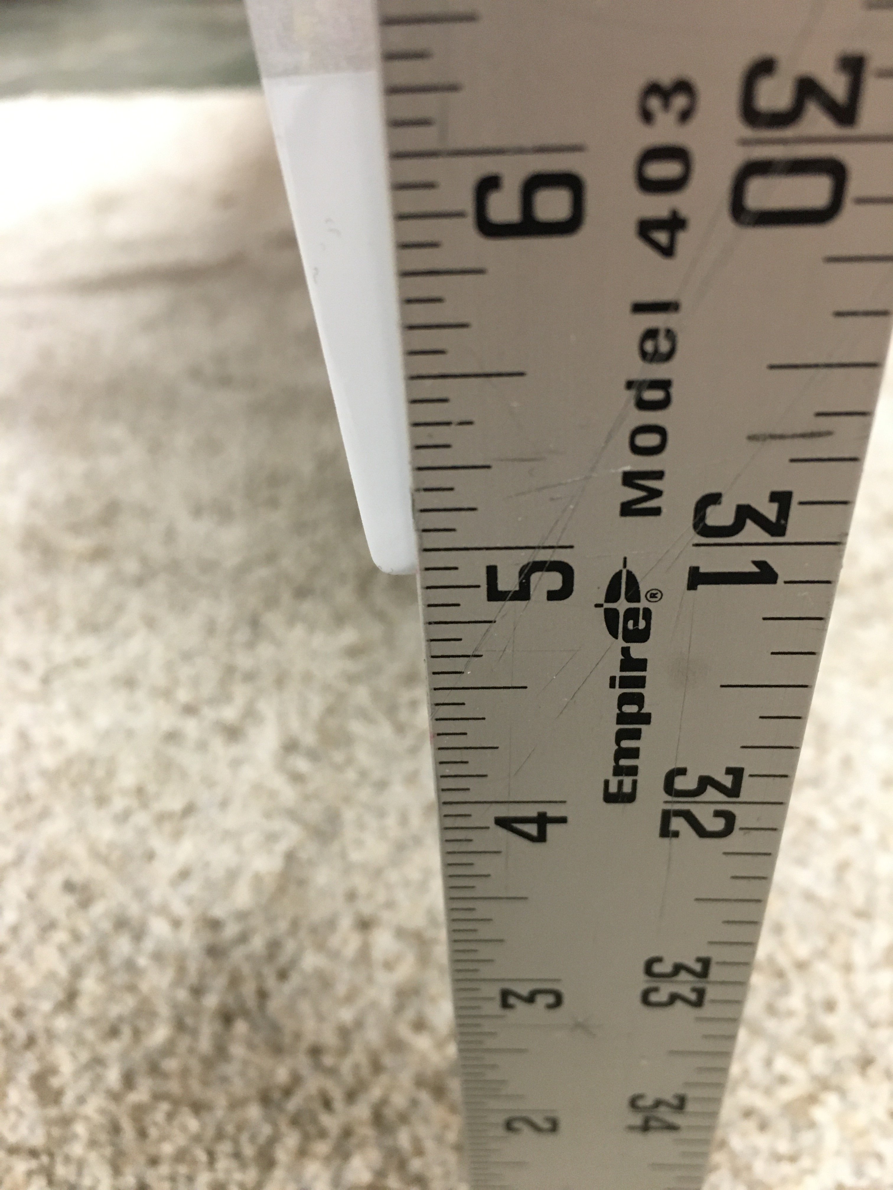

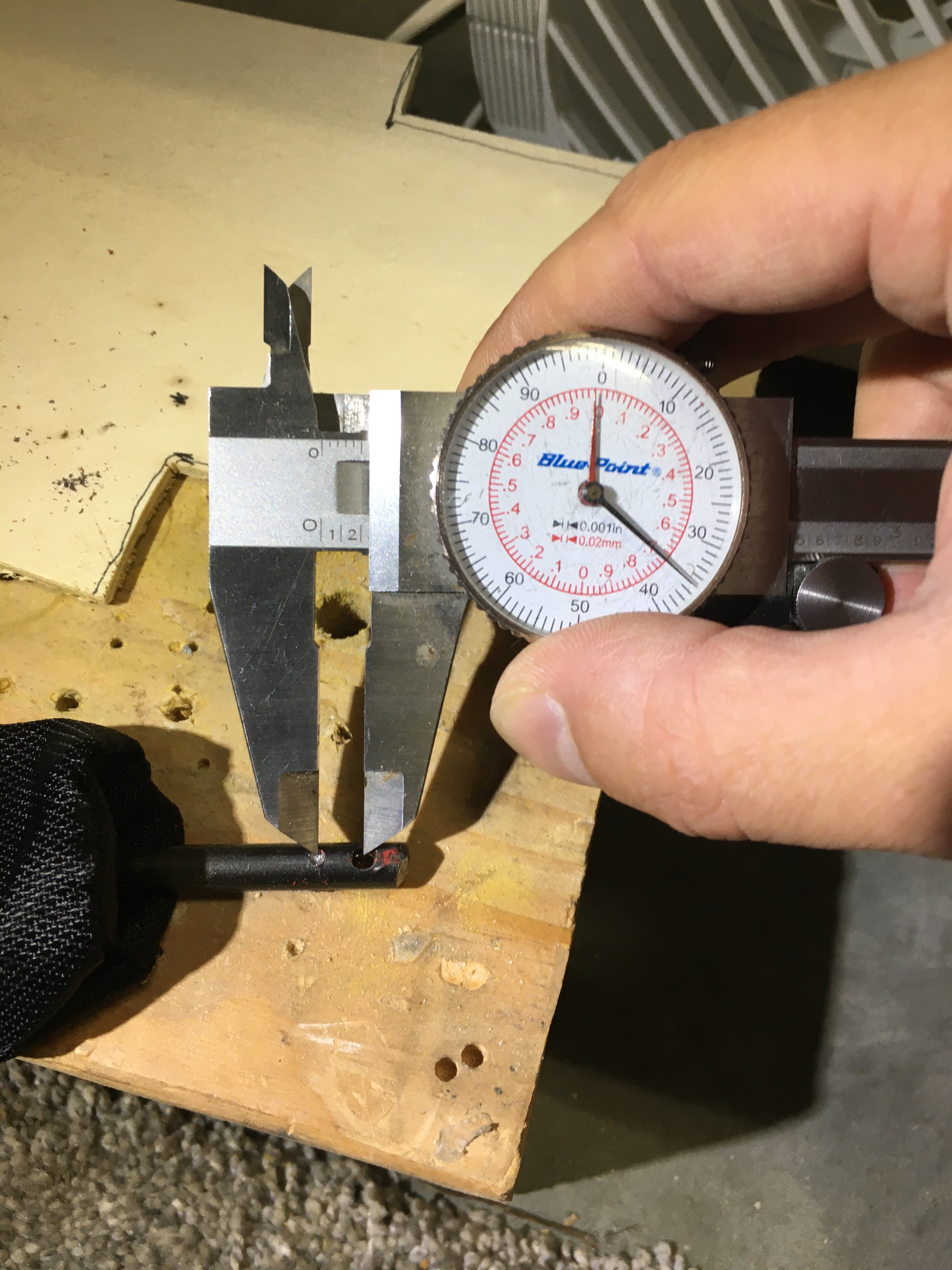

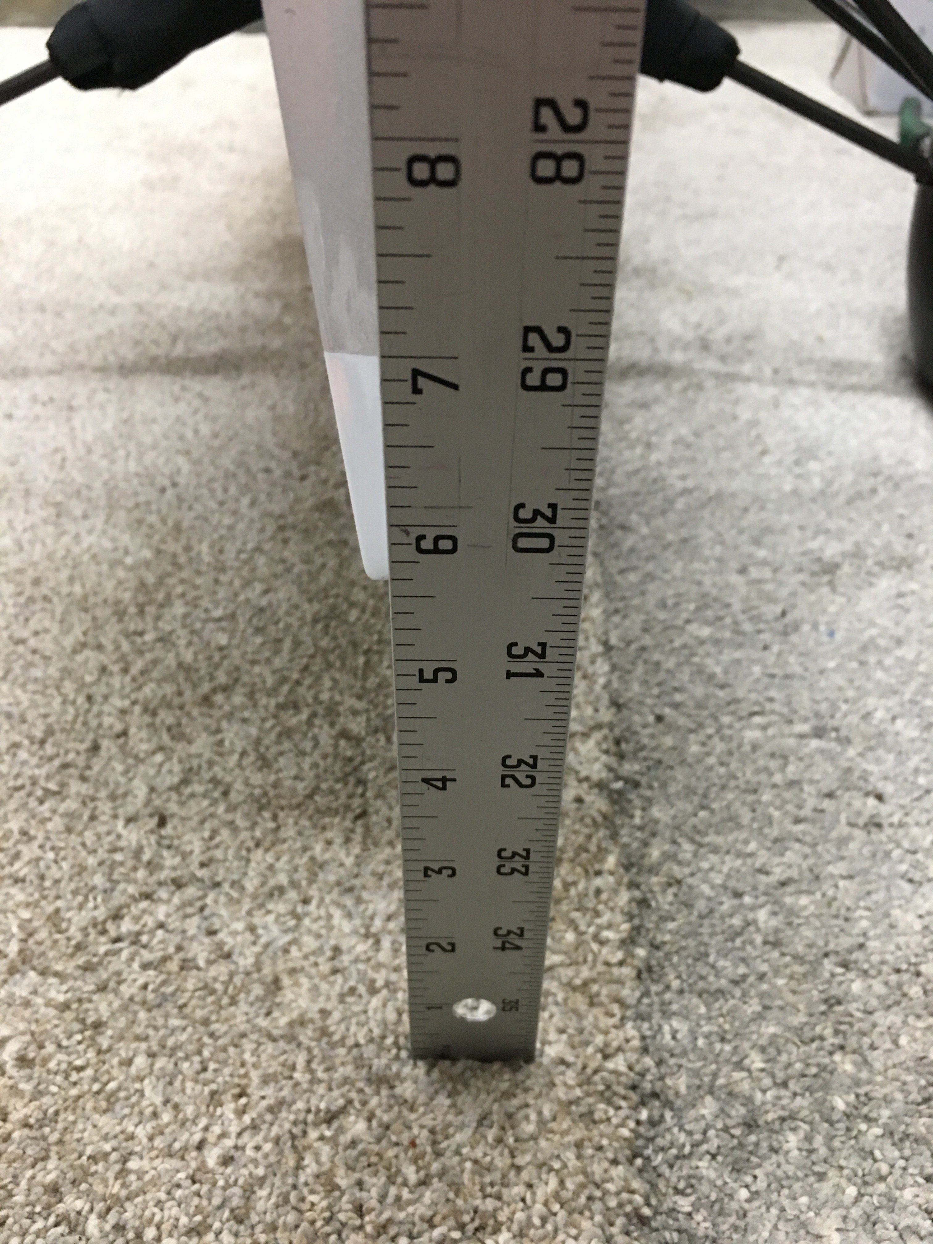

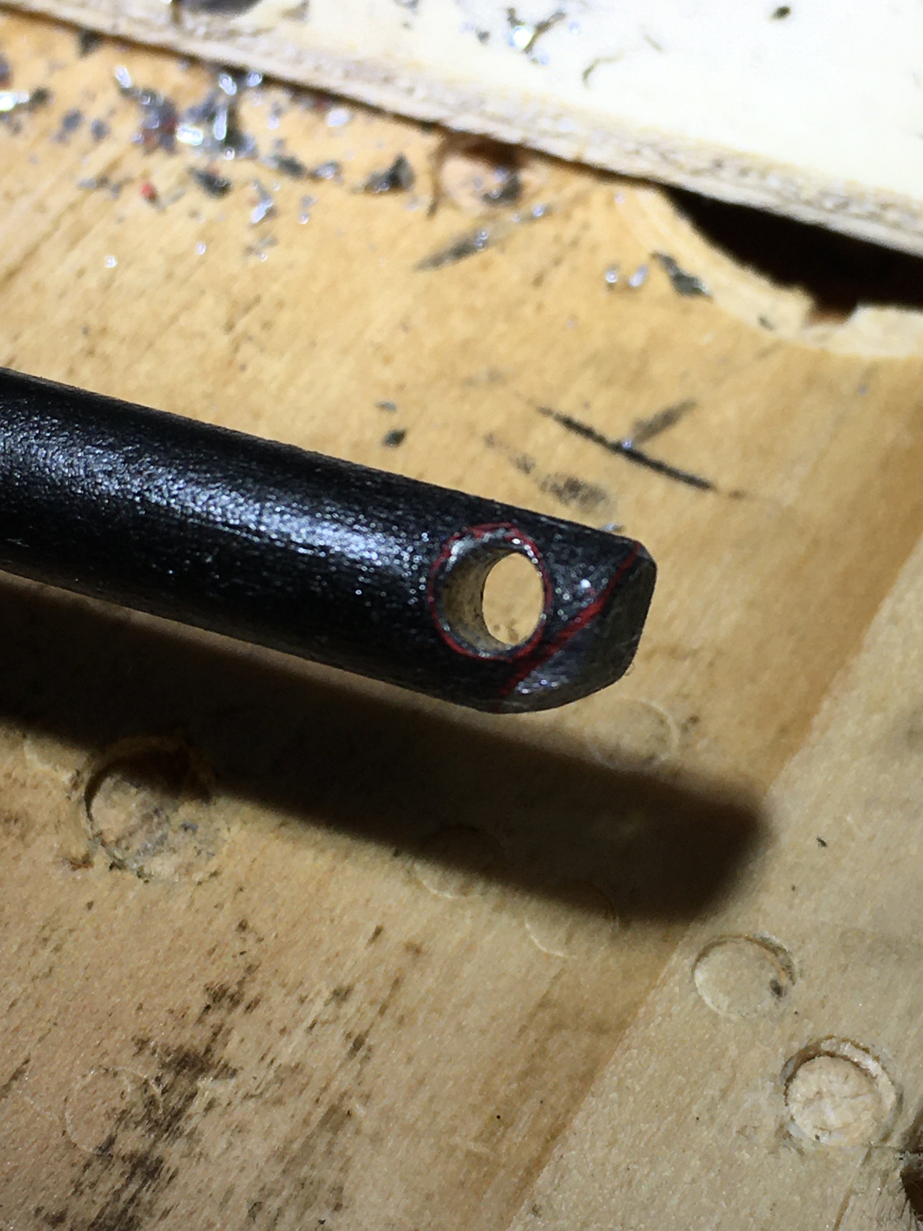

I drilled another hole 6-7mm inboard from the other hole on center. I gained just over 1/2” of Prop ground clearance.I am VERY pleased.
On another note I ordered a new prop since mine was missing 1/2” off each side. Got a message and said they were out of stock, but had painted props. I said send me a silver with white tips. Balance was a bit off and there was a lot of paint lumped up near the hub to remove. Just keep that in mind when buying one.
prop clearance before

shortening the rod 6-7mm on center
Cleaned up, and a little bevel so it doesn’t hit the other arm.
my new ground clearance!!! Yay!!!
now is sits with a little camber.
very happy!!! Thanks for the idea @FlyingClint
