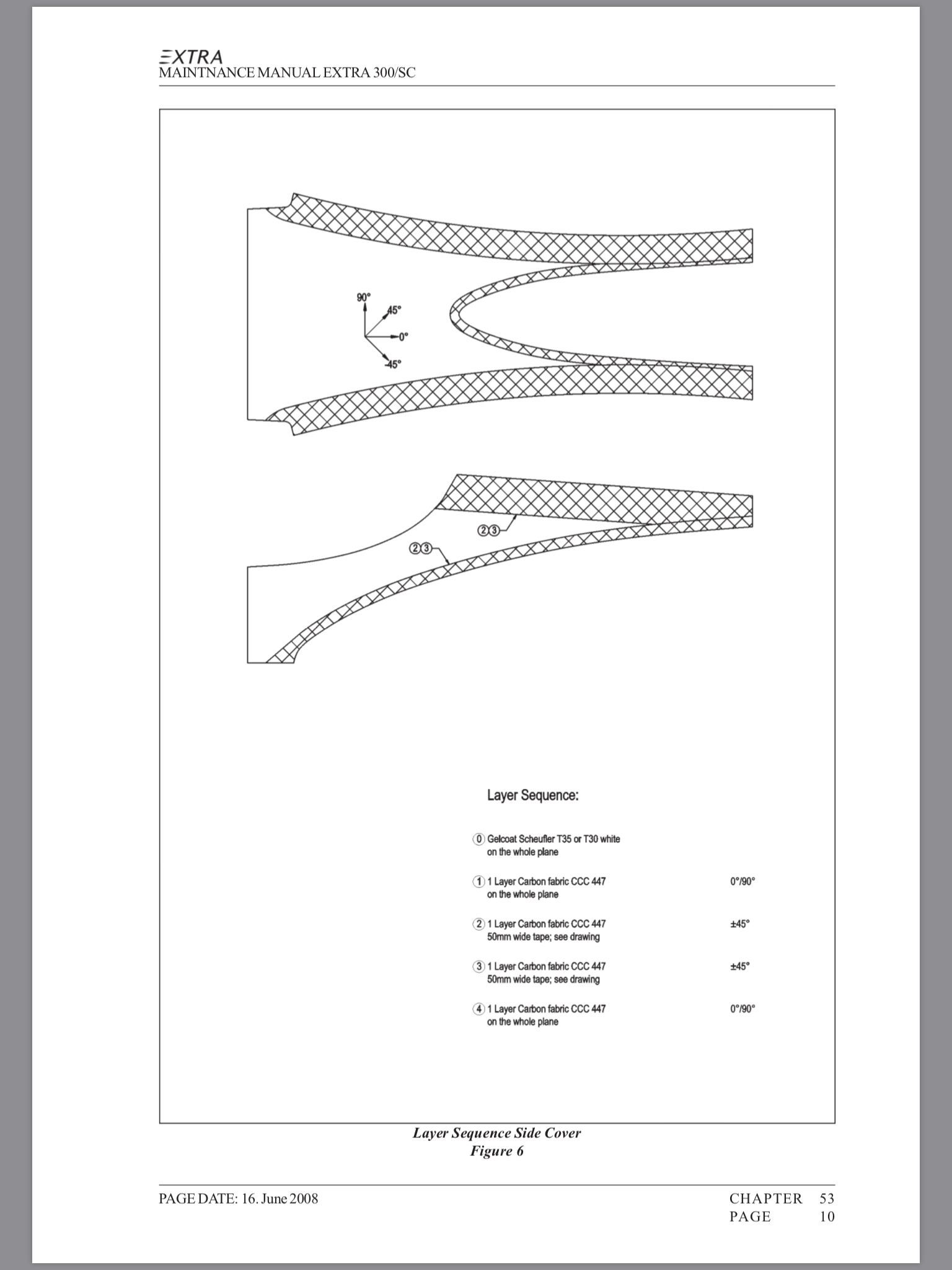

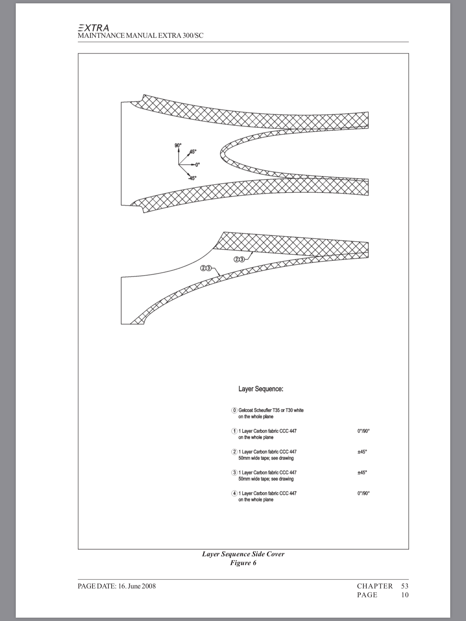

Couldn’t really tell from all the photos, so I looked through one of Extra’s maintenance manuals and found the image below. Hope that helps.

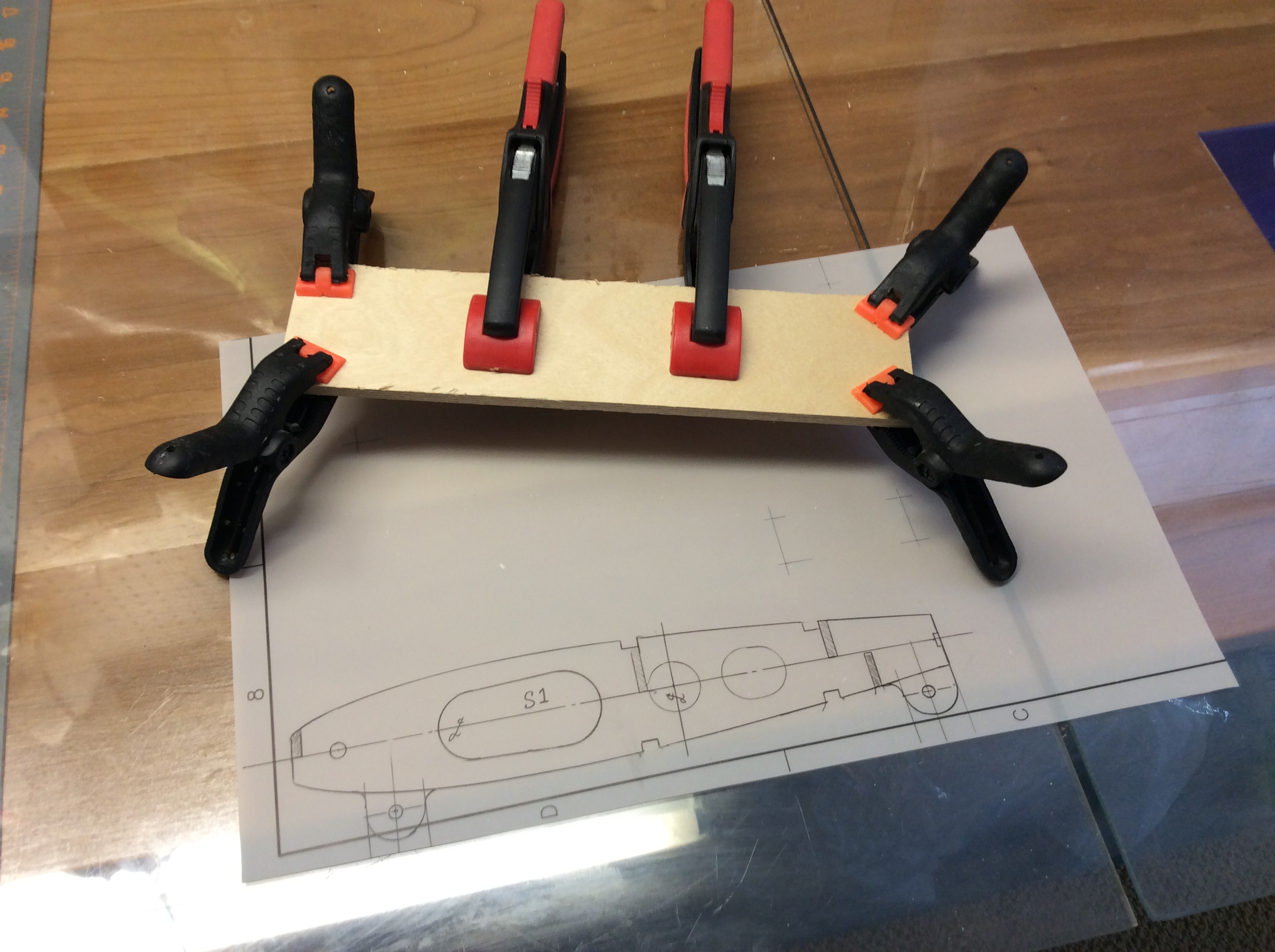

Got started on making two new S1 ribs for the stabilizers. Made drawing and glued two pieces of 3mm 5 ply plywood together. Wait for the glue to dry and then do some cutting and shaping. Once that is done I can continue to build the stabilizers.

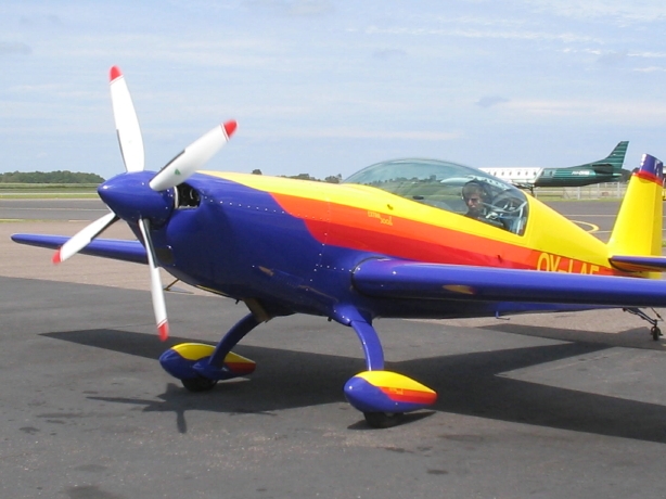

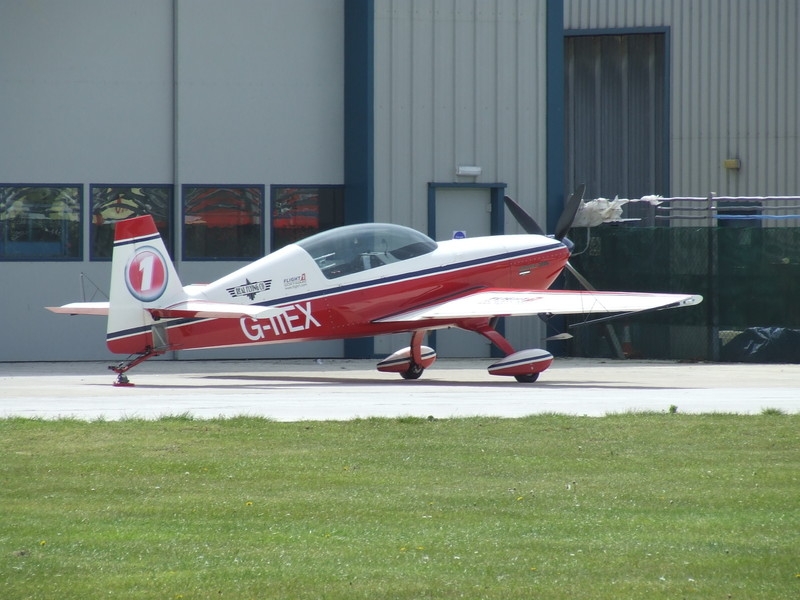

Here are a couple of real 330L pics. Looks as if the stab "butts" up against the side of the fuse where the fuse side is starting to "round" at the top. Also looks as if there is a "former/cover" that streamlines the compound surfaces of both horiz / vert stabs.
