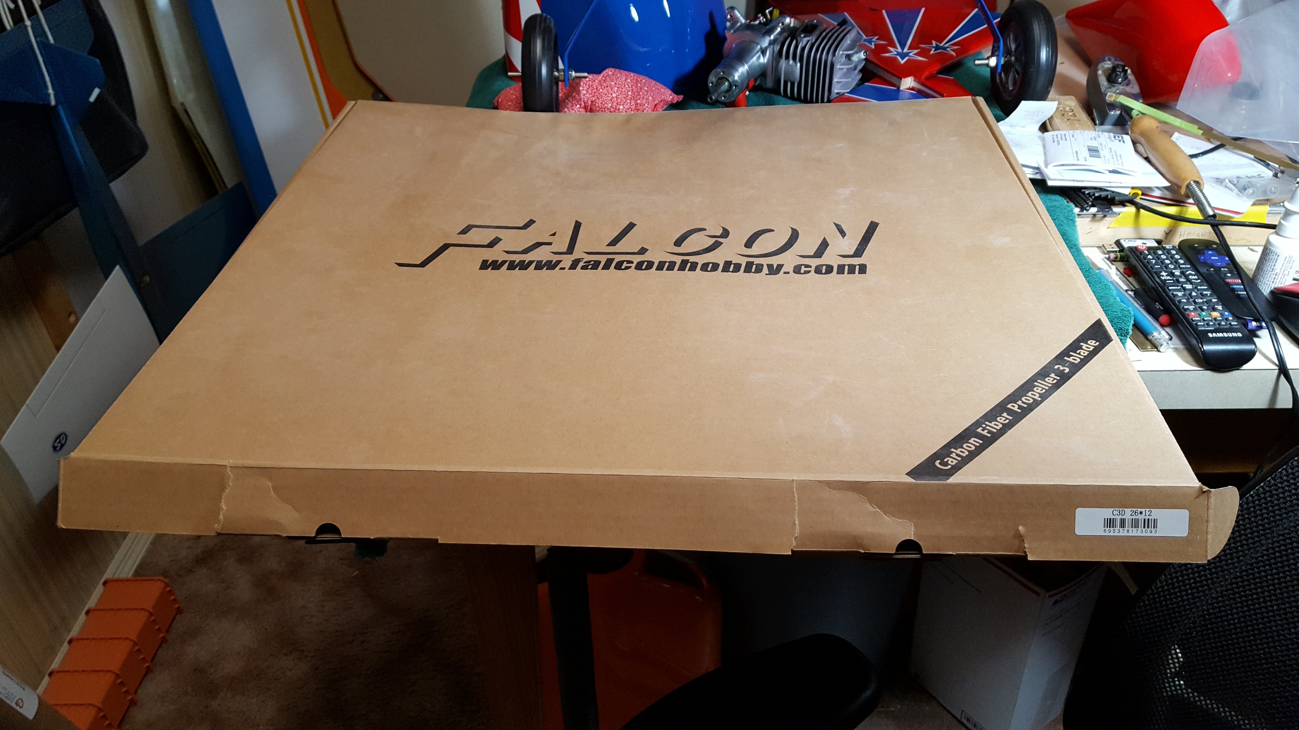

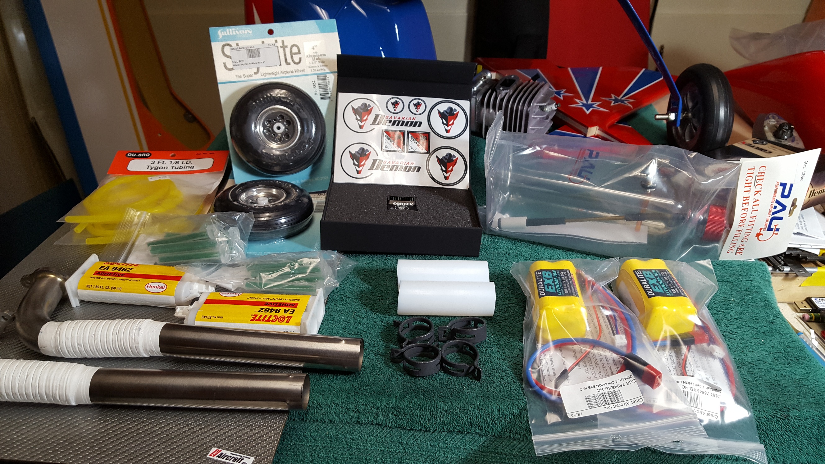

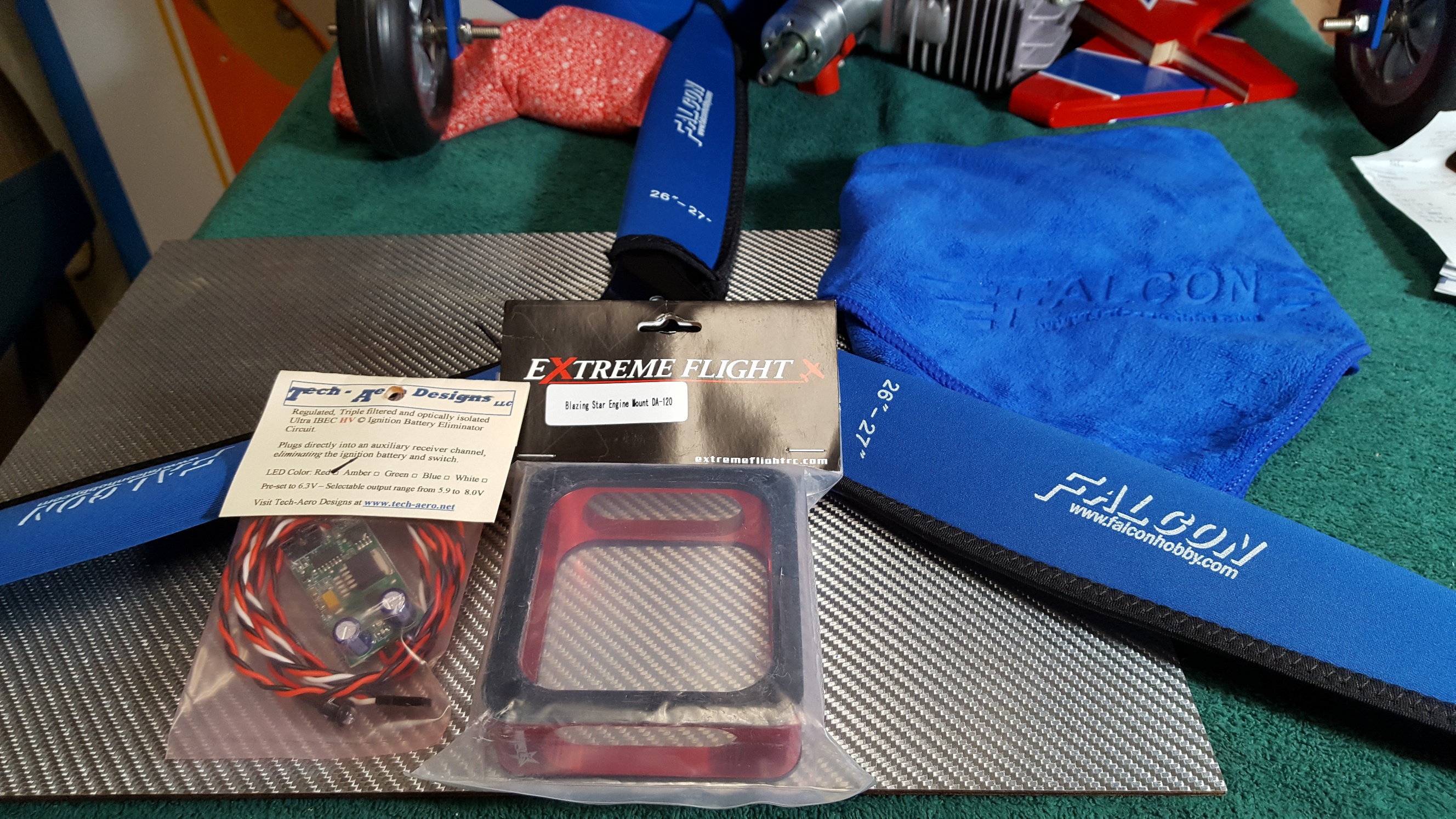

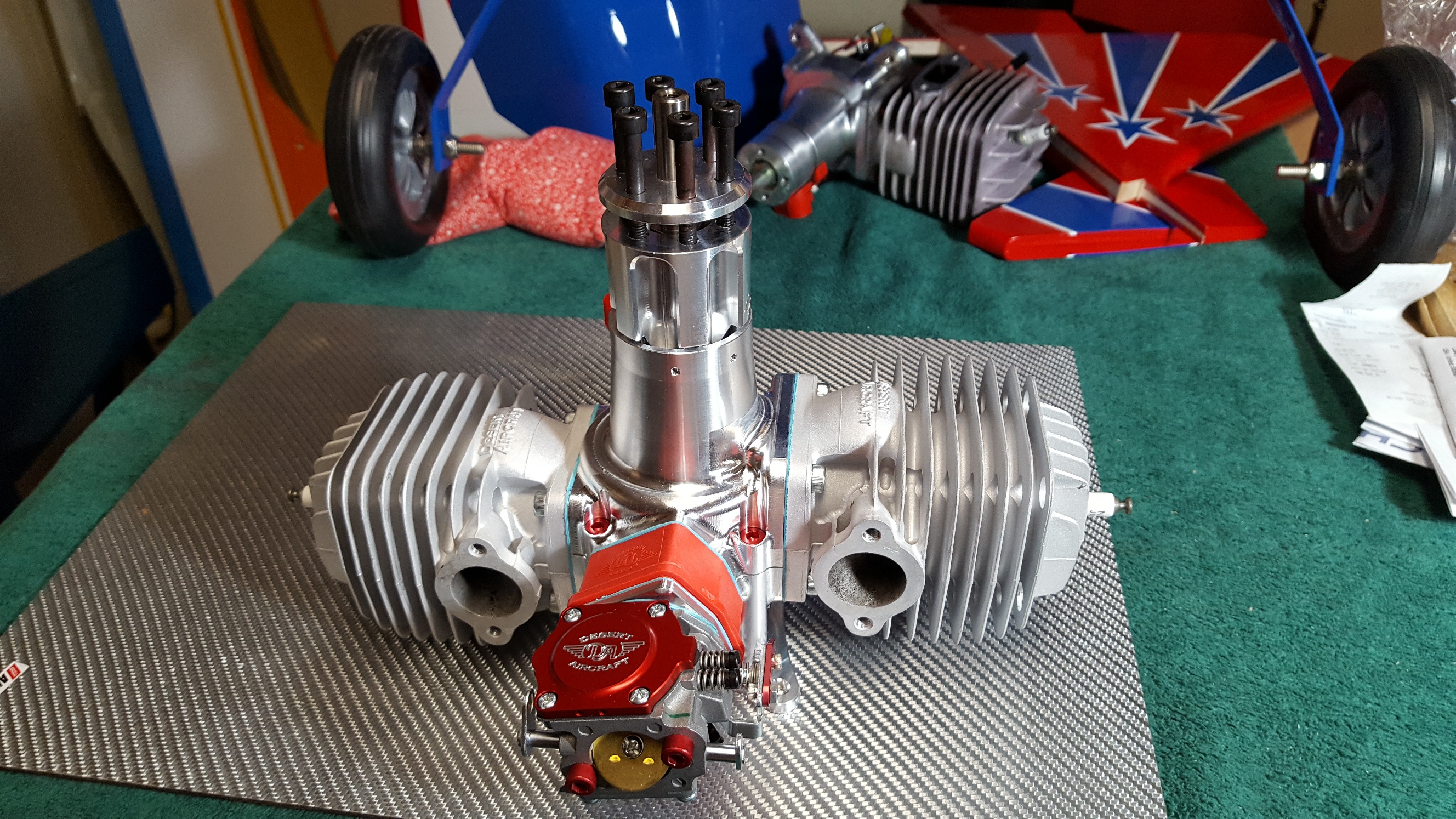

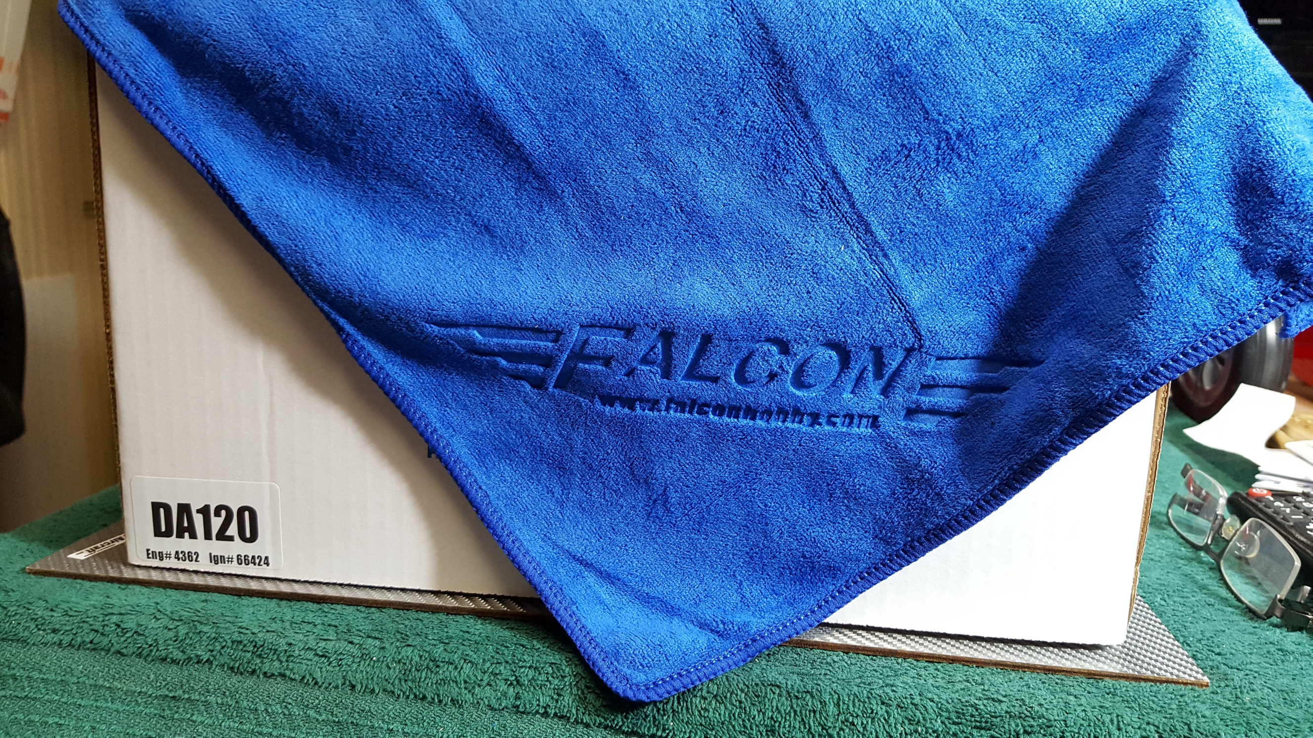

I received a relay from USPS via my buddy Tony this week with a load of parts for his Ultimate.

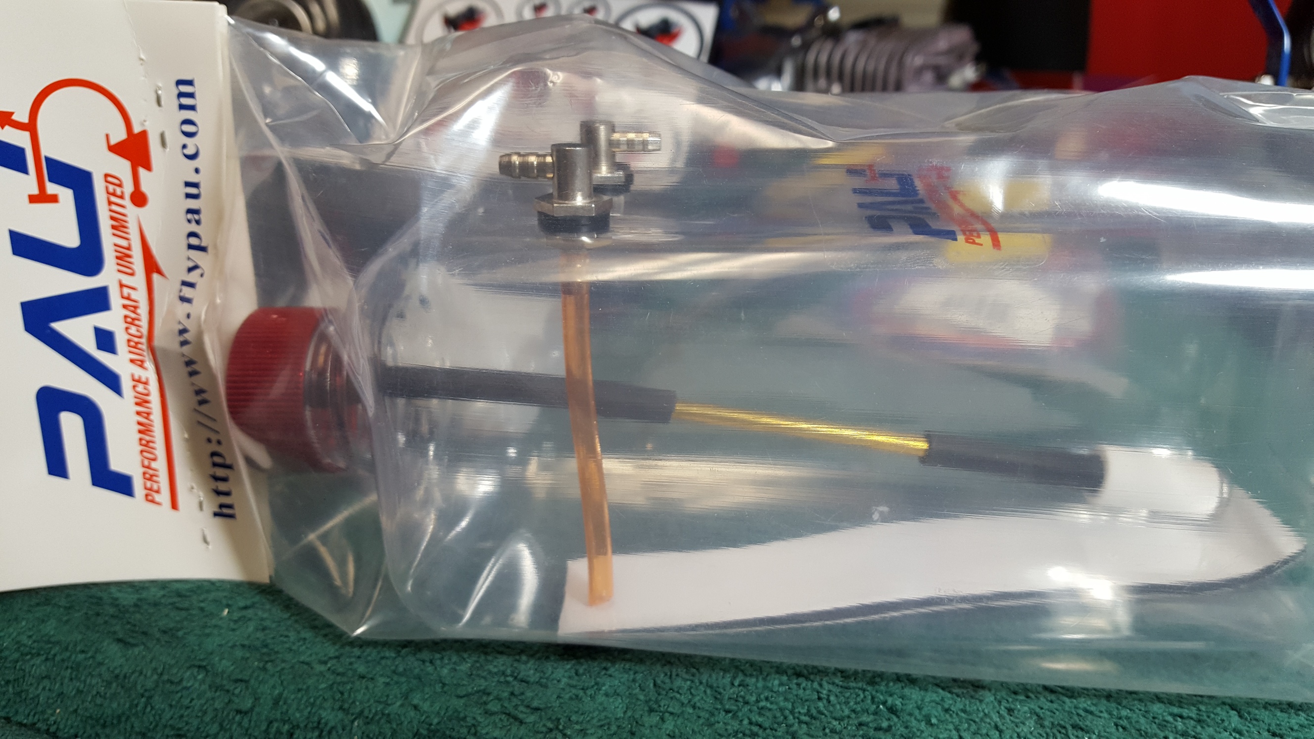

Falcon 3 blade prop, DA120, fuel tank, Tech-Aero Ultra, wheels, Blazing Star mount, headers, Hysol, fuel lines and batteries. The fuel tank is a PAU pro tank, it's really nice!
If you've never bought a big three blade prop before, it comes in a giant pizza box. ;)

What radio is going to be used in the plane because I see a Demon Cortex in the pictures.

The radio is a JR 11X DSMX with a Spektrum PowerSafe 12 channel receiver. Since the Cortex can only do 5 input/outputs, it will be used on the single rudder servo, the 2 elevator servos, and the 2 aileron servos in the lower wing. The 2 servos in the top wing won't go through the gyro. I've read that doing it that way works fine.

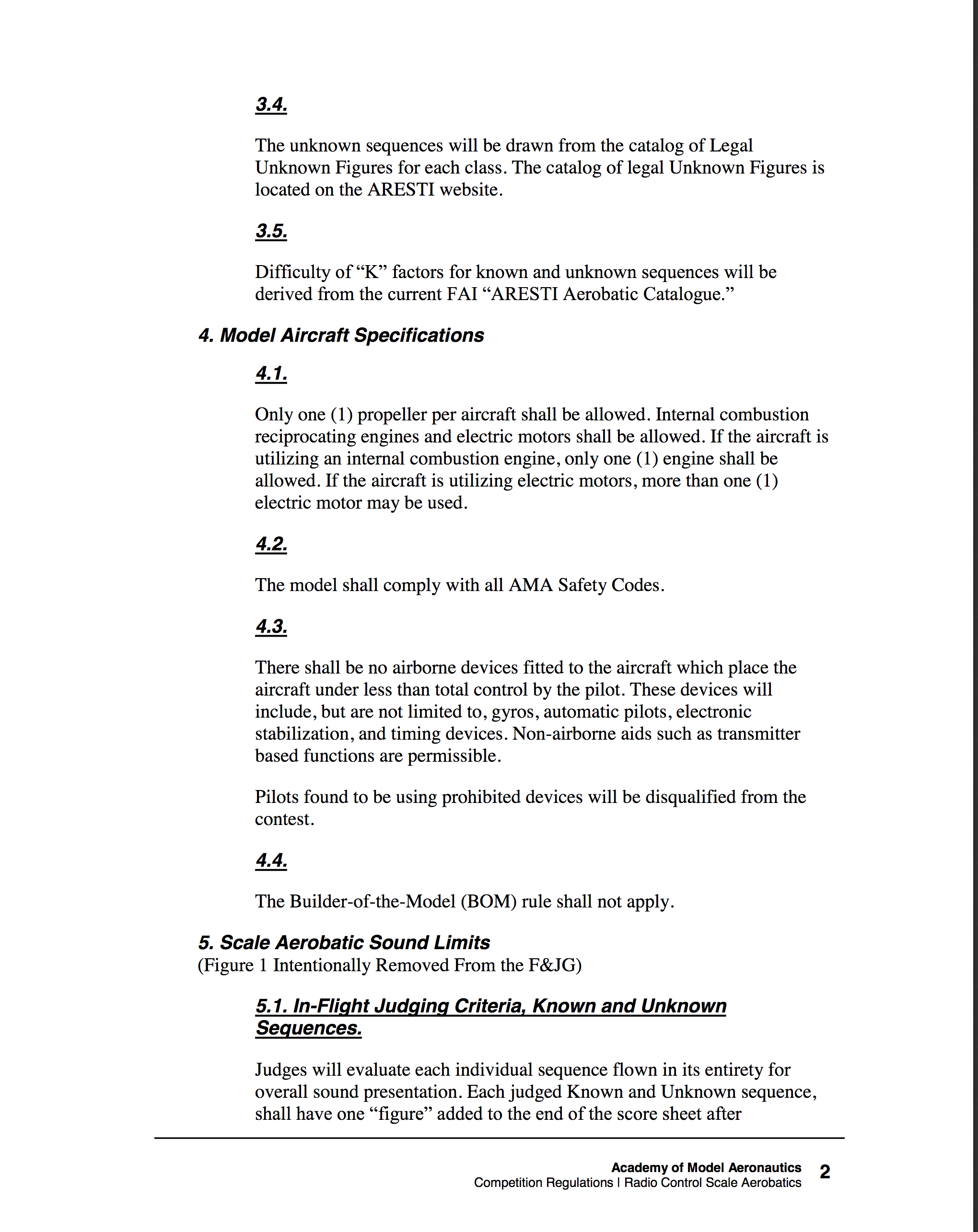

Can’t answer your other questions, but gyros cannot be used in IMAC or Pattern contests. OK, knowledge exceeded. Hahaha

Something I found interesting was the serial number on the DA120, 4362. My oldest DA50 was bought in 2005 and it's serial number 4779. They must have sold a lot of DA50's.;)
Serial number on older da120 is 1753 compared to 4293 on my new DA120 DA most have sold alot in the last six years .
Lots of get stuff for your assembly, love PAU tanks bit would ditch the felt for a Dubro nipple .
Your going to love that 26x12 prop , i tried a 27x12 and my 120 and it was working too hard , high temp .

This should clarify the gyro issue.
