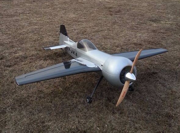

I saw a Juka posted on Facebook by Redwing... That one might be a player in the community once it's released.
