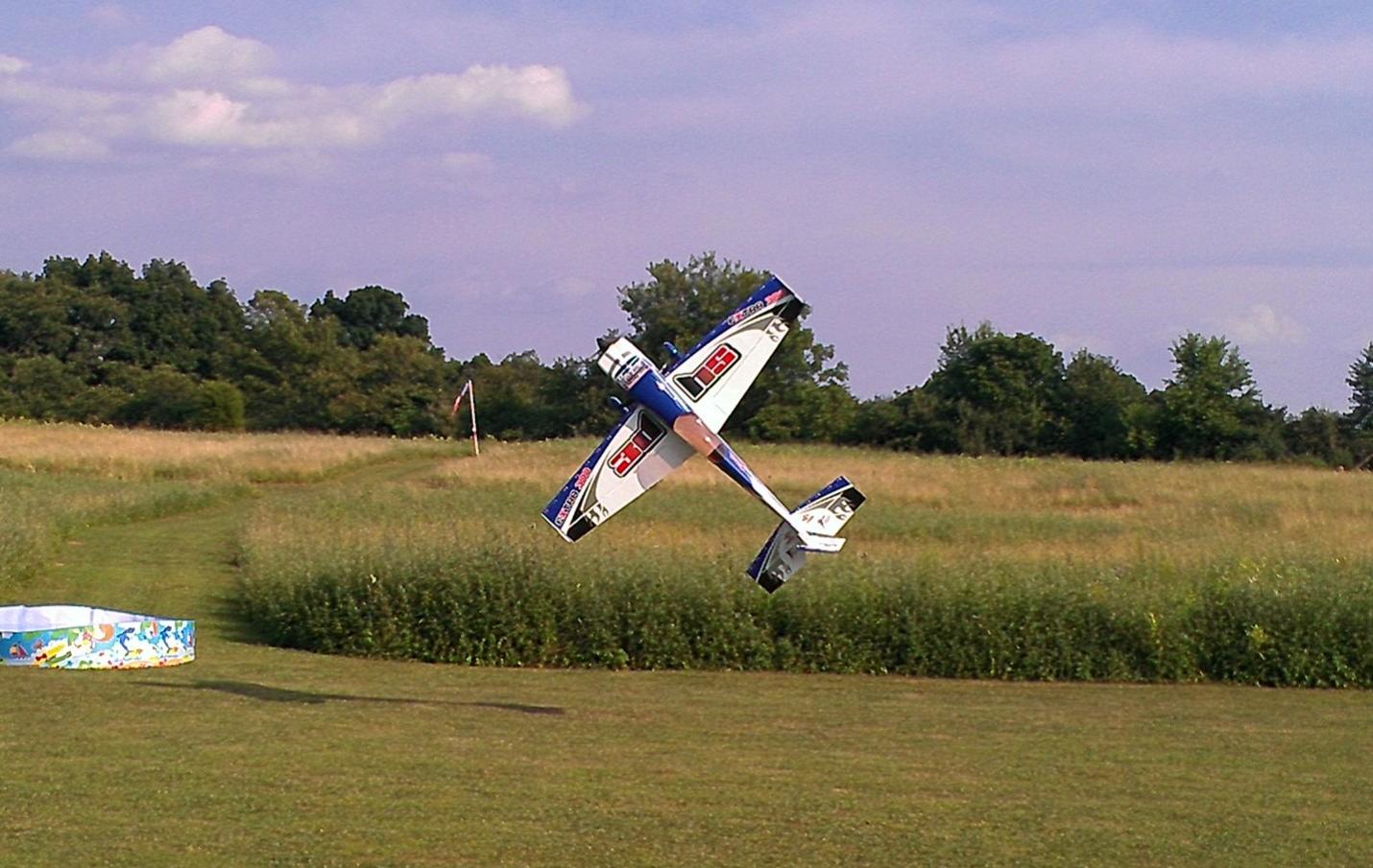

    Flying knife-edge (often abbreviated KE) means flying the plane with the wings in a vertical orientation. The wings do not generate any lift in the configuration, so the fuselage acts as a lifting surface. Generous amounts of rudder are usually needed to keep the plane from losing altitude.
    Joe Smith flying a killer high-beta knife-edge at the Fly-Low-In in New Jersey. (Photo: Pontus Rydin)
