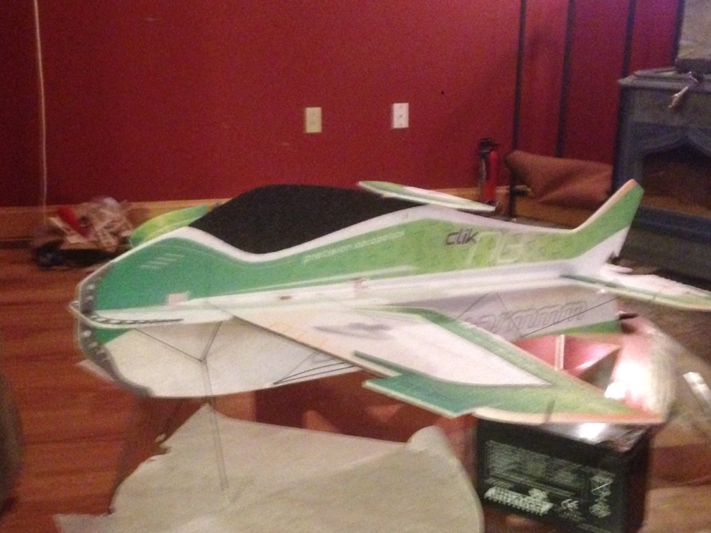

[MENTION=3092]Lovemyxtra[/MENTION] is working on one as well for indoor season. He also likes to play around with a VPP system on foamies.
Here is a pict of his project he just sent me.
