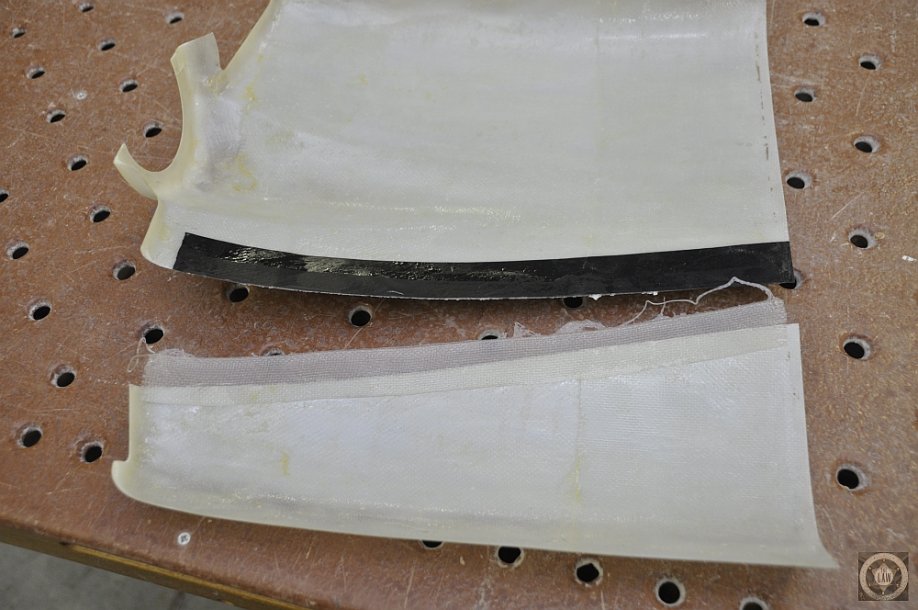

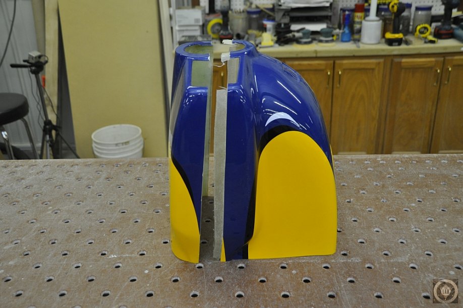

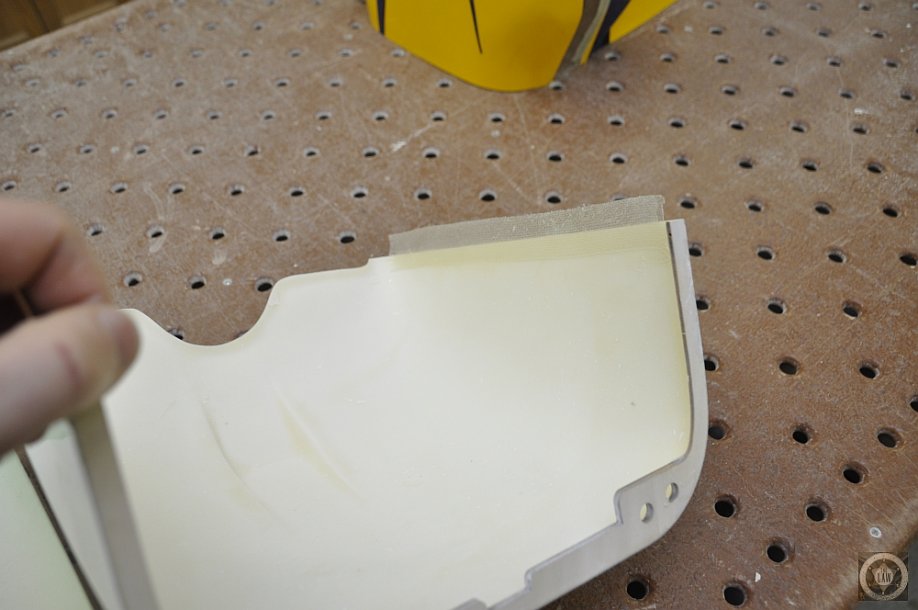

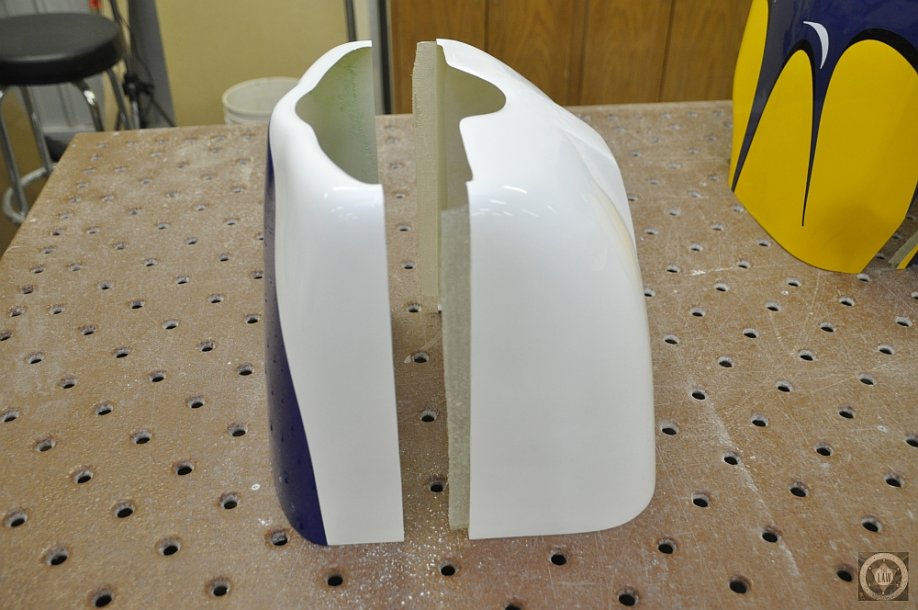

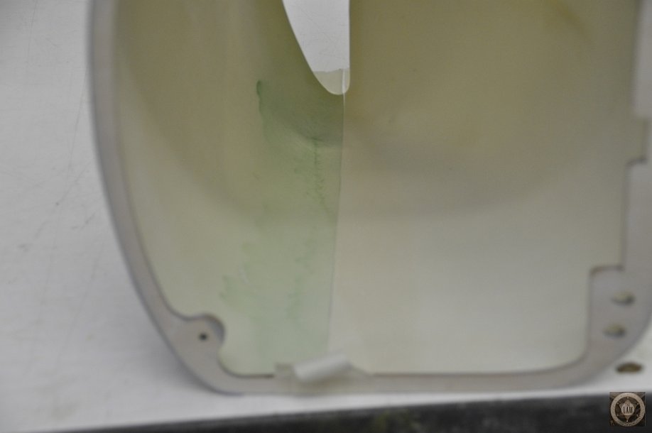

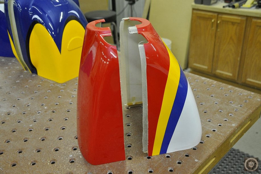

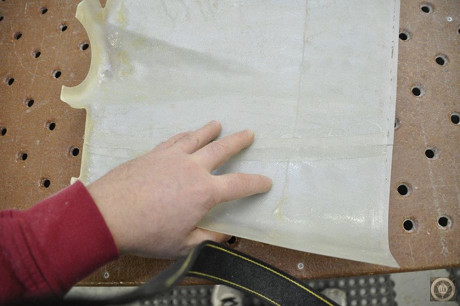

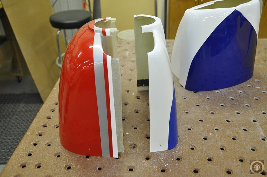

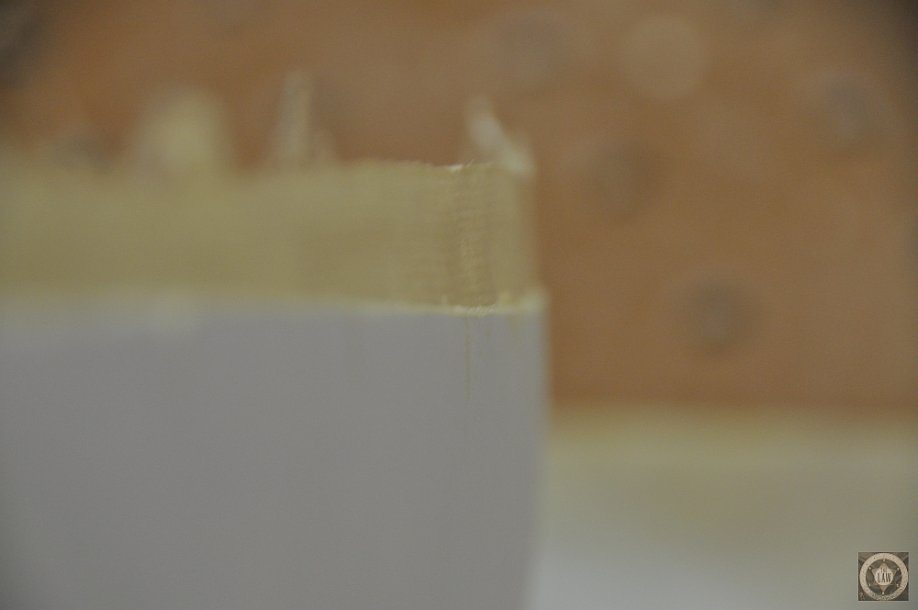

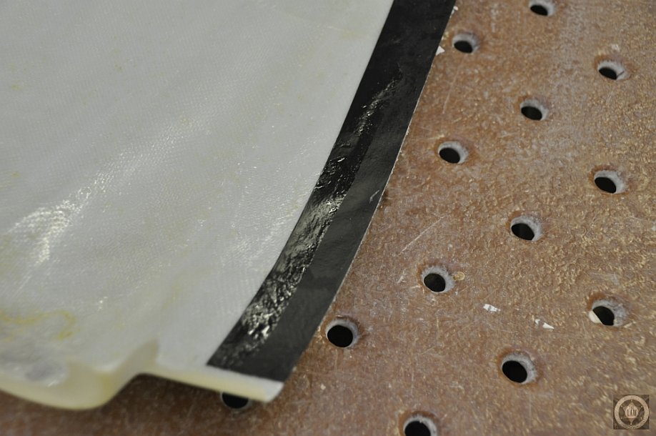

I know that my resin allows me to do some light handling after about 4 hours so I like to separate the halves before the resin is fully cured. It will take a little bit of pulling and maybe some compressed air but take your time. I will say that the electrical tape and pam cooking spray POS test cowl showed really excellent results!! I used 1 1/4" electrical tape, sprayed pam on there and lightly sread it out evenly with a shop rag. I am impressed with the results......enough so that I may somewhat adopt that method in the future. Please note the test cowl was cut with a tin-snips so the cut looks a little rough.
After these cure overnight the edges can be sanded and any loose fibers can be trimmed off.
Maybe as soon as this weekend I'll get to start working on installing these, but most likely next week. I'll show a couple of different options for installation of the mounting screws.
