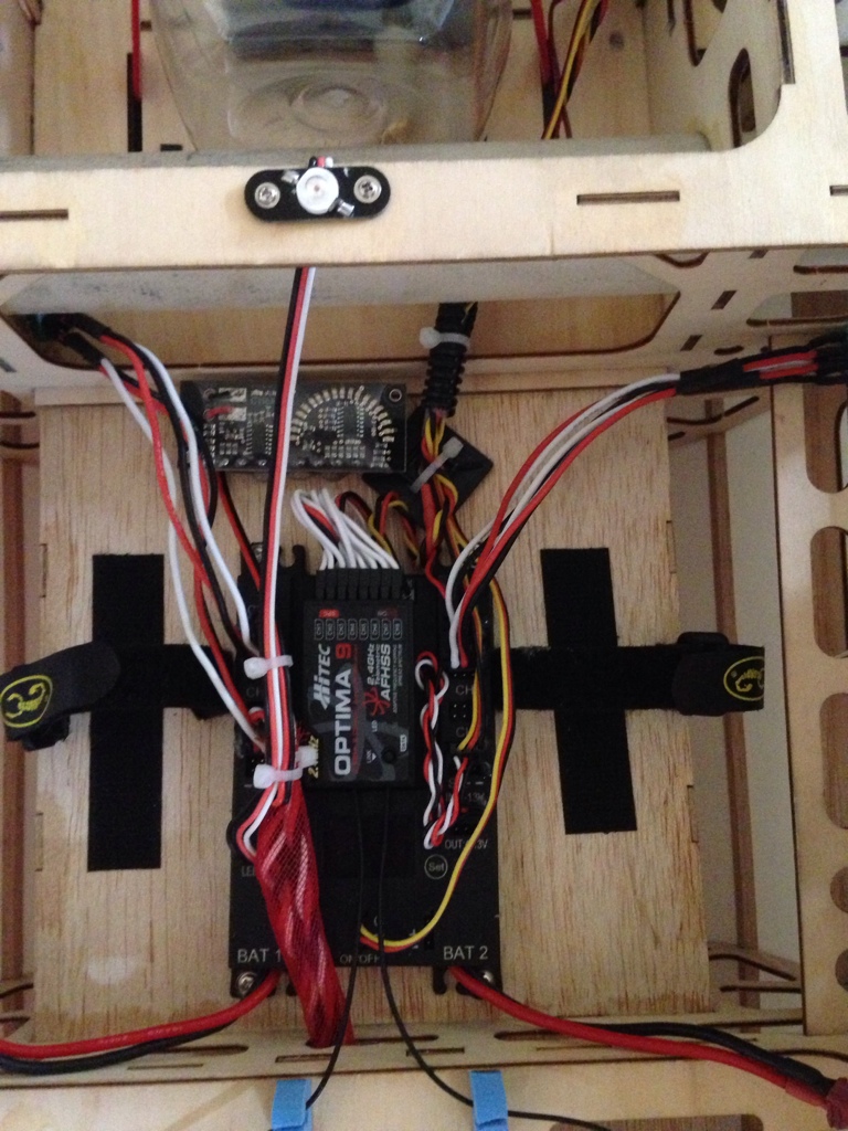

Like this one in my 104 Extra?
That's the one! Looks pretty straight forward Thanks gyro
My pleasure! It works excellent by the way, especially seeing my voltage displayed before each flight so I know what I've got left in my batteries :)
Let me, or [MENTION=2470]RedwingRC[/MENTION] know if you've got any other questions.
