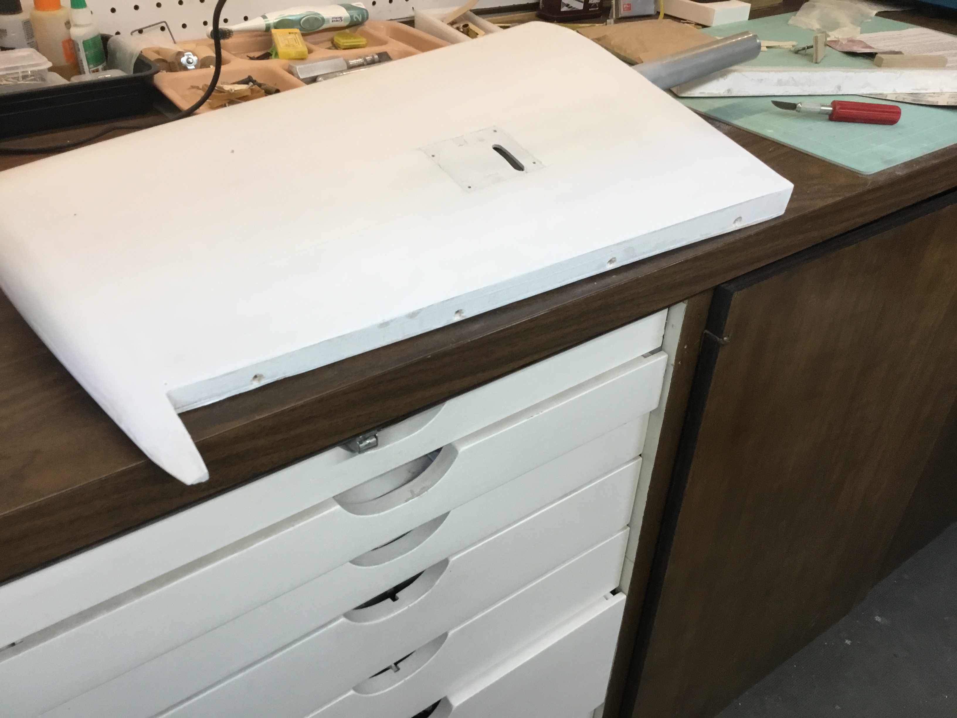

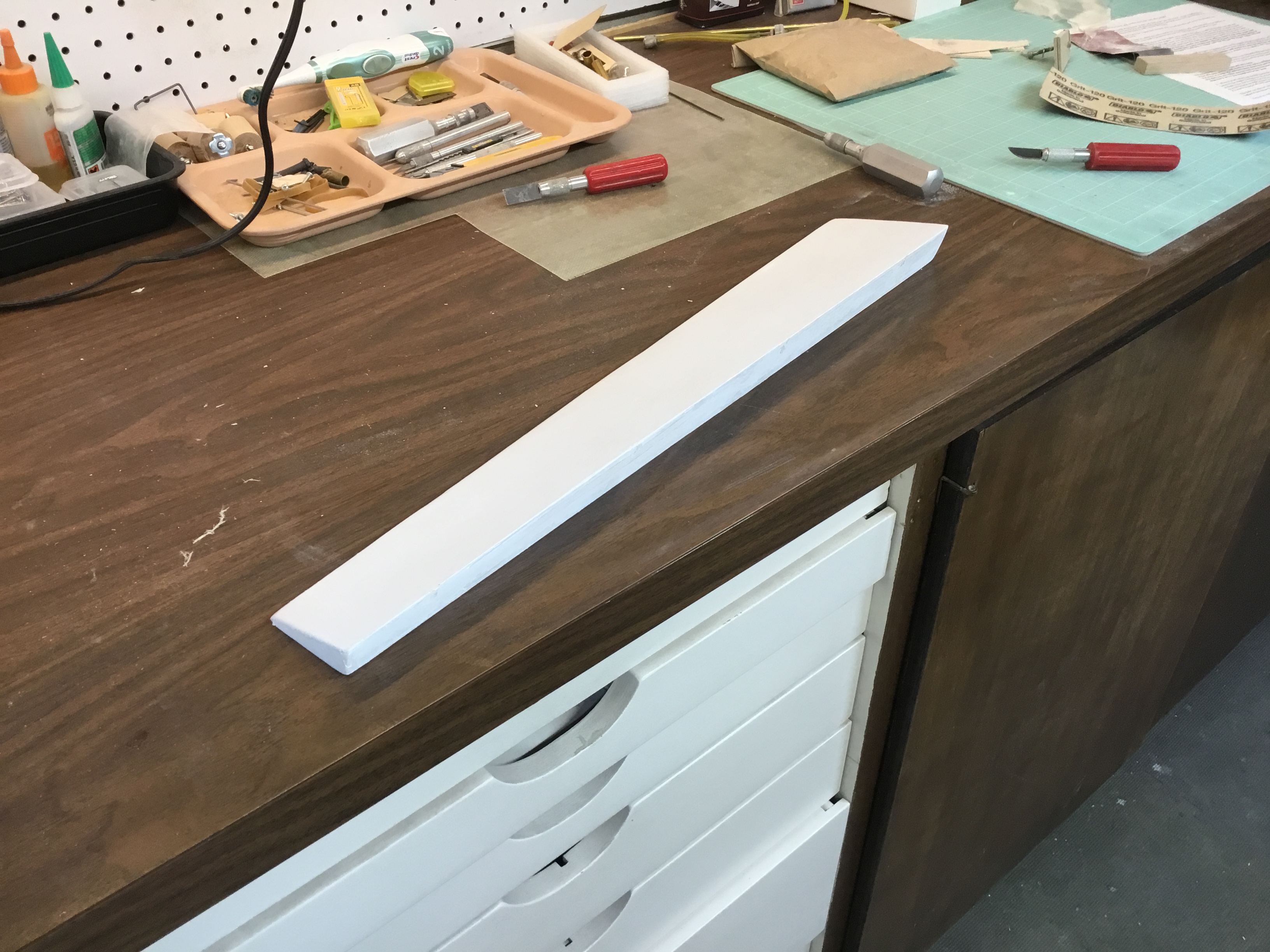

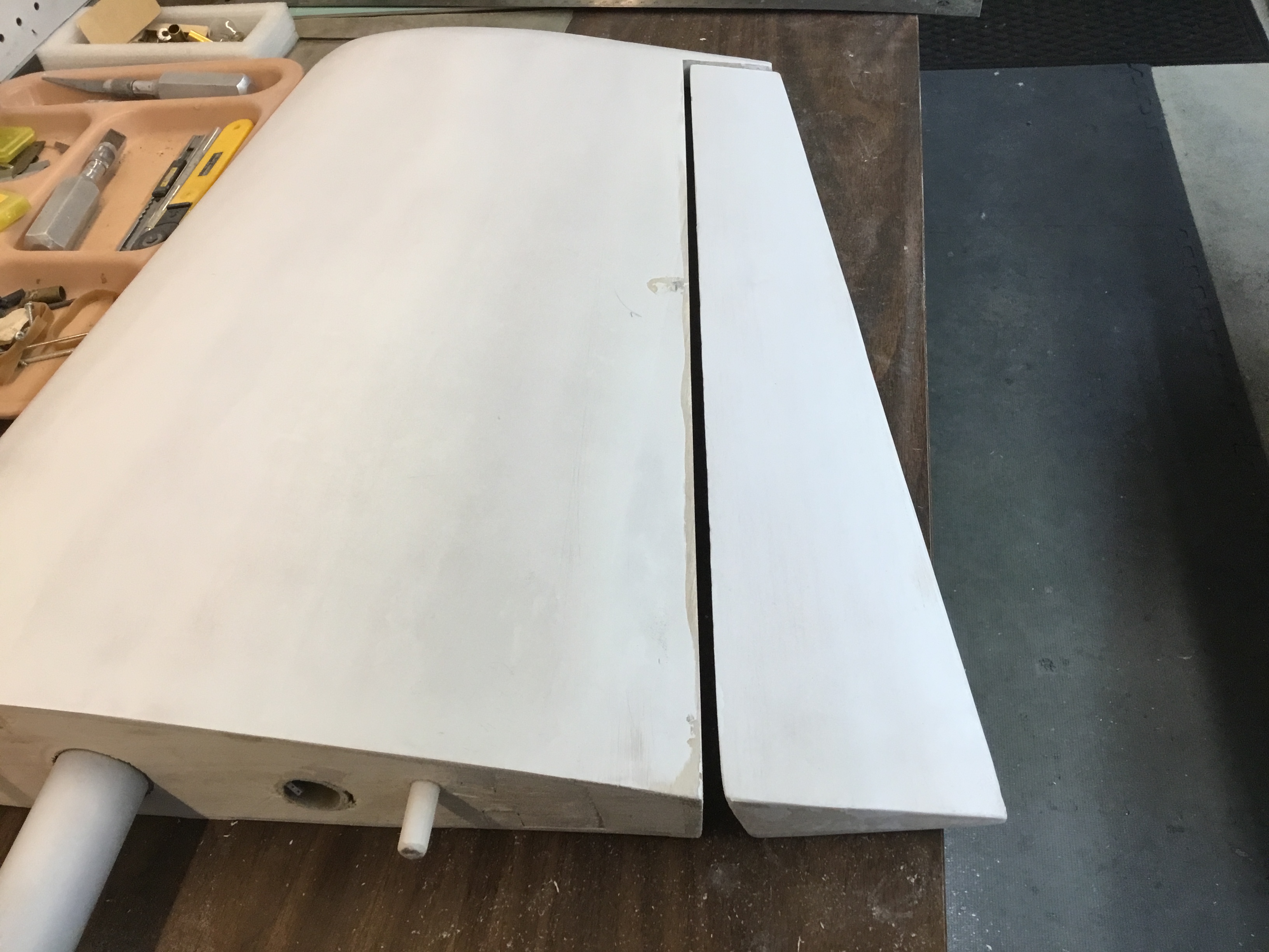

Back to hingeing. I started in the back.  Left elevator half.  I like to use the fiber covered plastic hinges.  I buy the small sheets (the blue ones) so that I can cut them to the size I want.  Usually, about 1” x 1-1/8.  Give or take a little, not too critical.  Heck some of mine aren’t even exactly square.  Everything lined up first time.  Wow, 5 hinges, hand cut, right on the center line, both surfaces first time.  Even the blind squirrel finds an acorn occasionally.  Right elevator, same thing.  Hmmm, maybe this isn’t so bad after all.  Then came the rudder.  The portion below the counterbalance is 1/4” aircraft plywood.  Not exactly conducive to cutting a hinge slot with an exacto #11.  Not having the right tool, I used a cutoff wheel in my Dremel and cut it just through the plywood enough that I could get one of those small exacto saw blades in.  I finished the slots with that and again everything turned out just right.  Those of you who’ve followed this thread knows that when everything is turning out well for me that something has to rear its ugly head.  As Paul Harvey (an avid modeler as well as a famous radio broadcaster) was famous for saying, stay tuned for “the rest of the story”.
