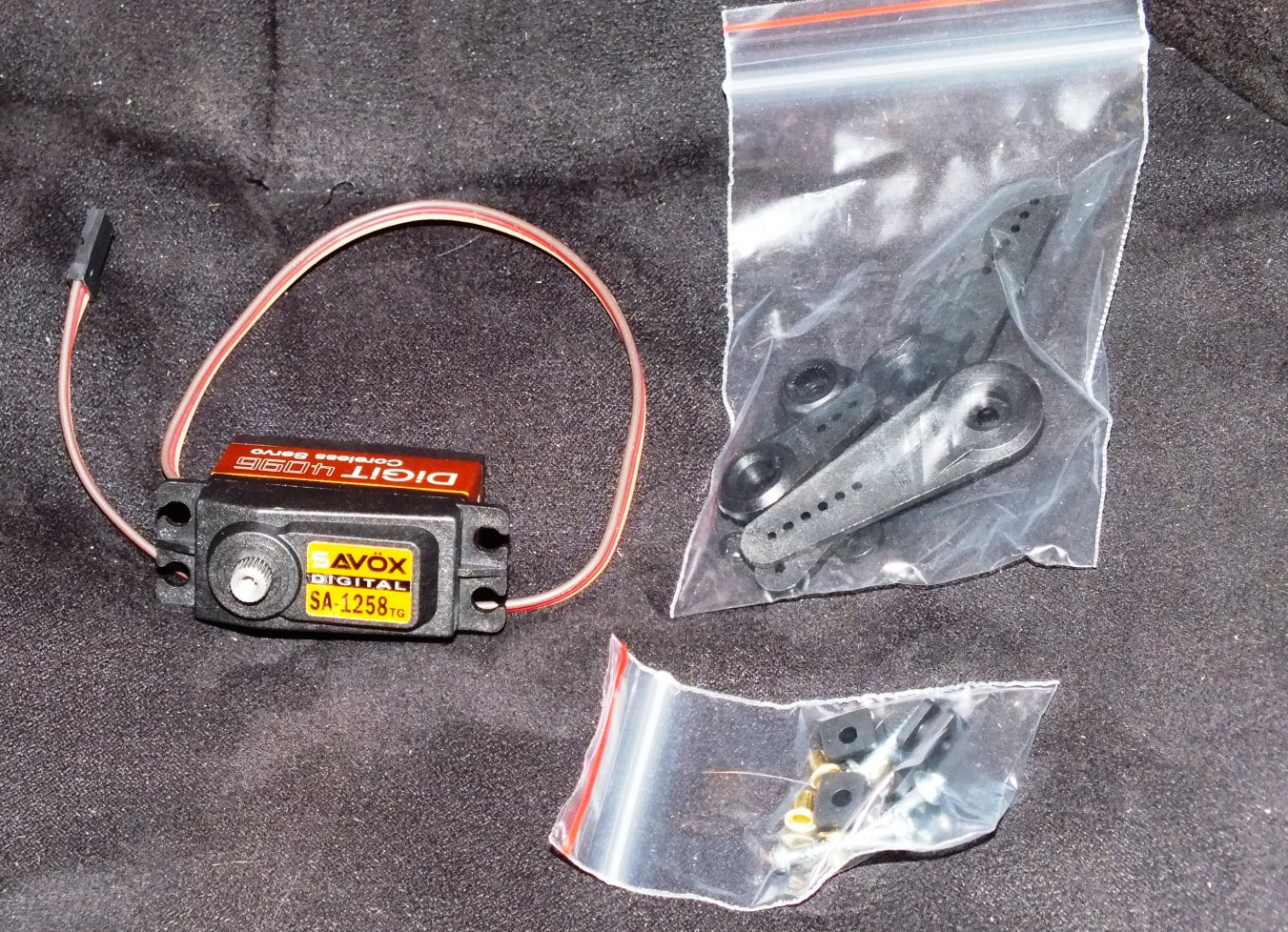

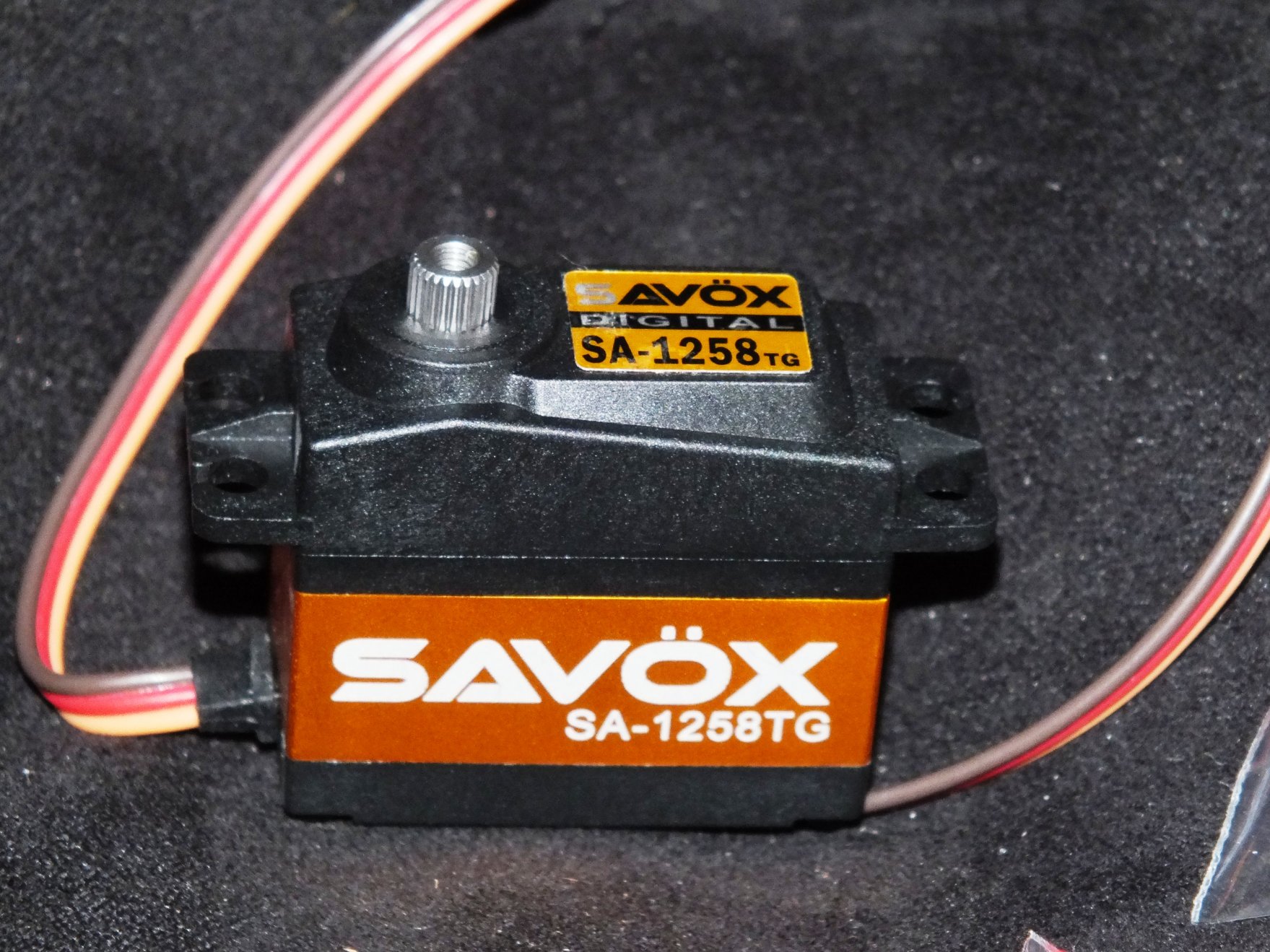

This is just an initial mini-review on the new Savox SA-1258TG Servos. We will be installing 4 of these servos on all the control surfaces of our 72" Extra build over the next few weeks and completing a full review on them then.
In the mean time, we figured we'd let you know that Savox has stepped up and made a servo specifically for us airplane flyers! The new "SA" line! :banana:
Perfect for a 1/4" Scale 3D airplane, here are the specs:
The SA1258TG combines leading edge technology with super high 12-bit (4096) resolution and titanium and aluminum gears for one amazing servo! With titanium and aluminum gears, this servo is truly magical. Pushing 167 ounces of torque and a blistering .08 transit time, this servo is redefining what an all-around servo should be capable of. This is a great upgrade to most comparably priced servos. The minimized backlash on the SA1258TG is helpful in plane wings for greater accuracy and less gear play.
Features:
Weight(g): 52.4
Speed(@4.8V sec/60): .10
Torque(@4.8V oz-in): 133.3
Speed(@6.0V sec/60): .08
Torque(@6.0V oz-in): 166.6
Gear: Titanium & Aluminum
Bearing: 2BB
Case: Aluminum
25 Tooth Spline

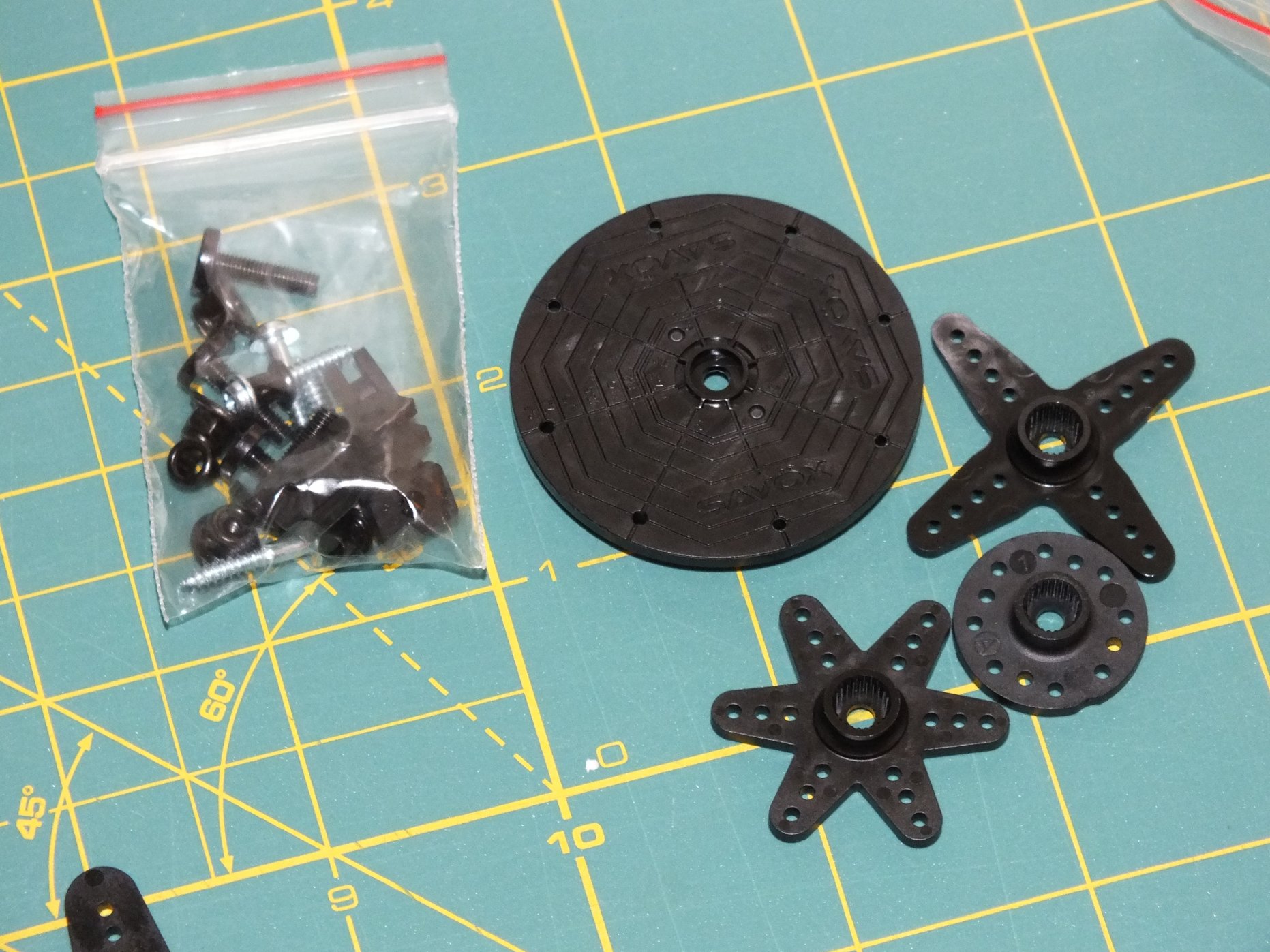

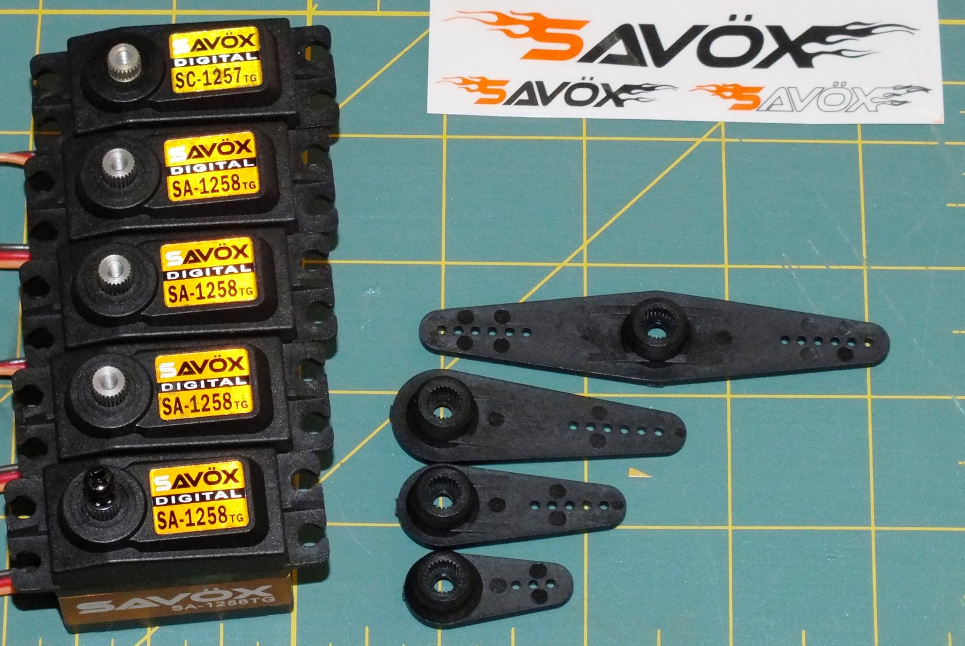

One of the things we noticed quickly about this new servo, are the goodies that come with it. In addition to the reduced backlash, the servos come with some very usable heavy duty servo arms. These are very strong, and the perfect size for 3D, saving you some money over purchasing them separately.
We'll be using these included arms during our 72" Extra build. (we also pictured for comparison what comes with the SC line that you might be more familiar with)
